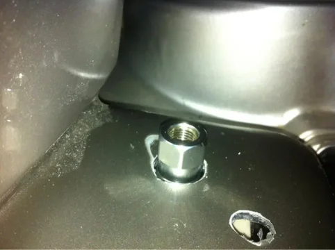

How many times are you supposed to measure before cutting? I can't seem to remember. Looks like this afternoons project is turning into how to patch holes nicely. I rushed into mounting the antenna. First hole I didn't realize there was a metal tab right under where I was drilling, hole two works but is kind of flimsy and the antenna sticks out sideways, hole three goes through the metal plate. I am going to attach the antenna to the hard mounting area in the bumper. *sigh*. I guess that is what I get for working against my usually more well thought out MO.

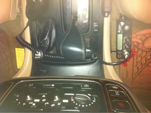

Any suggestions on where to mount the radio in the truck before I go drilling like a mad man?
Hole #3 wins. It's mounted to a tab of metal that is part of the bumper support. Much more solid and holds the antenna much more vertical.
Currently I have the antenna cable running through the tailgate. I will take the time to do something more professional after this upcoming trip. Right now this is a down and dirty install.

To fix holes #1 and #2 I'll find some fancy hardware to put on there to make it look like it serves some kind of purpose. Or they will be future locations for on board air and water connectors. Yeah that's it, I meant to put those there.
Not knowing if you have an after market audio system or not, but if you do and it's only a single din unit, why not stick it in the second din?
Another place could be in/under the upper console where you'd normally stick your garage remote.
Also saw in a nother post in MUD where it was mounted behind the center console, above the back seat cup holders.
Just a few ideas...:hhmm:
Yeah I considered all those options. I have a double din Alpine touch screen installed. There is not enough room in the garage remote console, measured that and I have a 2 year old that likes to kick anything in front of his feet including the area above the cup holders. It is actually working quite well by my right thigh. It is currently held in place by velcro and will get a more permanent mount when I get around to it. It survived an entire weekend of good wheeling without coming off so it might just stay the way it is. not sure yet.
