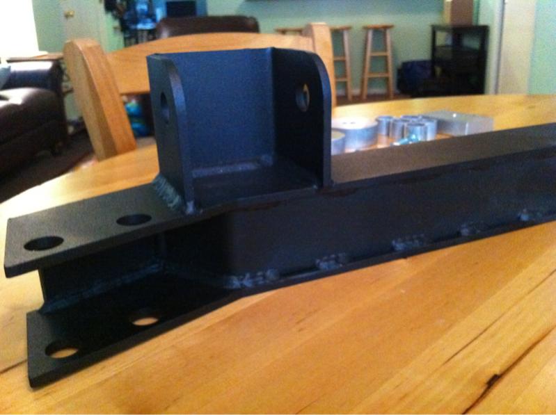

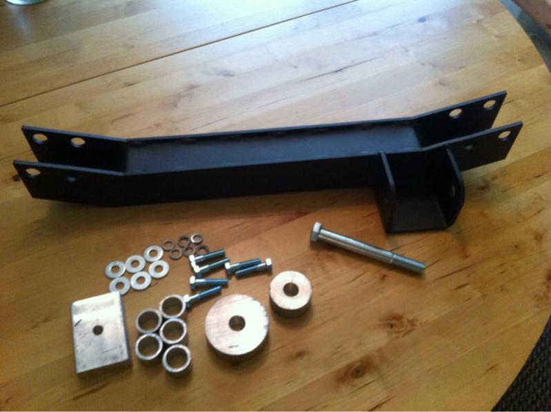

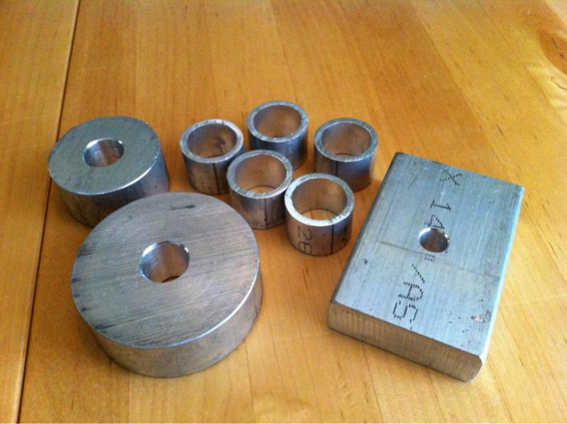

I bought the diff drop from Bump It Offroad. Looks and feels like solid construction. Nice powder coat job. Includes all the hardware. The spacers are pretty rough cut from tube stock but I don't think it's a big deal since no one really sees under there unless you are upside down (that may be a concern for some on here :) ).
Mike had a great set of instructions for the installation. I had to read over them a few times and identify all the parts to make sure I was unscrewing the right nuts and bolts. After 5 minutes I had it all figured out and the install took only a few minutes. The entire install was much easier than I expected it to be; no stuck bolts, no tight places to get to. Just pop the old one out and pop the new one in with spacers.

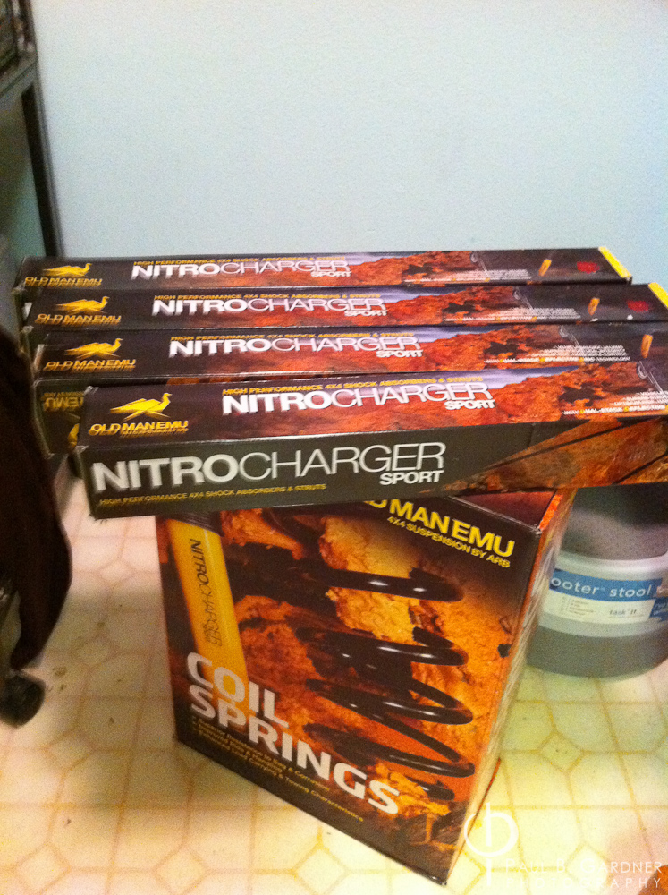

A few months after buying the diff drop I was ready to start buying everything else. I spent a lot of time reading on here all the various options on rear springs, spent some time on the phone with Slee and finally settled in on the OME860 rear springs. They were a perfect match for the amount of load I carry when traveling with my family. I also took Slee's advice and went with the Nitrocharger Sport shocks (60000 and 60002). Only a few weeks after the shocks and springs I was able to buy the last piece of the puzzle; the OME Torsion Bars.
Bits and Pieces
Almost like Christmas. I forgot to take a shot of the T-bars included in there. Oh well, who cares.
