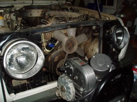

Well I think I found the source of my knock - or shall I say DanKunz and Trollhole found it. My front crankshaft pulley is wobblin' all around. Today I pulled my grill, drained and pulled my radiator, pulled my belts and was able to wiggle the pulley a solid 1mm to maybe 2 mm with my fingers. Dats not good son!
Trollhole and Hard40 have the tools I need to pull the pulley and I'm hoping that the problem is isolated to my pulley and does not extend to my crankshaft.
Also pulled my winch motor today and it was frozen solid. With liberal amounts of electric cleaner (something I found at Advance) and some wrenching I was able to get th motor freed up and it moved pretty freely now by hand. I'm cleaning it one more time and going to let it completely dry before I lube it up with dome di-grease tomorrow. Hopefully with that it will fire right up. I can hear the solenoids clicking in both directions but the motor's not moving. All connections I can see look OK.
I wonder if the crooked P/S belt angle messed up that crank pulley...
Might have... I have a new IPOR PS bracket sourced. I'm interested to see what the crankshaft looks like. I hope the problem is in the pulley and not the crankshaft. I did see that a corner of a fan blade was cracked. I'll check that out tomorrow and see if it needs replaced. Engine cools just fine though.

So you can move the pulley, by hand...1 to 2 mm in the vertical axis while the engine is off?
Sounds like the pulley is hosed, not the crank...almost like the PS tension wallowed it out.
Just took another look at her and I think you nailed it Dan. That pulley is L-O-O-S-E. Your big-sis is sending me an IPOR PS bracket and Trollhole via Hard40 is getting a socket and pulley puller to me tomorrow to gank that pulley off. Hopefully realigning the PS pump and a new pulley will fix everything.
Oh, and I was wigglin' it with the belts off...wouldn't move easily by hand w/ belts on.

Pulled the crank pulley last night. Put a large socket on, tied a breaker bar to the frame and hit the starter a few times and the nut came right off. The pulley, even though you could wiggle it with your fingers, took a puller to force it off. After I pulled it off a bit it was solid again - no wiggling. I didn't have time to examine it well to look for what was causing the problem - hope to do that tonight.
