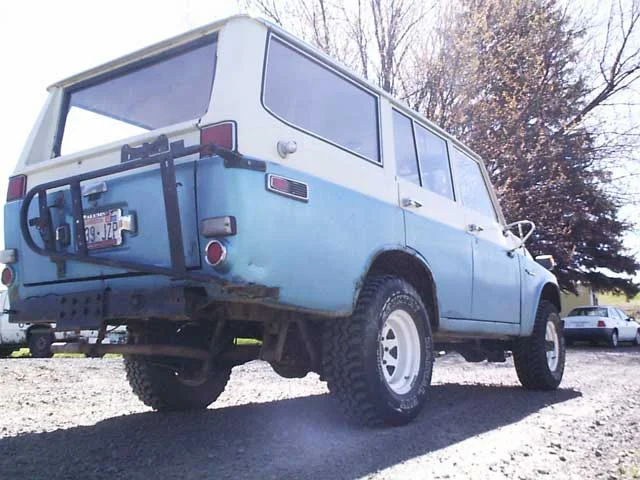

I had to do some tail light work when I had it and I ripped out some trailer wiring that was causing problems...
You mean this wiring? :rolleyes:
TJK
Can't believe that wiring could reach any obstacle after the spring over!
That tire carrier was a beauty.
