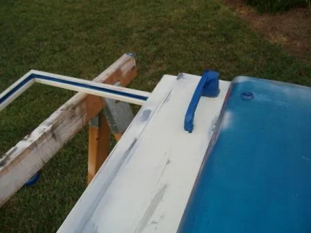

Pic 1) Holes from PPPPO installed mirrors w/ special high-tech duct tape backing

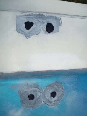

Pic 2) Holes in Pic 1 filled with POR Patch

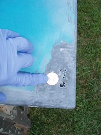

Pic 3) Rust holes at bottom rear corner of door - quarter for scale

Well - I still have mixed feelings about POR Patch. If you are patching pin holes and nothing larger then I think it is a good option. If you are patching anything larger you need to cut out the rust and weld in new metal. For all the holes you saw on my door except for two small pinholes in the lower corner the POR Patch sucked. I had to grind off a bunch of the POR Patch and what was left was filled with air pockets....not good.

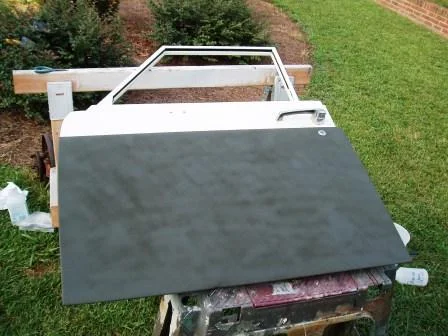

I felt bad for not posting up any pics so I ran out and grabbed some.
Pic 1) Driver's front door. Note the green looks 'blotchy.' The same thing happened w/ my fenders. I hit them lightly w/ a green Scotchbrite pad and it then looks nice and even.

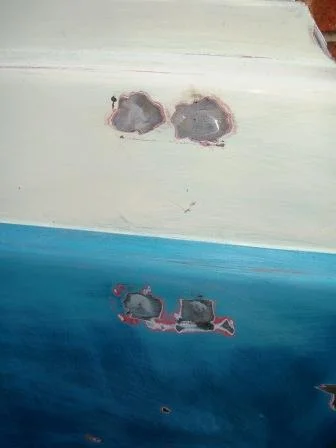

Pic 2) Holes in passenger's front door from PPPO's van-style mirrors. Welding these shut was 1000 times easier than using POR Patch on large holes.

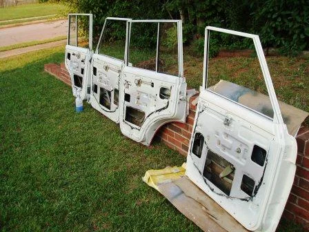

Well whadaya know I was able to take most of the day off. I only got about 5 hours in on the Piggie between the dogs, work and an insulation contractor coming by for a couple of hours to insulate the attic above the garage - its much cooler now.

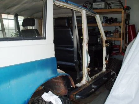

I spent my time on the Piggie working on the doors. The driver's front door is painted and ready to be reassembled. All of the other three doors are stripped, sanded and prepped for application of POR. See da pic! I hope to slap some POR on these tomorrow afternoon and then start with the ODG/white paint later in the week.
Before I reattach the doors I am going to sand the A, B and C pillars and slather on some POR as best I can.
