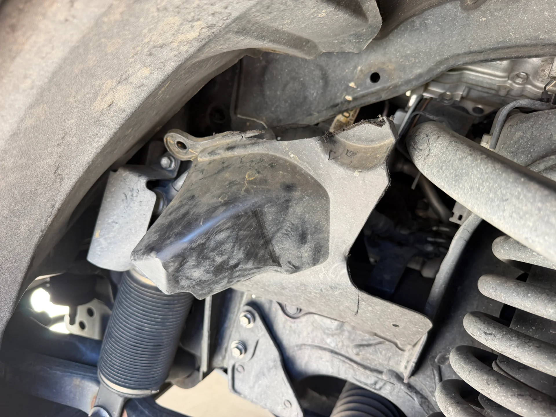

I'm looking for some help identifying a wheel well splash guard. This is on a 2021 LC HE, drivers side front wheel well. See photos below. I believe this was not properly re-set after some suspension work. Notice one of the tabs has been worn off while rubbing on the tire. Also, any idea what fasteners should be used to attach it.
I'm looking for some help identifying a wheel well splash guard. This is on a 2021 LC HE, drivers side front wheel well. See photos below. I believe this was not properly re-set after some suspension work. Notice one of the tabs has been worn off while rubbing on the tire. Also, any idea what fasteners should be used to attach it. View attachment 4167466View attachment 4167465
5378260040 - PACKING, FRONT FENDER APRON TRIM, B (it appears it comes with the white clips installed)
9046712069 - CLIP (WHITE)
9046710210 - CLIP (BLACK)
Edit: Links are just for illustration purposes. I usually buy from US based dealer.
