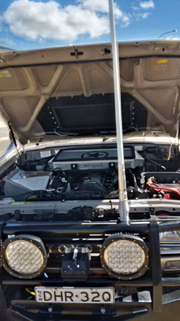

I've been very happy with my Moonlight Airbox - crazy fast spool with that and a Hallman and awesome induction noise!
So you went with a 4" inlet pipe from your Moonlight snorkel, correct?

That's right, 4" snorkel, 4" into airbox, 4" out o airbox and reducing to 3" to suit the turbo with an elbow. I could have kept my old snorkel, they offer a reducer to do that but I was worried about the snorkel flowing well enough so I went 4".

I have have just received a moonlight fab airbox for my gturbo gx 1hdt. I am yet to install or order a snorkel, but I intend to go with a safari.
With a custom airbox and/or a snorkel the factory resonator inside the front guard is discarded.
If I install the airbox without a snorkel for now, I will extend the airbox inlet to draw air through the inside of the front guard.
Do I need to consider anything else besides induction noise when running sans resonator and sans snorkle?
