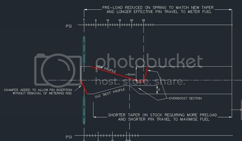

I don't see any benefit to retaining any over-boost functionality. Mainly for the same reasons as using a large flat spot on the deep section of the taper - It sacrifices anreoid travel and therefore makes the useful taper shorter.
I had not thought about a progressive rate spring, It's a good Idea. I will have to see what the taper looks like in the end to see whether that would be beneficial or just a slightly stiffer spring.

I found this yesterday for the 1HD-T and didn't see it posted here. Thoughts?

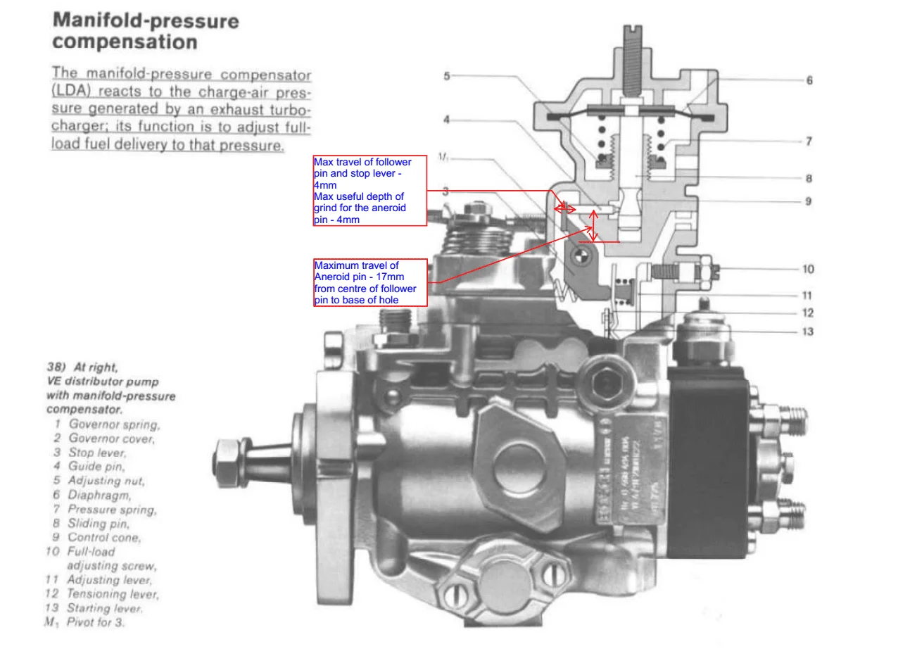

From measurements I've done so far, the pin profile in red in the drawing above is largely useless.
The taper starts too far up the pin, this reduces the useable length of taper available. also, the aneroid pin cannot travel deep enough into the housing to use the full length of the suggested taper in red. the aneroid will bottom out before the follower pin gets to the full depth of the taper.
the taper is too deep. The follower pin, and the associated governor control lever inside the IP will run out of travel at approx 4-4.5mm depth. grinding the taper to 6mm is of no gain.
I've added some notes to the image from @vwluv10338 to try to clarify my comments. Id be interested to hear others thoughts, experiences with this.
@vwluv10388 , I'd be interested to know the source of the diagram you posted

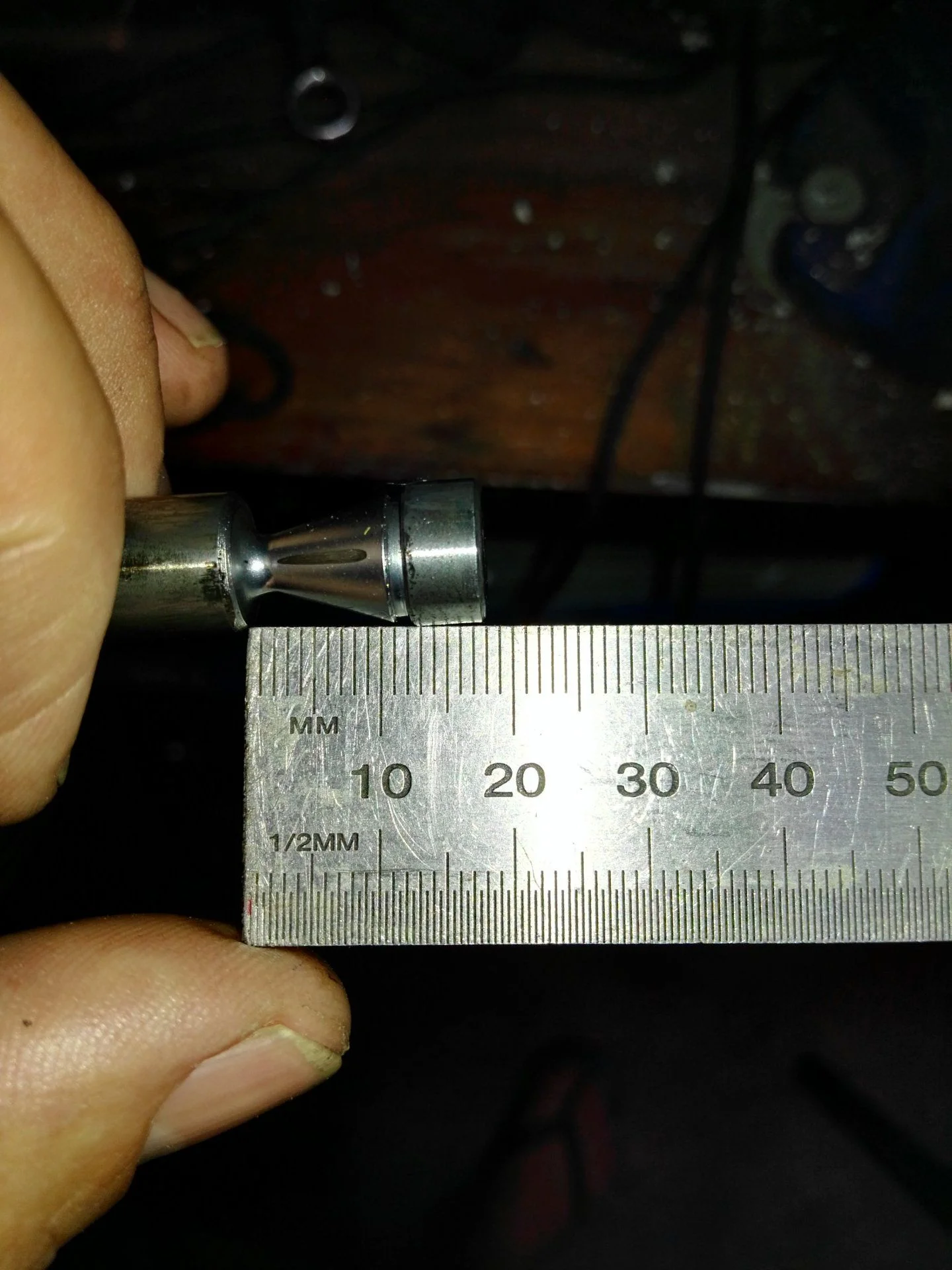

Pin pictured above shows the standard taper for this pin finishes at approx 19mm from end of pin.
The taper could have started 6-7mm further down the pin, or ~2mm from the end.

I initially didn't like the look of it. Looks too short a taper, but based on my measurements, I might be able to do something with it. I don't like the groove around the base of it.
The current grind on it has a max depth of about 3.5mm
