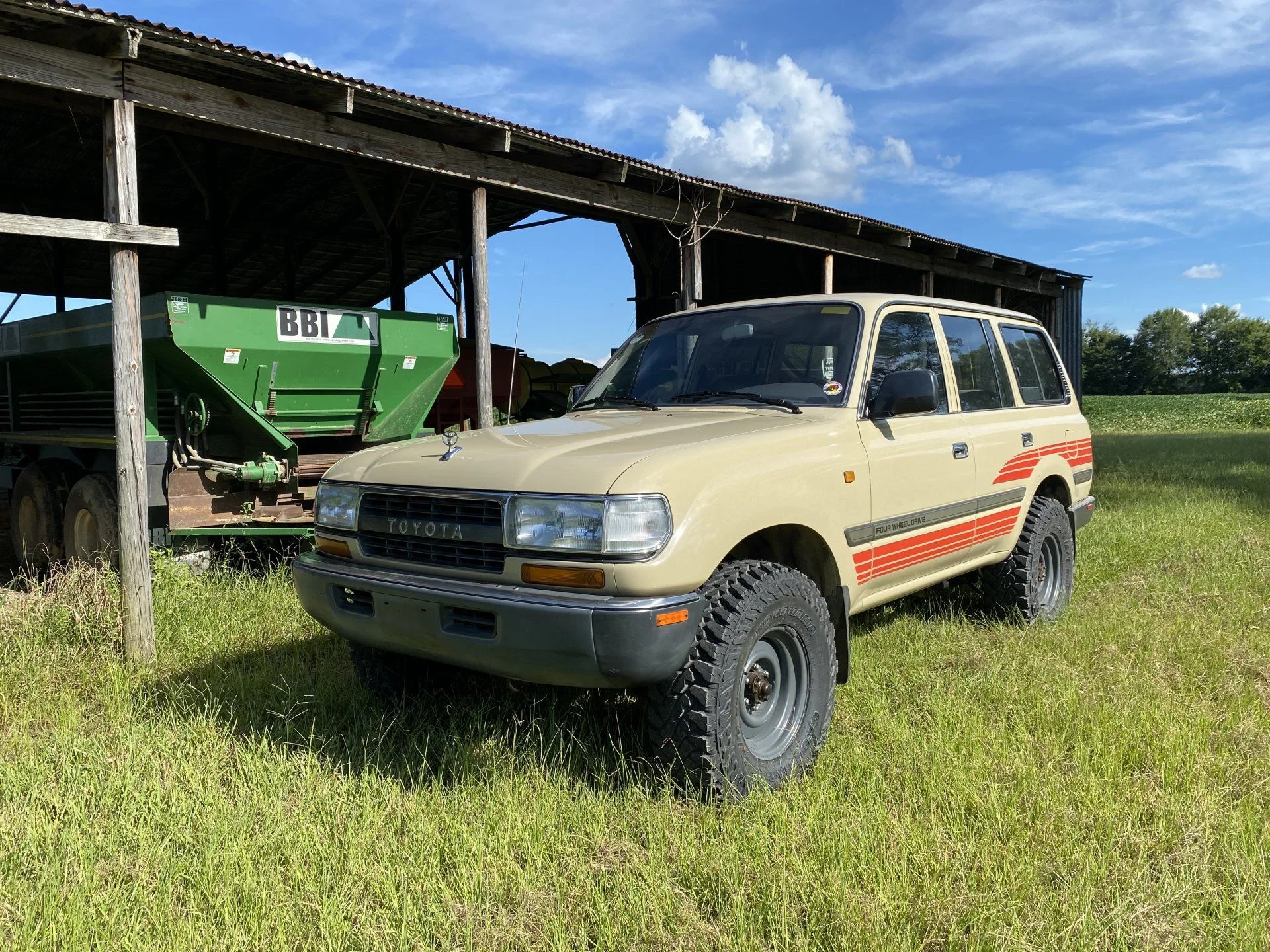

I need to go ahead and do hoses and such. May toss a radiator in it just to be safe. I really don’t like how crowded these engines are compared to a 2F but man. It’s pretty cool.

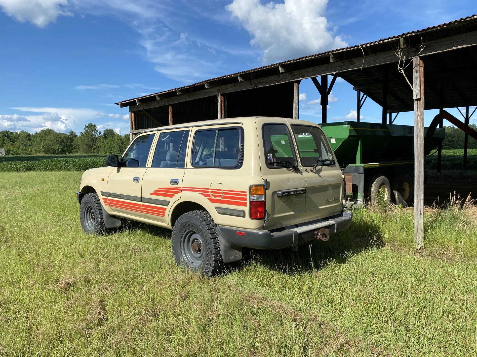

I love this quirky thing. It's looking awesome! Those double rear wipers are trippy.
Thanks man. I figured this one was worth all the grief I am taking over my usual 80 series trash talk.......

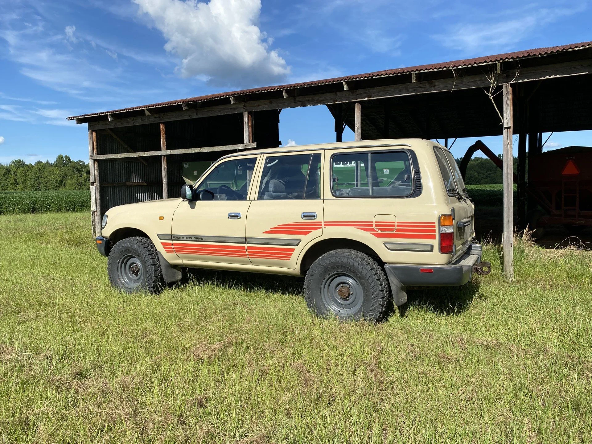

Took the OddBall80 for a road test today. All was going great until I got to the busiest intersection in town and it died.
Some bystander saw my old ass trying to push it out of the road and jumped in to help.
I fussed with it a bit and figured out my power source for the PowerSurge took a dump. I was using the relay from the old fuel pump.
I am going to get a new relay tomorrow and rewire it and try it again.
As for the drive....it runs really good. Once I get the bugs worked out this will be a hard one not to drive a lot.

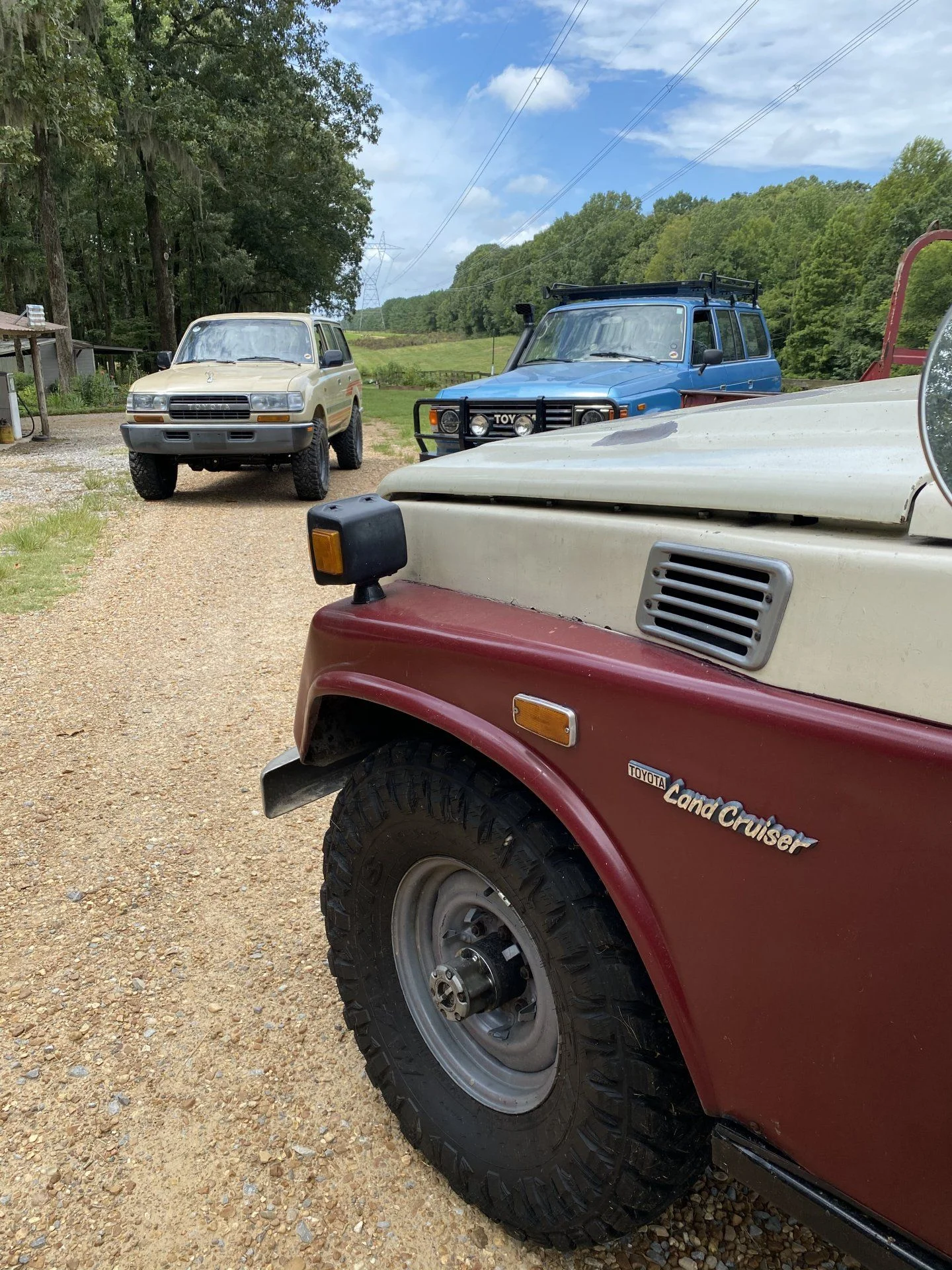

Got a Tilda Bogue family shot today after dusting off the 45 for a new project

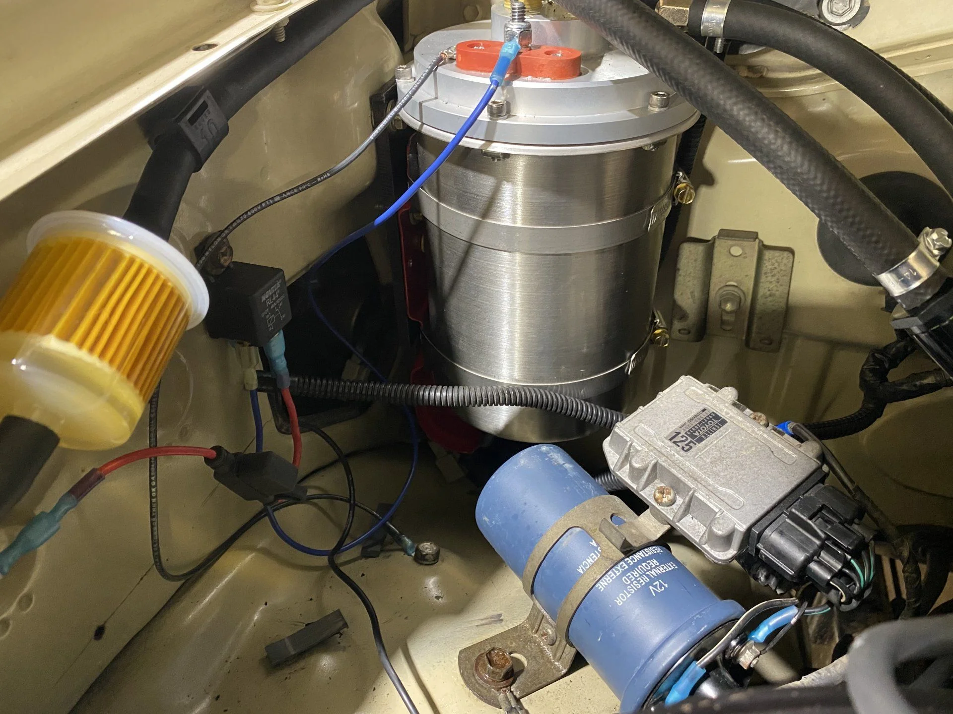

I rewired the ignition and fuel pump setup today. Someone got in there in the past and made a bit of a mess.
I added a new coil ..... this is a standard coil I had bought for a 72 FJ40.....
The chrome one was all jacked up.
Turns out the power wire I tapped into had an in-line fuse under the sheath. The fuse was only 10a and the pump needs a 20a fuse.
My bad. I should have seen that.
Should be good to go now.

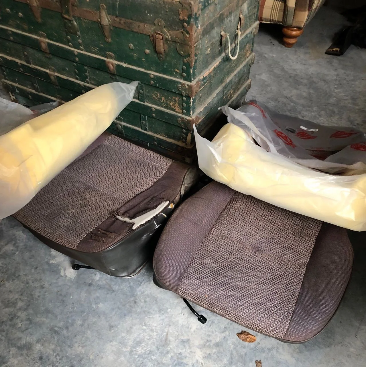

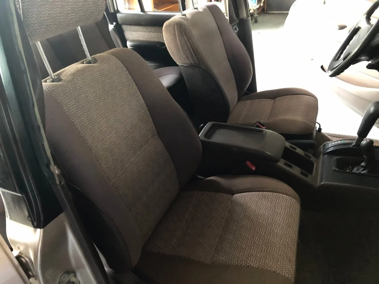

I really really like all the work you are doing. I know it is not high on your priority list yet, but when you are ready, I can recommend Spector Off Road FJ80 seat covers. They are very pricey but I splurged and bought two brown seat bottoms with new foam for my preservation project and they look great. I think your driver's side is a stock gray seat. Thankfully it looks like that odd ball passenger side is in good shape.

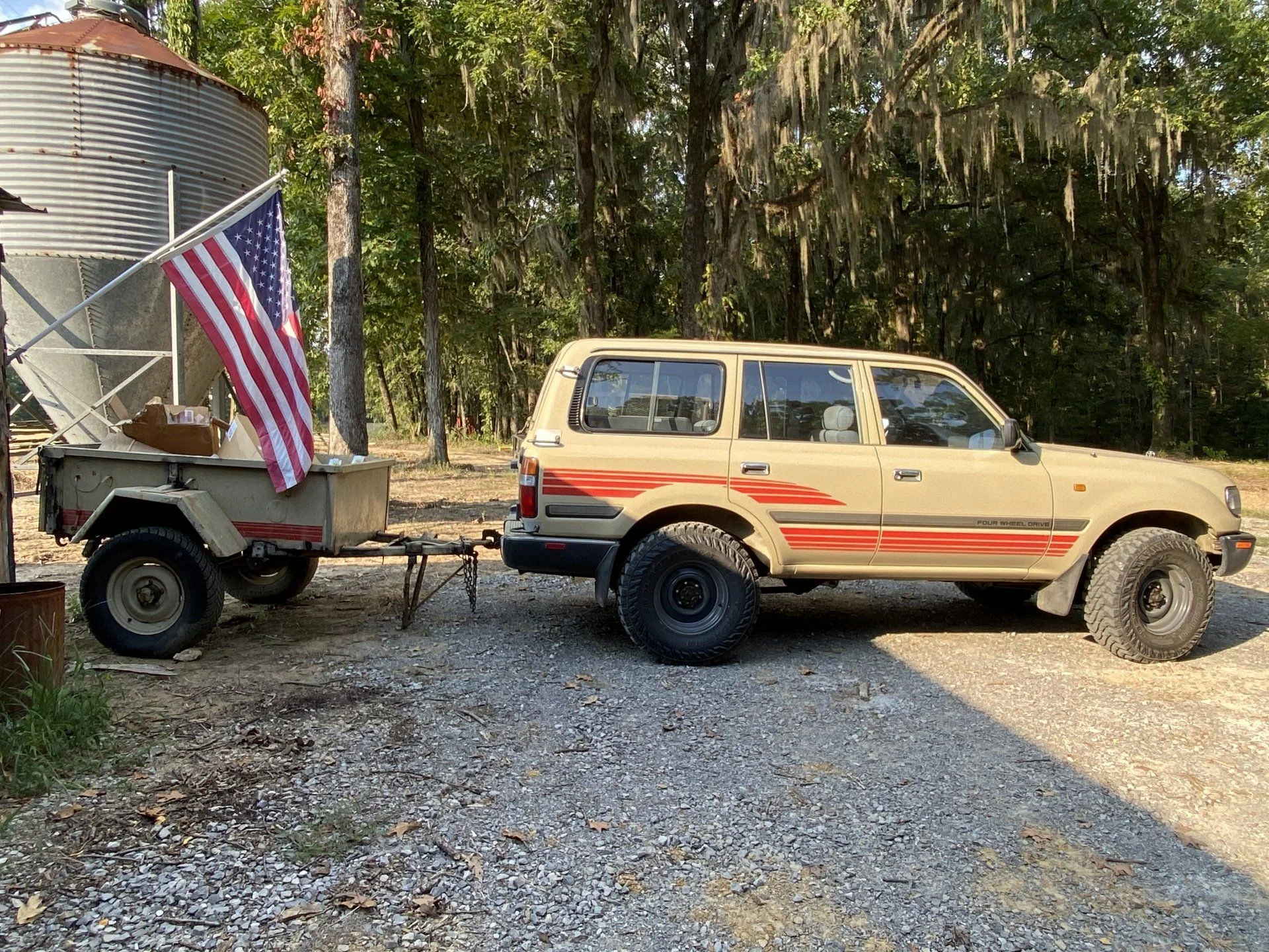

First time I’ve used the trailer since I got the lift and tires on. It sits mostly level to the truck now which makes me very happy. I hate a nose down trailer

I‘ve recently seen a few people parting out trucks with interiors matching yours. Only reason I know is because I’m debating on keeping the 80 I have with the same interior. You can probably find matching 3rd row seats with enough material to fix your driver’s seat bottom.
A little off topic, but is it that unusual to have an 80 without a sunroof? I’m new to the 80-series and know pretty much zero about these trucks.

Hooked up the trailer for a run to the dump and it was full of red wasps. I uploaded a whole can inside the channels on the tongue and now they are going for a ride
Such a great ride man.. Any plans to color match the trailer wheels?
