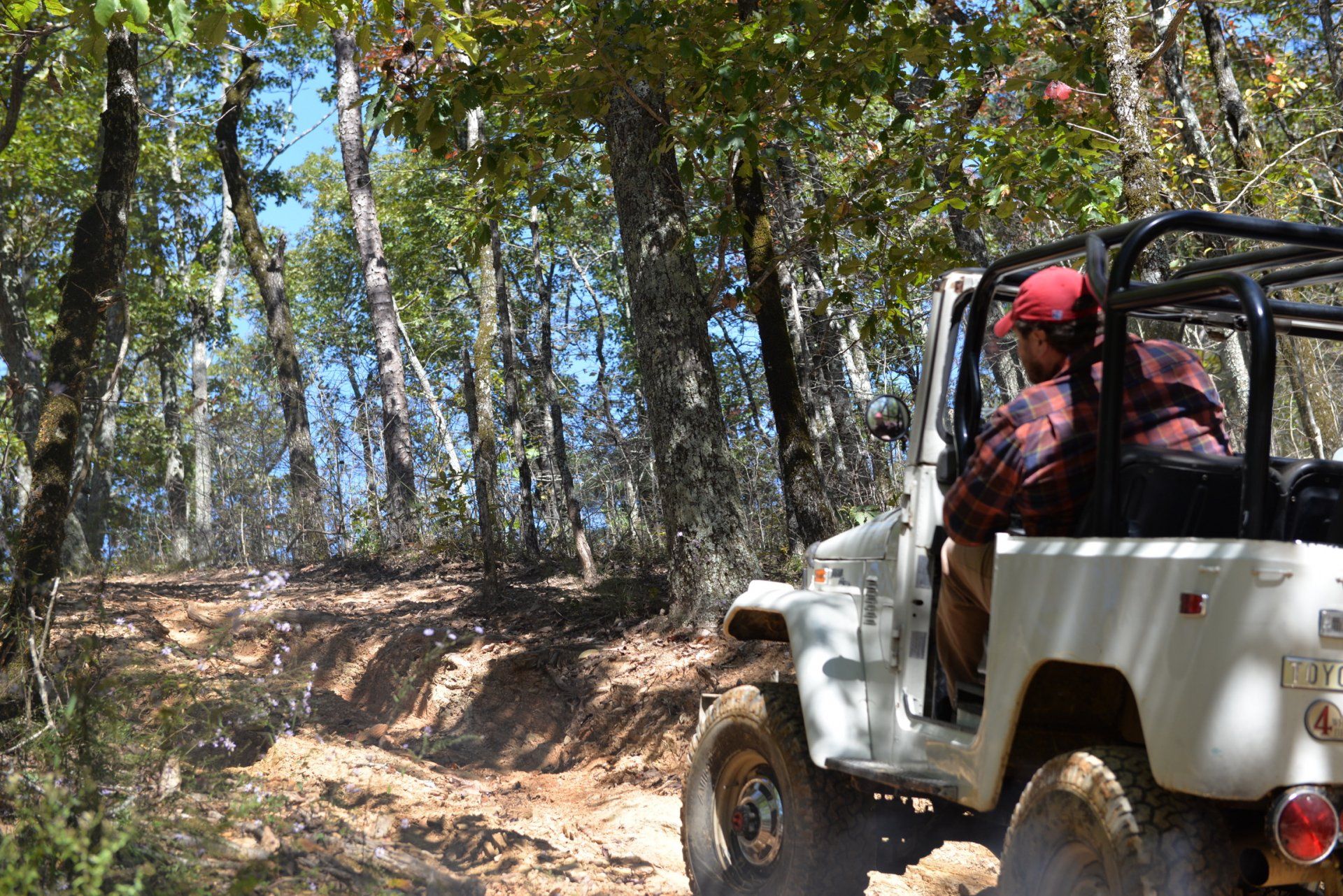

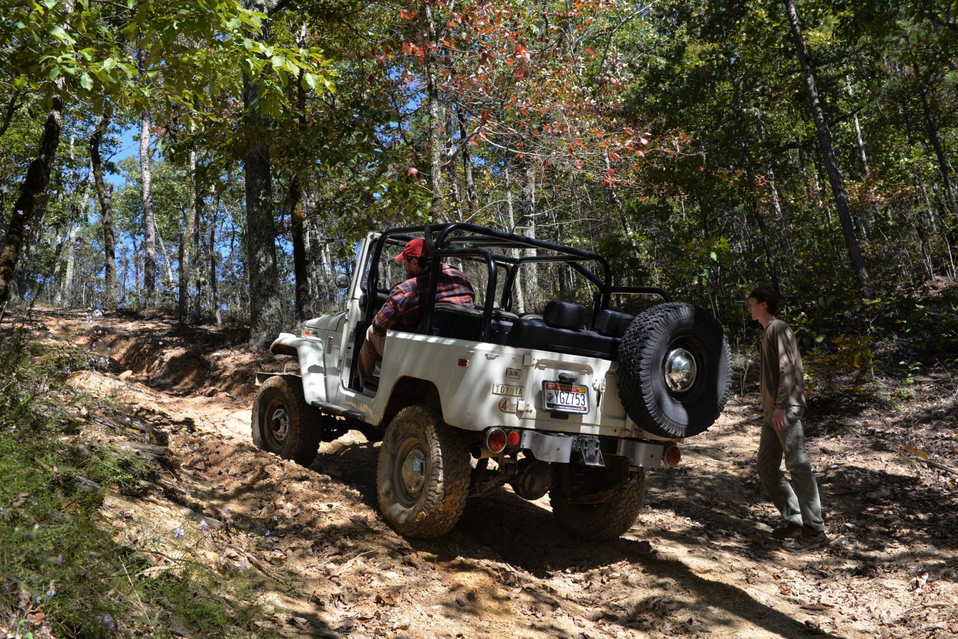

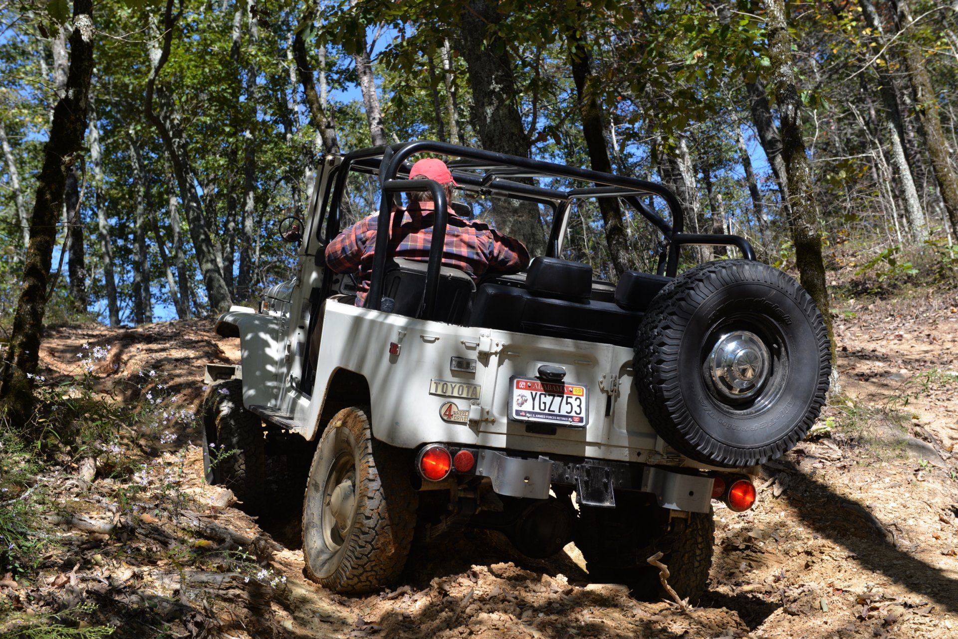

To keep this tech flavored: @orangefj45 built this Orion 4:1 and it DID NOT pop out of gear on a VERY steep downhill. Thanks @orangefj45! Additionally, the Spartan locker held up well to mild abuse and wheel spin. Finally, special thanks to @Bama4door for spotting and @girupb for the NSA qualified camera.
Pictures for attention:
Sizing up the hill climb.
Listening to my Sensei.
Luggin' and smokin'
Normally, this is how sh*t gets broken.
