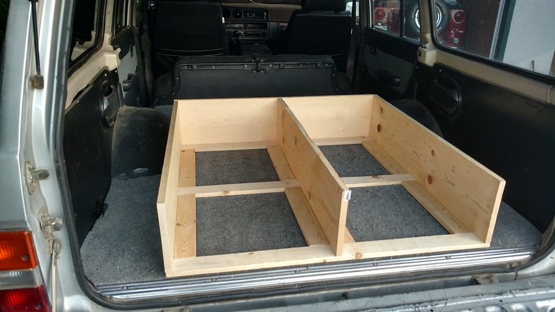

Progress...

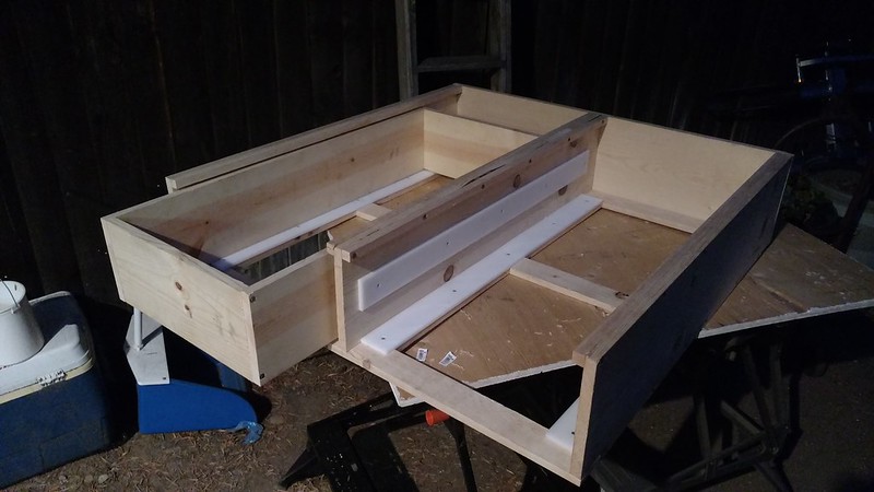

Got the main box built, the drawers framed and the HDPE slides put in place. The next steps will be to fit the top cladding to the countours of the 60's cargo area and build the floors of the drawers (going to wait until I can use the table saw at work to cut the thin plywood for the drawer bottoms).
Once all that is done I'll get started on the slide out sleeping platform portion.
I'm still not sure how I'm going to secure this whole thing down to the floor though, so if anyone has any ideas about that I'd love to hear them.
IMG_20170601_200547563_HDR by Darrell Vaughn, on Flickr
IMG_20170607_205245248 by Darrell Vaughn, on Flickr
Where did you source the HDPE and was it already those dimensions?
It was leftover stock at work from an old project they were working on before I got there. It was in 2.5" square bars and I ripped them down to 1/4" strips on a table saw.
