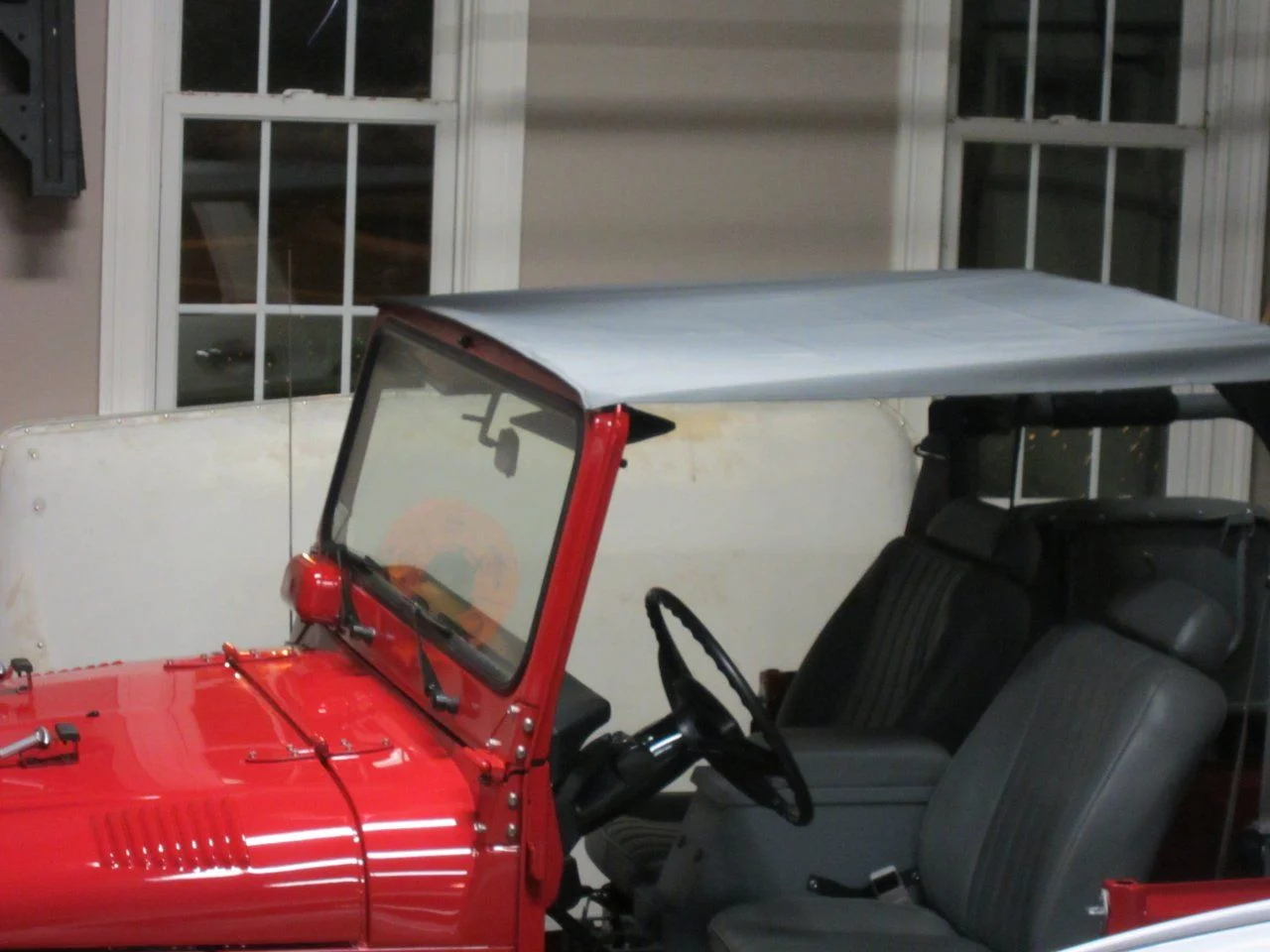

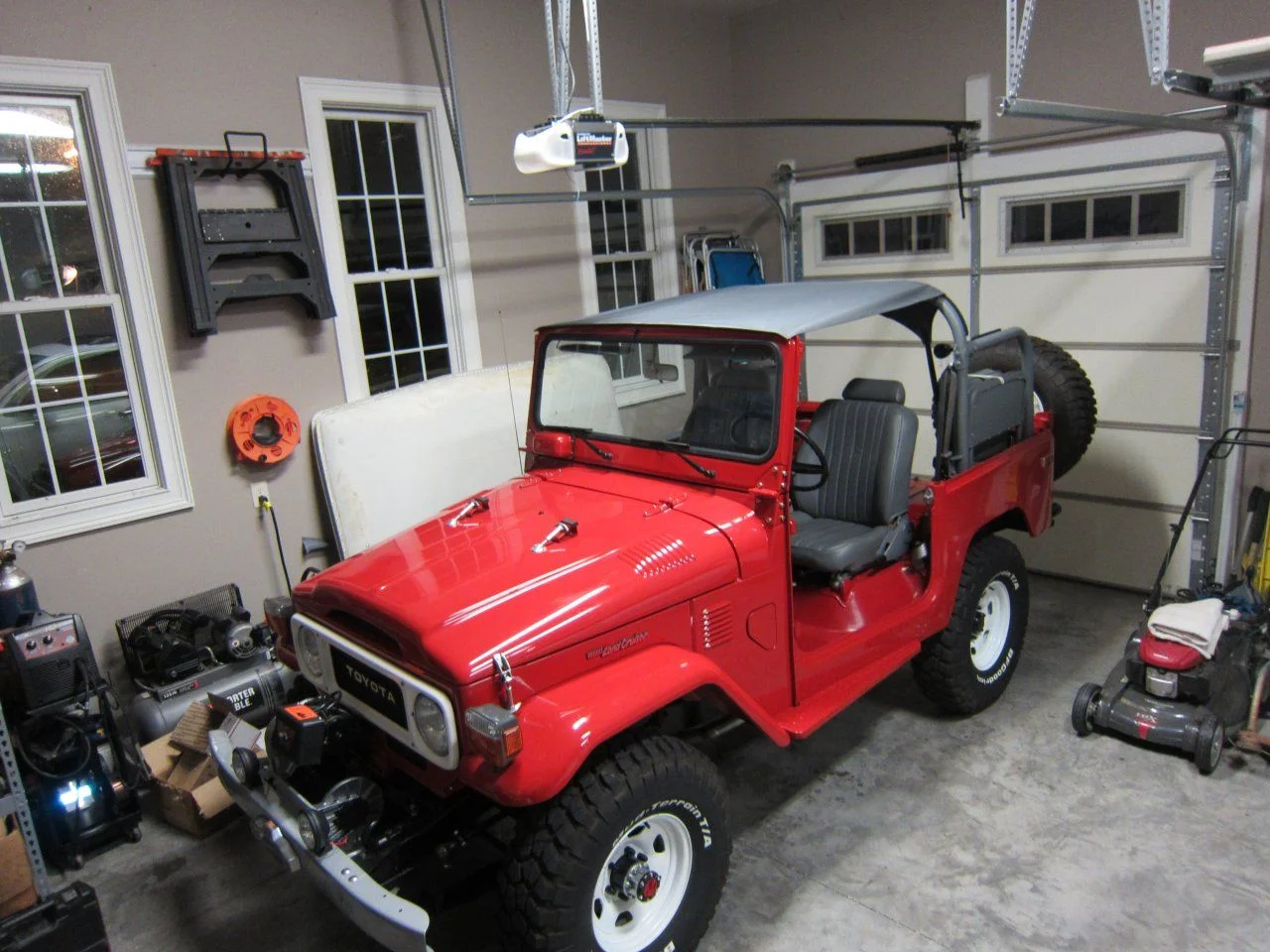

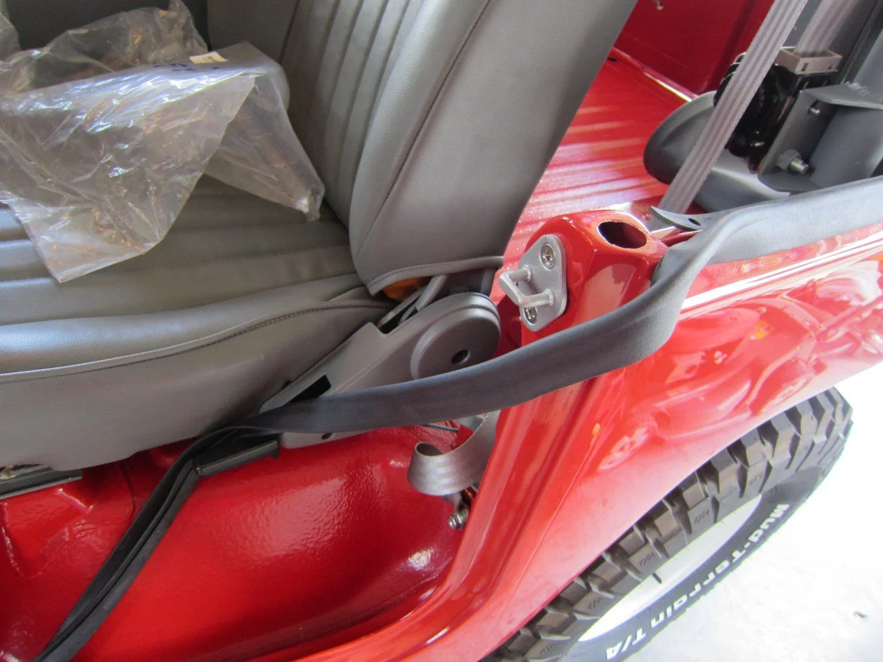

Fixed the rear diff cover leak. Then put the bikini top on. Not real sure where the rear straps are supposed to attach, but I am sure that I don't want to drill any holes for the footman loops that came with it.
When I was running a bikini top many years ago I put in footman loops on the tub rail ... The PO in me said it was ok to do :meh:

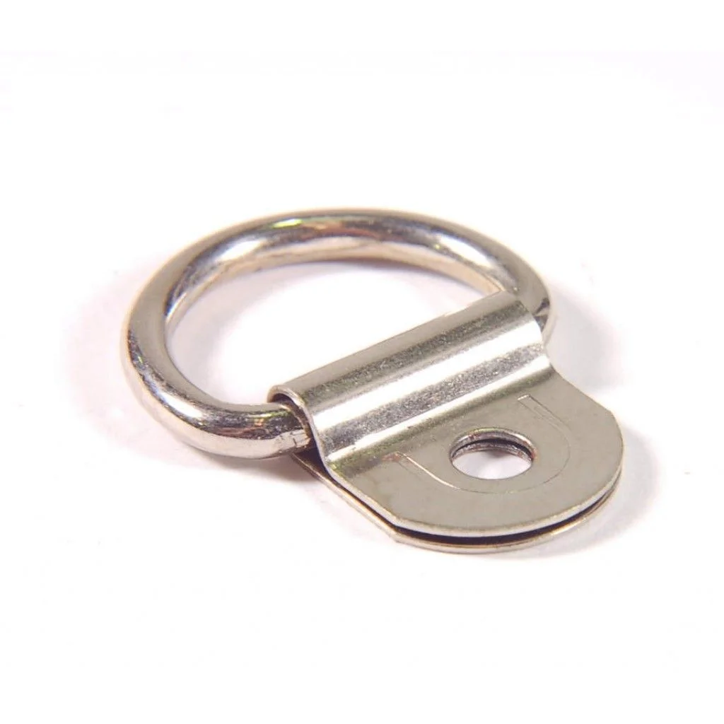

Less damaging .... you can get some D ring anchors ... Maybe about 1.5" ... You could bolt them to the hardtop capture nuts on the tub rail
See pic for the type of thing I'm talking about

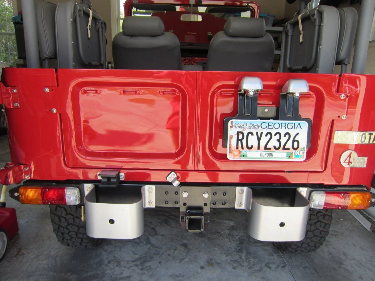

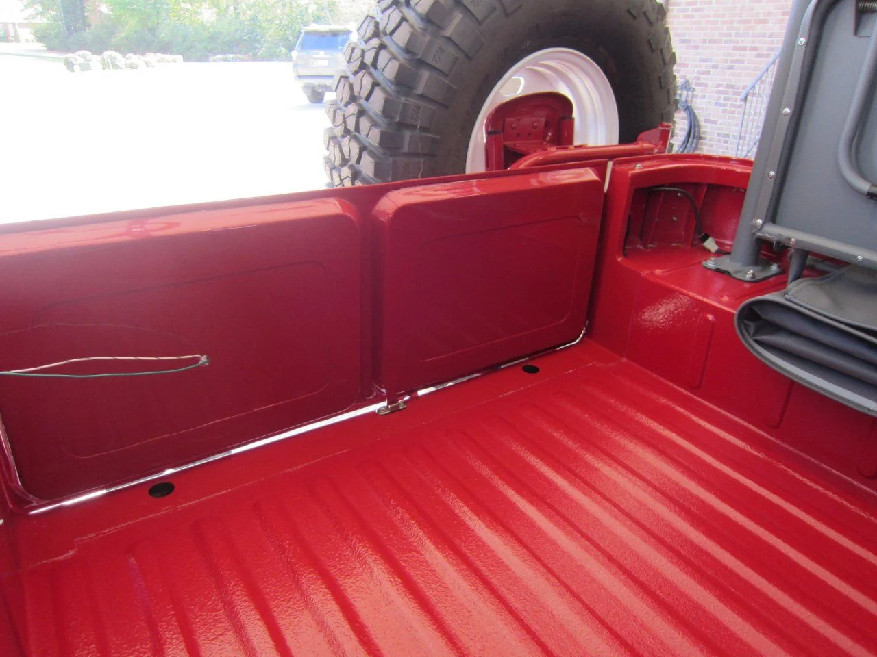

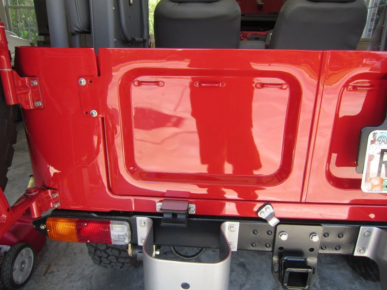

Installed the tailgate today. Welded together a set of barn doors. I like the tag here, where it is supposed to be.
^^ thank you.

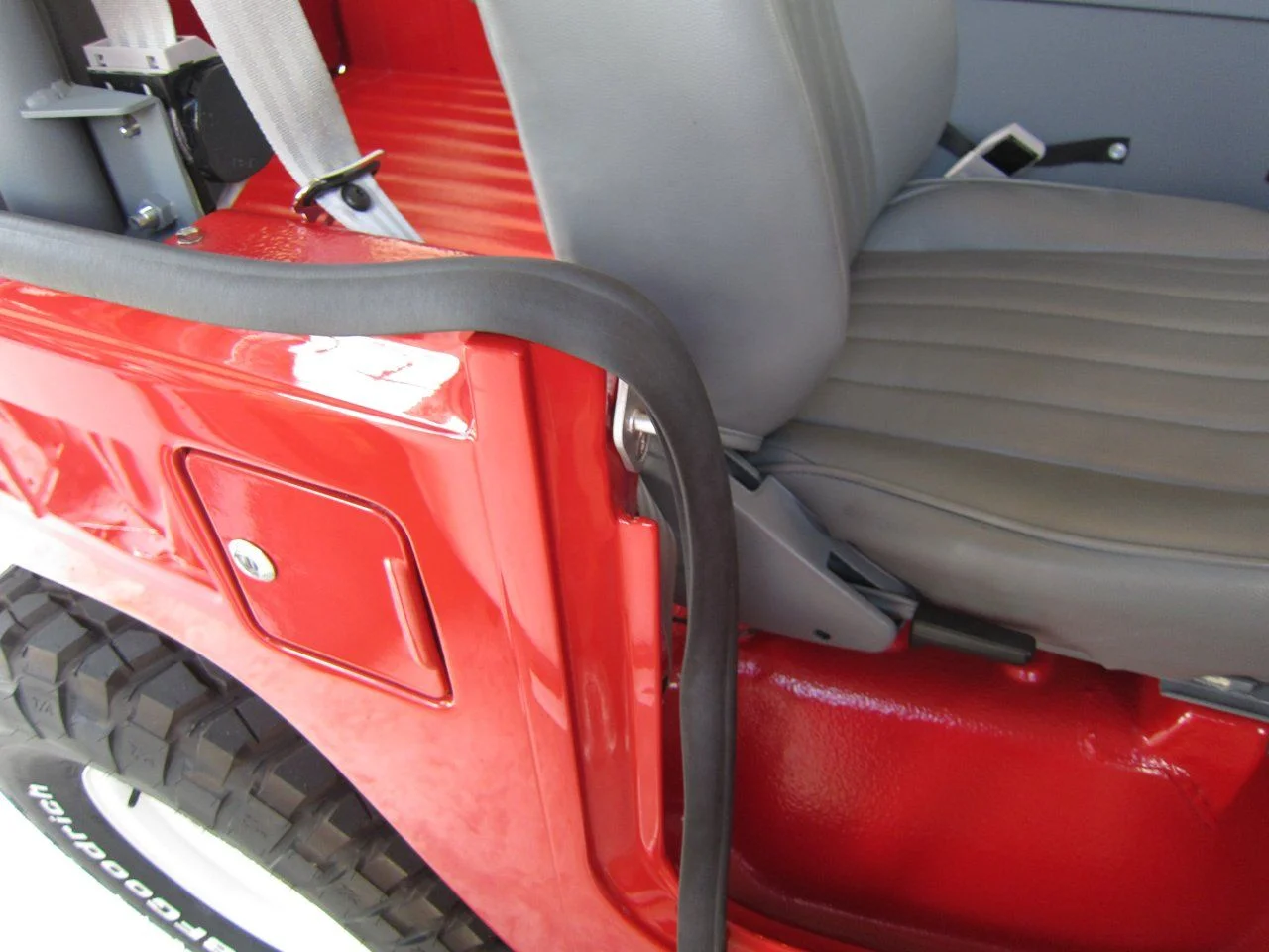

Also test fit the rear molding today. planning to set the top on one last time before I send it to paint. I assume this is way to long to accommodate the longer wheelbase trucks or even a troopy?

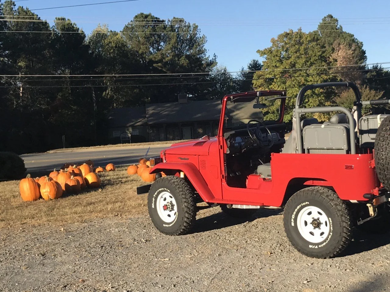

Took the front doors, rear doors, side panels & the pieces over the doors to the painter today.
Then took it pumpkin shopping.
