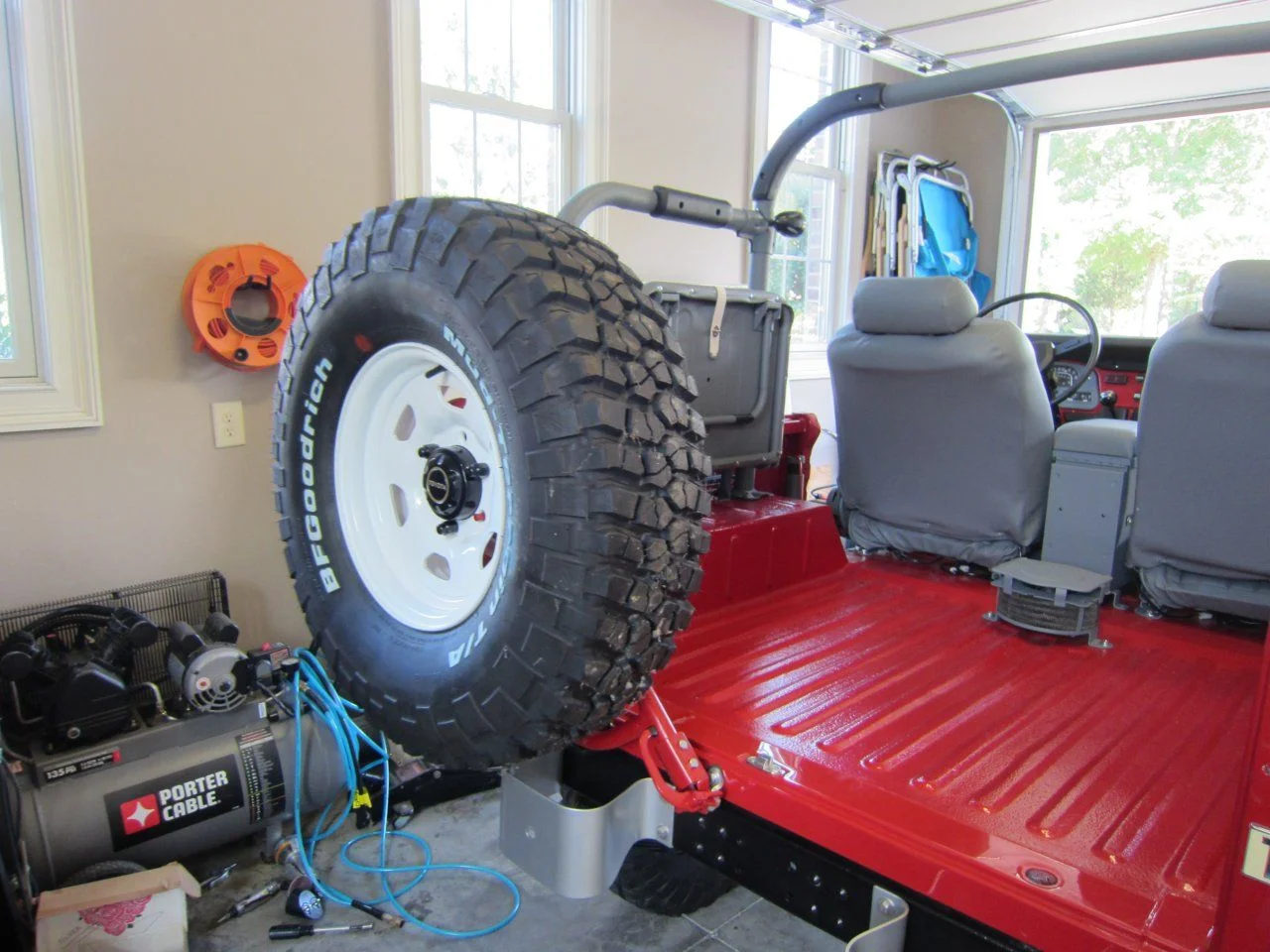

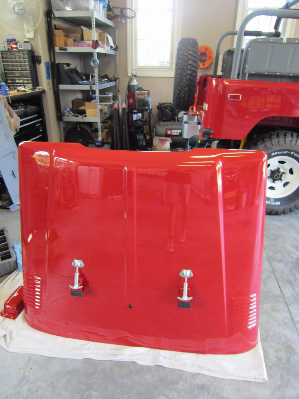

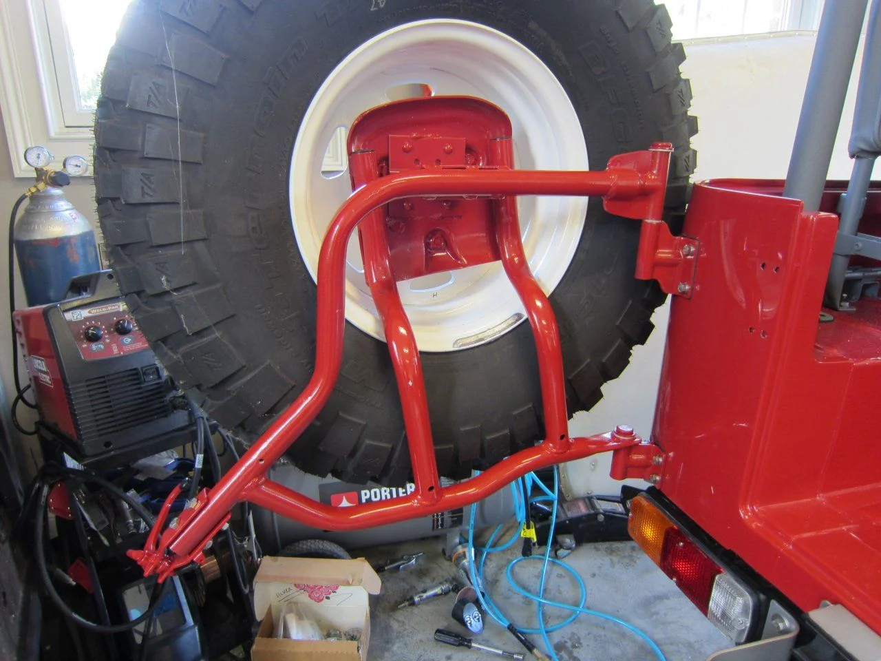

Moving along, I picked up the hood, spare tire carrier & windshield frame today along with hinges & various small parts. Tire carrier was a bitch to get the pins back in & I damaged the paint a little doing so. Grease & a BFH!! Easy touch up though.

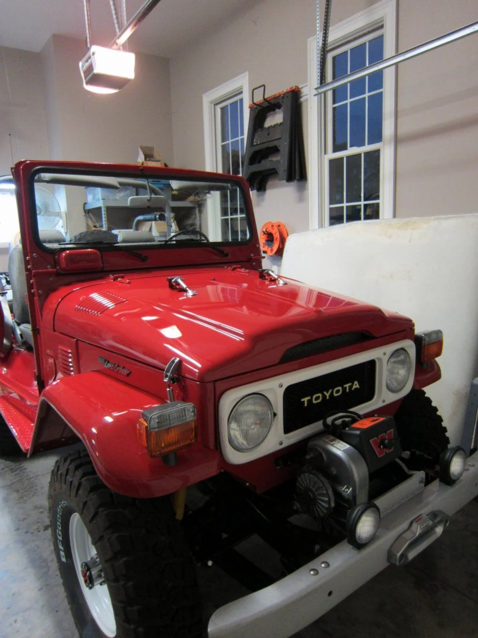

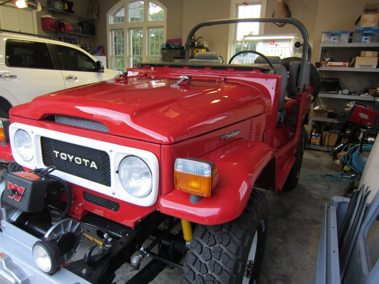

And a few with the hood installed. My painter forgot to paint the hood support rod so I'll add that later & the hood hold down latches.

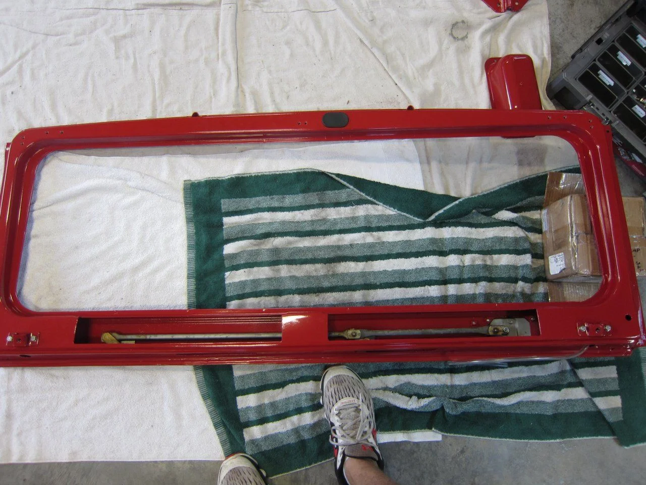

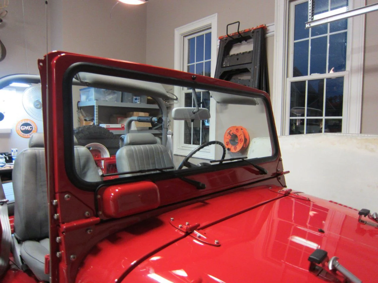

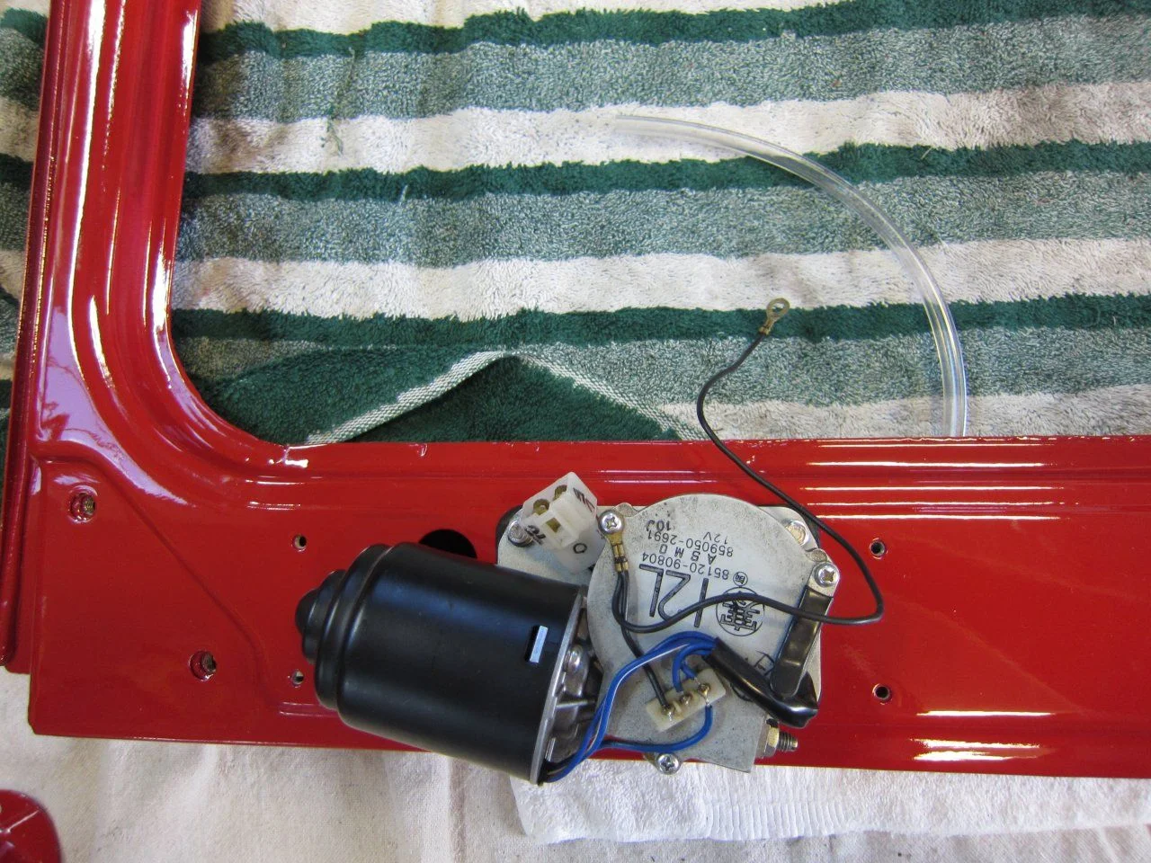

Put wiper linkage & motor on the frame today. Now, to get the glass installed.....
btw, where do I attach the ground wire coming off the motor??? One of the bolts for the motor cover??

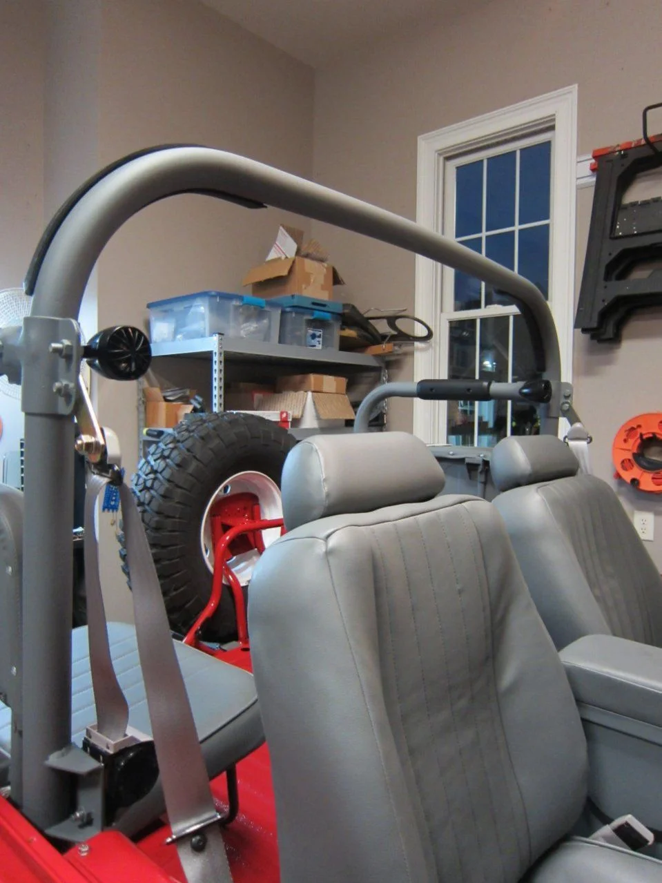

And seatbelts for the front. It's been a really good day. Had city police come by & fill out paperwork for a tag. Definitely not reported stolen...:)

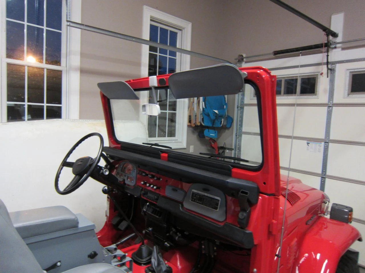

Did you instal the windshield yourself?
No, I chickened out! Decided it was cheaper in long run to pay local glass shop $60 to put it in, rather than break a $350 windshield.

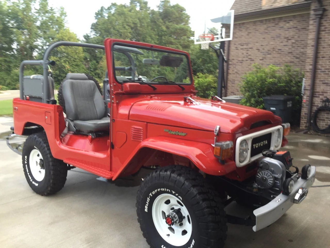

Mounted the tag & drove it around the neighborhood this evening. Still waiting on the new brake switch so I have no brake lights and didn't want to go too far.

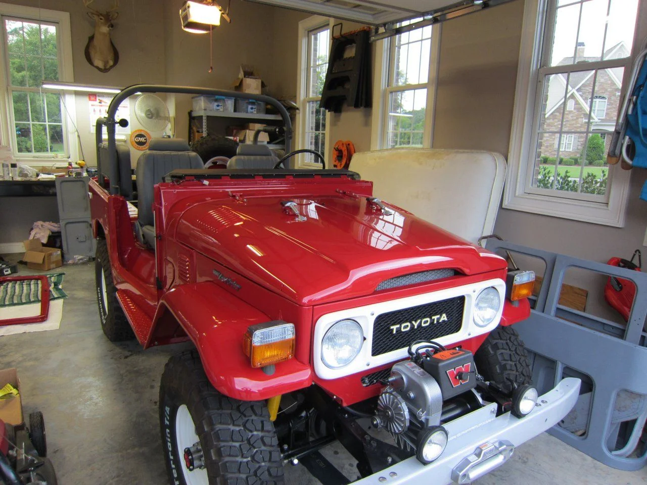

Good day today overall. I managed to get all of the gauges working and changed out the speedometer for an extra one I had. Everything seems to work. Carb cooling fan even kicked on today after I drove it around. Still have an idle issue, but overall it's in pretty good shape.
I went ahead and adjusted the toe out problem, it's now slightly toe in - amazed how much difference it makes in the feel of the steering.
I hesitate to even type this, but I think we have the carb issues worked out. Wouldn't idle, then wouldn't run at all, but only part of the time. Turns out there is a small metal screen in the carb & there was some gunk in it, basically not letting fuel into the bowl.
I drove it about 10 miles last night with no issues so hopefully it is good to go.
