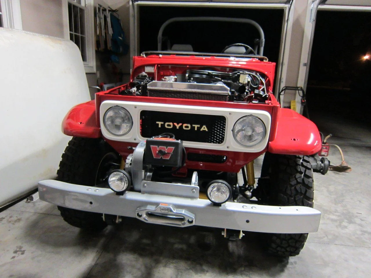

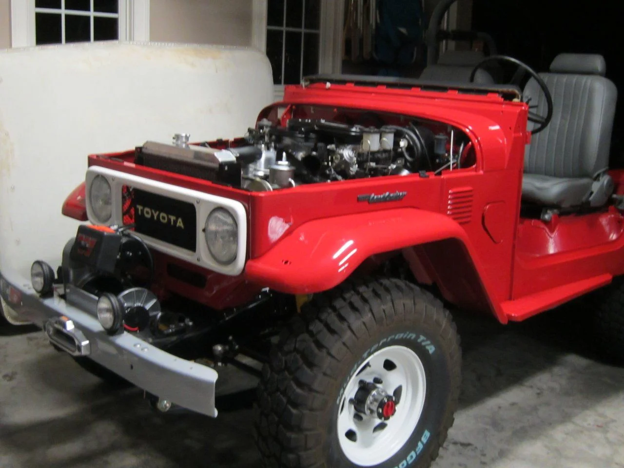

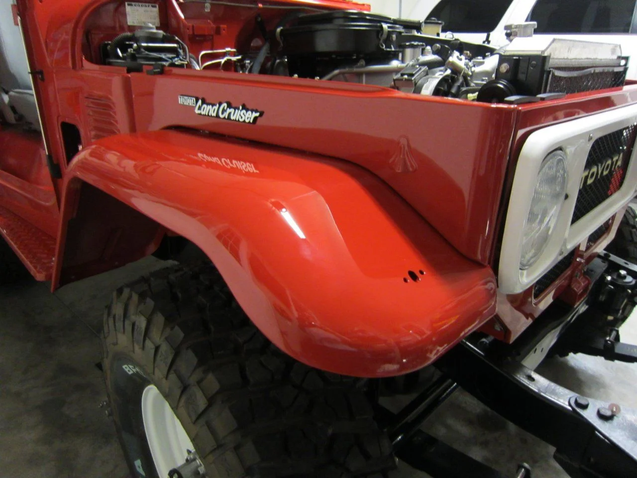

Now it is really starting to come together...
And I drove it for the first time ever... just off the tow dolly & into the garage as it didn't have fenders on it yet...but I drove it.

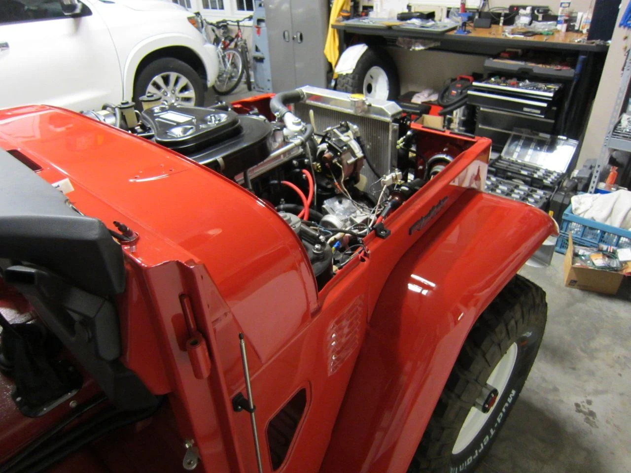

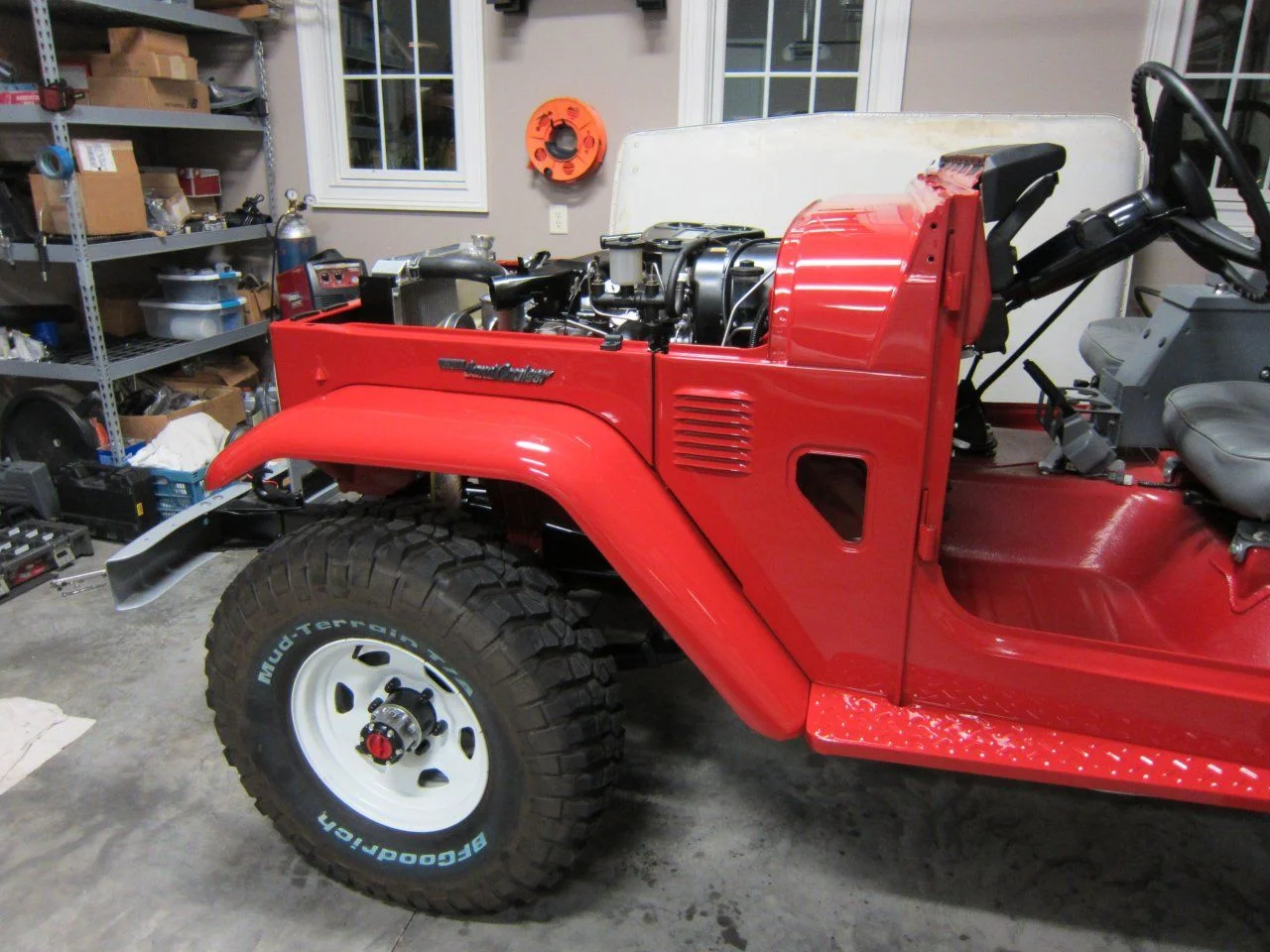

Few more.

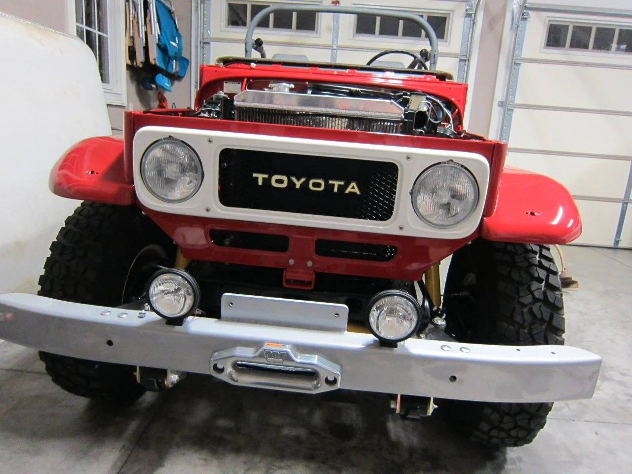

A few little things done. Gas door & lock, kick vents, etc. Winch installed too - that damn thing is heavy.

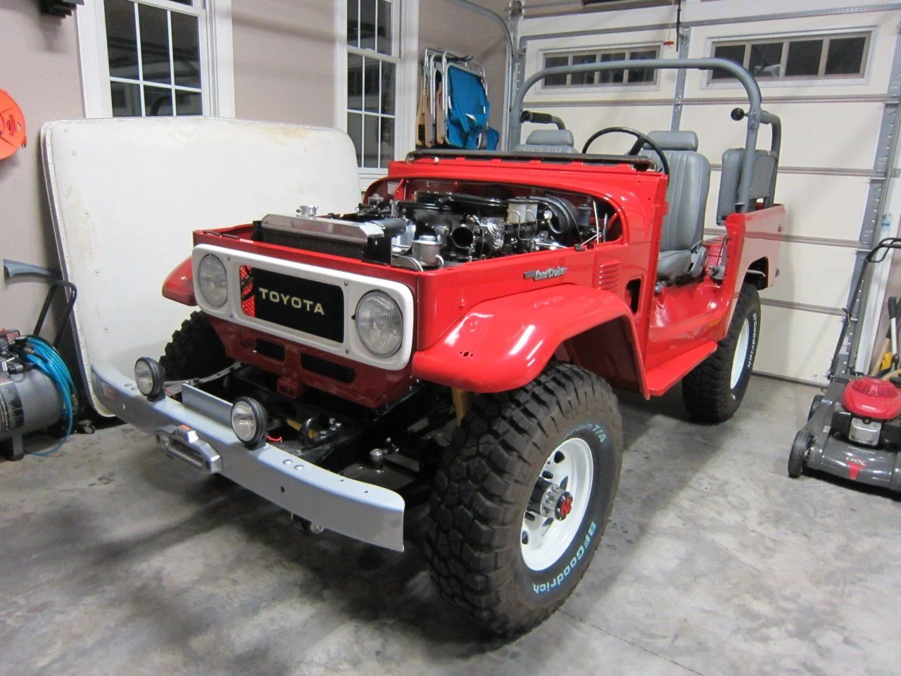

Thanks....been a long time getting here. Should pick up the hood, windshield frame, tire carrier & a few misc parts today from the painter. Slow, but at least some progress.

spill the beans.... your first post in this thread has a 2013 date. 3 years? As I look at my "To Do" list and my wallet2- 3 years seems about right. Our 40s were/are in very similar condition at the start line.......How much do you have in it and what percentage of the work did you do yourself?
Yeah, actually bought it in 2012 so it's been more like 4 years. I did all of the tear down and all of the rebuild. I've paid people to do powder coating and painting. Also paid to have the engine completely rebuilt. I've learned to weld, rebuilt a winch, installed the suspension, rebuilt the wiring harness (with help from Coolerman) and learned tons about this truck. As far as cost, I do have a running spreadsheet with all that info. For your protection and mine I'll have to keep that a secret. If my wife finds out I'm liable to be living with whoever tells her. ;) I've really tried to do everything "correctly" and not cut corners, etc. So I'm sure I will never get my labor out of it, but I have no doubt it is worth more than the true $ I have in it. But hey, I doubt an accountant's labor is worth much anyway.:cheers:
