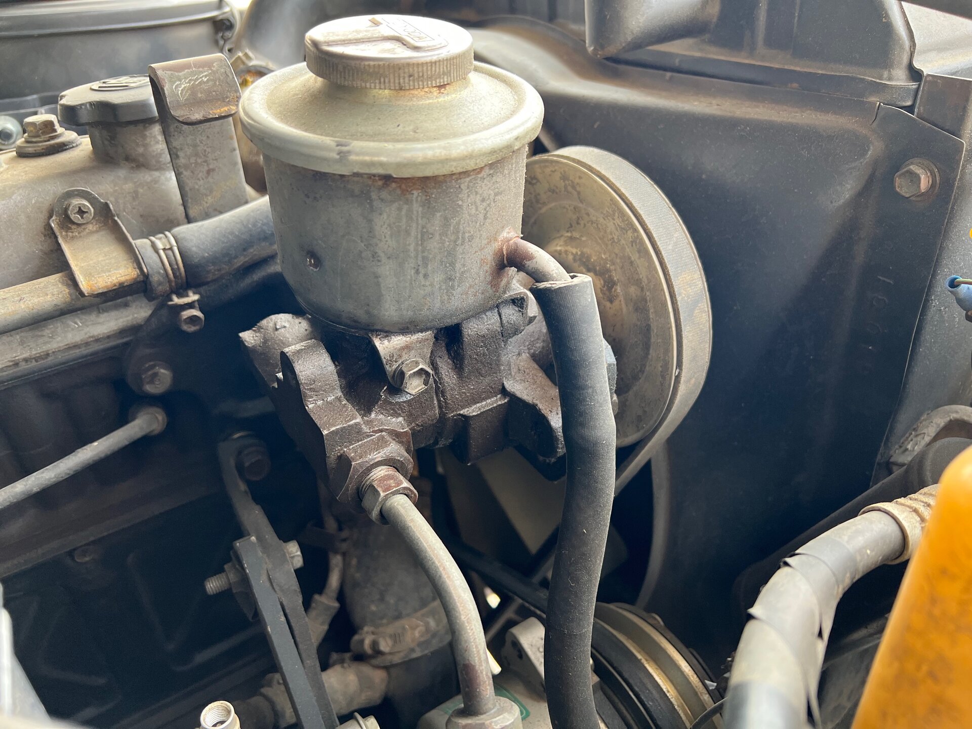

When I purchased the FJ40, the power steering pump did not work, but the previous owner provided me a new power steering pump. It matched a similar unit I installed on my FJ45. Only visible difference is the connection point of the discharge connection on the pump. Current installed unit (below)
Discharge connection point is on the side; while the new unit is on the back
I think its basically the same unit; would like second opinion?
I believe you can swap the reservoir from the old one to the new one.
Do you have the part number of the new pump?
