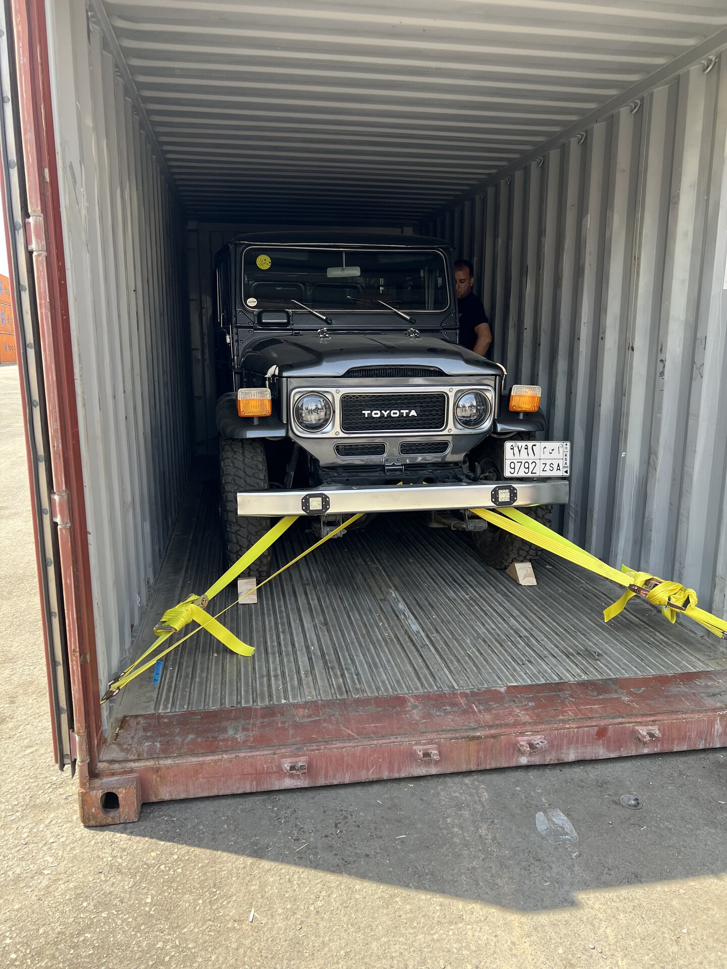

But was out of time...as it was time to pack ...
Strapped in and off to Toronto!!!
