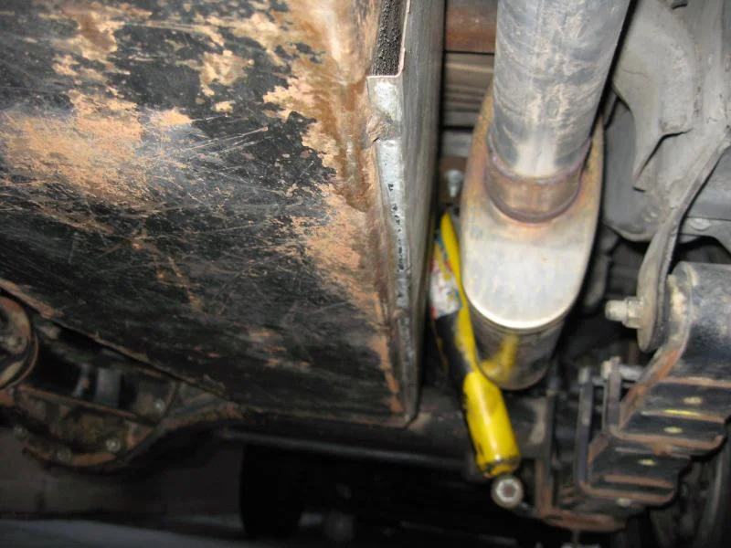

My exhaust runs about the same as the stock 2f does. I have a flowmanster 50 (I think a 50?) turned on it's side to clear my saddle tank. The tail pipe exits just behind the rear of drivers tire mudflap. If you look at the first picture showing the tank, you can see the muffler on edge near the spring perch.
Mt second tank is an 19 gallon saddle tank from Australia. I found 2 and sold the other one a long time ago. These tanks work well and you can keep your spare tire in the stock location too.

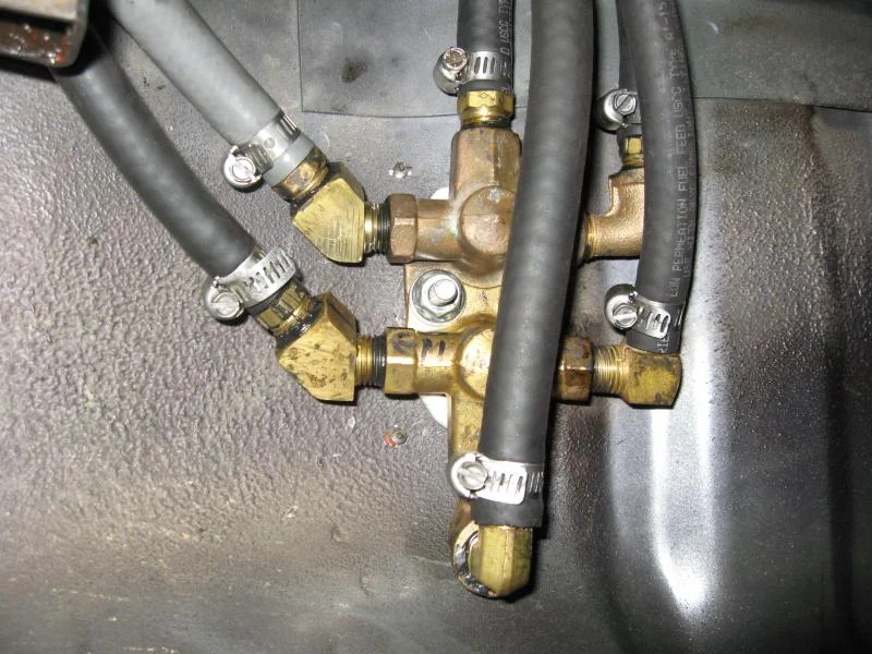

Both tanks have their supply and return lines plumbed to manual fuel valves I mounted in front of the drivers seat. Just switch to change tanks.

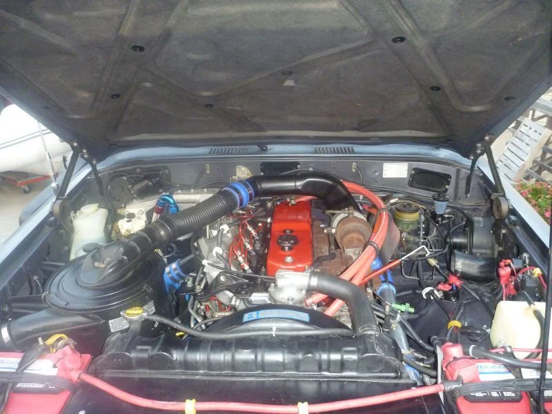

Batteries, I run two batteries in my swap. They are DuraLast Golds, group 24's in parallel and rated at 750/935 CCA. This set up spins the engine fast for quick starts and the GP's seem nice and hot.
I have had good luck with these batteries. One was weak after about 18 months and I explained my install and how both batteries should be changed out, and they exchanged both both for free!
Here a picture of my install.
