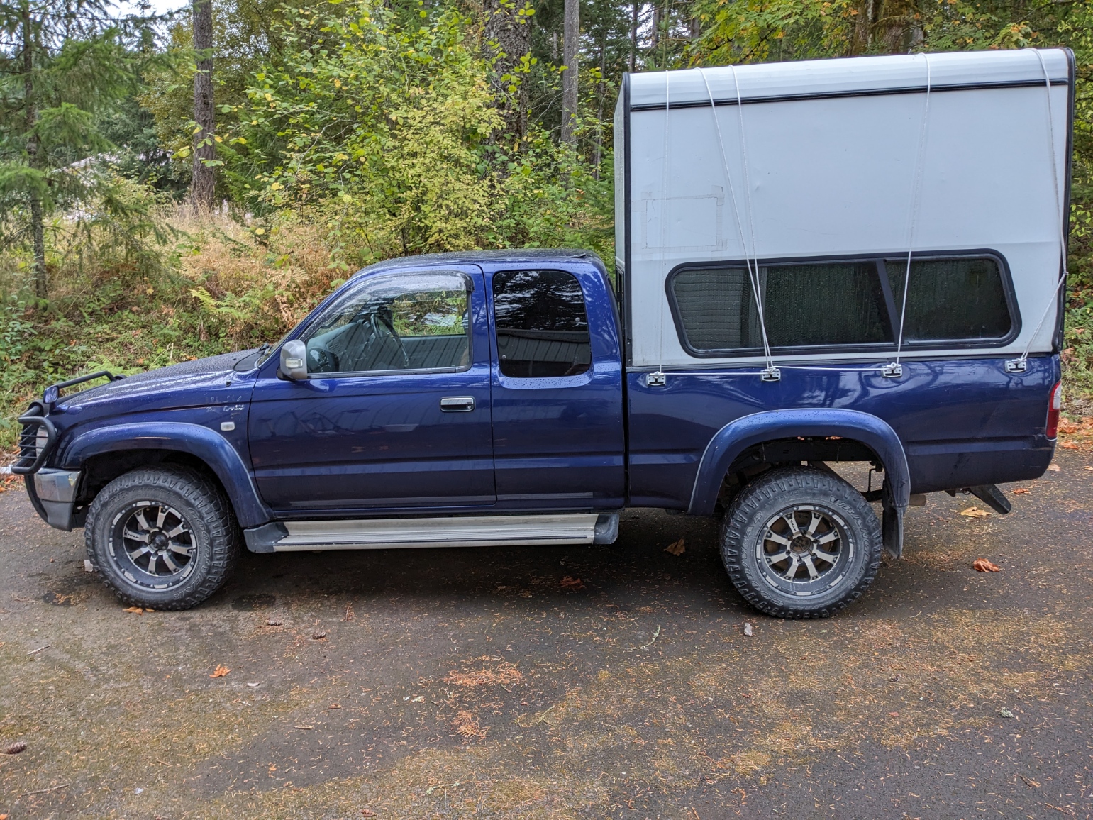

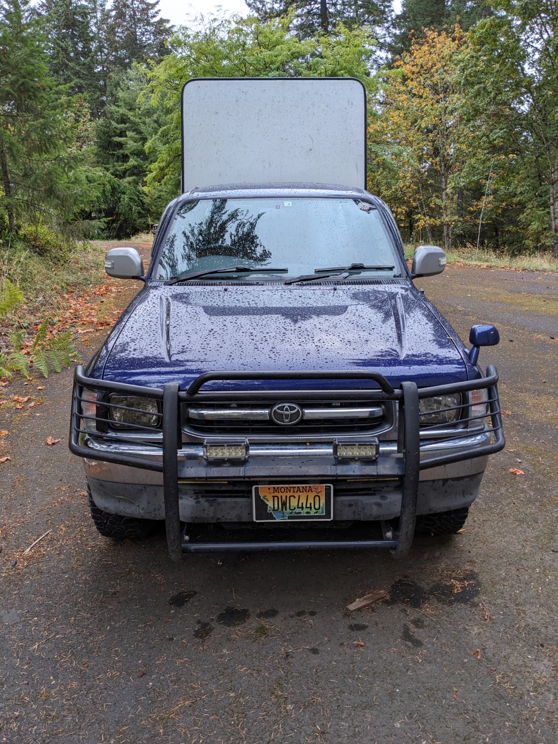

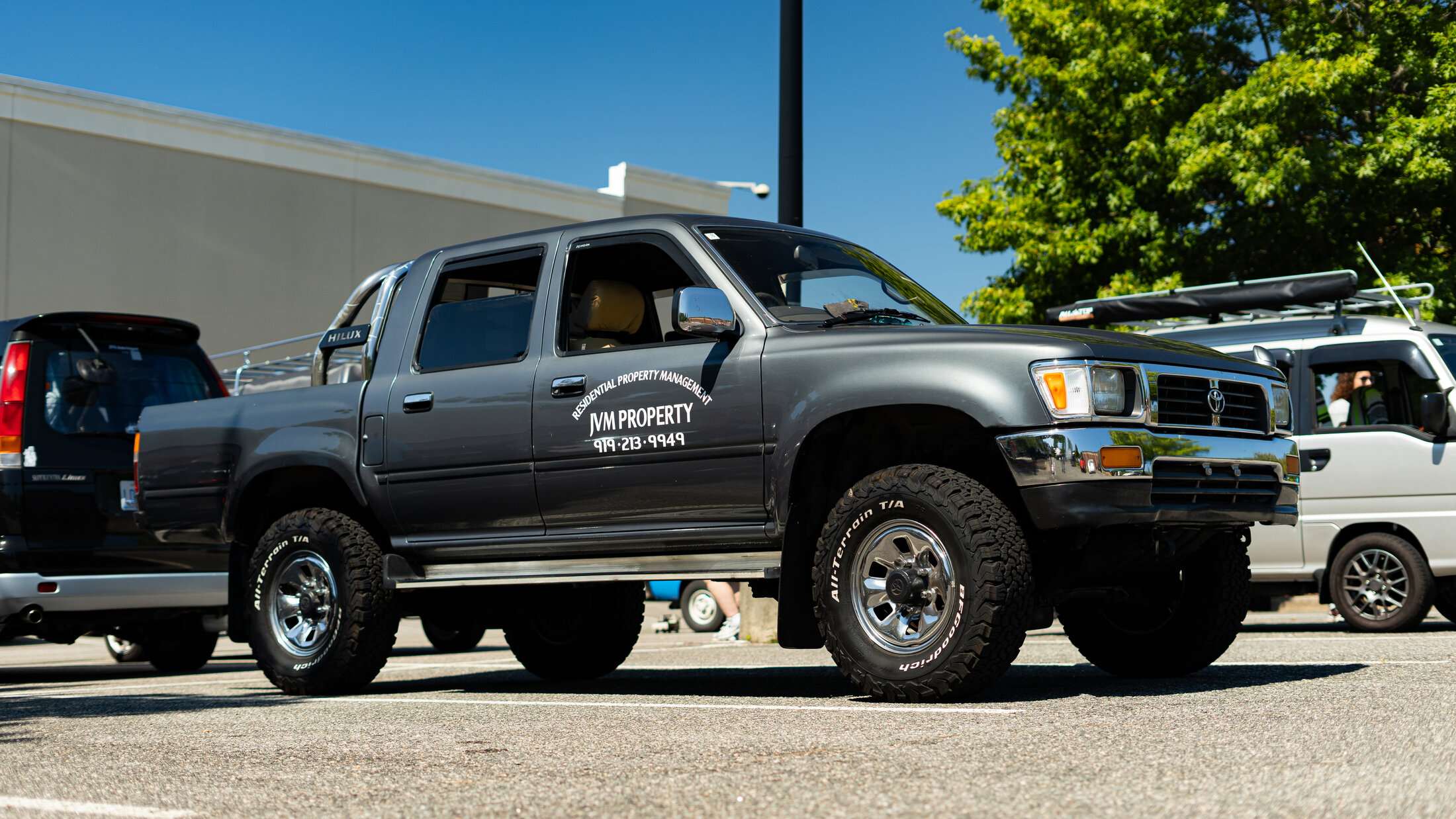

Rare(? - almost all '90s era Hilux 4WDs I've seen for sale have been double or regular cabs, usually the former) Xcab '98 Hilux w/5L diesel. Imported last year.
And yes, the monster canopy came with it at no extra cost - I do actually have a use for a canopy of that size (hauling a dirt bike or ATV out of sight). Picked it up last week in Montana and drove it home. I had to tie down the canopy because the clamps wouldn't hold it down at freeway speeds.
My first chore is to get the canopy off for now, then sell my US config pickup to fund mods for the Hilux (first new suspension - the shocks are worn out, then either a turbo or locking diffs - not sure which one first). Lot's of cobbled wiring for gauges, lights, cams, etc - I will tear most of that out.
Body is mostly in good shape (one smallish dent on passenger rear bed corner, and clear coat faded/worn on hood and top of cab), no rust underneath.
