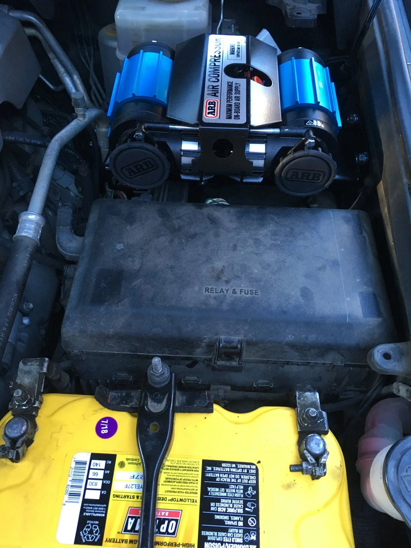

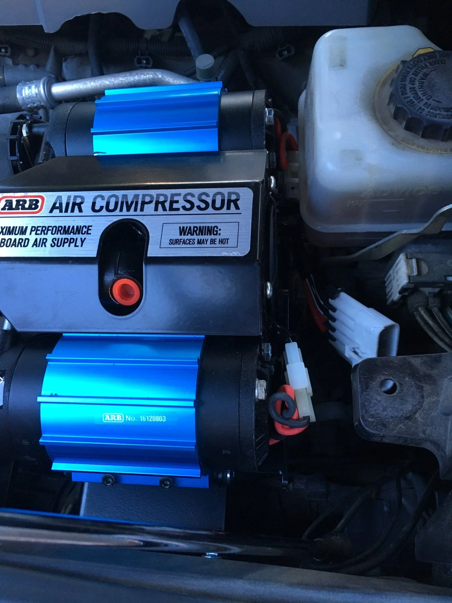

Step 1 install the compressor

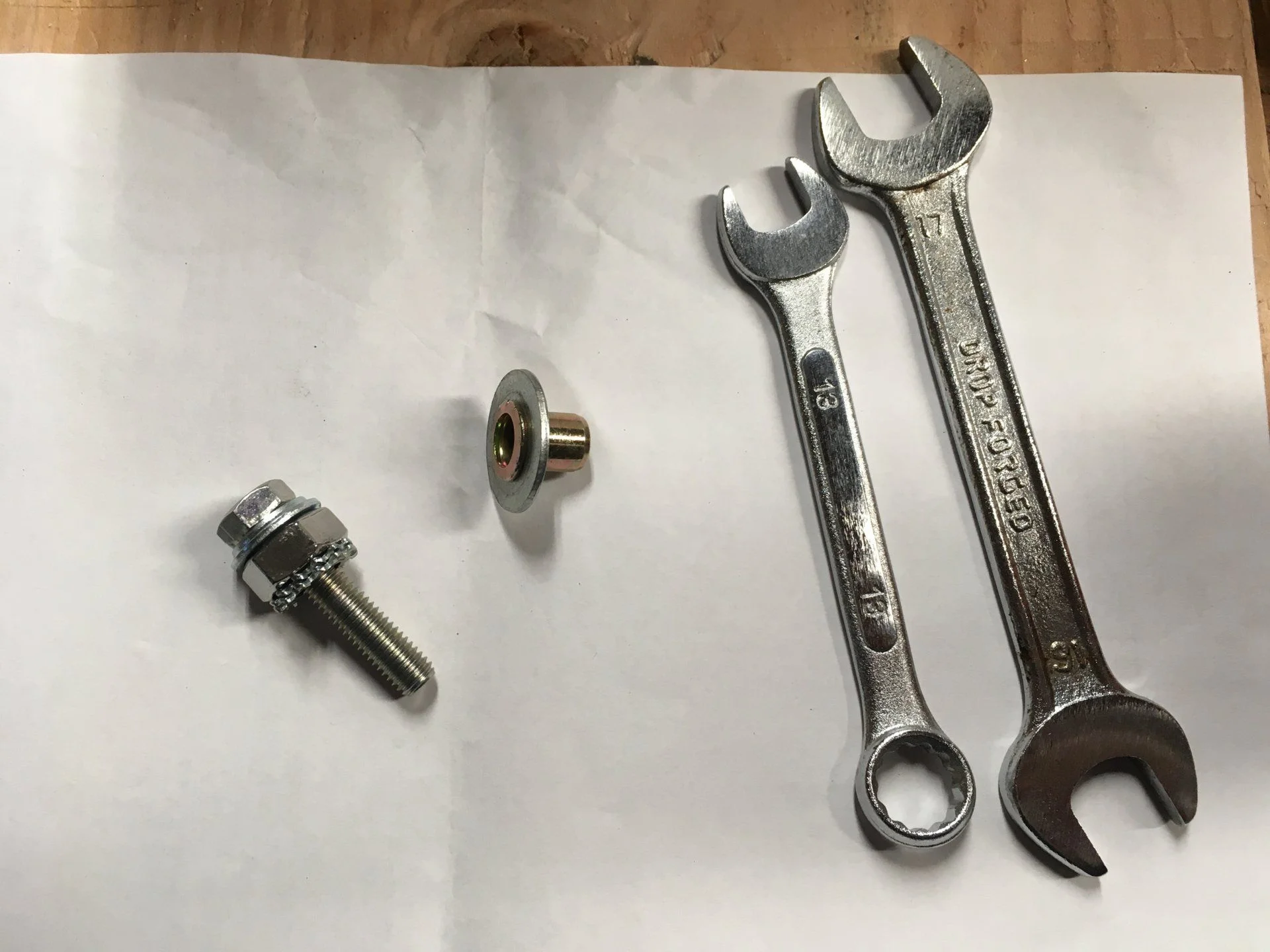

Step 2 test home made rivnut tool.
Check.
That’s a 10.9 m6 bolt, an m8 nut, two star washers, and two regular washers.

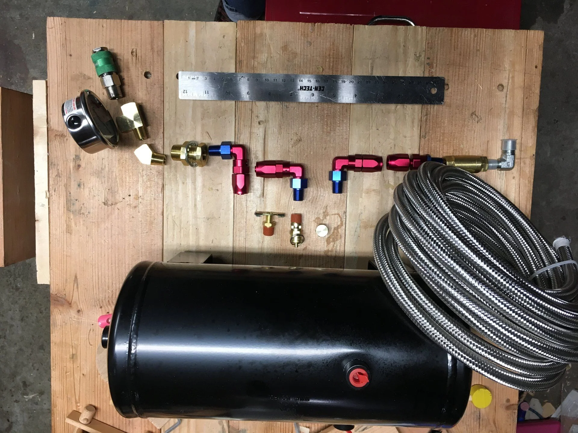

Step 3 compressed air tubing and tank mock up. Wai for fancy 1/4 npt to 6an connectors from China, then lay it out for verification.
And discover I got 3/8 quick disconnects. Who’s in charge of procurement?!

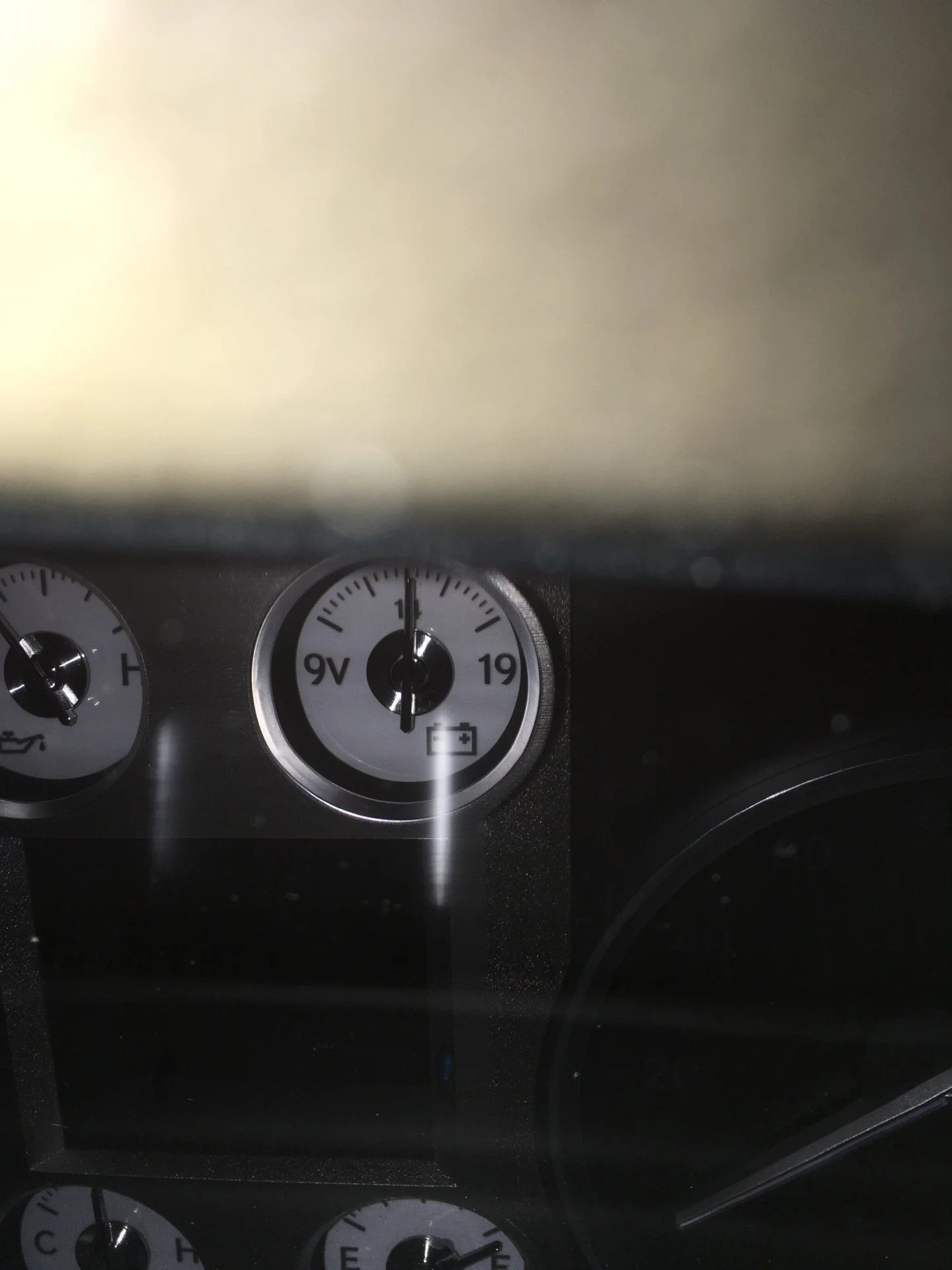

Here’s the alternator reading at a stop light above 14v

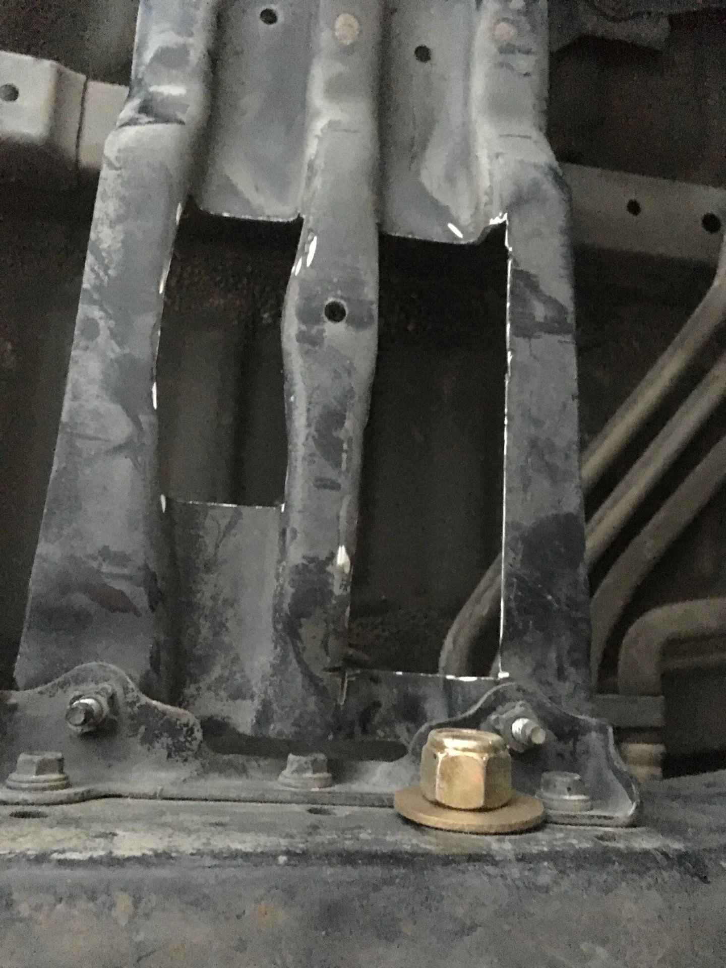

Step 4 i needed the tiniest bit more vertical for the tank, so I cut the spare tire carrier. After fitting up looks like I only needed the front half of the forward rib for space. It’s a bit flexy now, but I can stiffen with a square tube if I need to later. Spare tire carrier is really heavy gauge steel.

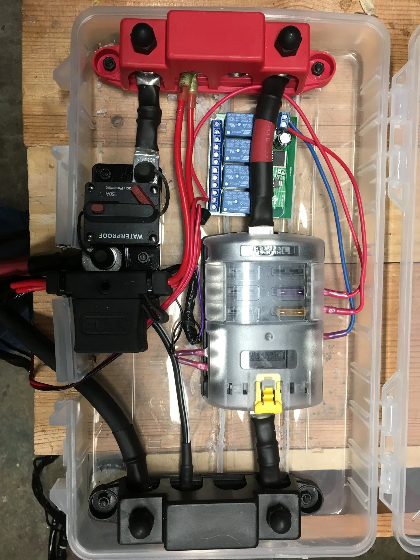

Step 5 finished up the electrical. In retrospect I think the bus bars were not necessary. For sure I could have gone with a fuse panel that didn’t have negative and used the negative bus bar. But I had the stuff so I used it.
This little plastic box was $7. It fits on top of the fuse box. Not waterproof after my slicing and dicing, but splash resistant at least.

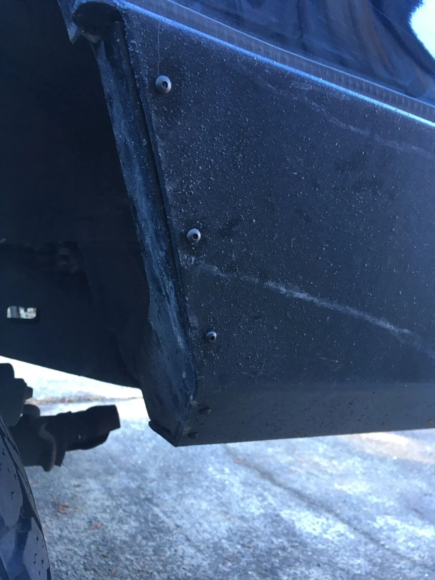

I upgraded the attachment point on the RLC bumper fill ins at the wheel well. Version 1 was very small screws using tapped aluminum. It worked as good as it sounds, which means 80% of them vibrated out in gravel road use.
Version 2 uses rivnuts and M4 bolts. It should do much better.
Looks about the same, hopefully functions much better.

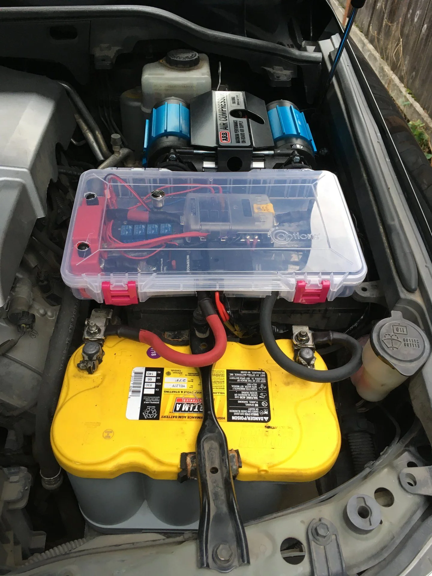

Step 6 - complete electronics install for ARB twin (and future stuff)
Fits and works perfect. Have a breaker (in the box), bluetooth relay switch (in the box), override toggle (on the box), and the cosmetic covers fit on too.
Wire tension holds it in place just fine from the 1/0 to the battery, and the cover will also hold it in place.
