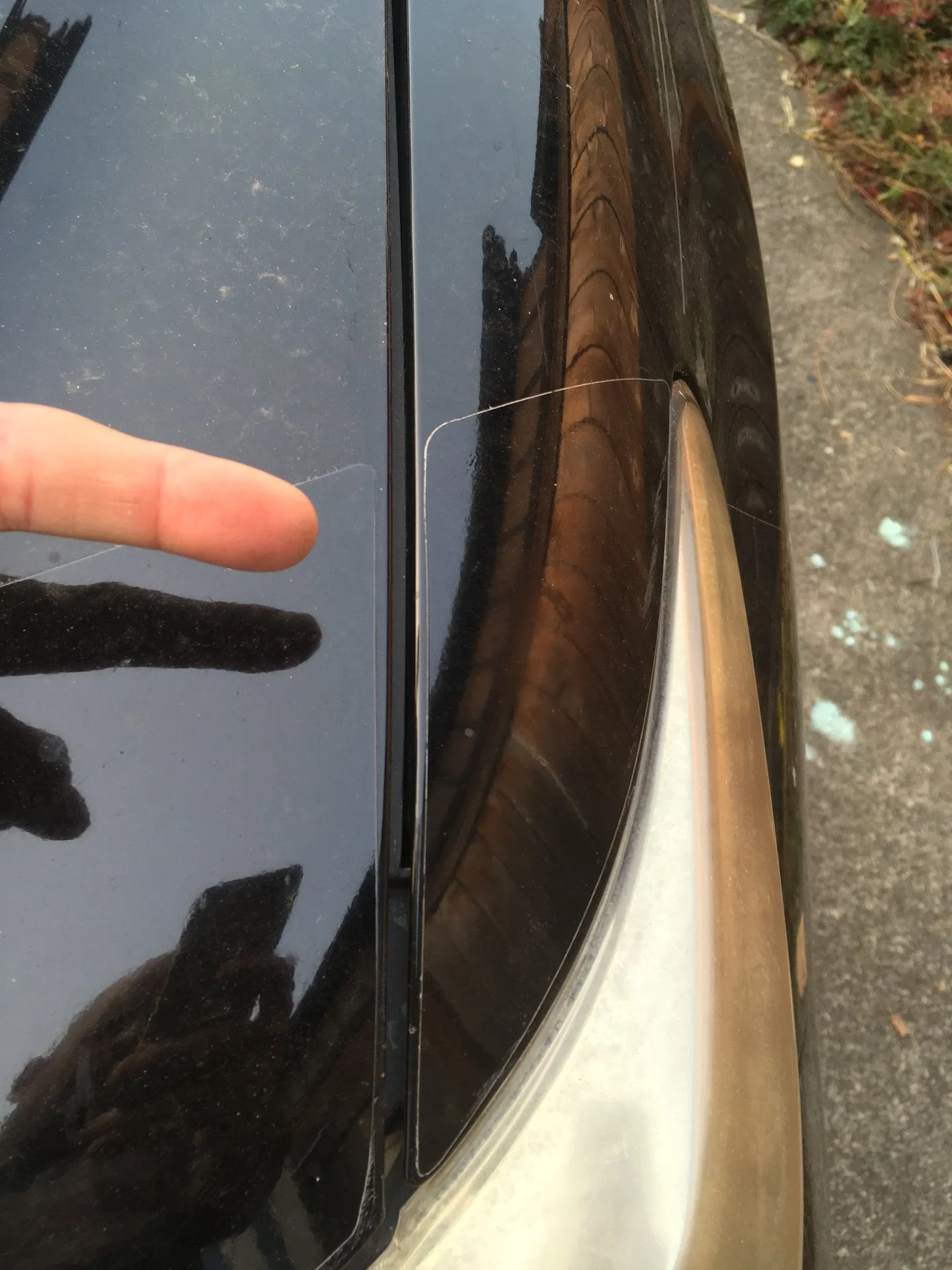

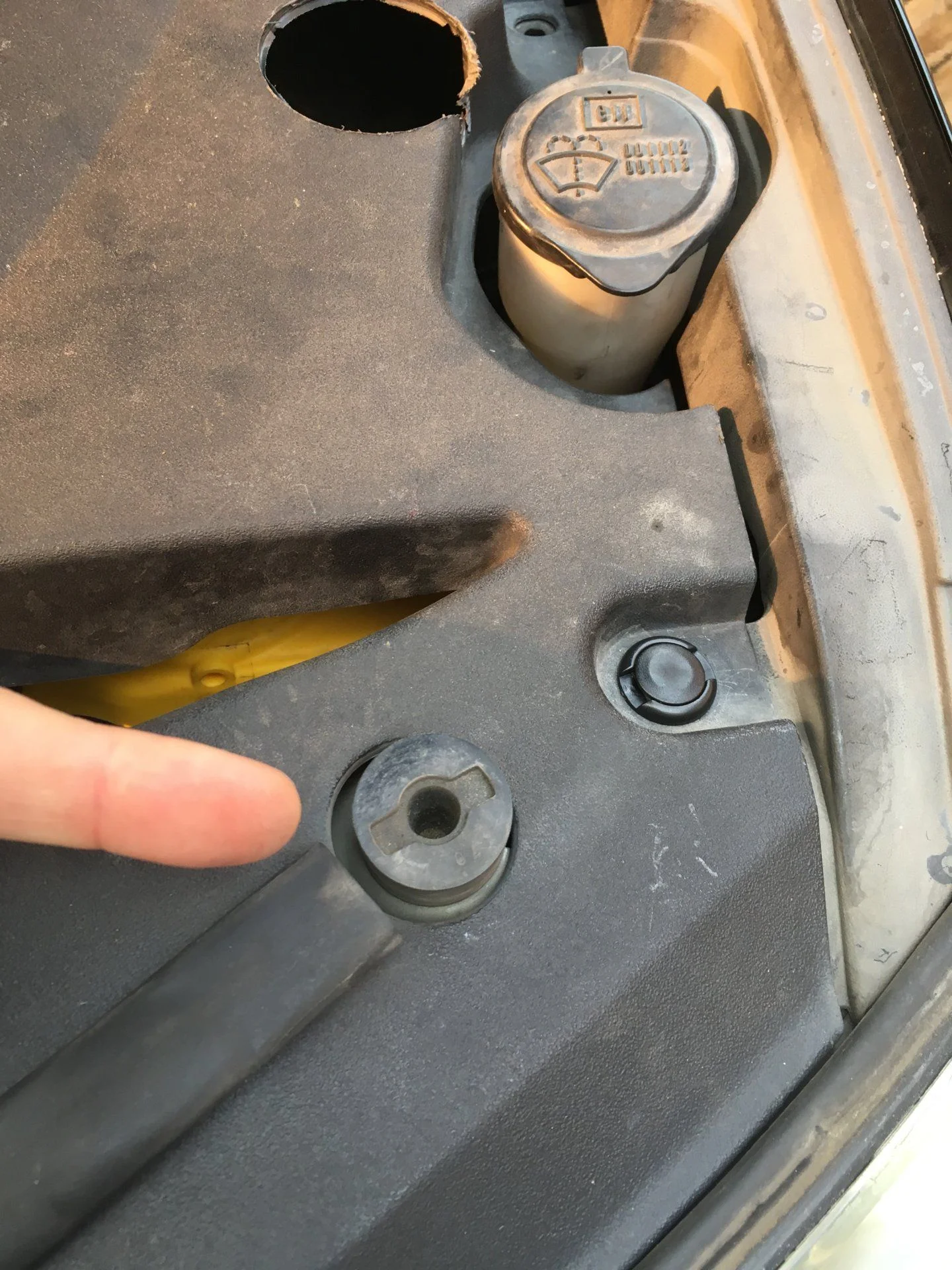

Hood alignment got you down? My driver side fender gap was 1/8 low, and I could see it all the time. Right in my field of view. Turns out it’s an easy easy fix.
Screw the large bumper in or out to adjust. Voila!

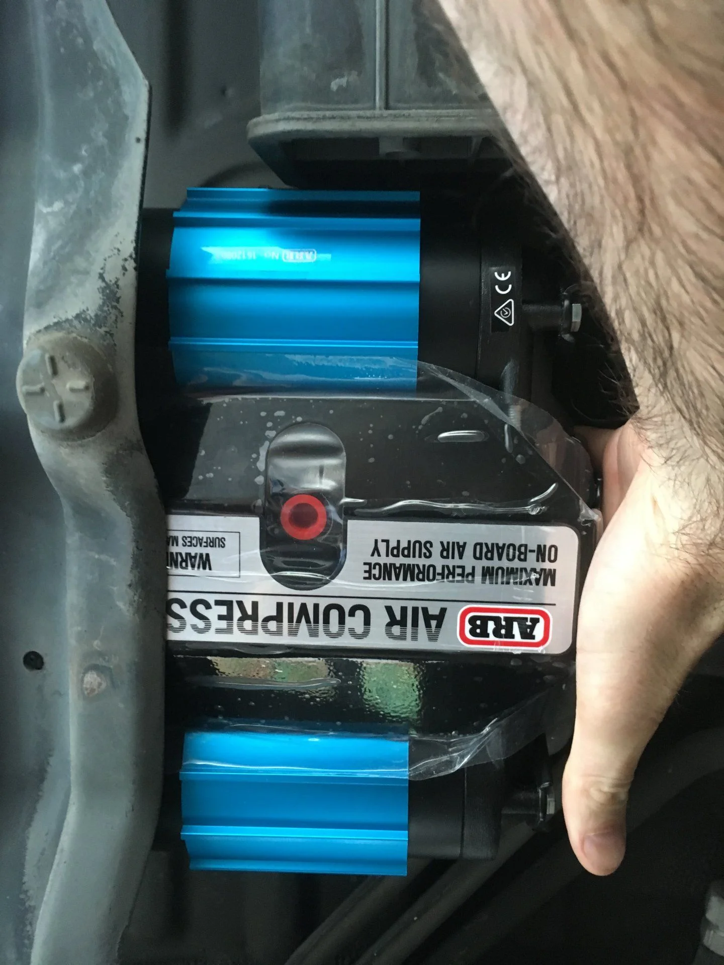

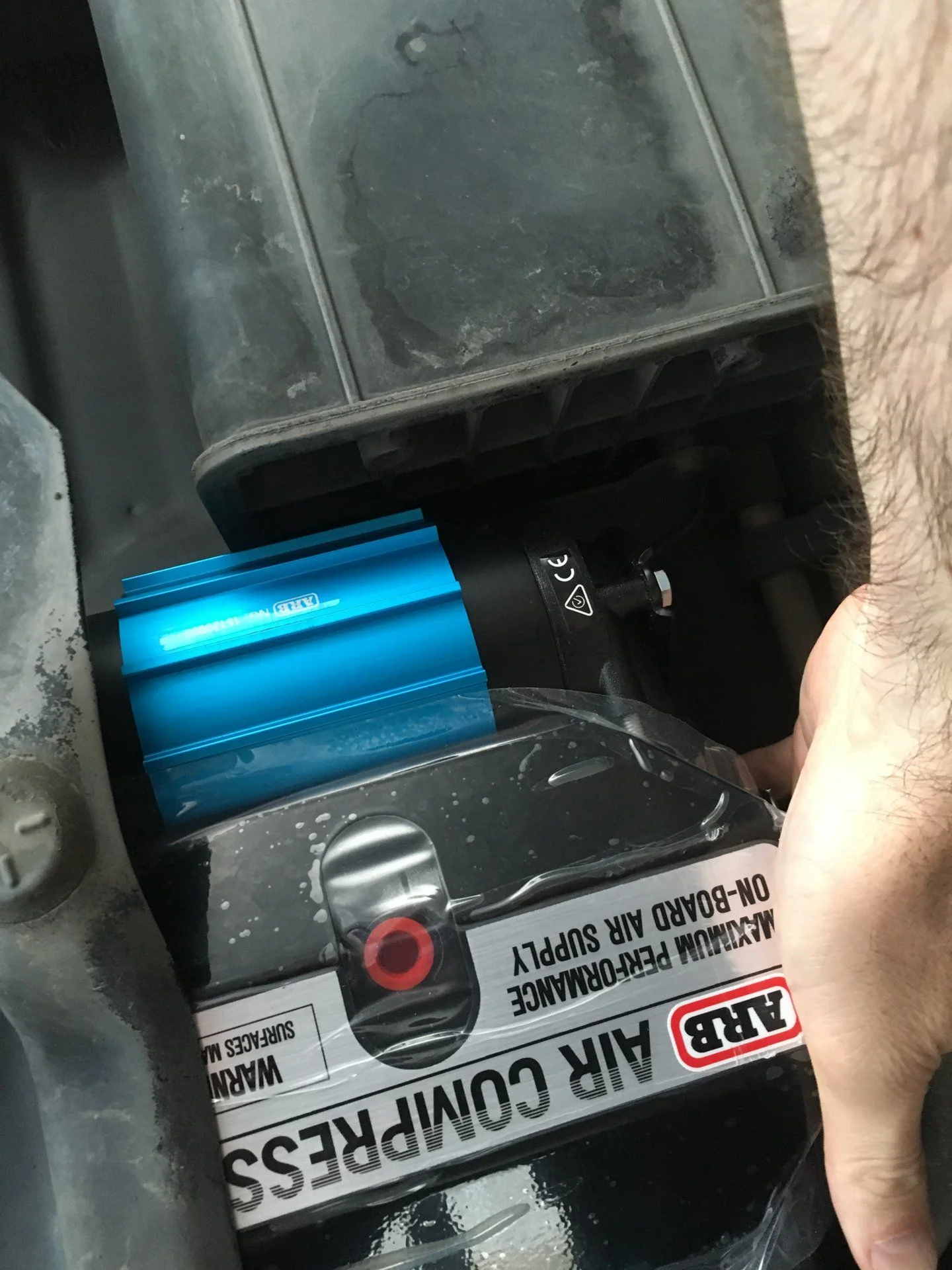

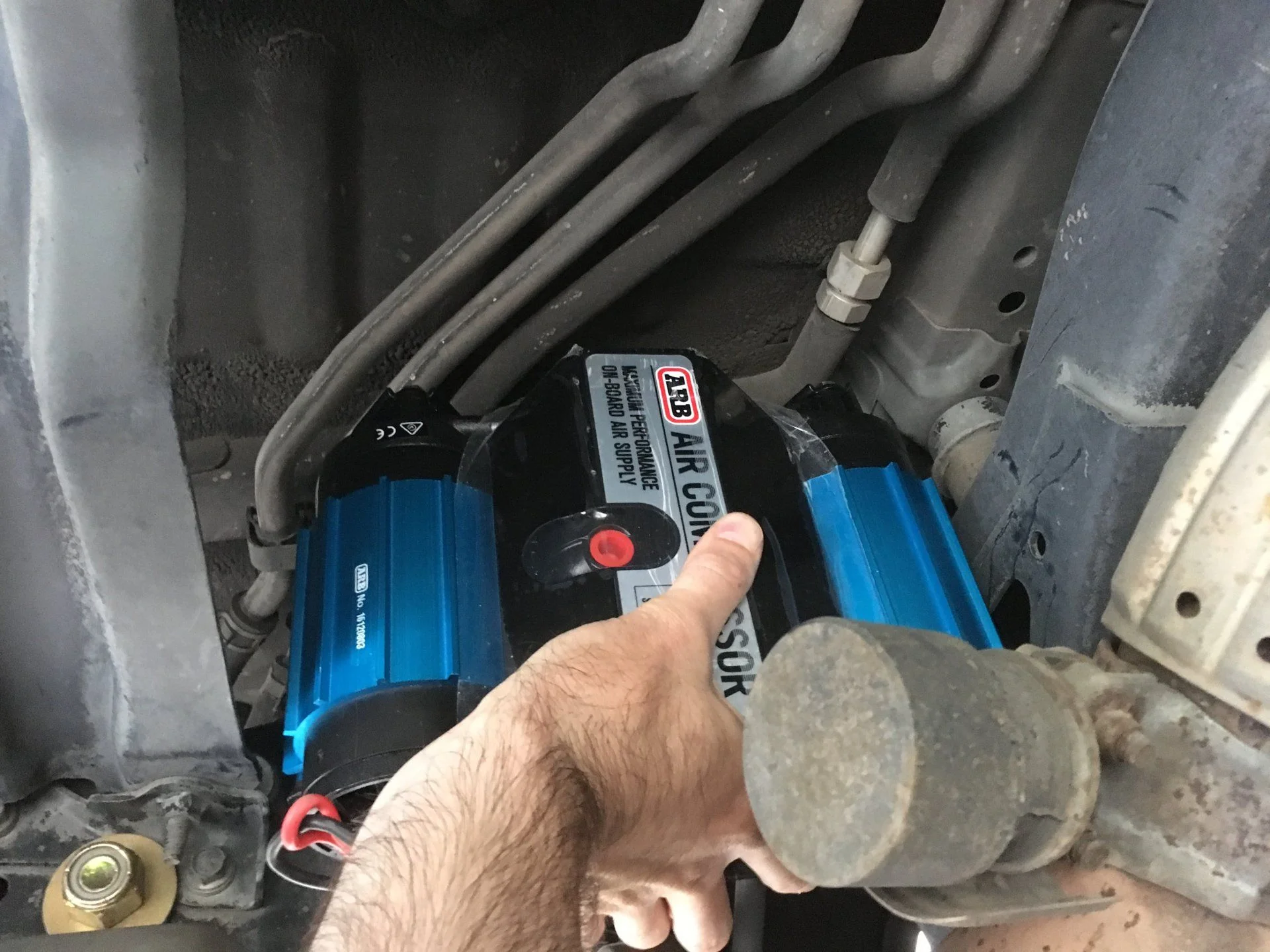

Are either of these rear mount positions for the twin advised?
1 by the rear ac unit?
2 by the driver side axle and frame corner above the soon to be deleted resonator?
I’m gonna get a 2 gal tank too to stick back there
Any pics of a rear mount would be appreciated!
I’m ok with relocating the breathers. But I don’t want it scraped off by the first trail run either.
I would imagine the compressor would get super dirty and take some direct shots of mud and water at high speed over time under the truck potentially causing issues and shortening its life. I’ve considered mounting one inside the cabin on the back of the drawers facing the second row seats or under the hood in the “traditional” spot.
Ok thanks. Yep just looking at options. I guess the under hood temps are not really a concern as the twin gets above 200deg while operating anyhow.
I think I’ll order that bracket and the 2nd battery kit and get on with it.
I did quote out the AUS sourced interior rear mount, it was priced like other ARB stuff, just on the range of too much, in the end decided I didn’t want the noise in the rig.

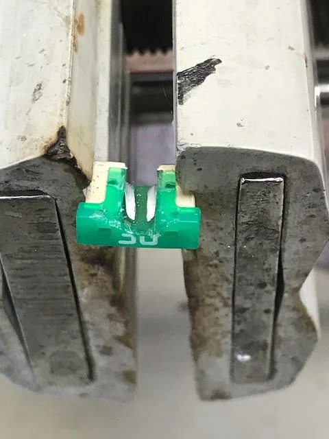

Why do I always feel like the last one to the party? Sorry about that... Assuming you have access to the parts, you can make one of these adapters in about 15 minutes. That said, I know do it yourselfing something like this isn't for everyone but I wanted to do a quick "how to" for anyone interested: I started with a 30 amp factory type fuse as I wanted the filament portion to be as robust as possible for soldering to. I whittled away a little of the plastic case and soldered in my fuse holder and diode. The orientation of the diode is critical and the band of the diode should be closest to the front of the vehicle/fuse to work correctly. Here are a few progress pics:
Followed this approach and built the Alternator Sensor wire <diode> update.
I used a Mini Fuse, 40 A as the body (not a LP mini, which is the regular fuse in the LX570). A Mini fuse inline holder as @619TOY did, and a 1 A <diode >. Honestly the hardest part was getting access to the blades on the sacrificial fuse. It took around 30 min start to finish.
For orientation, mine worked with the <diode > on the blade toward car front / battery. And the <diode> should show the band toward the fuse.
Before: (cold idle) 14.07
After: (cold idle) 14.56
So I got 0.5V on cold alternator.
My battery after a few weeks of driving was at 12.55 V. I have the Optima Yellow Top 27F.
I'll watch this for a few weeks, and if it doesn't perk up will get an additional maintenance charger.
I've got maybe 8 hours on the truck since the <diode> mod on the alternator sensing circuit. My battery now reads 12.76.
That's good, but not great - hoping to see 13.0. I'll check again in a couple weeks.

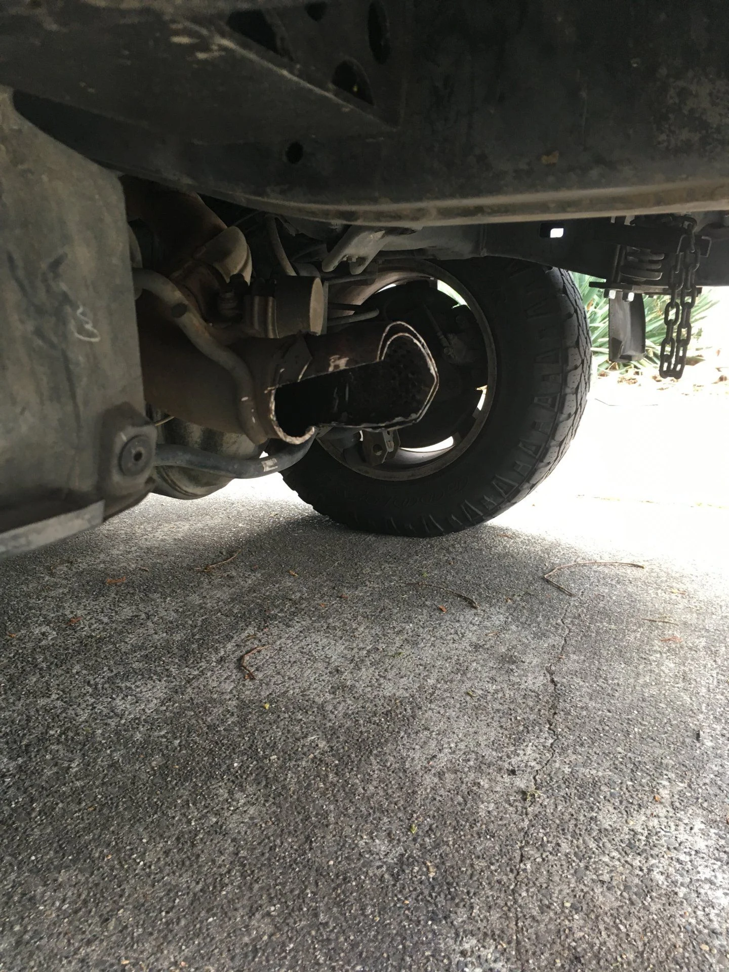

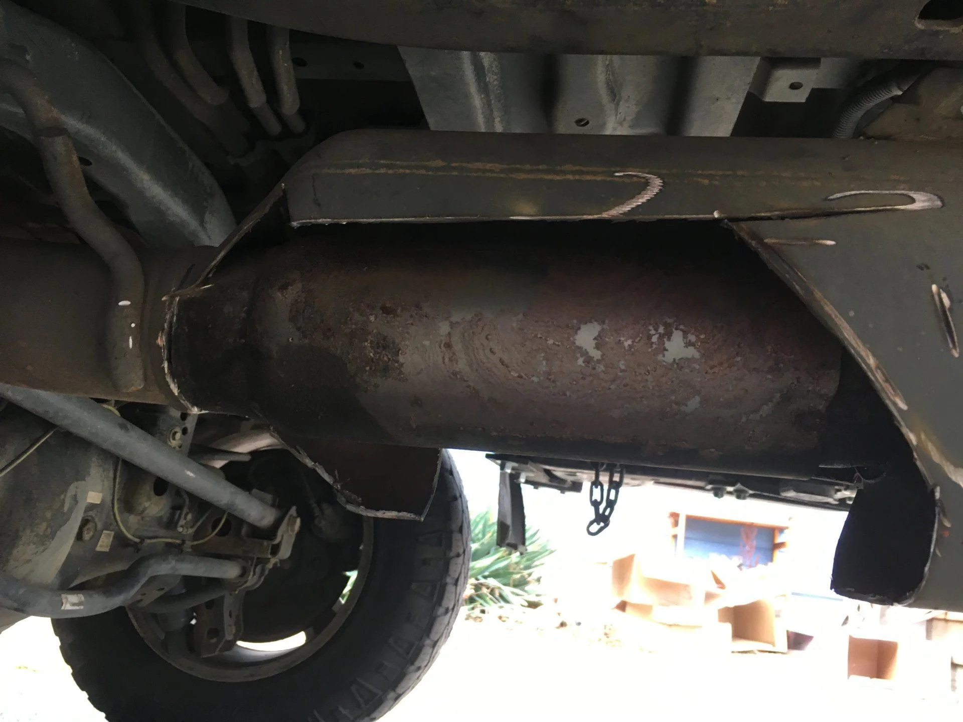

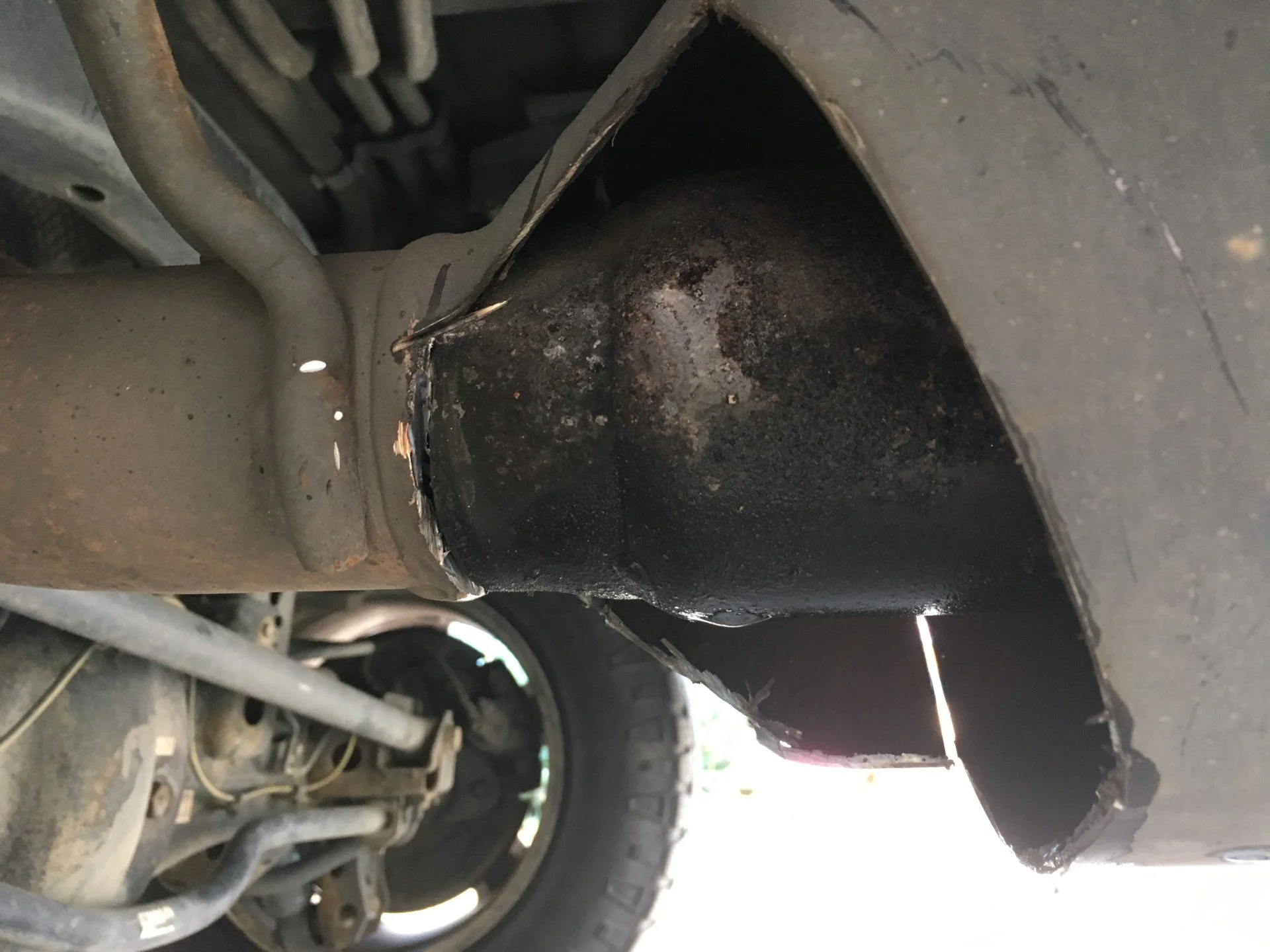

Resonator delete completed!
I deconstructed the resonator today. It has three layers of steel a thinner gauge steel outer layer (what we see) and two pipe layers.
If you cut right behind the weld you can use the inner pipe layers to shape the flow a bit.
I’ll post up the final look soon.
Yeah for weight reduction and clearance gains
