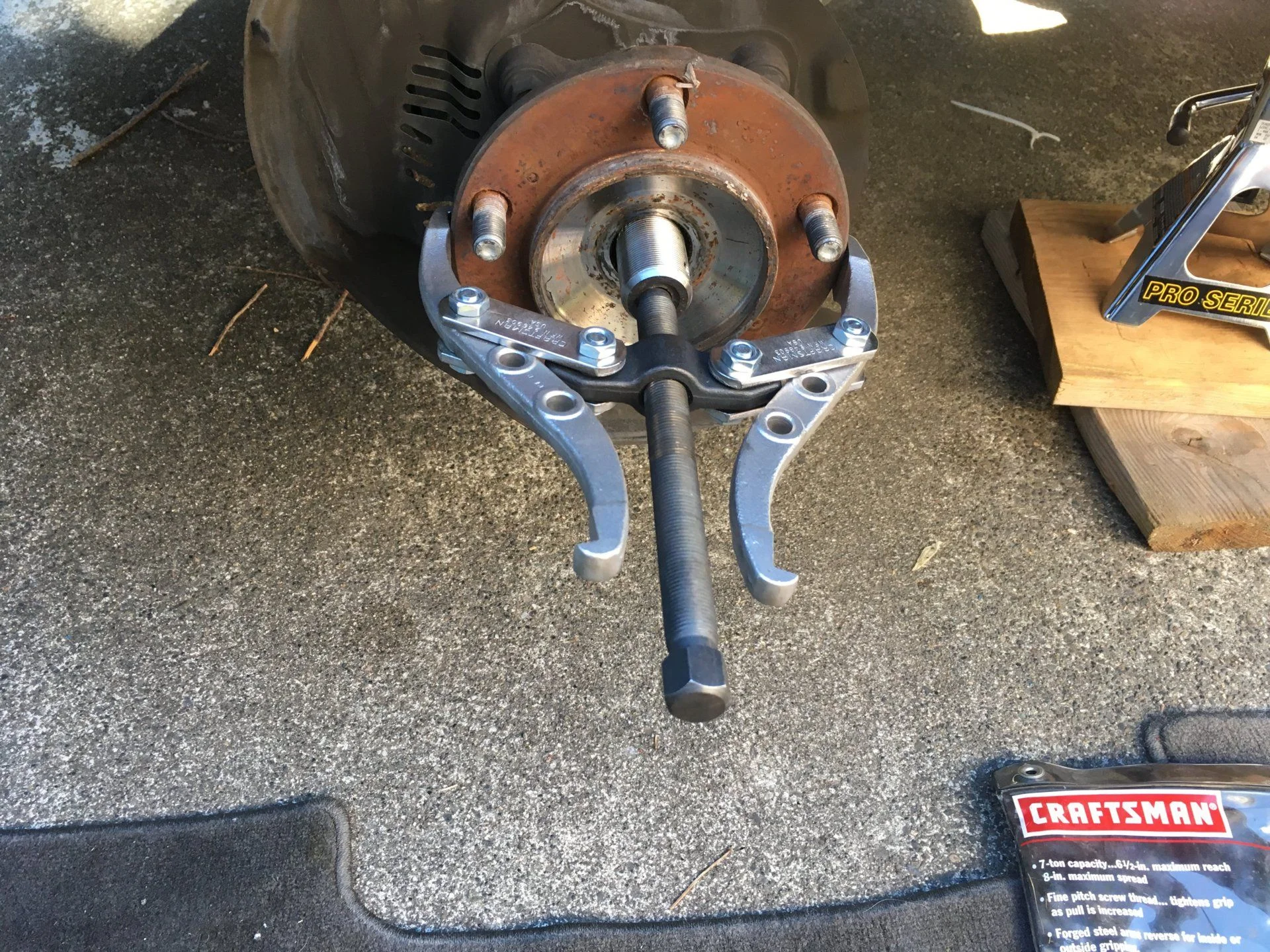

Did the driver side axle today. Missed the action shot of my puller last time. Much faster and easier the seconds axle, less than two hours all in.
Moving on to AHC and the two remaining diffs now.

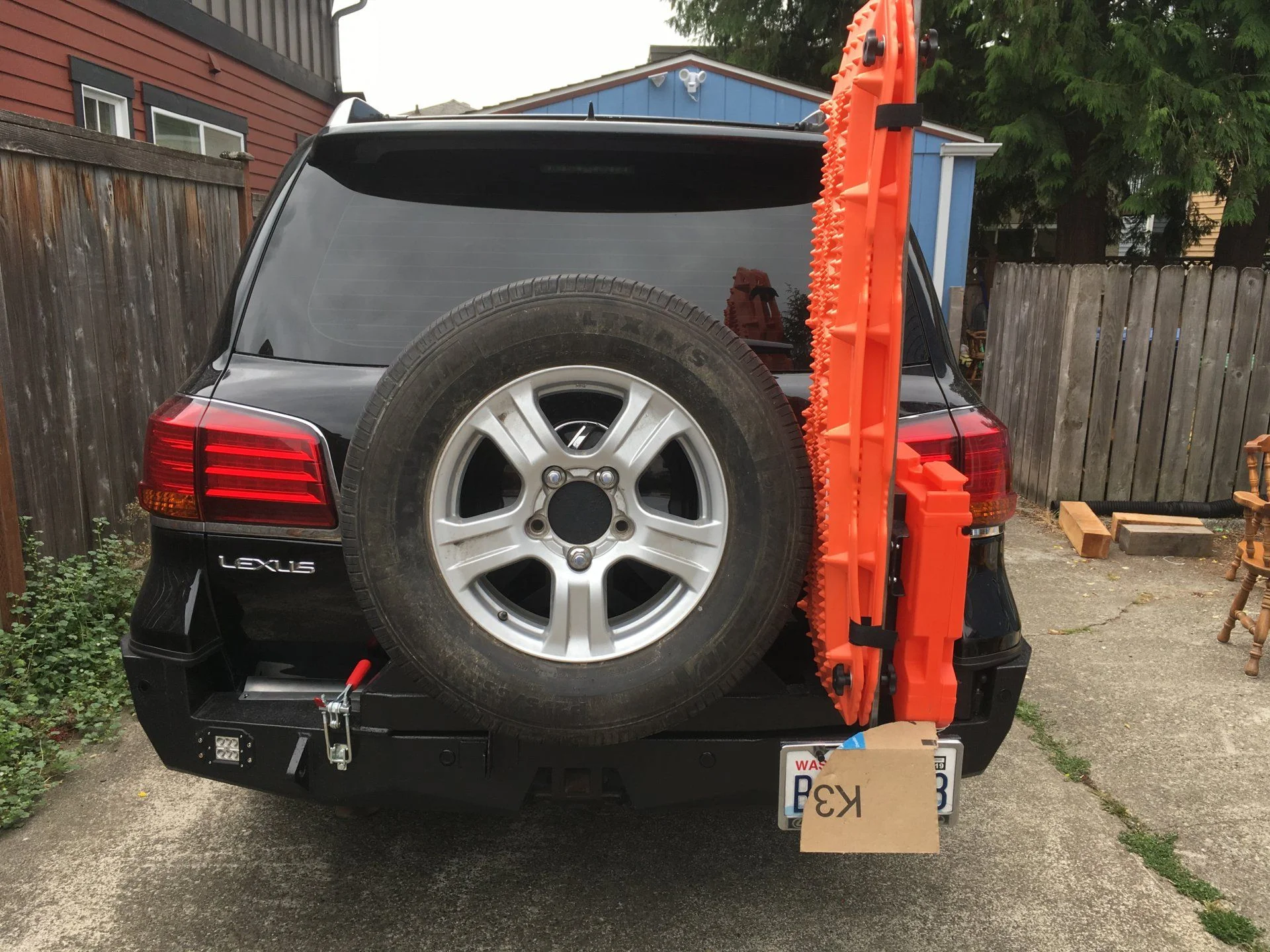

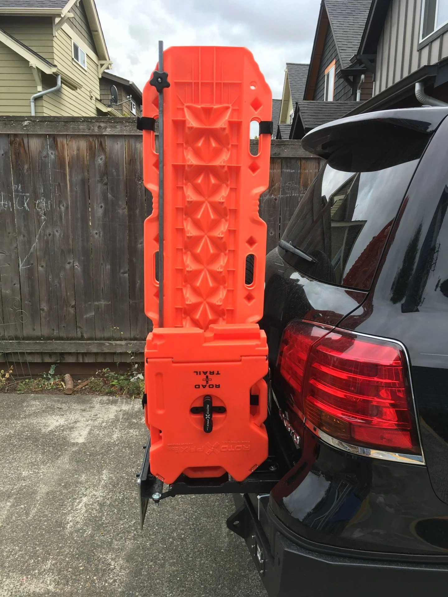

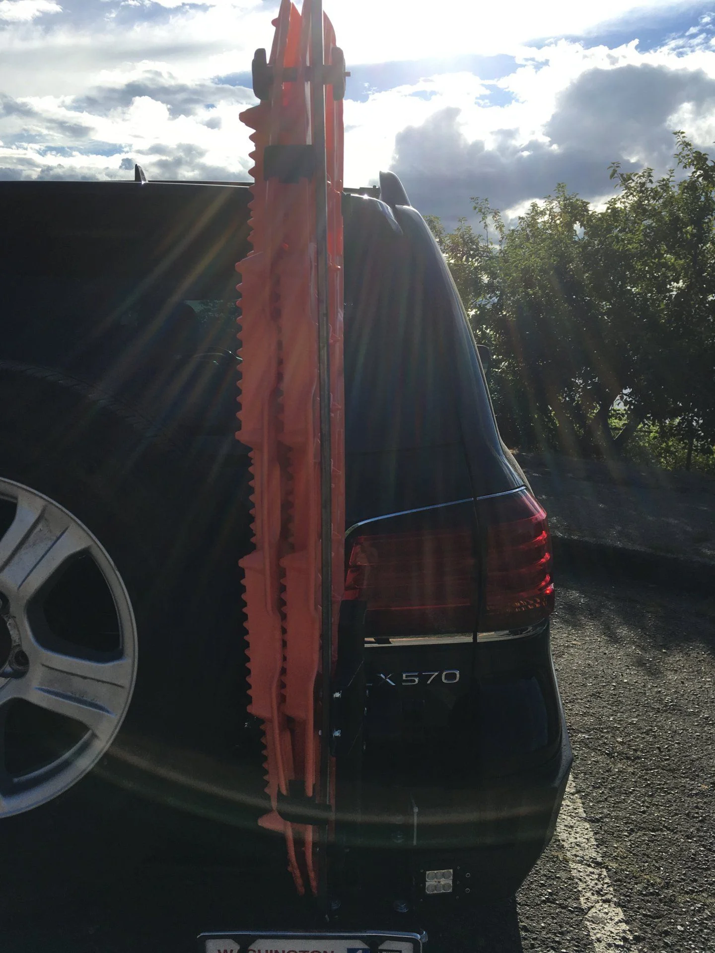

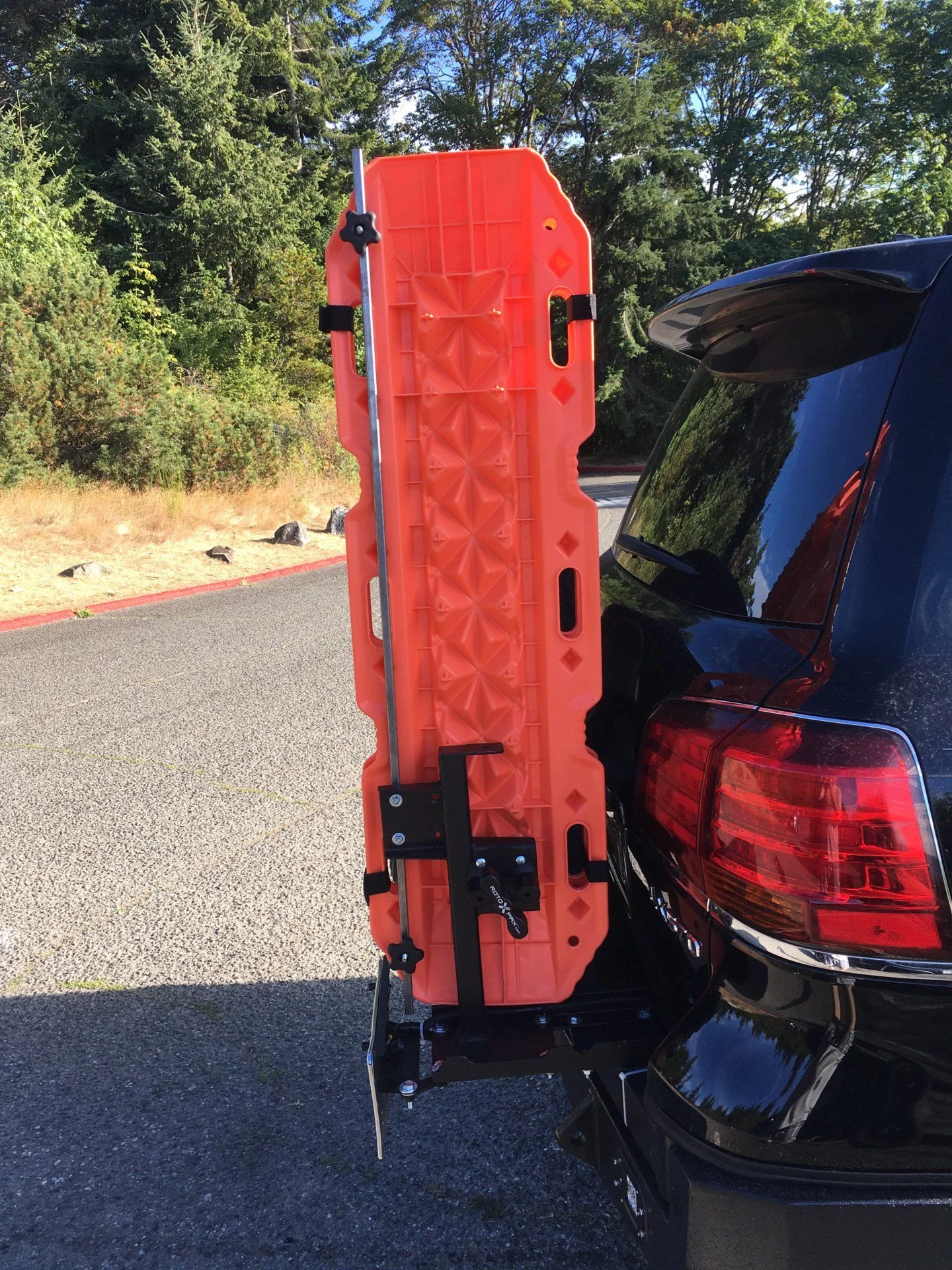

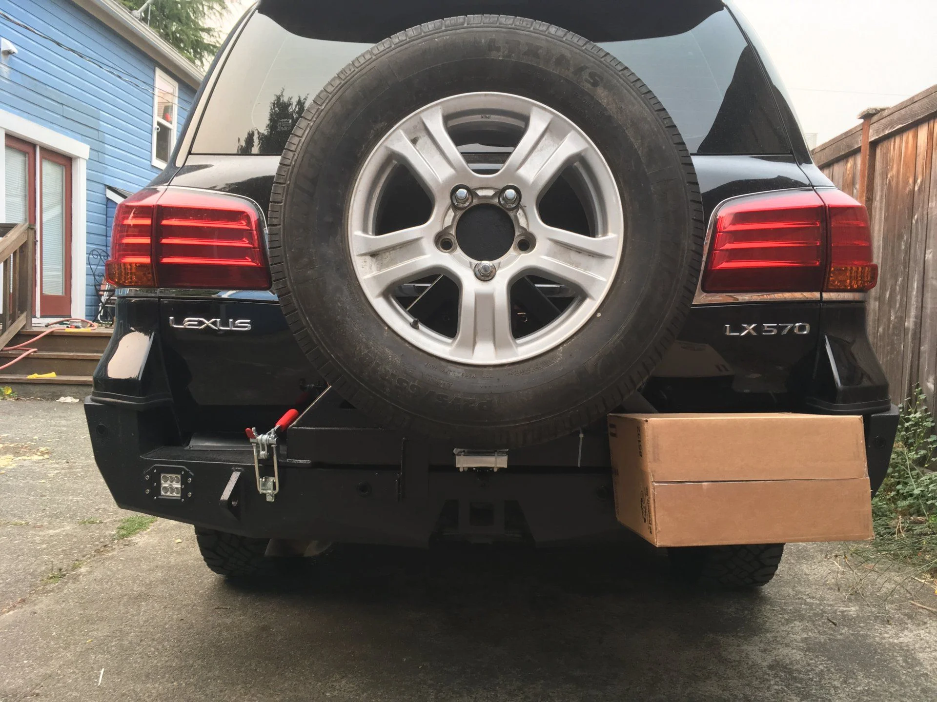

Finished up the Trax mount. I have the generic rescue buddy version.

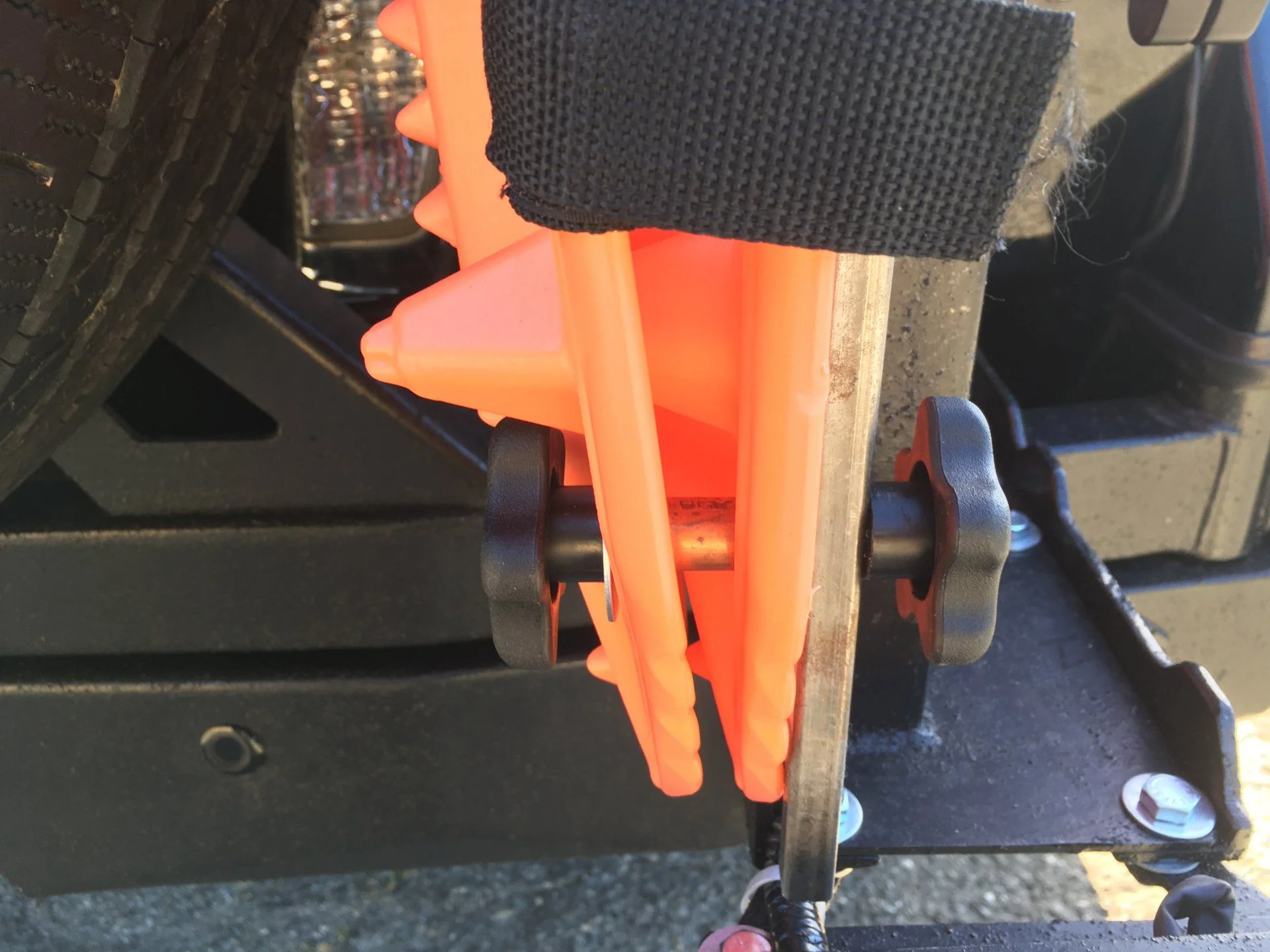

Started with the pax mount made for my bumper. I had previously bought a 1/2” by 4 ft section of square tube for a roof mount I didn’t finish for the trax (this mount will work for that, but I’d likely put it diagonal) anyhow. . .
It’s 1/4 Inch based primarily because the knobs from Amazon are 1/4 20.
Test fitting indicated I needed to be able to screw in the bolt rather than use as a stud. Further sizing showed that the built in hole on the trax is the same as 1/2” copper tubing. Excellent.
The securing item is 1/4 all thread cut to length. Knob, fender washer, jam nut, space, nut, 1/4 regular washer. The copper tube ride still on the nuts and is between the two washers. Fit isn’t perfect, could put a bushing in there’s but it’s fine. Am screwing it together with a second knob. Super easy on off, which was my goal. Some vibrations but nothing a bungie around the pax wouldn’t fix.

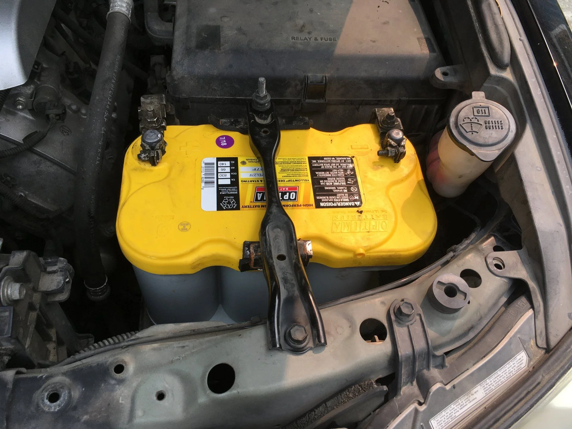

Had a flat battery today and got to use the lithium jumper I bought a couple months ago. After I figured out how to use it fired right up. Had 82% after sitting in the truck for 45 days of summer.
Drove 30 min and had to jump again. It got there but with some cranking this time down to 70% after second jump.
Drove about 45 min. At home batt was 12.0v. Reservoir was an inch or so low, so filled it up, measured 12.3v. Then started (no jump) and idled for 10 min. Up to 12.5v. Think it was just low water in the batt, but taking this as fair warning and adding the Slee dual kit to my shopping list.
Battery was down to 10 v this morning. Figure it was a goner, was a duralast gold 27f 3 years and 3 months old.
I looked at the group31 update and Slee tray, but decided to just get a 27f optima yellowtop instead.

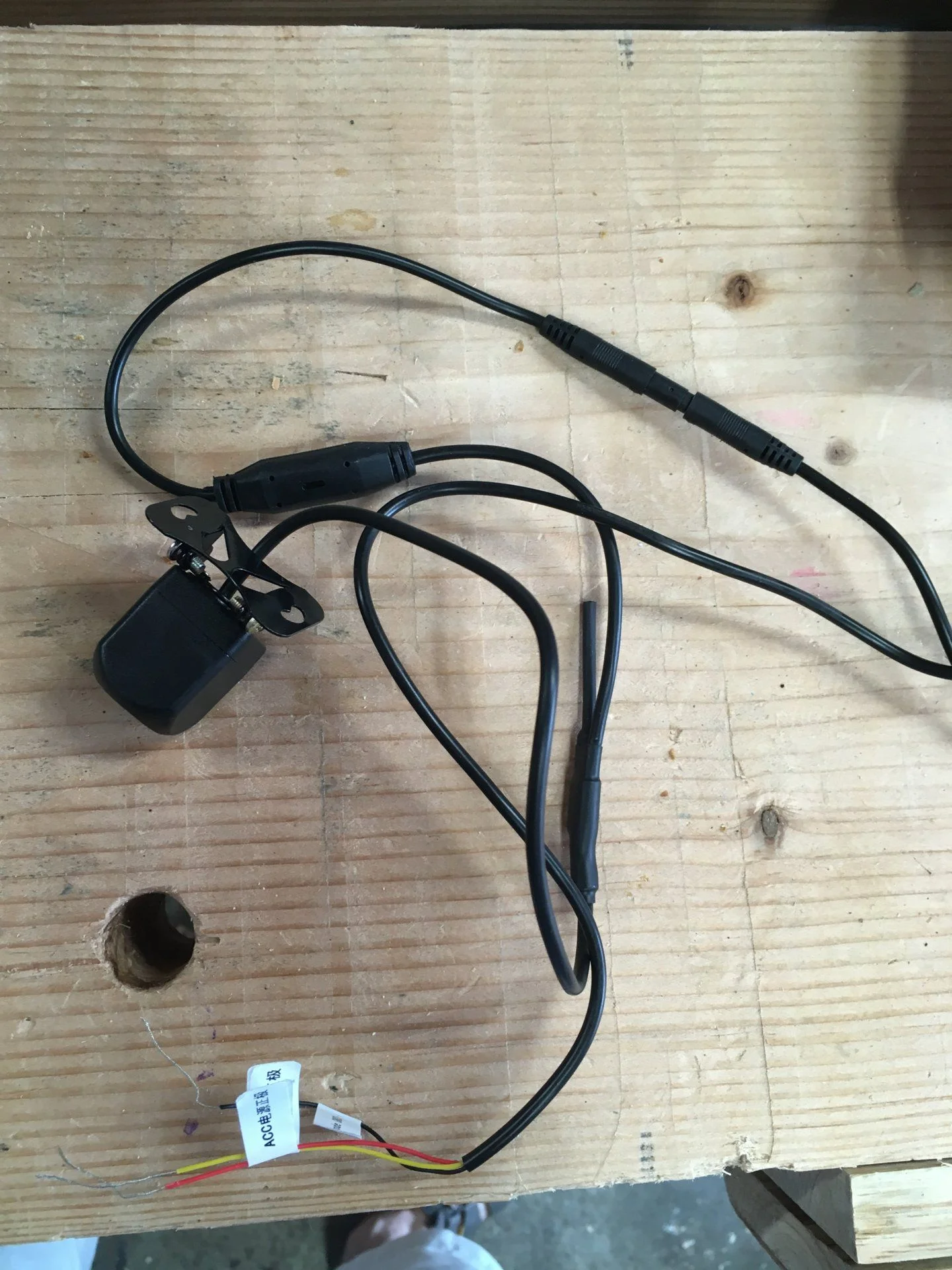

Spent some of the afternoon addressing a backup reverse camera for my rlc bumper. I couldn’t come to terms with taking the hatch apart and I didn’t find a good way to splice a camera into the Headunit another way. Was looking at captive monitor solutions, and saw a WiFi only option, kind of like an IP camera. Only $35 so gave it a try.
https://www.amazon.com/gp/aw/d/B07DH6KVD2?tag=ihco-20

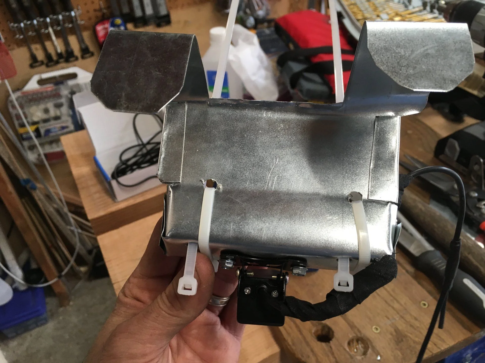

Hooked it into the trailer wiring breakout box I put in a few weeks ago. Hacked up a mount from a galvanized shingle I had laying around and zip ties. If it seems solid I’ll paint and formally mount with some tapped screws.
I don’t use the reverse camera a lot, switching to the camera WiFi and turning on the app is a about 10 sec.
It also has video recording.
