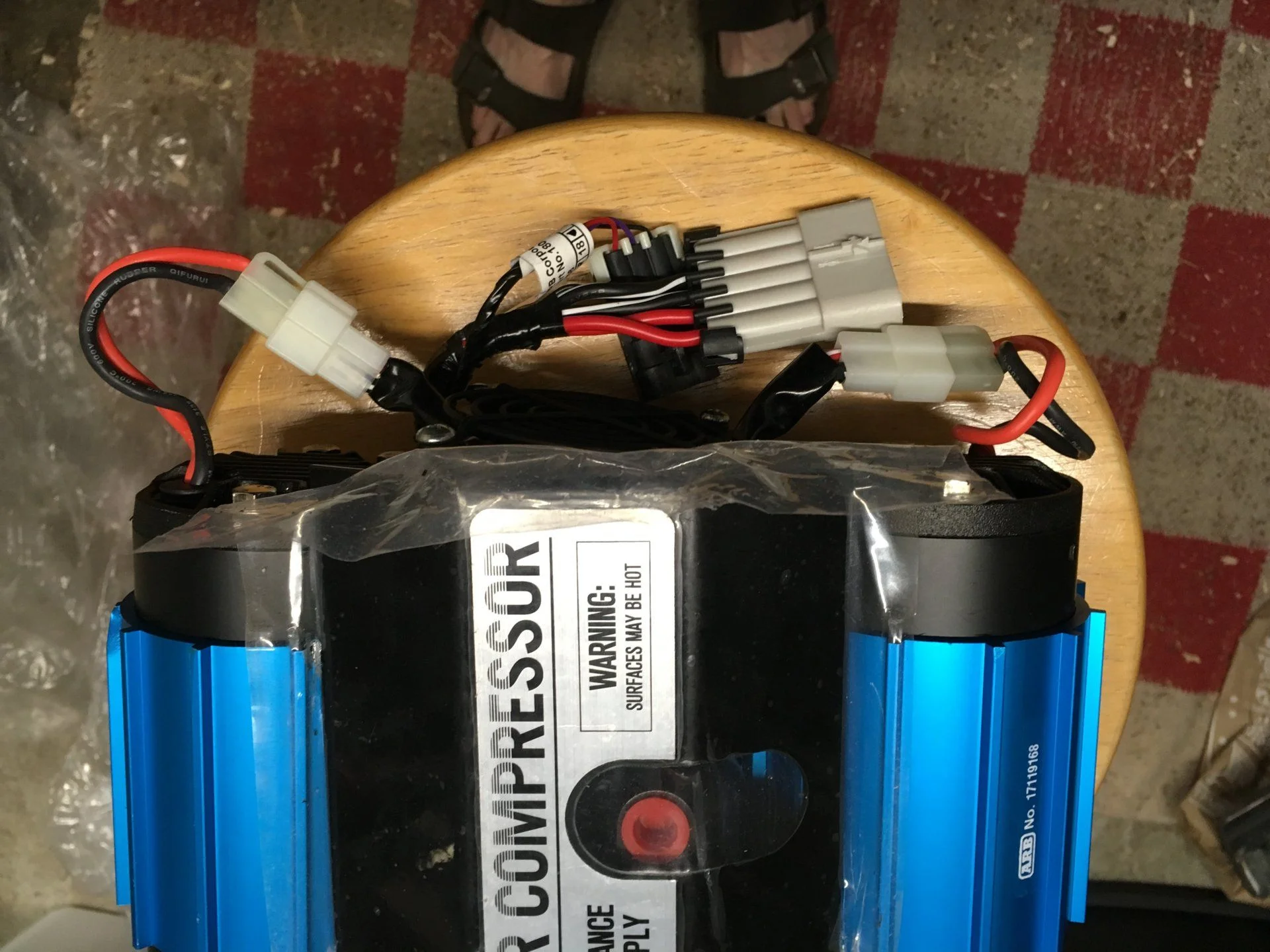

Assumed it was dead, saw an arb twin in the Amazon warehouse, and took the buy once cry once challenge.
Was able to stick a real switch in the little compressor, and it woke back up. Guess it was just a wire gauge issue on the test wire. A bit torn now, don’t really need the arb, but it was a good price. . . I also hand pumped an lt 32” tire to 40 psi. This I will not ever want to do again.

I was thinking of sending the arb twin back, think I’ll keep it now in case I have to get New gears.
Moving service of the other two up the priority chain.

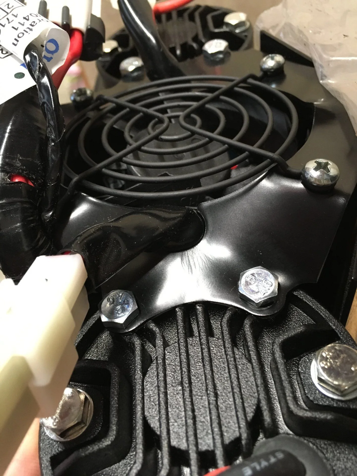

Sad day. The Warehouse Deals ARB twin had obviously been dropped. Bent bracket, broken fan, etc. No main harness connector. Might have been rebuildable, but it was only $100 less and there's no time value in that. Back it goes.
In what world is it ok to break something and return it?

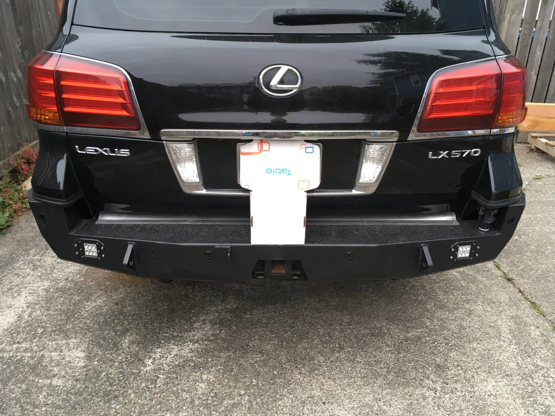

Here is the RLC rear bumper prior to adding the swingarm. It’s been immensely fiddly part because I’m fitting an lx, part because I make a lot of rookie mistakes. Still happy with it.

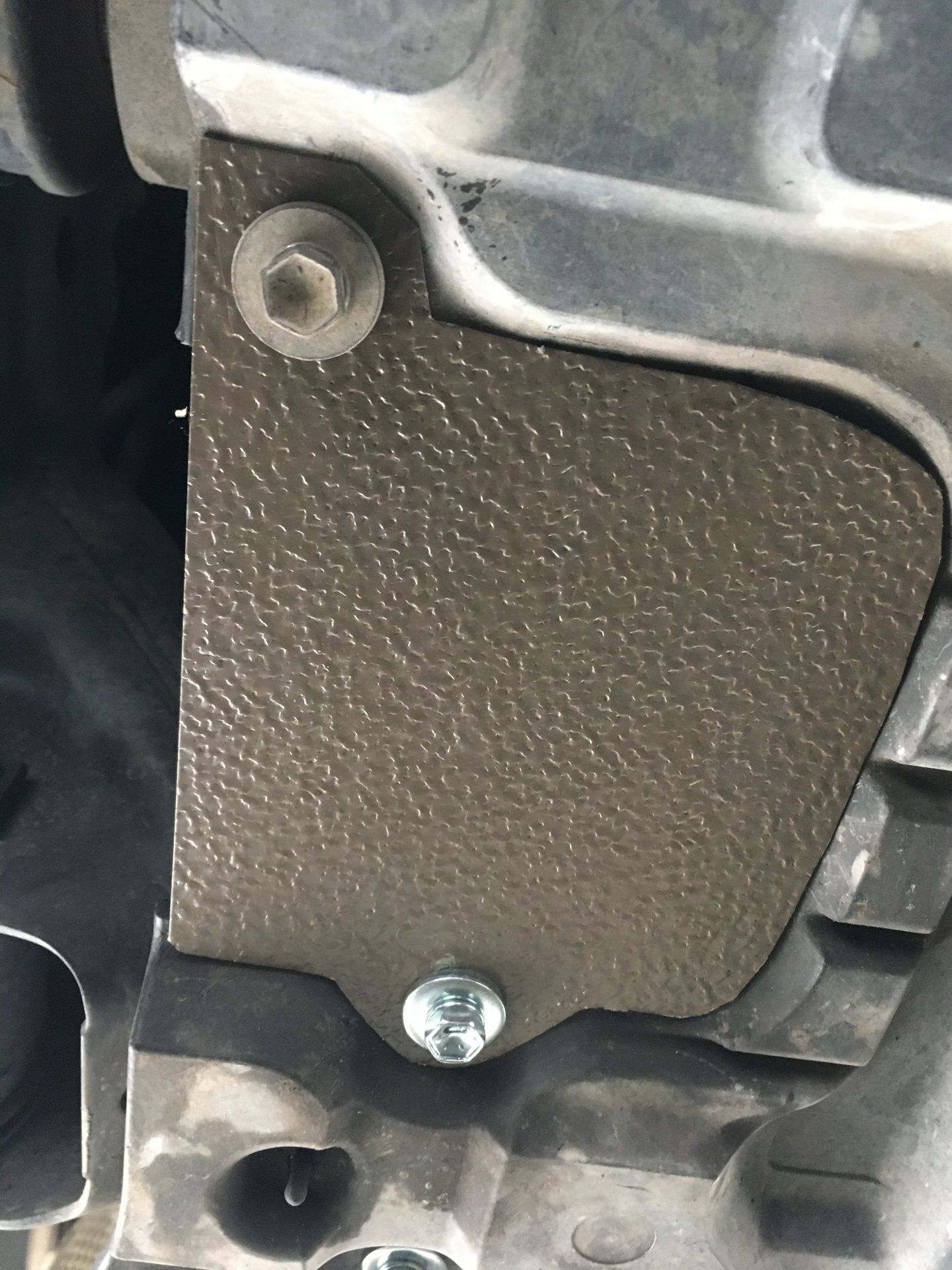

So Lexus gave us a pretty cheesy mid skid. Mine is plastic. It was missing the oil drain plug cover. I went full fondue and added this high quality full custom cover made of complementary colored sheet metal.
Yum.

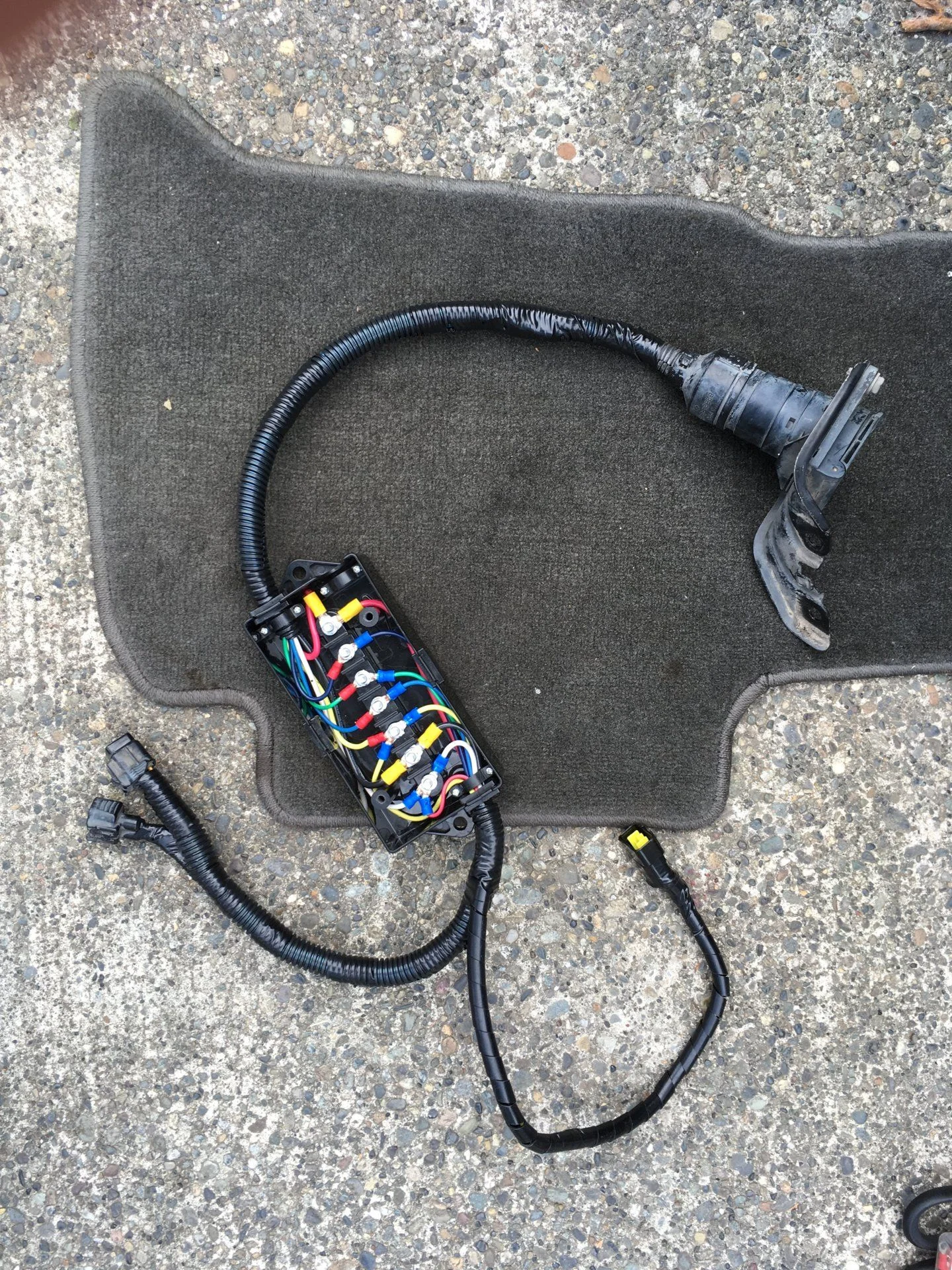

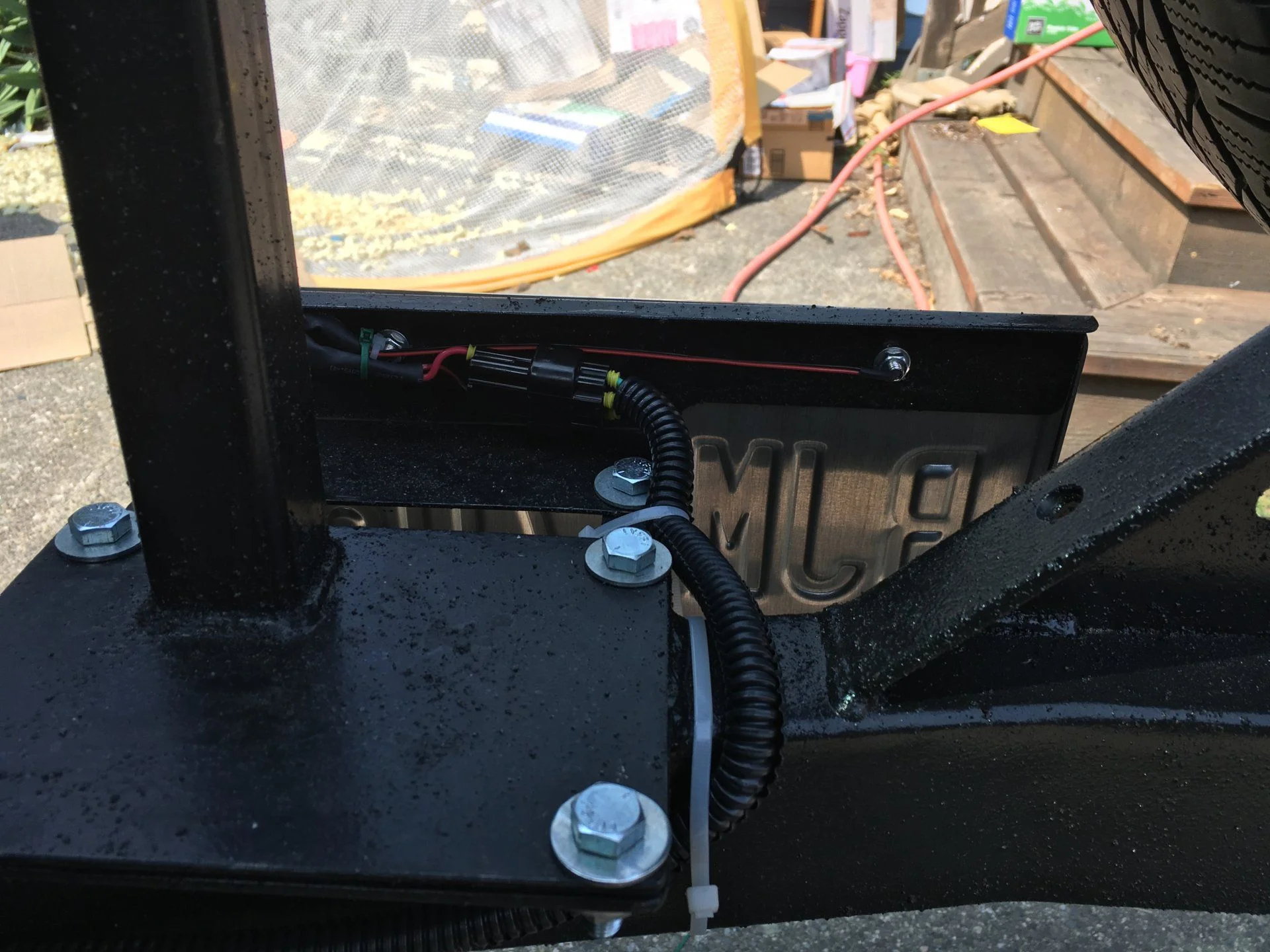

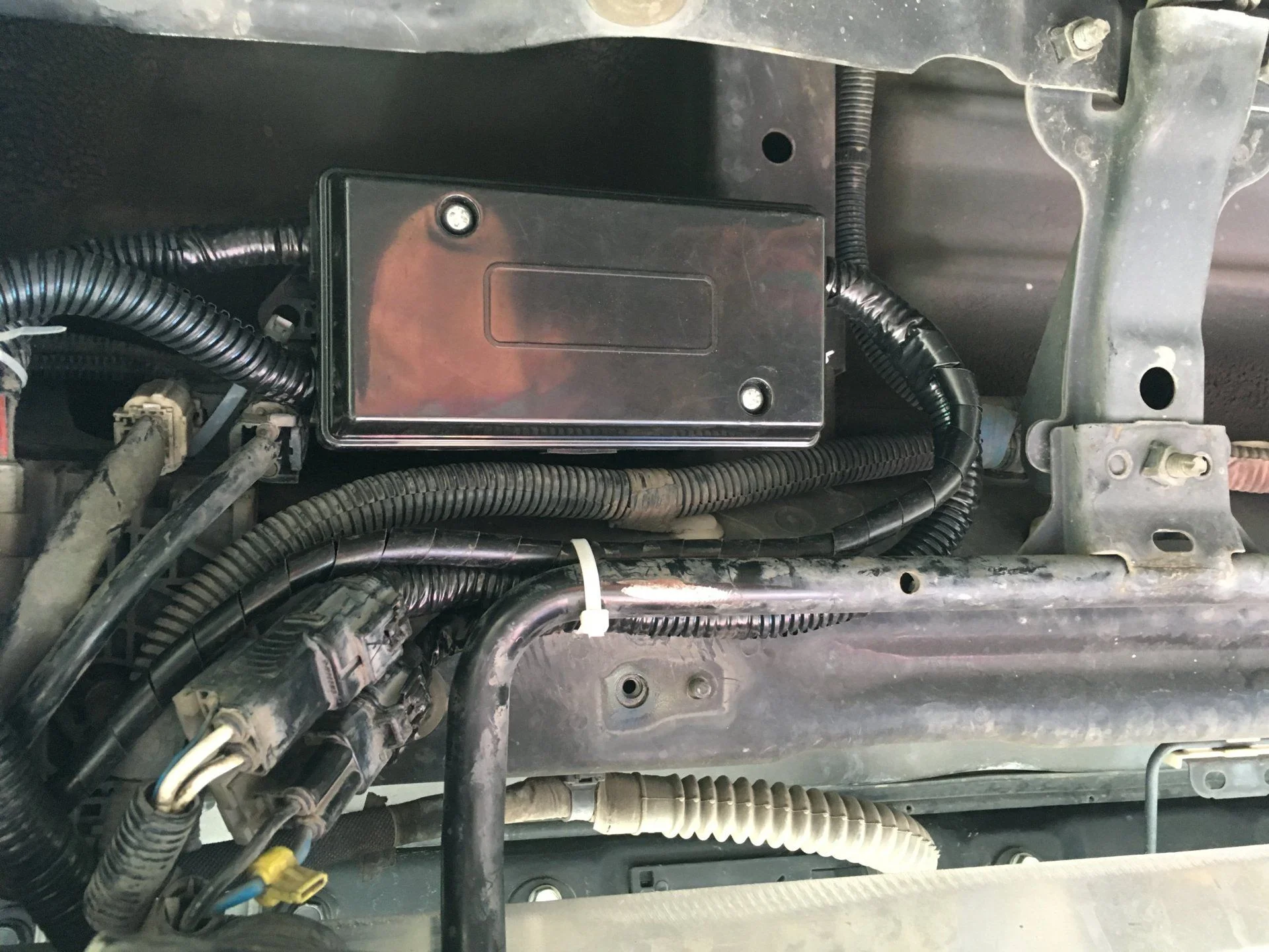

Added a breakout box off the trailer connectors. Wired in the trailer connector, the bumper reverse, and the bumper license and brake. Easy to now add further lights if necessary to the bumper, and for other accessory use.

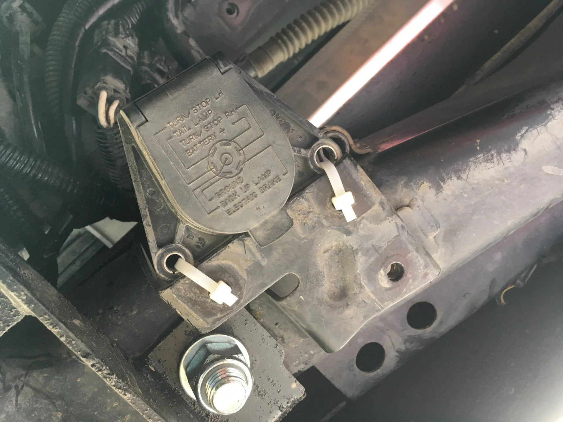

Just took all the bracket off the OEM trailer connector and wire tied it off flat to the mounting bracket. Now it is above the frame. I am hoping it won't block the under spare (if I take off the swingarm), but if it does, cutting two wire ties isn't too much trouble to move it.

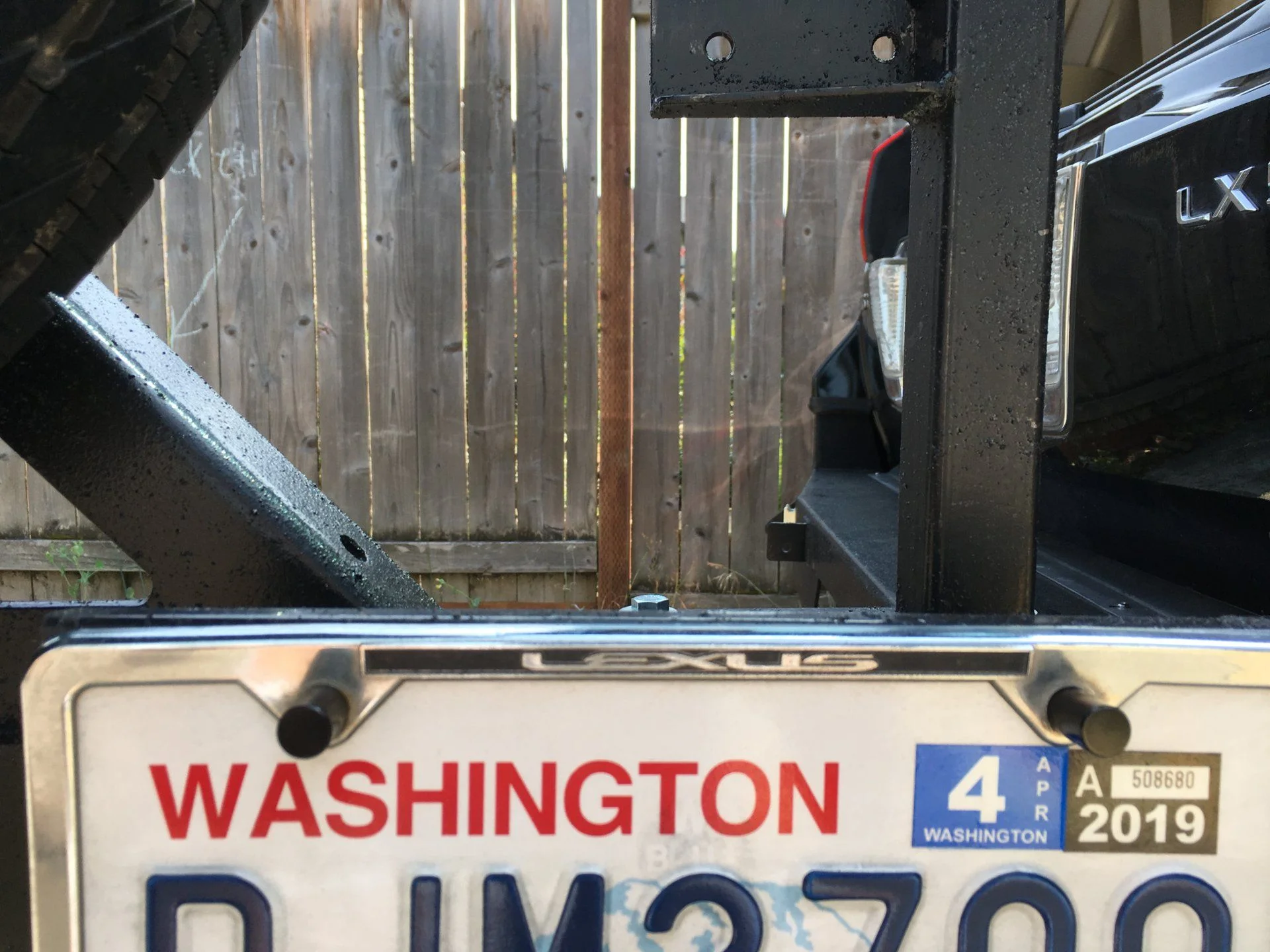

Here are the license lights and the plug I made for the license and brake. I haven't decided if I need a third brake light, so I ran a pin in, but not out of the plug. Easy to add a pin later.

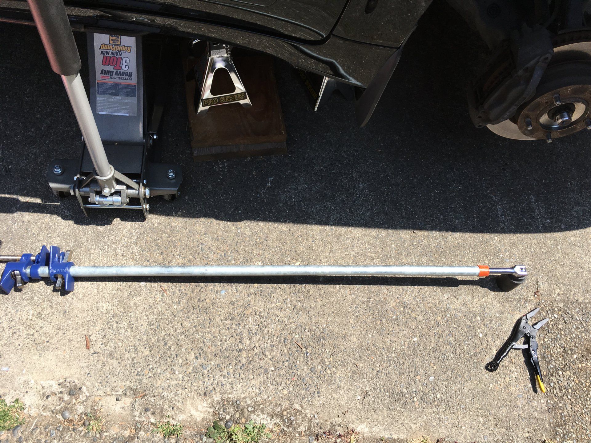

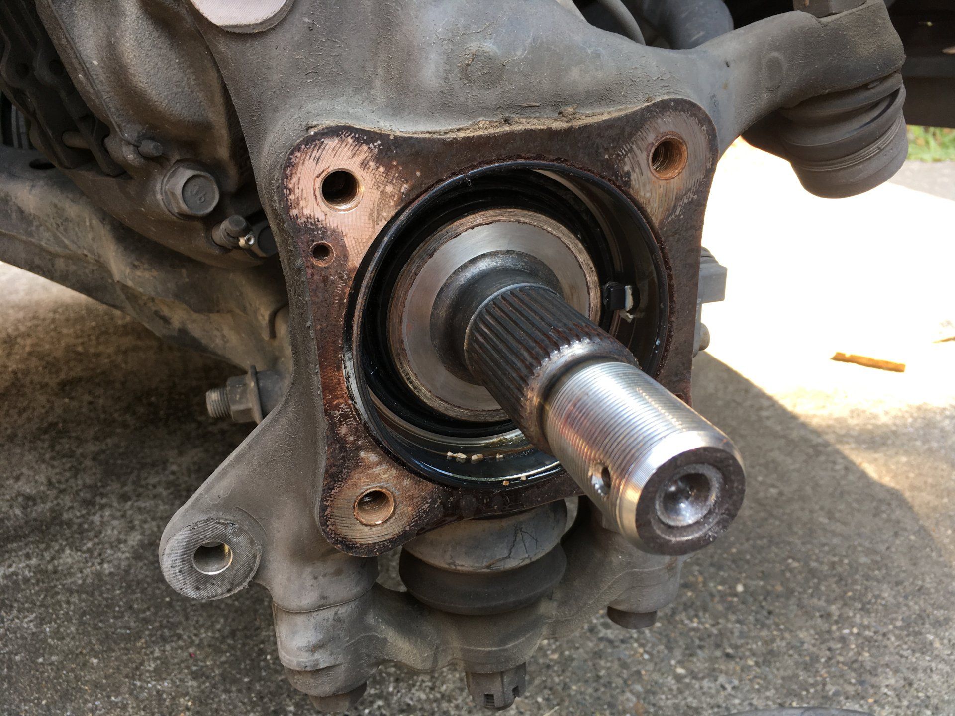

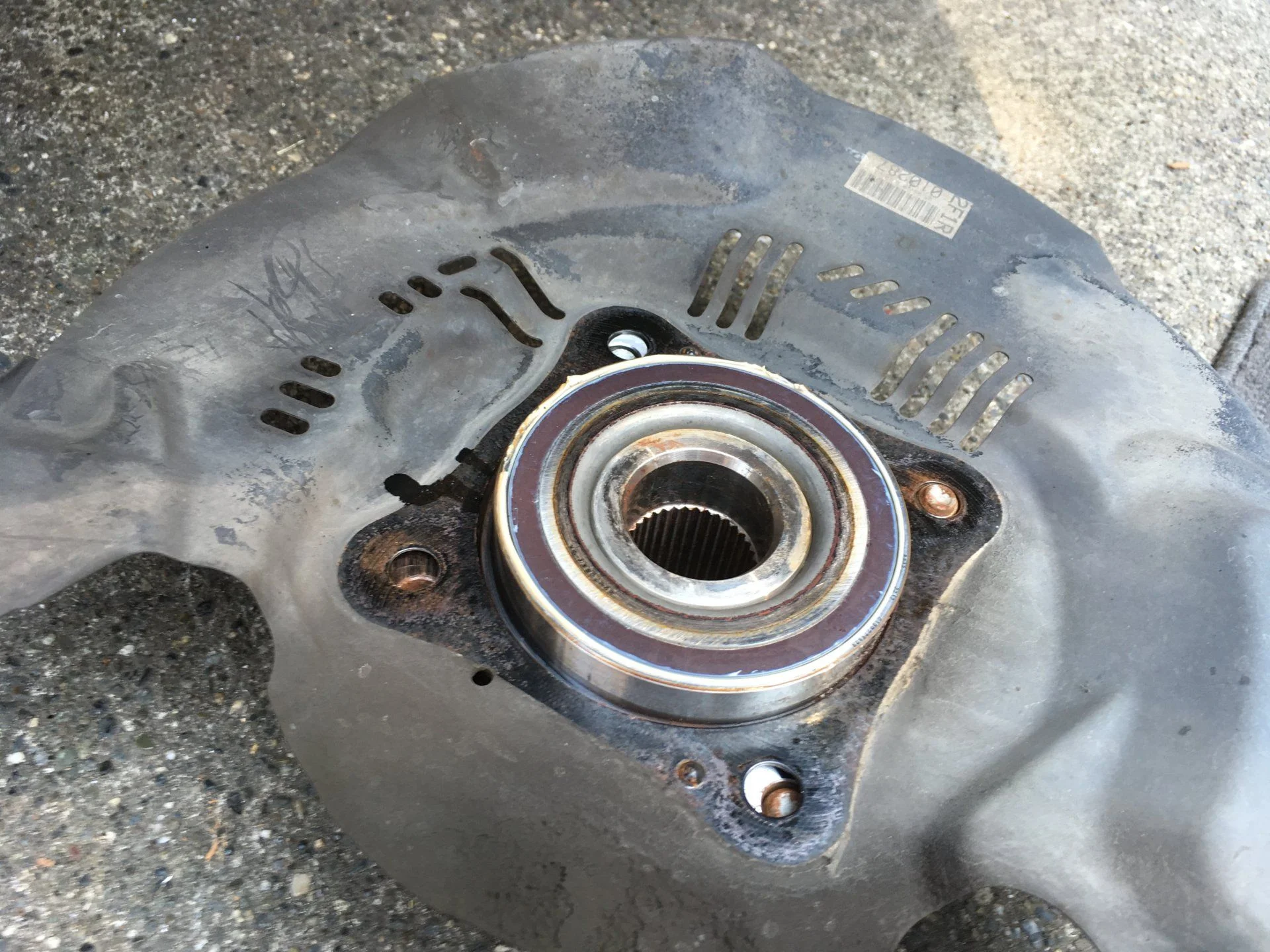

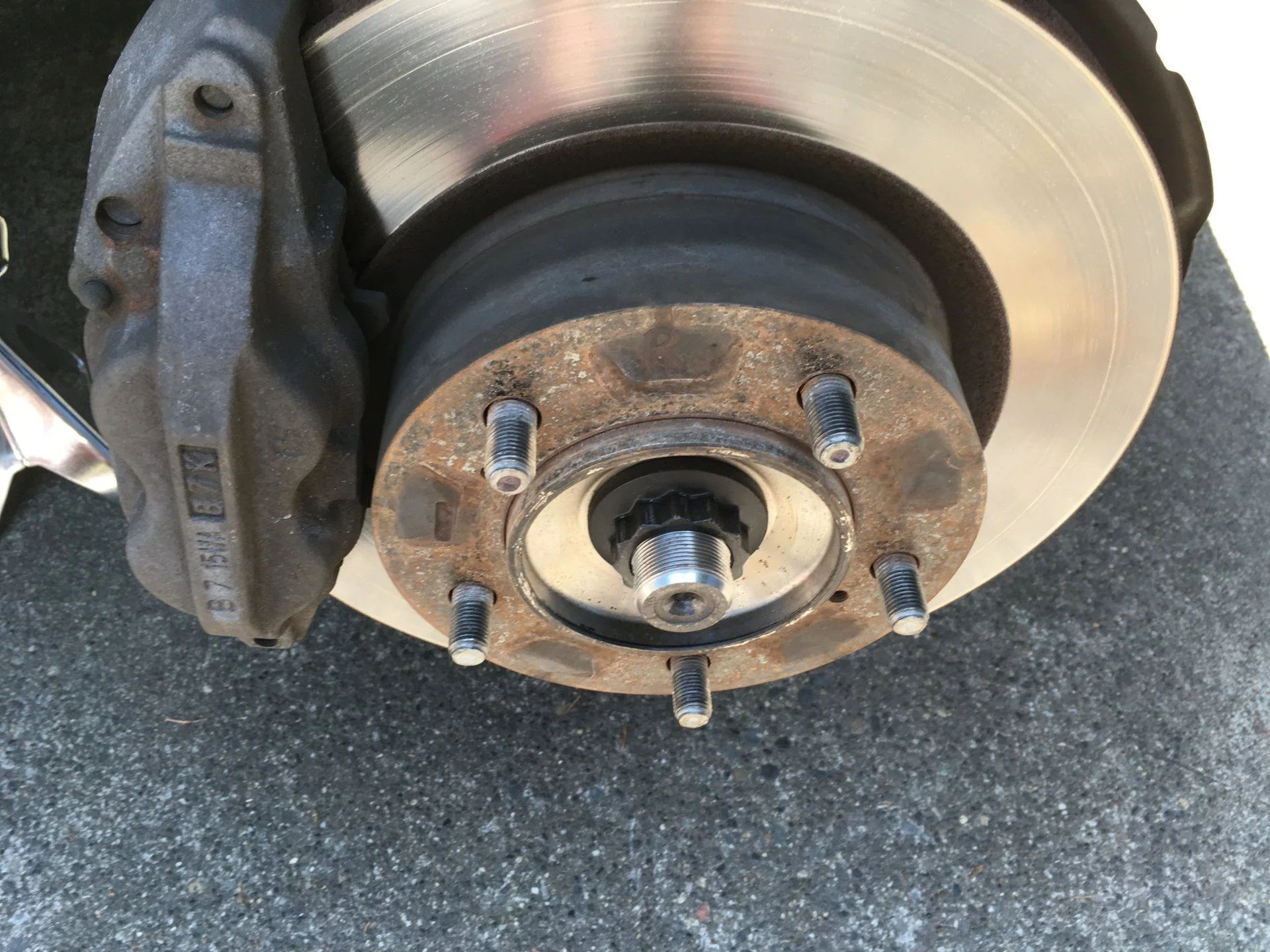

Did the passenger front axle today, hubs, rotors, bearing, metallic pads. Used a four foot pipe for leverage on the breaker bar for the hub. Easy.
Used a two prong puller that I got 25 years ago to do a bmw rear bearing. About 2 hours. Figure the other side will take half that unless it is seized.
Definitely needed it, silky smooth and no vibration from the side of the truck anymore.
