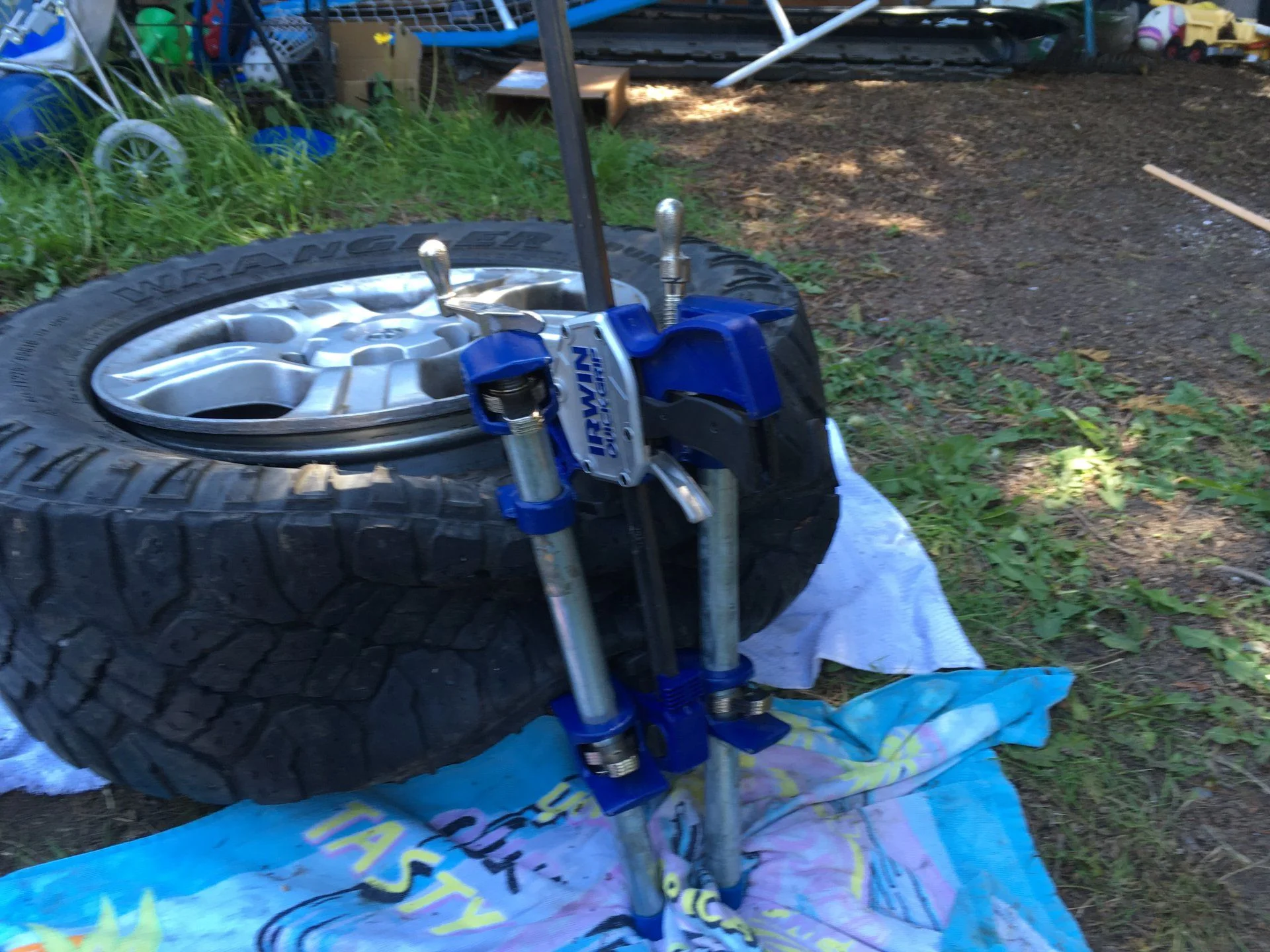

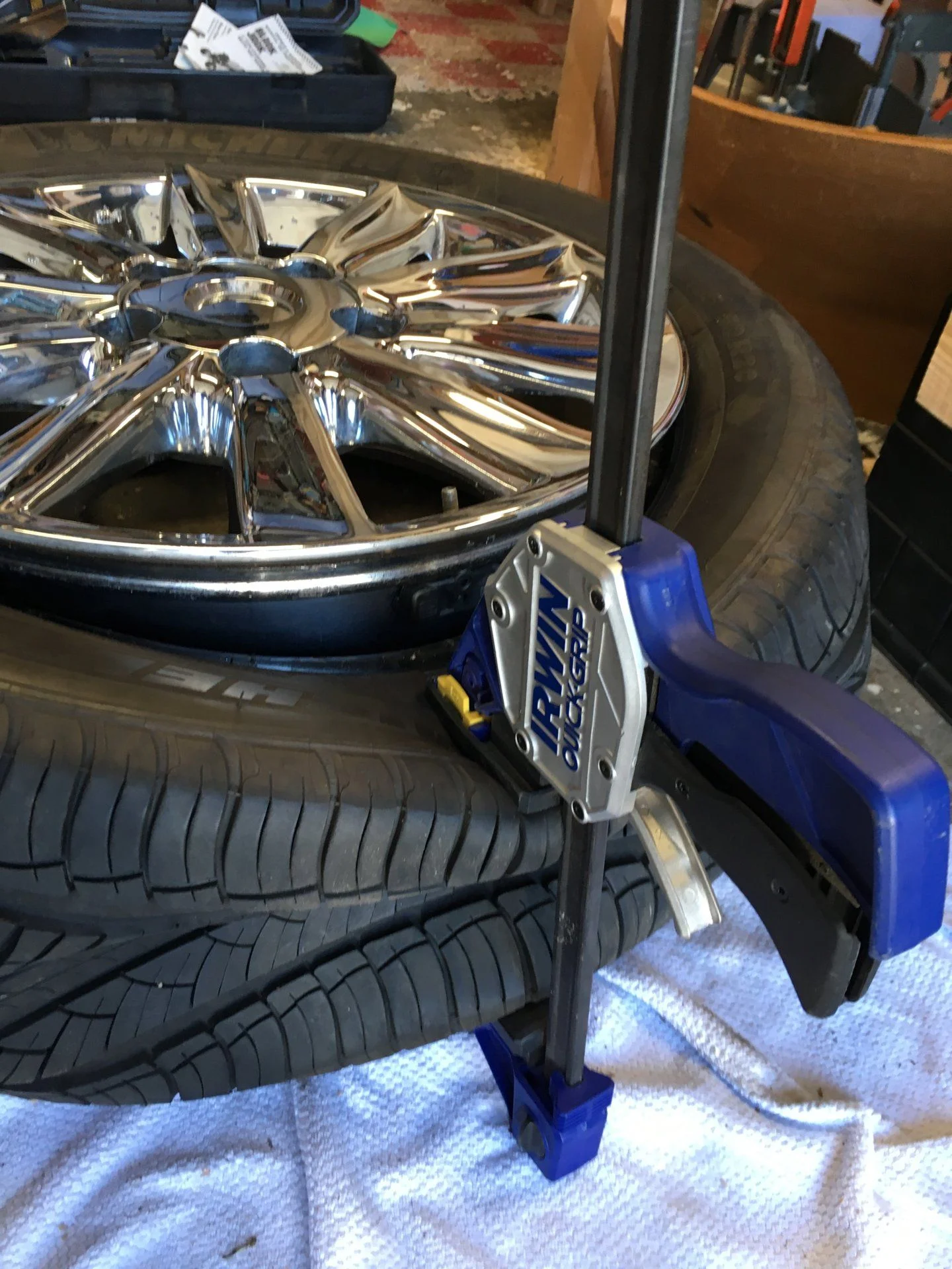

what other ghetto bead break techniques are there?
that's way better than the rube Goldberg I had in mind with a strap and the stock bottle jack

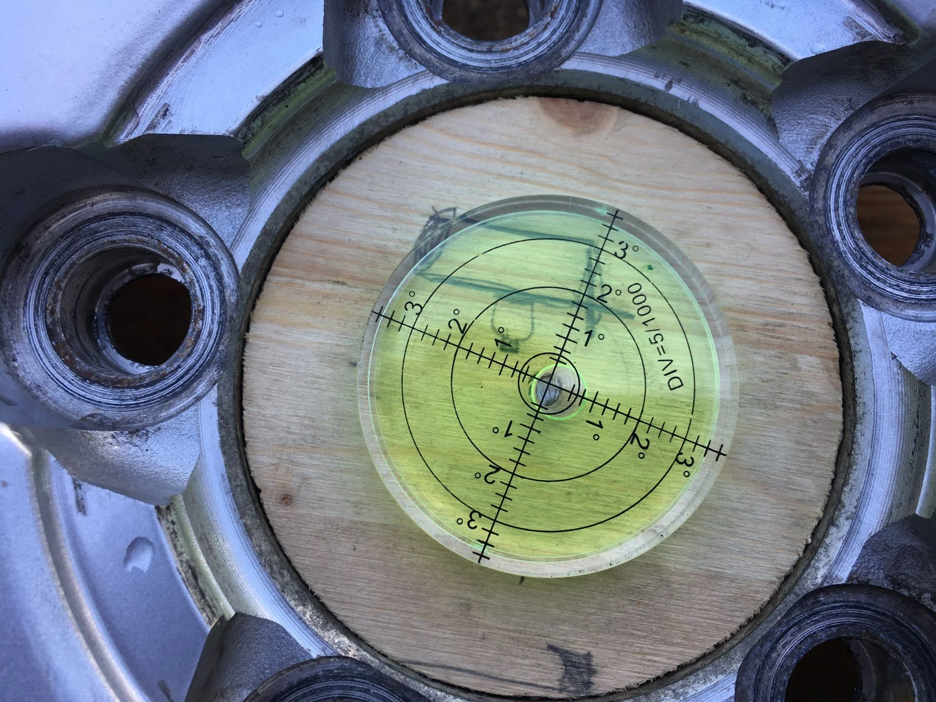

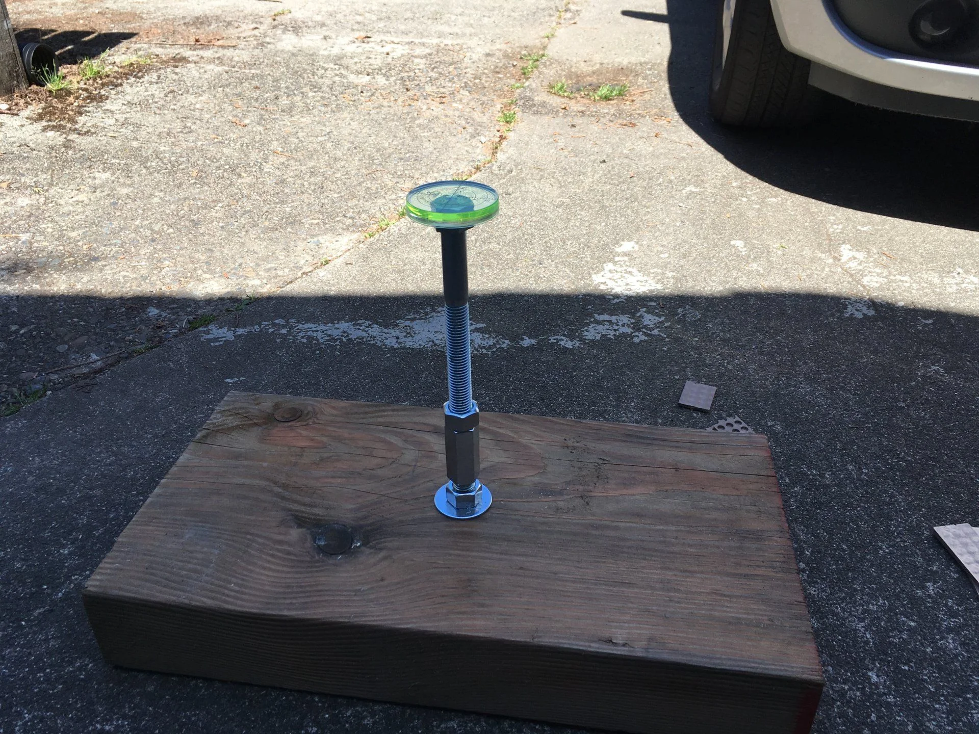

Made a static bubble balancer to check balance on my road CL set. They checked out, so on they went today.

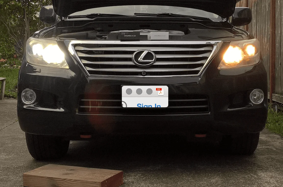

Put in the Hikari LED Hi, Low, and LED marker lights tonight. The high beams are a real tight fit into the housing. I fought with the driver side a long time before I remembered I had some Silicone grease from a plumbing project. Put some on the gasket, and some on the wing pegs and it went right in.
I think the LEDs are probably 3x as bright. This poor photo doesn't do it justice.

I used Cree Hi Philips Lo. They fit fine but both High beams were a bear to get turned. Some silicone grease did the trick. I'm sure there is a spring clip in the housing I didn't understand how to finagle.

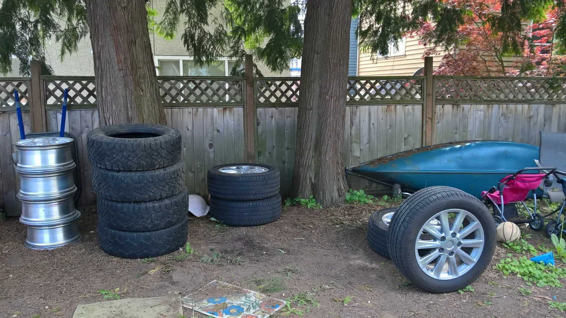

My tire graveyard. See that - it's four rims waiting to be refinished! First dismount -> 1 hour. Last dismount -> 10 min.

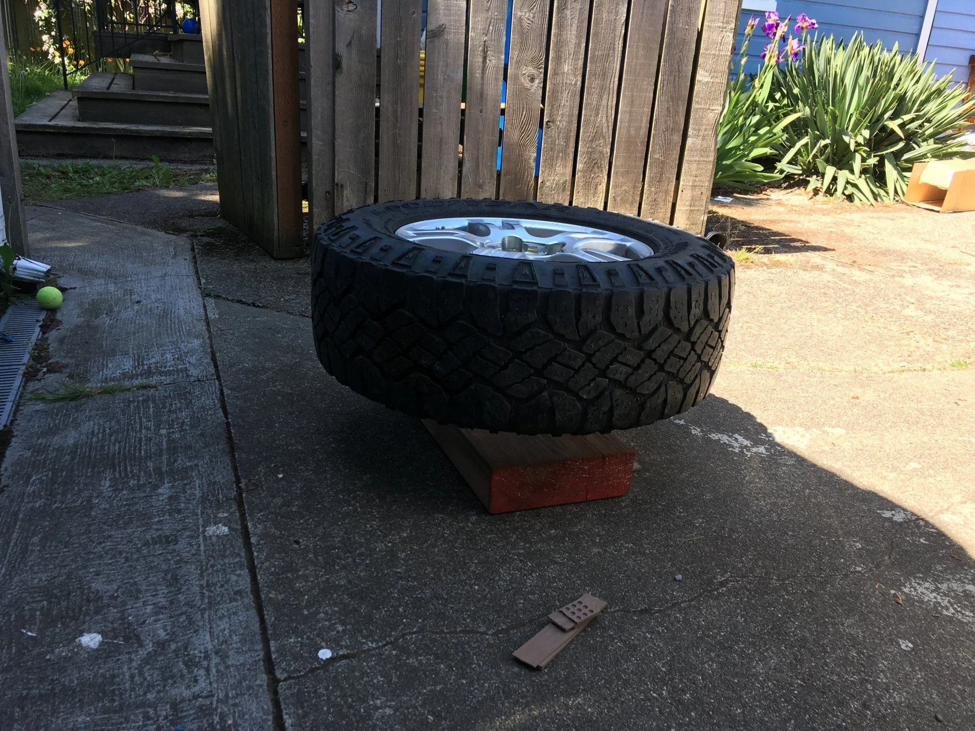

I did get one out and in the new rim and bubble balanced.
Some learnings: a larger floor jack isn’t as good as a smaller one for breaking the bead. The smaller diameter pressure point is key.
Put on the tpms sensor before mounting the tire, an LT tire is much harder to flex then a P tire
I included some pics of my home made bubble balancer, which was about $20 in bolts and bubbles.
