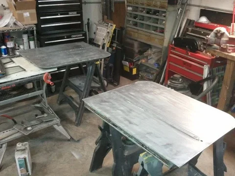

Nekid doors.
Heifer-net
Thanx Aaron.
I continued to work on the doors today. I sprayed the inside with some cheap rust converter rustoleum I had laying around. Got a good coat in the inside bottom. I figure anything is better than what was there. I filled a few small holes with POR15 epoxy - that s*** is the bomb. Once dry I painted the bottom of the doors with por15 as well as the inside of all the window channel and the entire channel that extends into the inside of the door. I removed the vent window locks and sanded and painted the frames. I left the glass in the frames this time. Last time I did a set of doors I removed the glass and replaced the rubber - pita!

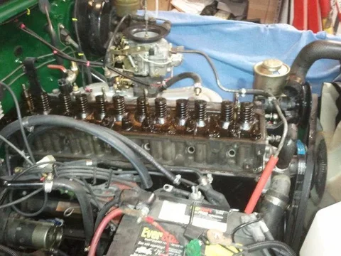

Worked on swapping the head today. Looks like I had two bad exhaust valves.
This is the old one before it came out. :meh:
Got the new one in and torqued down and the manifolds and carb back on. That was a beotch. Chasing the threads in the block was a PITA too. Put the push rods in and the rockers back on. Still need to torque them. And then need to put the t-stat and alternator back on. Almost 8 hours to do what I did. I am pretty wiped.

wow!!! I totally did not expect you would be doing this so soon!!! great job... it is a huge PITA.. trying to lift the head on there and lean over the truck and not mess up the head gasket. did you do that by yourself. I was under the impression you were not that strong? :-)
I certainly am not that strong. I attached the front to the cherry picker and :princess lowered the front as I manhandled the back in place. Pretty sure I did not do any damage to the HG but it was touch and go there for a bit.
