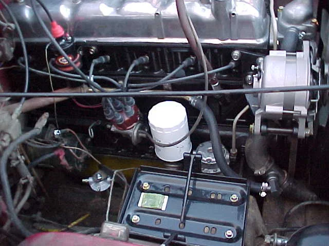

engine bay is almost done. Cooling system is buttoned up. Alternator wires extended to the passenger side. Rebuilt dizzy and pertronix installed. Carb rebuilt and installed. Just need to finish those fuel lines and build a temporary exhaust.
Lookin good so far! Need MORE pics of......."THE" FJ45 buildup :)
Sharp looking motor there! Nice build!
