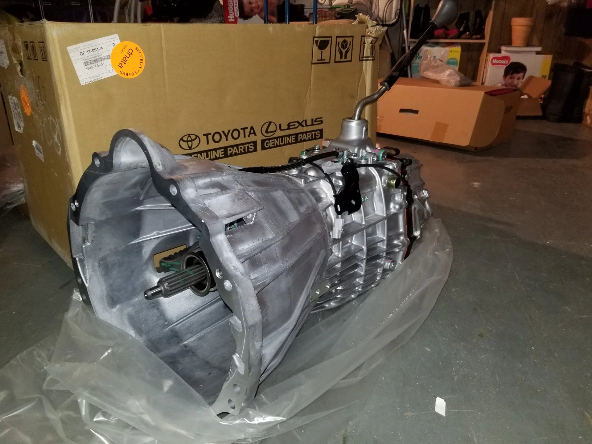

And the brand new H152F
If it helps, 360 Degree gearboxs (here in Aus) can also supply an overdrive 5th for an H151F to lower RPM in 5th only. H151F as you'd know was the factory fit behind 1HDFT's. Not sure what bellhousing config you have on the box above but it sure looks purty :) With the starter in the middle of the V yeah it looks like a VDJ config for sure.
This really doesn't need to be said, but wow! that's an awesome story, and a real gem you've got there. Truly appreciate the time you've put into detailing the work done and planned. I'd really like to be able to put a diesel into my cruiser but I don't think just following build threads I'd have the nads to do it. giddy up!
There is also a 5th gear kit sold by Terrain Tamer, i believe. I knew about those kits, but there were a few problems with them for me:
1) Replacing the counter shaft (which is part of those kits) would mean that i would have brand new gears on the counter shaft meshing with worn gears in 1-3rd gears. This could (and probably would) lead to less than ideal gear contact between those gears.
2) Didnt want to go with aftermarket parts when original Toyota is available.
3) H152 also has the shorter first gear (compared to H151), which was an extra reason to go with H152 over modified H151.
A regular H150/H151 bellhousing (with starter on the left side) bolts up to H152. The bellhousing on the picture is the original one for 1VD that the tranny came with (it's for sale BTW, if someone needs it)
