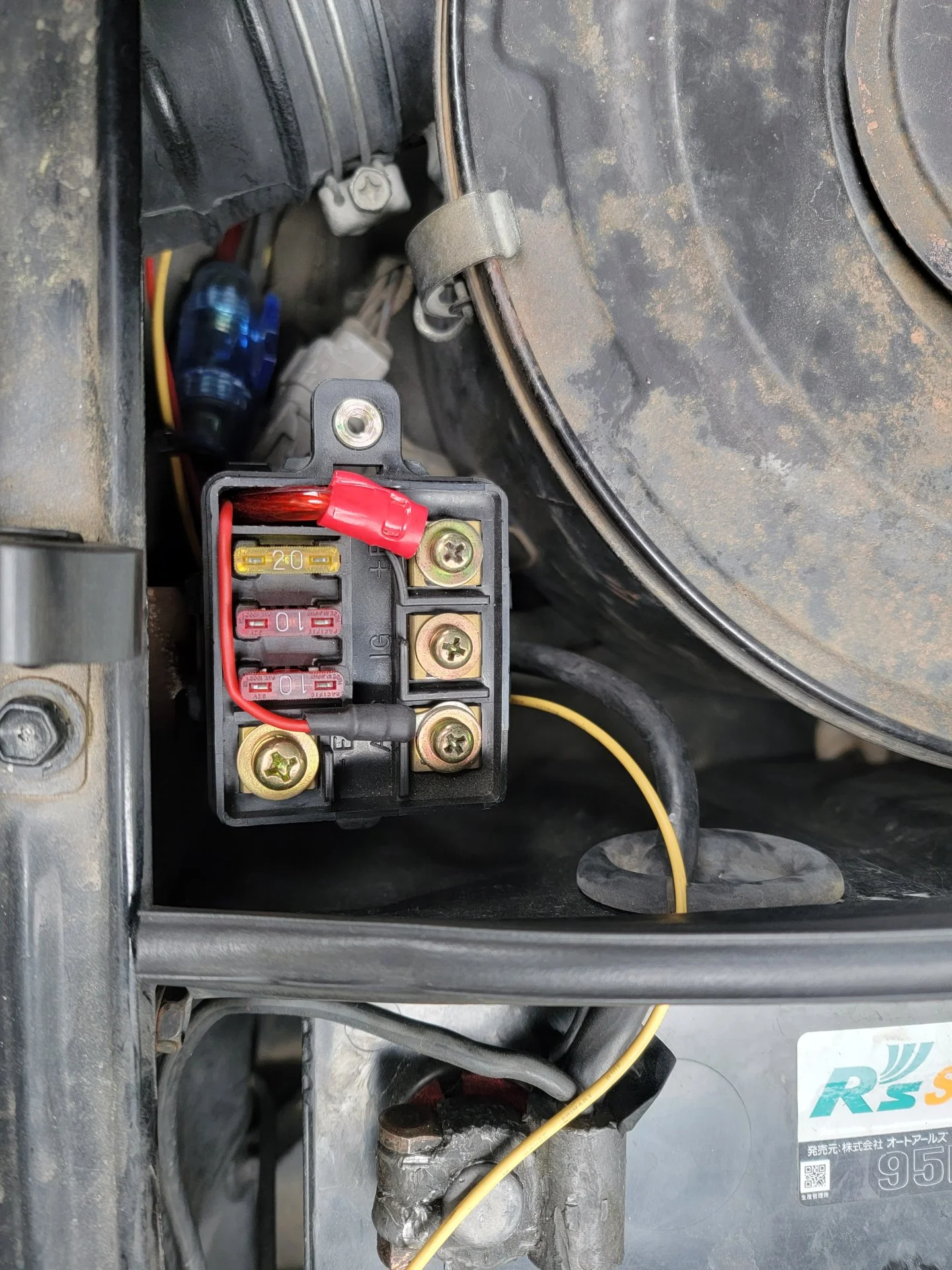

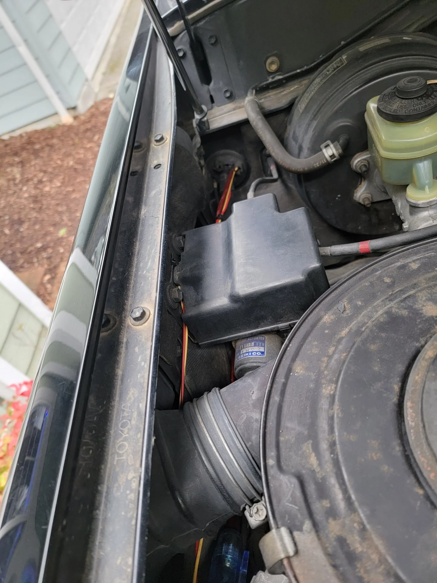

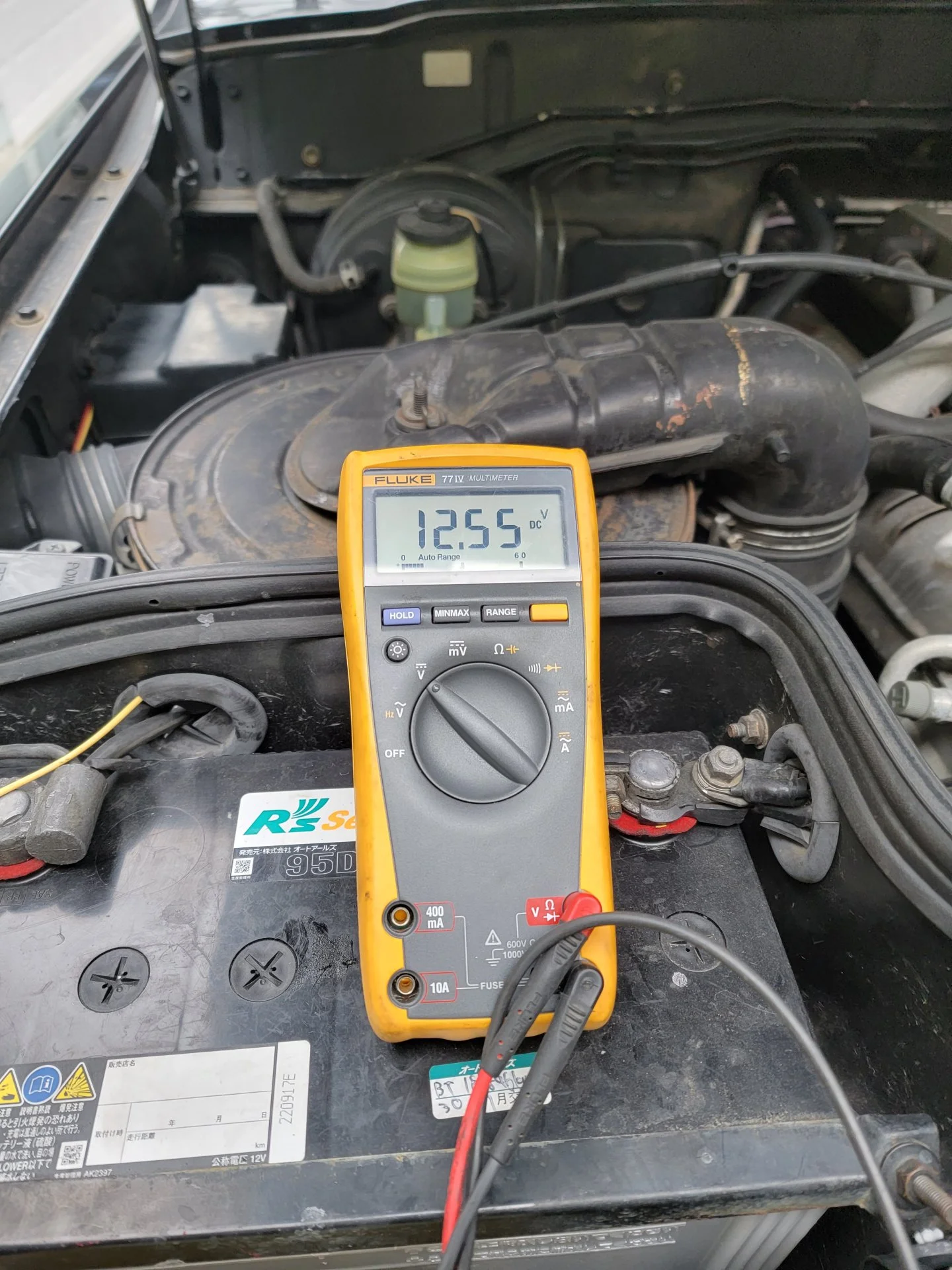

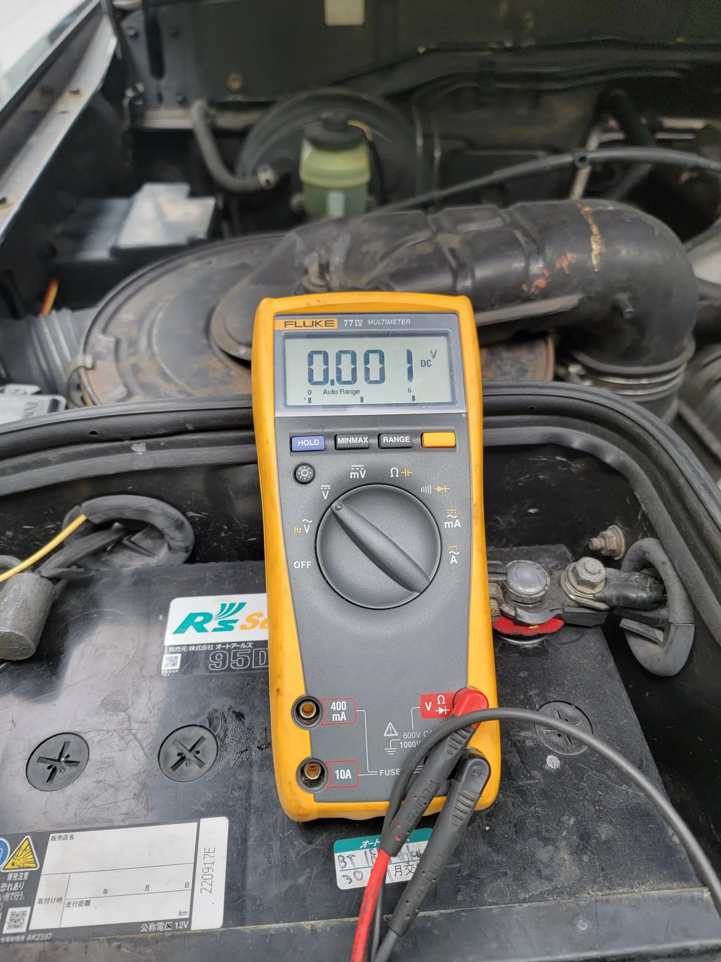

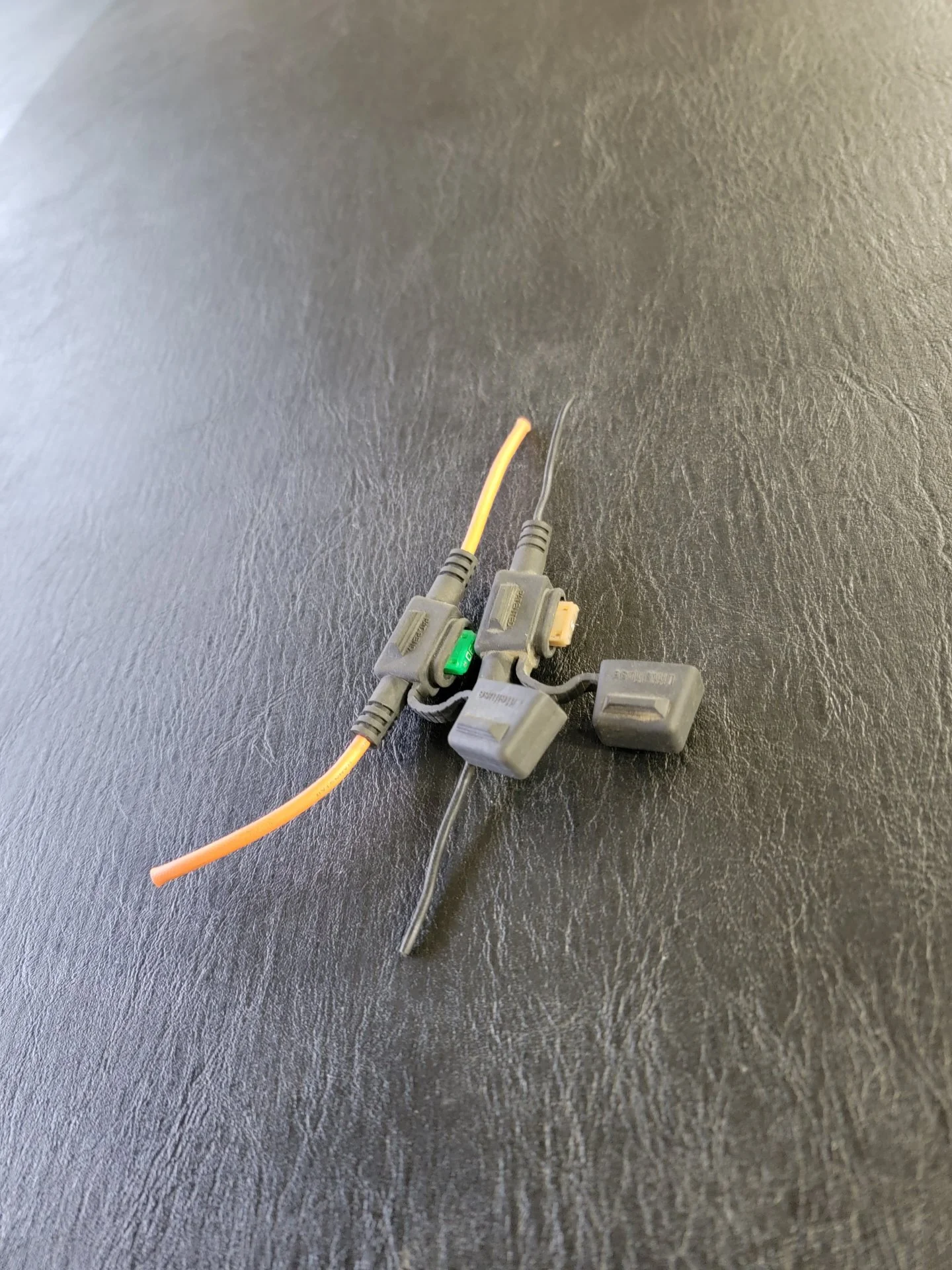

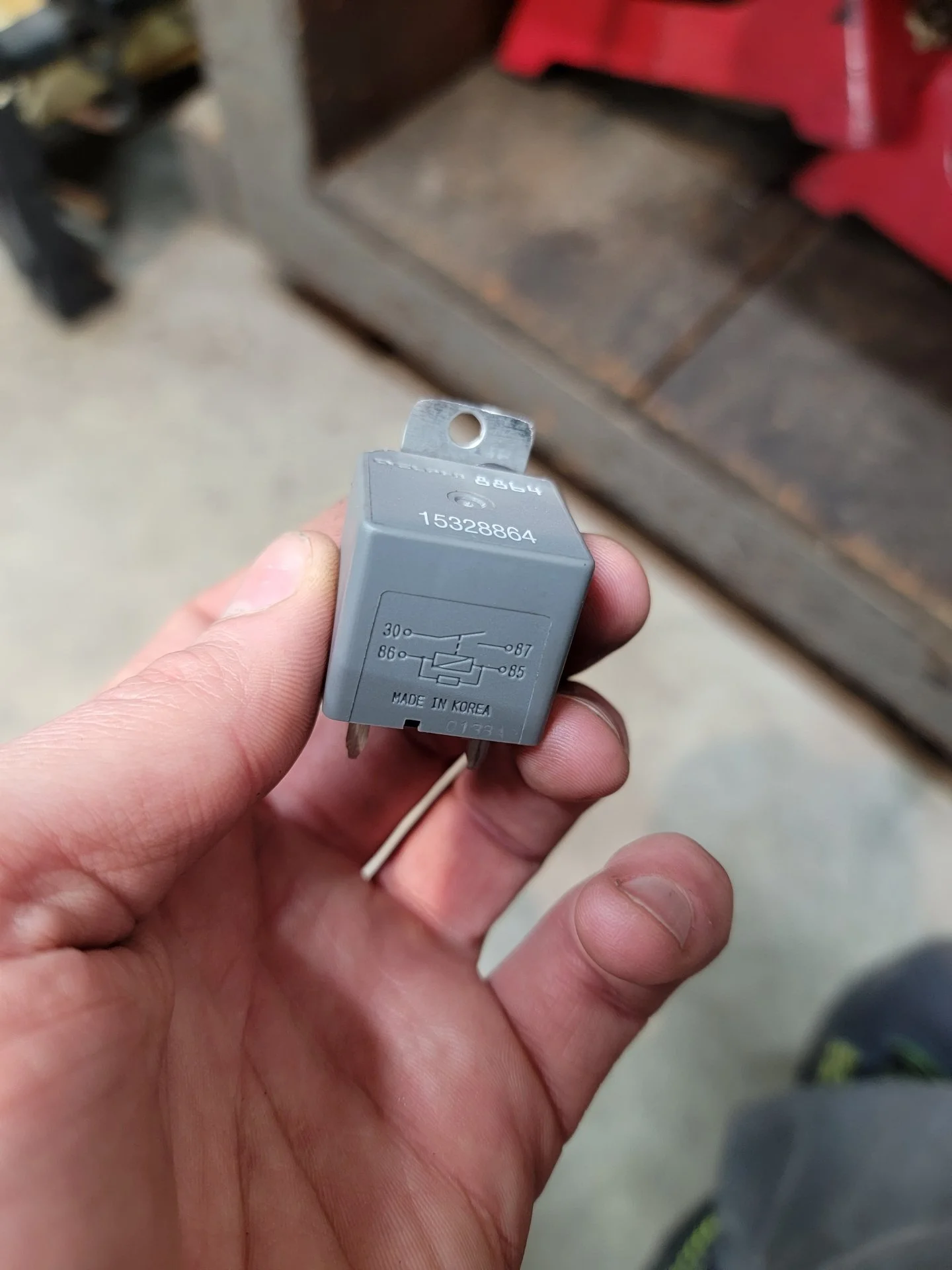

In preparation for my bumper and Baja squadron lights I looked into wiring
Baja wants like $70 for a harness. Can't pay that for something I can build with stuff in my shop.

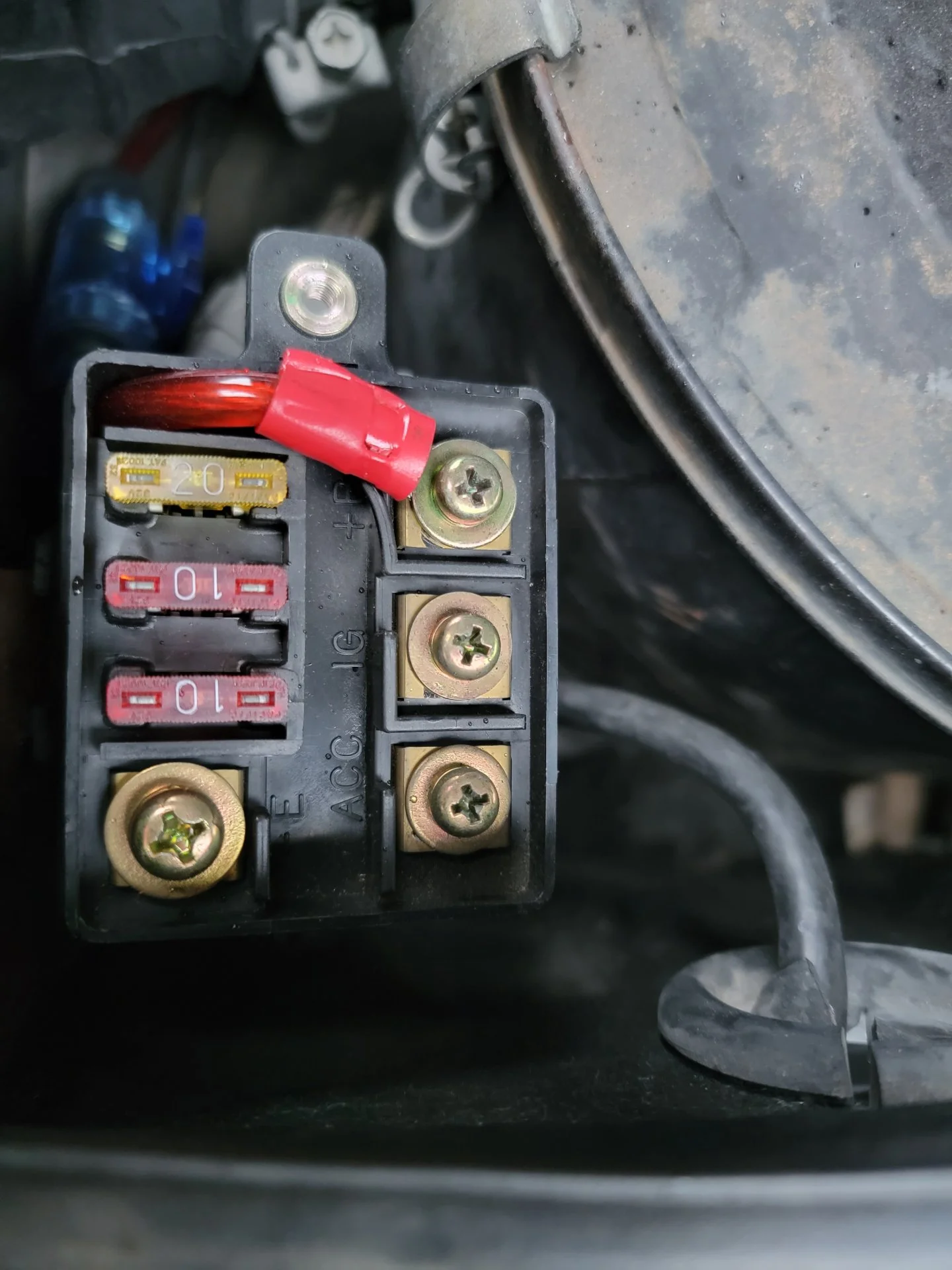

Grabbed a relay, switch, a couple inline fuses and started mapping out how it'll run.
I'm going to use my underhood power point.
I'll run constant to the relay and switched power off acc to the switch.
5 amp inline for the switch and 30 amp for the lights. I had to run to Napa to get the connectors to mate up with the lights.
I'll build the harness tomorrow as I have to work shortly.
This stuffs super simple, but it's nice to work on things that aren't broken.

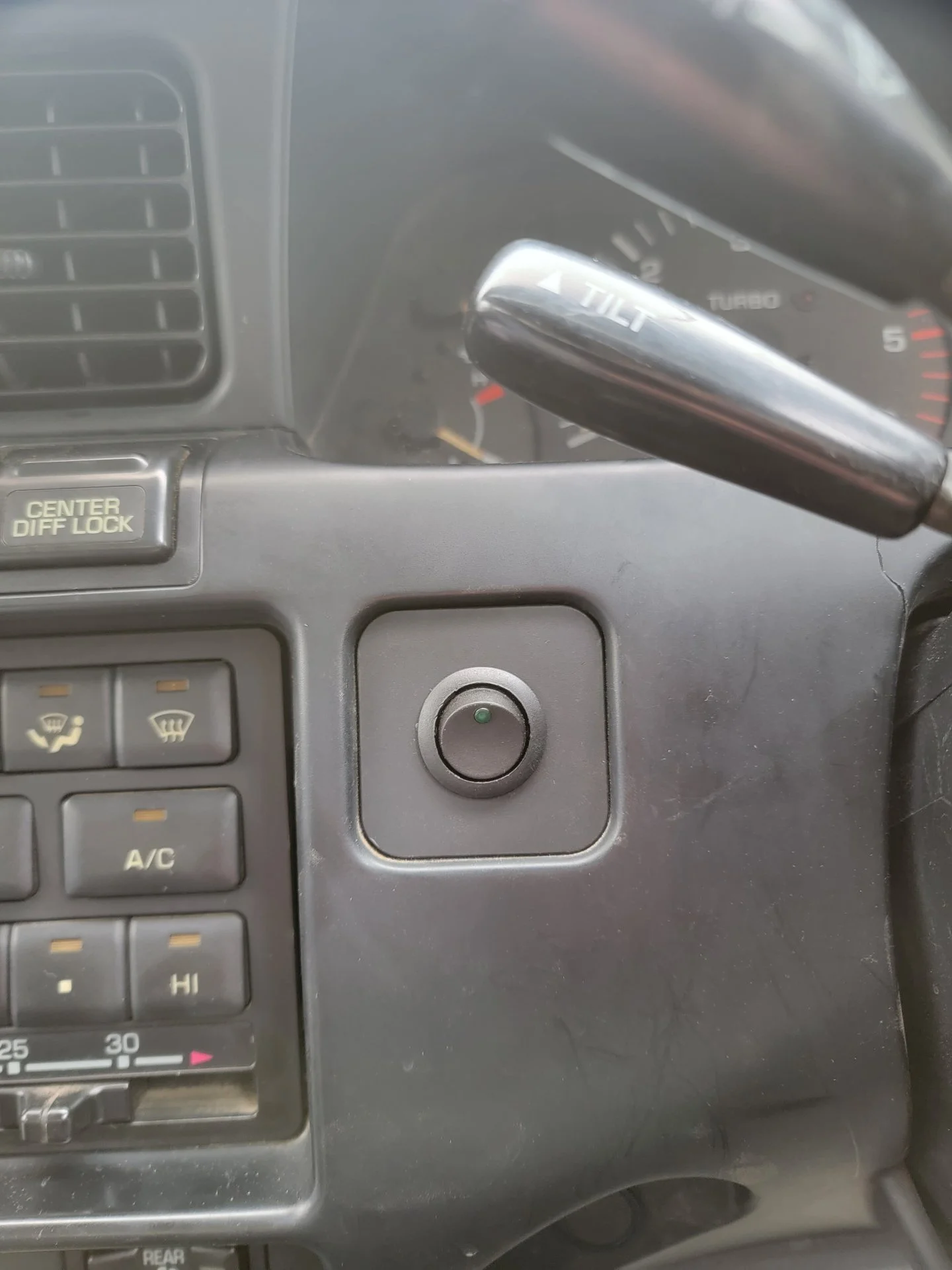

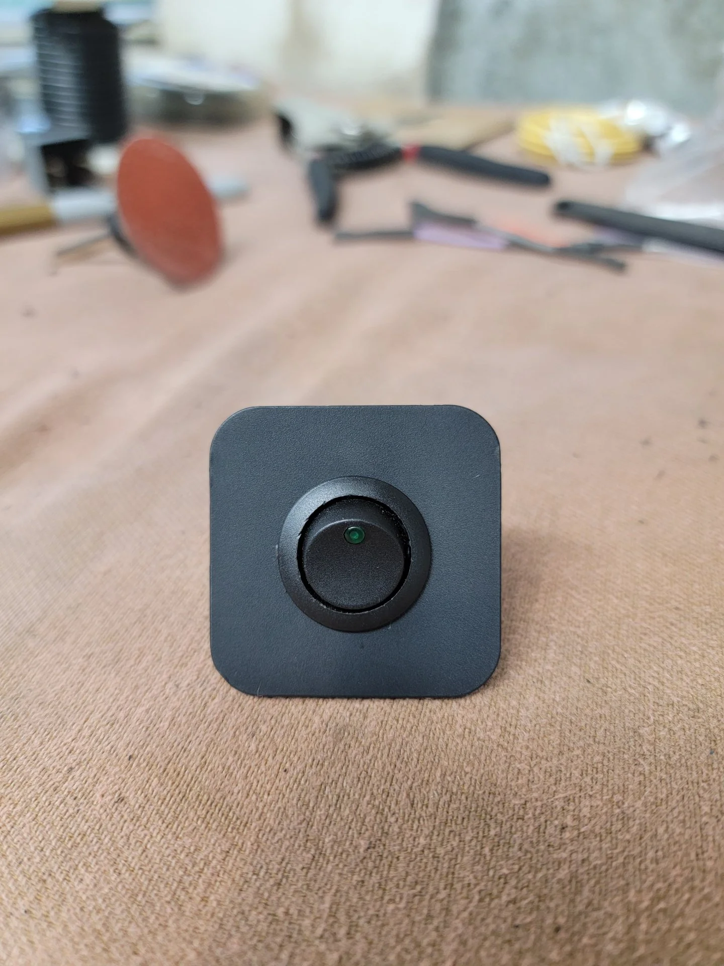

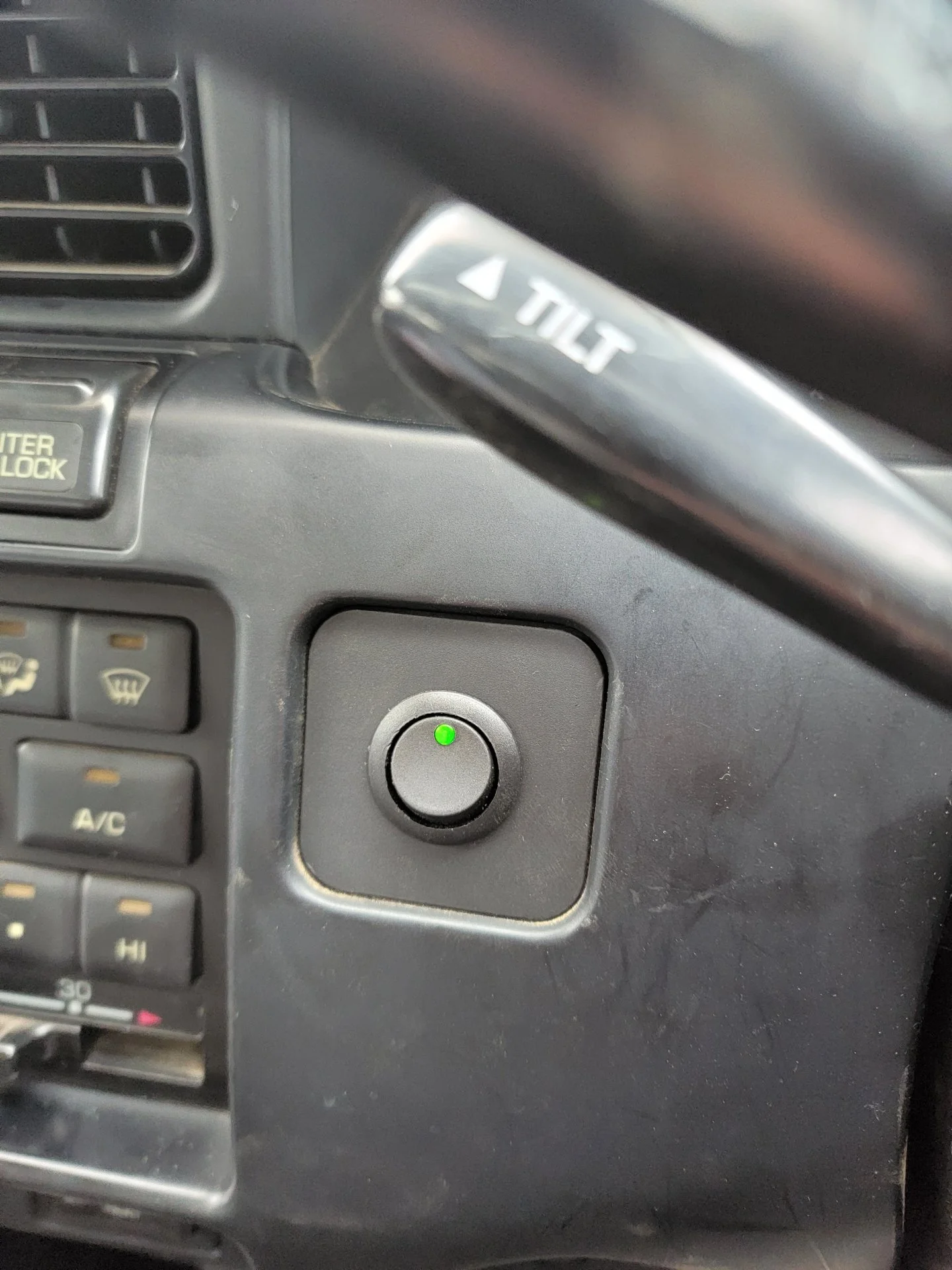

I mounted the switch and wires it up. I made a small bracket for the relay. I'll mount and wire the relay tomorrow and just leave a hot lead for when the bumper gets here and I know exactly where the lights will go.

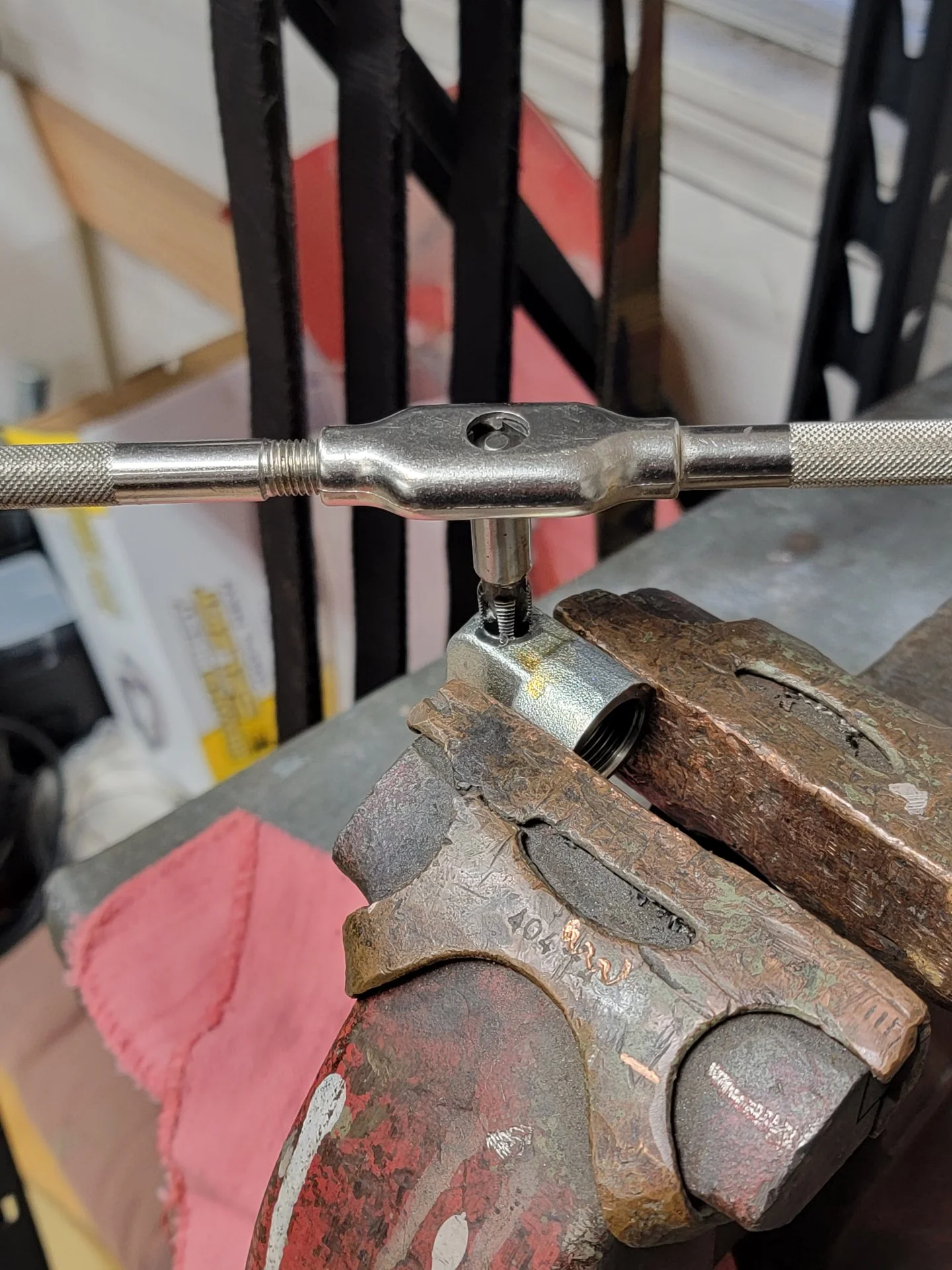

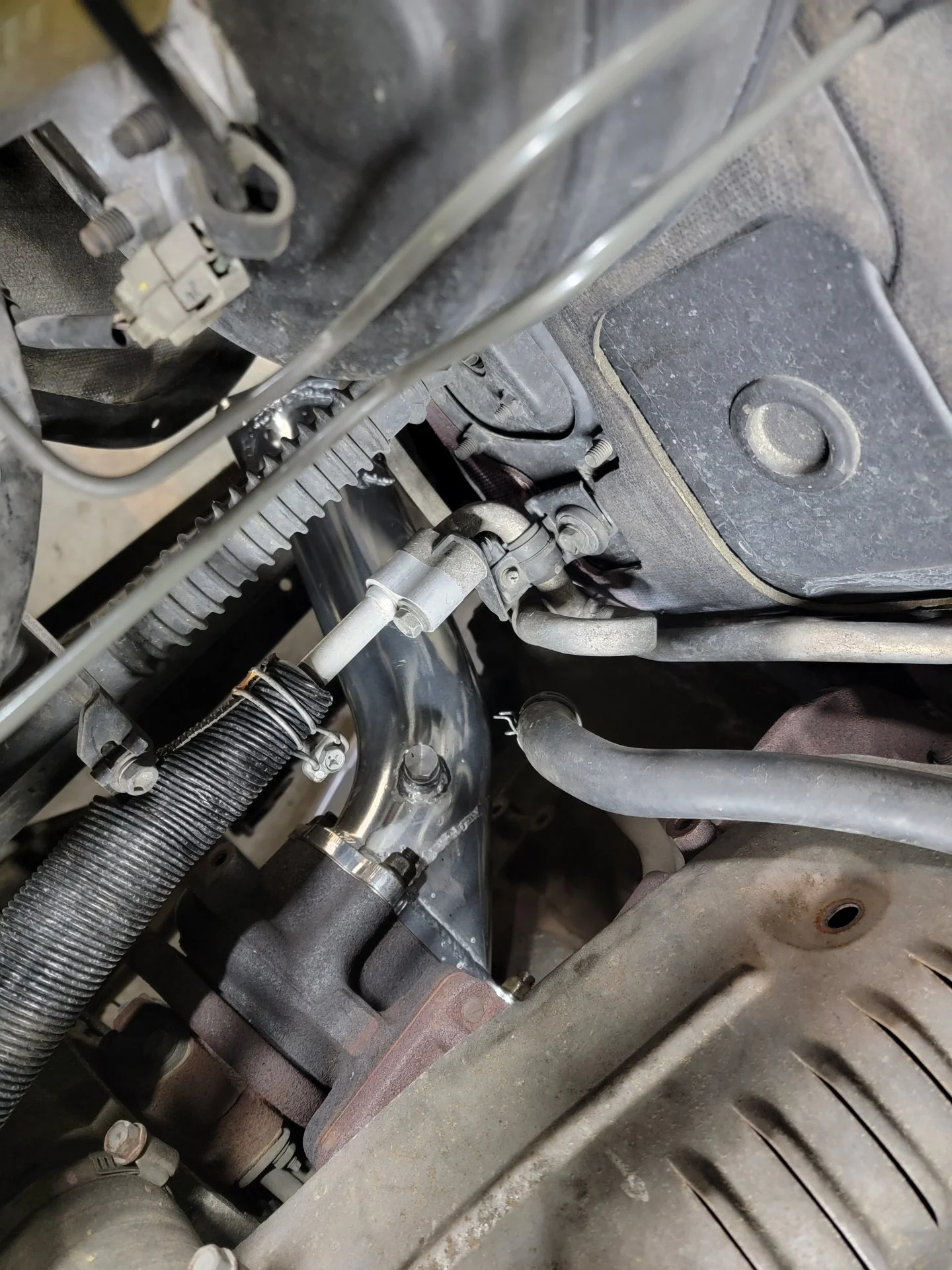

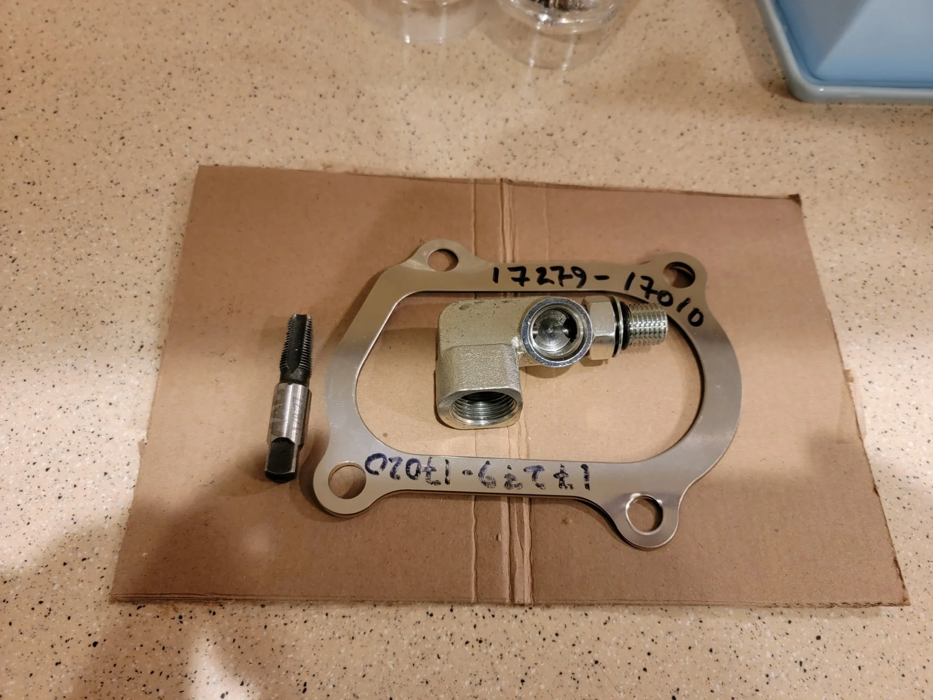

I'm going to bypass the radiator. Install a larger transmission cooler and run -6 an braided hose with an fittings. I also plan to install a temp gauge. So I picked this up from radd cruisers. It's a stock union that's drilled for a 1/8 npt sending unit. I tapped it. Also pictured is my new dump pipe gasket.

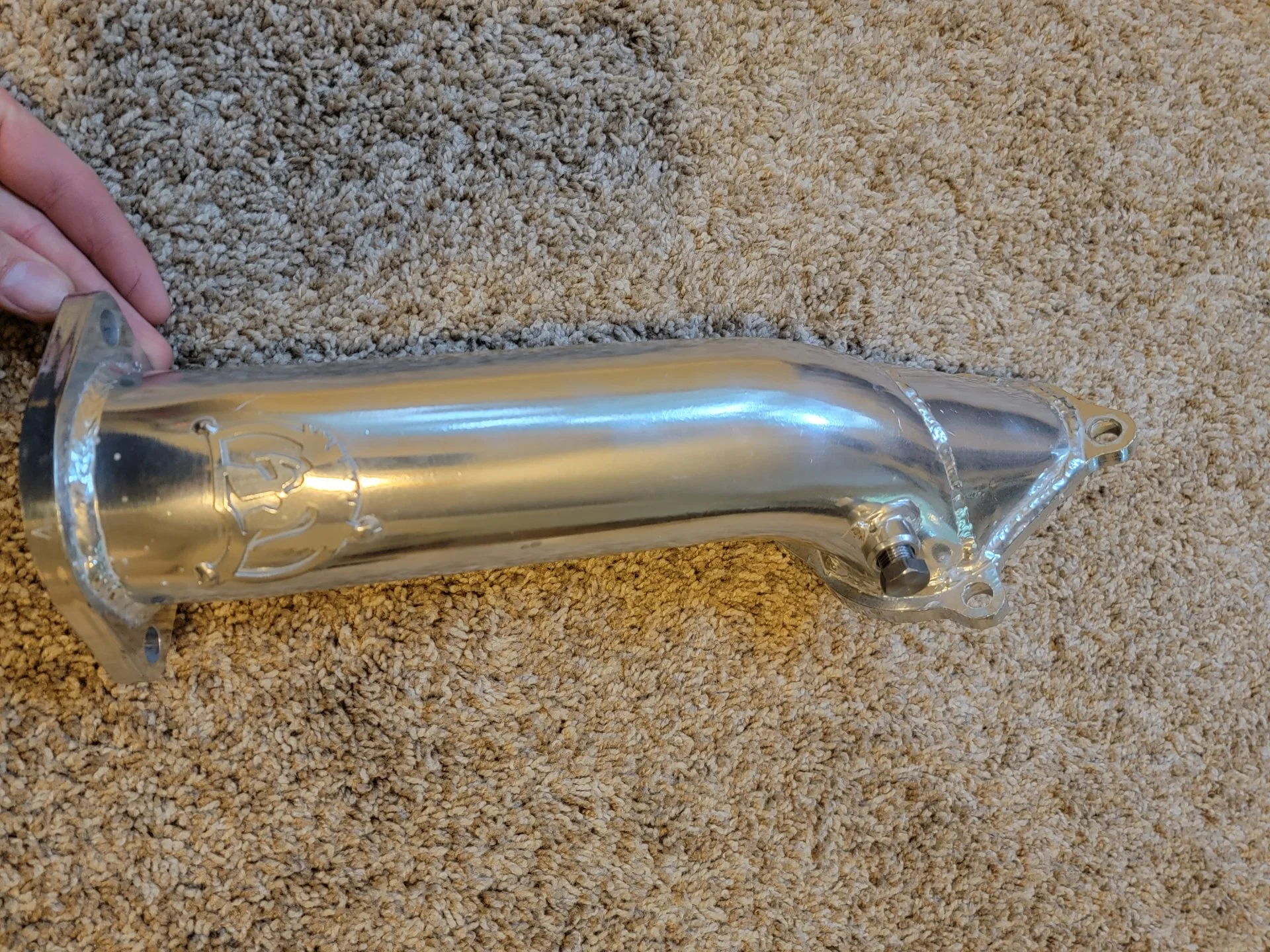

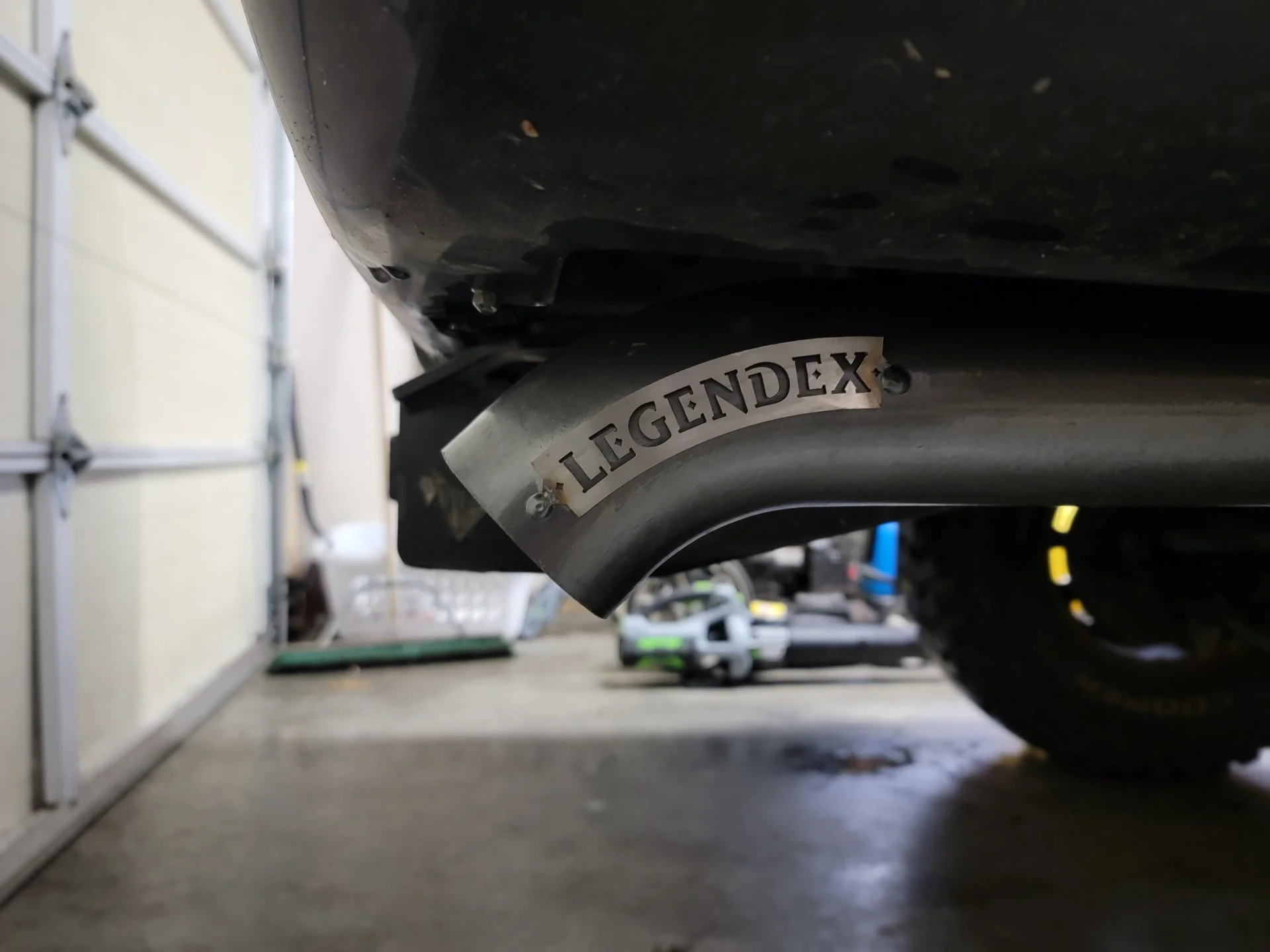

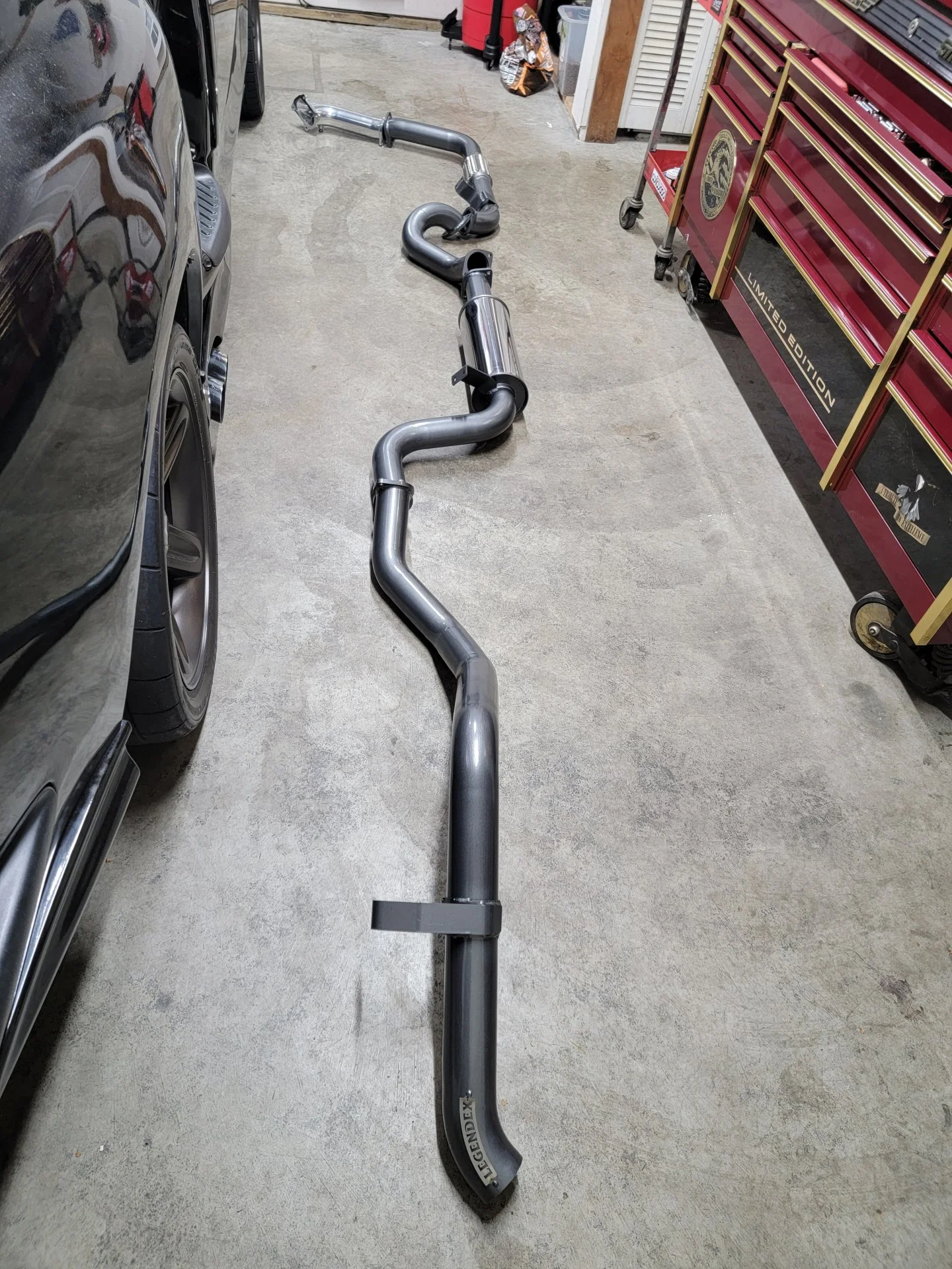

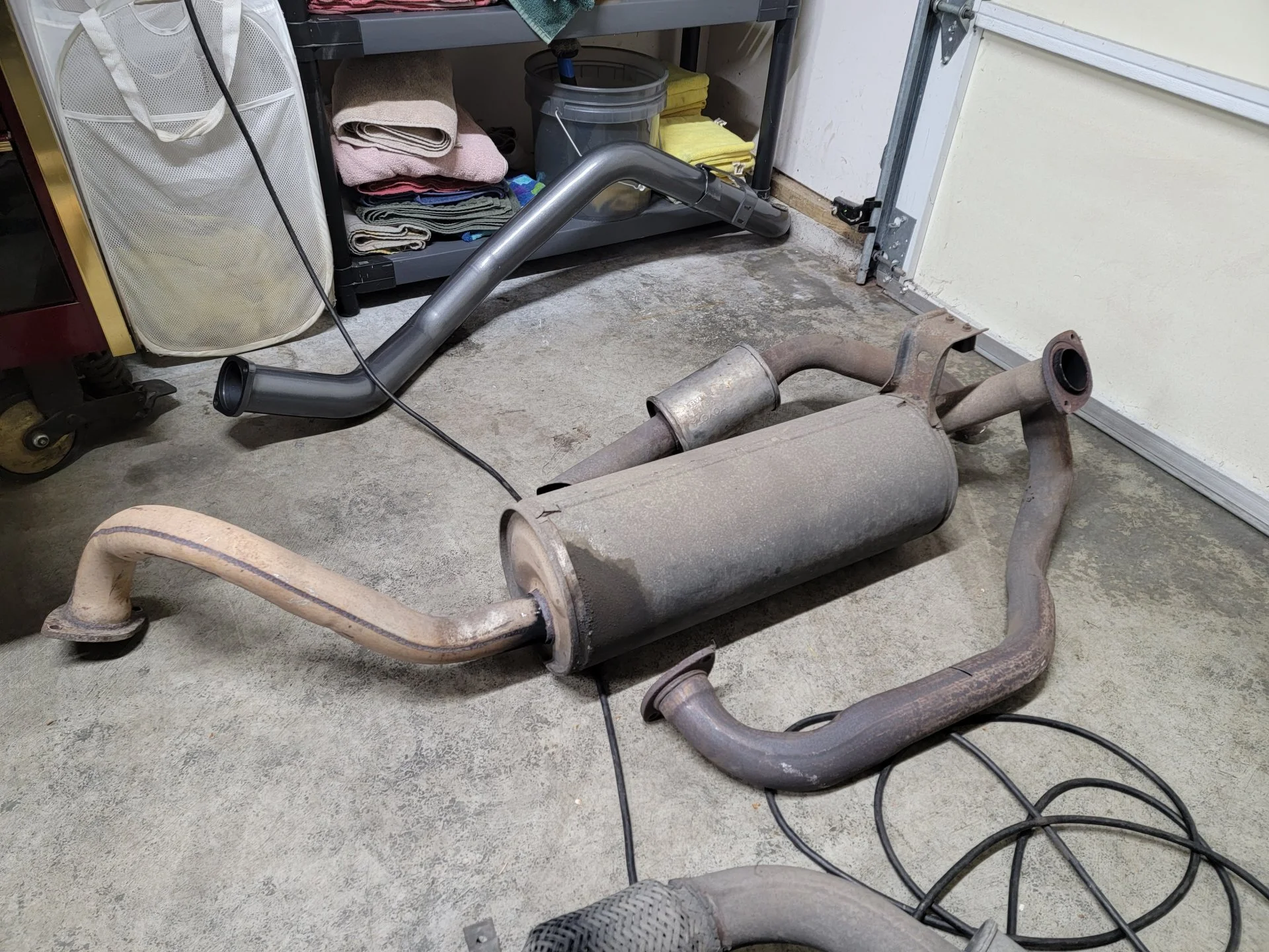

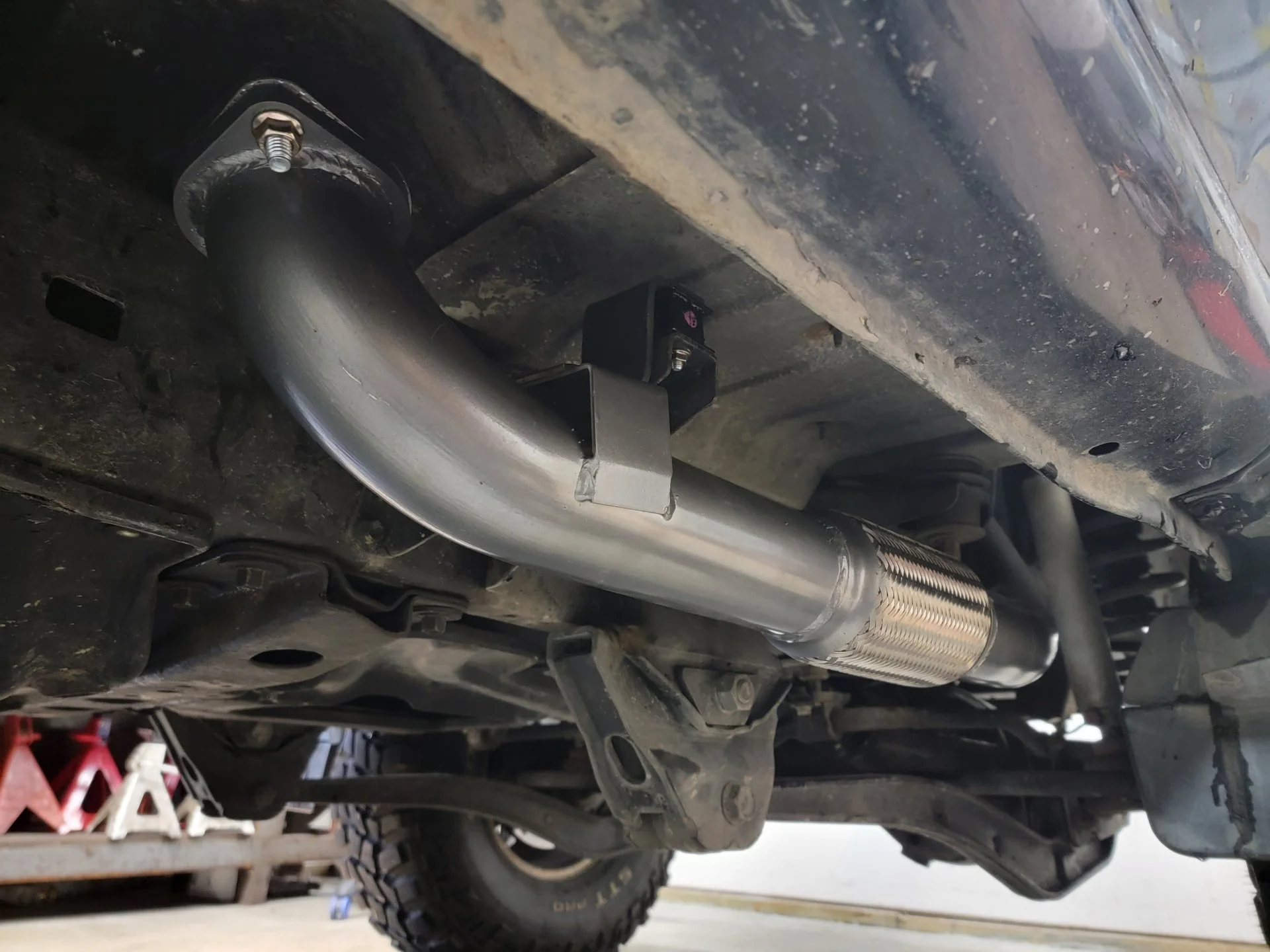

This morning my 3" legendex exhaust showed up from Australia.
Superior 4x4 had a fair price and shipping and got it here fast.

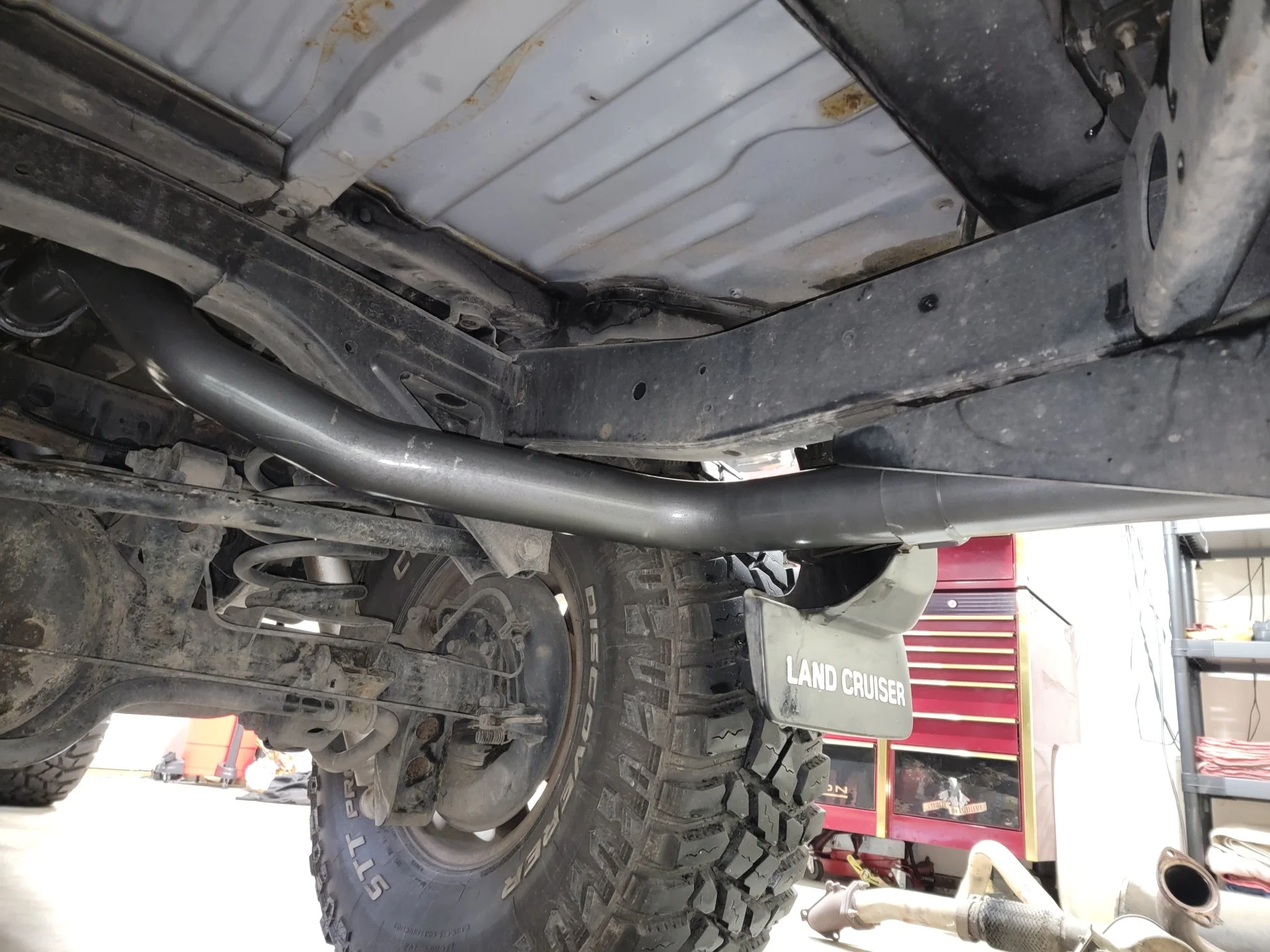

The install was obscenely easy. 2 hours start to finish. It's a huge improvement over stock. I do wish it was inside the frame rails, but oh well.

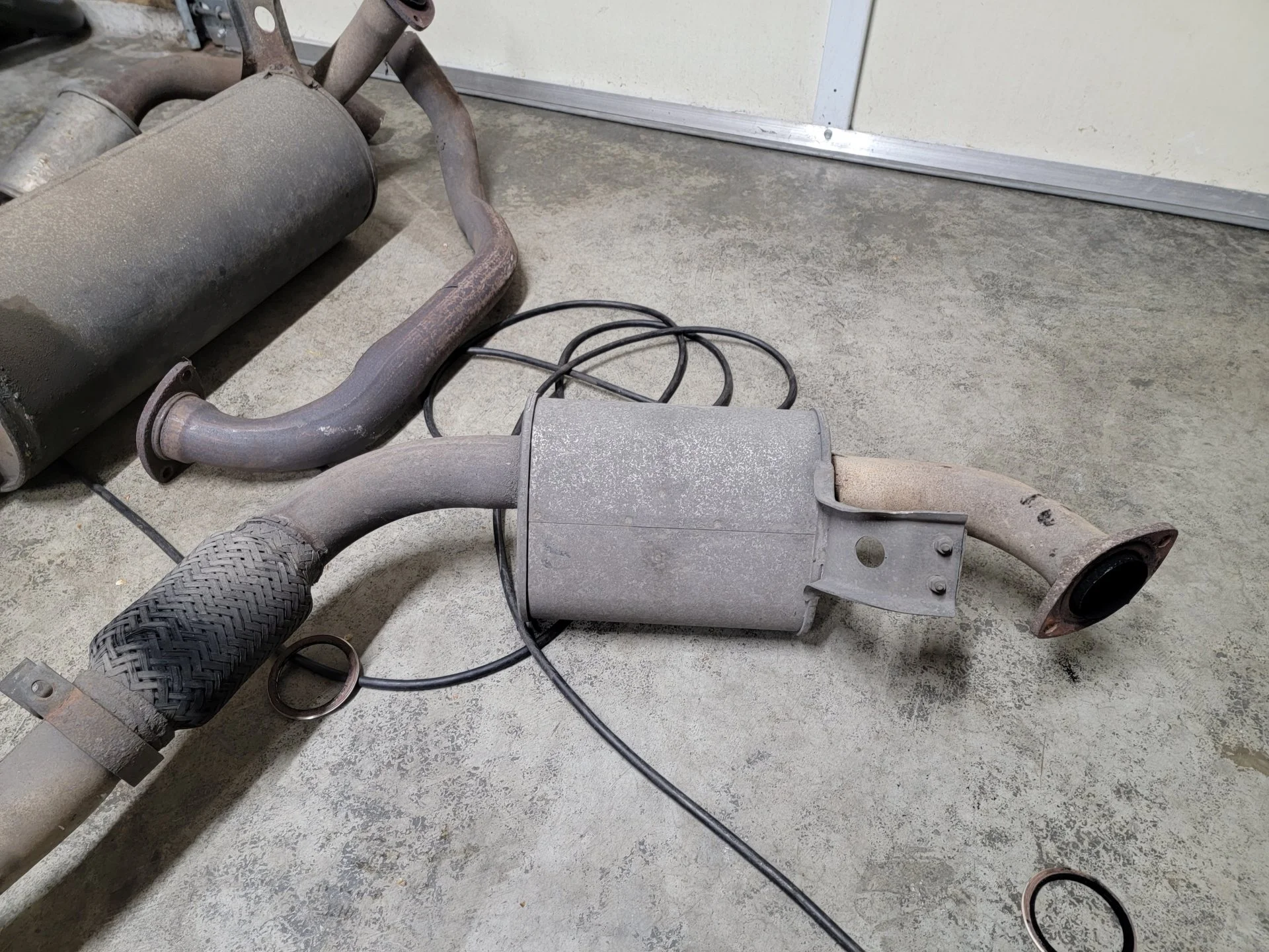

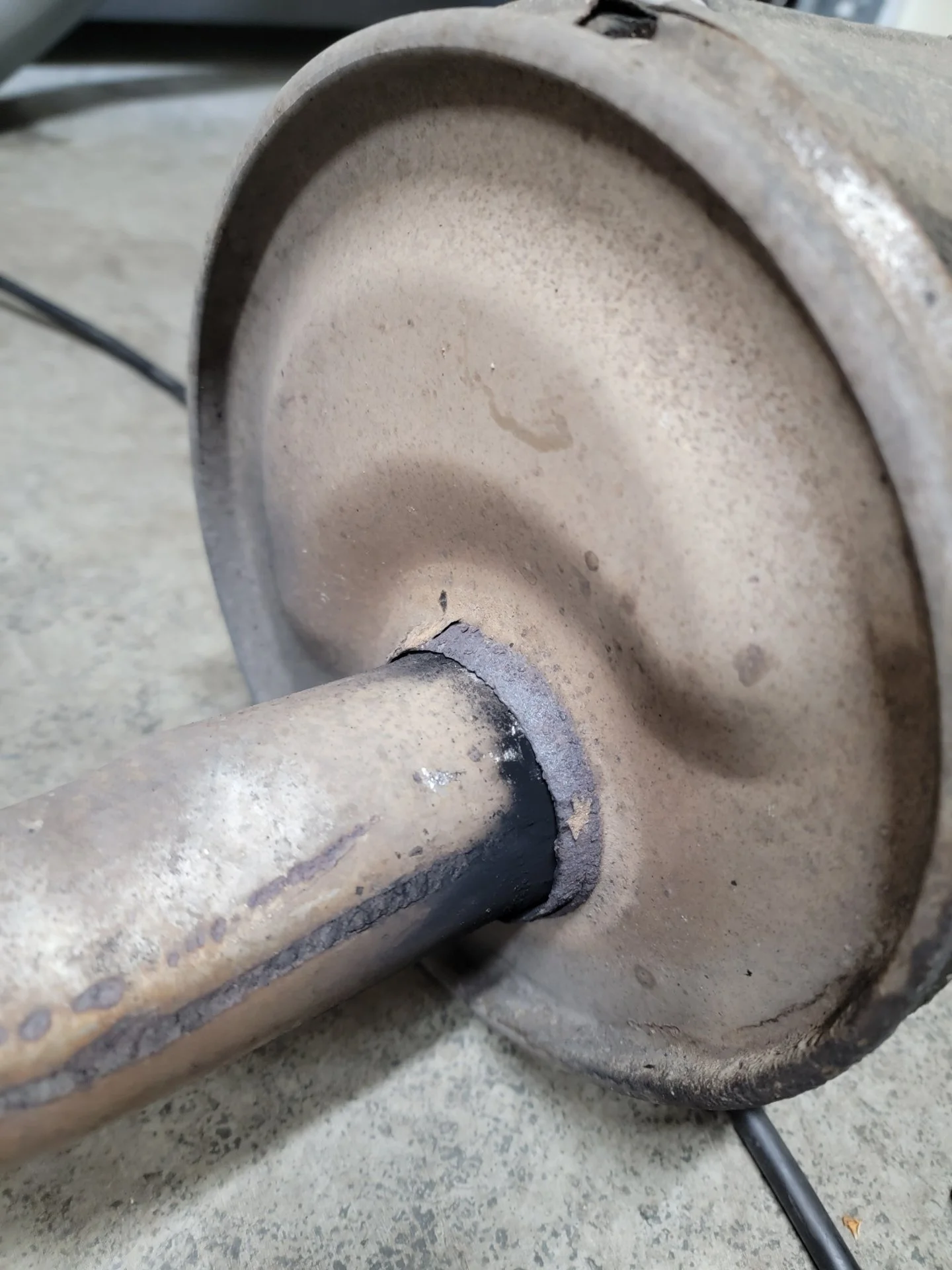

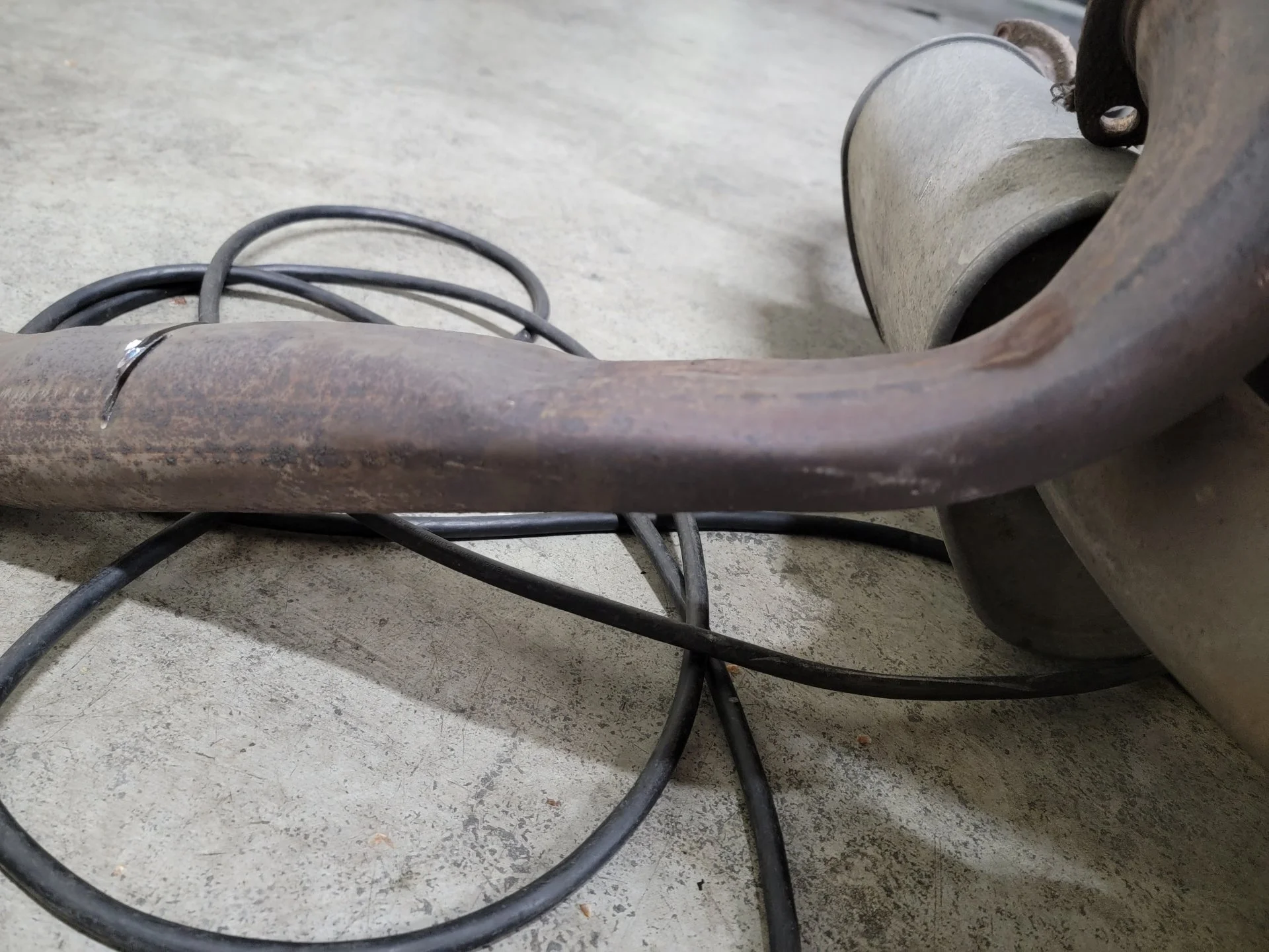

The stock large muffler was falling apart. I had 1 broken hanger. I replaced all 3 anyways. The factory flex pipe had definitely seen better days.
This is the stock system. Notice how crimped the exhaust is where it went over the rear cross member.

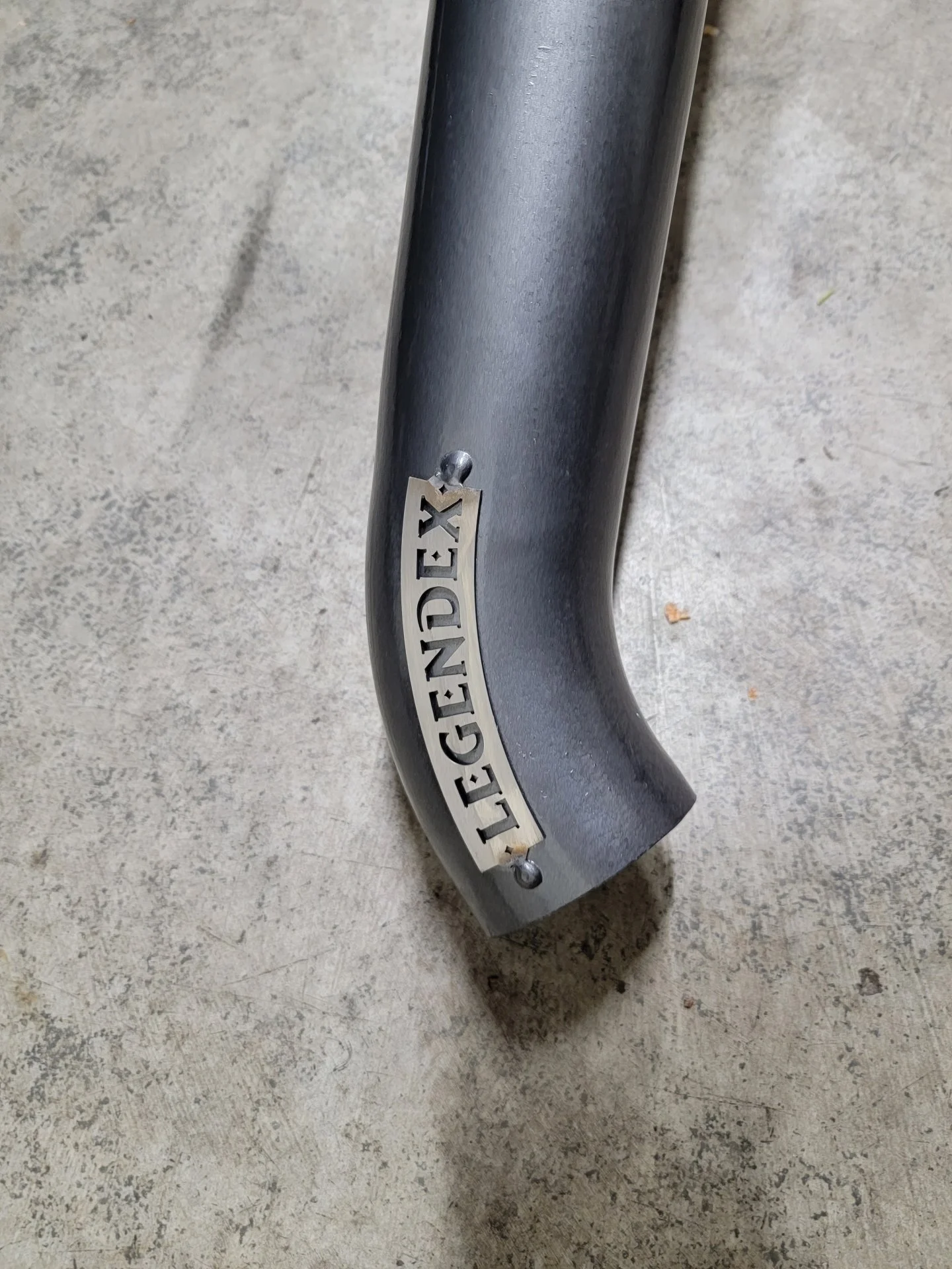

Here's the legendex box as it came. Little rough, but no issues with the product.
A shot of the exhaust bits and complimentary sticker.
And the final product.
I'll have a video tomorrow of the before and after sounds.
It feels much more responsive. As it should being so much more open now.
