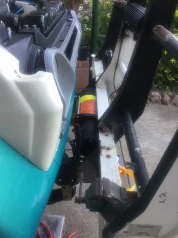

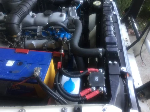

Got some more work done this arvo, I didn't like the solenoid pack mounting system that came with the winch so I mounted it under the bonnet and made up some longer leads. Still need to mount the plug for the winch controller which I'm thinking of recessing into the upper guard and also running an in-cab switch...
