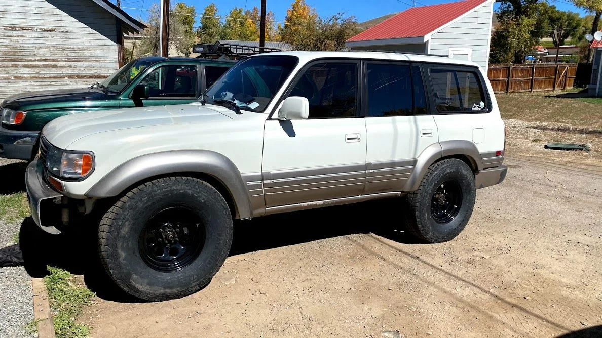

Started as this. Had a front brush guard, running boards, chrome wheels, rear taillights guards, and a lot of interior coffee stains.
I ripped all that stuff off probably within a half hr of it being home.
Next was a camping trip up and over Tincup Pass (oh yes also spray canned the wheels black).....(slightly less bad)
Platform and oh yeah i delivered some pizzas in it for Dominos. @Andrew Bluemel has the kewl 80
At this point i'd say 2 maybe 3 weeks had gone by. It was time for 37s. I went with a Dobinsons 2" lift coils and some 37" all terrains. But this is for the next post. I ran out of picture space (sorry)

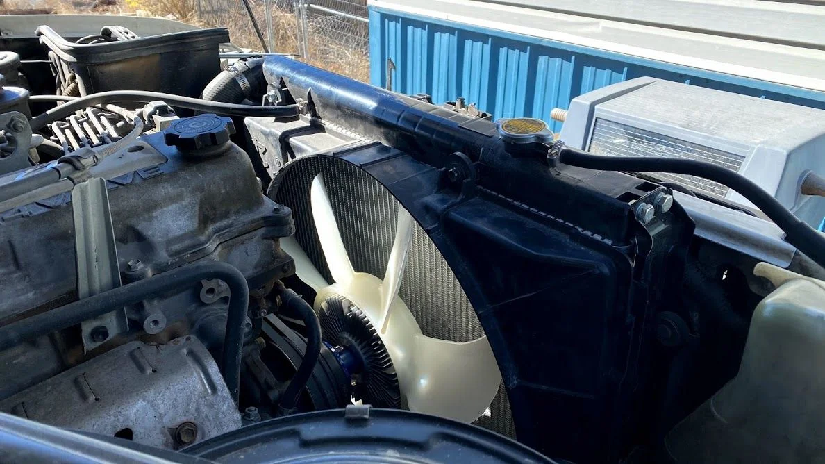

In the midst of all this I actually blew the radiator on the way back from the Tincup trip. Huge shoutout to Andrew and my friend Tess for literally driving all the way back to Colorado Springs with me, then back to where the truck was, then installing the radiator at midnight, then hauling butt back to Gunnison till like 3am. It was nuts.
Anyhow, I Have recently done a TON of PM. New Rad, rad cap, fan clutch (15wt oil), fan, rad hoses, belts, heater hoses, vacuum lines, brake booster valve/line, pcv stuff, egr plug, rad overflow bottle, engine grounds, spark plugs and wires, air filter, intake hose. Old trucks :censor:

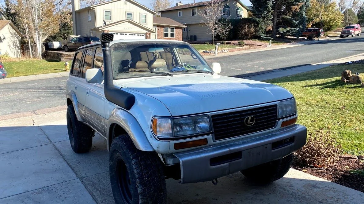

Got bored so I chopped the rear bumper off. Also got rid of the roof rack in prep for an 8020 aluminum rtt I am building (will be sealing holes with urethane). Also my dad found a trail gear front bumper for cheap so I am picking that up tomorrow!
Plan by year end is get this thing to 5” of lift. Dobinsons everything in that department. Then Huddexpo rear bumper build with a swingout and spare tire. And @Andrew Bluemel gave me his old auto locker when he upgraded to an e locker so I will put that in too.
