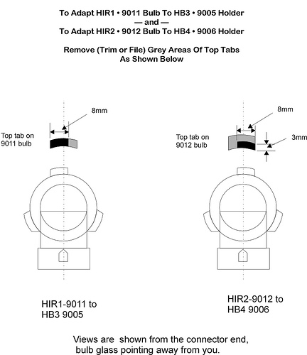

The 9011 mod to replace 9006, was cutting the excess casting off locking rings all or did you need to modify the plug for the wire harness plug?
IF so how did you do this plz...

Sorry, hadn't noticed that you asked about the 9011 into 9006 location mod.
You'll notice on the plug part of the bulb on the 9011 there are two plastic guide rows, this is on the inside. The plug end of the wiring harness for the 9006 has a place for only one plastic guide row. So on the plug on the bulb you have to cut down the two plastic guides. I'm cut them down just enough so that the bulb fit into the pug of the harness very snugly. Then the diameter of the 9011 is ever so slightly smaller then the 9006 or 9012. To address this I simply transferred the rubber o-ring from the old 9006 to the 9011 while leaving the original o-ring as well. This gave the bulb base the diameter needed to fit snugly into the 9006 headlight housing. Hope that makes sense.

Elijah,
Do you happen to have any pics - or would you mind taking a pic or two - to show what you describe above?
It's been a year or two since I did the mod. I simply followed the HIR bulb base modification shown below. But I didn't think about doing anything with the o-rings.
I remember when I did it that the bulb didn't seat as well in the projector housing as well as the 9005/9006 bulbs had. In fact, I was worried about them coming loose and unseated when off road. While that hasn't been a problem, it would be nice to get them tight and snug as possible.

http://farm5.static.flickr.com/4038/4328053720_1d2cc6a334_o.jpg

Elijah,

[URL="http://farm5.static.flickr.com/4038/4328053720_1d2cc6a334_o.jpg"][/URL]
Please remember that I installed the 9011(HIR high bulb) in place of the lows, (9006 or 9012HIR). Hopefully this is what you are talking about. The base of the 9011 bulb in the low beam light housing, once the tabs are turned and seated, will have a very slight amount of play in the low beam spot. This is due to the diameter of the low beam base being slightly larger than the high beam bulb base. Do you remember the o-rings at the base of the bulbs? I took the o-ring from the existing 9006 (OEM low beam bulb that is being replaced) and added it to the 9011 bulb while leaving the o-ring that came on the 9011 in place. With this additional o-ring, the bulb didn't have any play in it's seated, final position. It's fairly difficult to explain. I haven't checked but that might be identical to what I typed in the previous post! Ha! I suppose I could go pull a bulb and take a pic of the two O-rings on the base and post it later.
