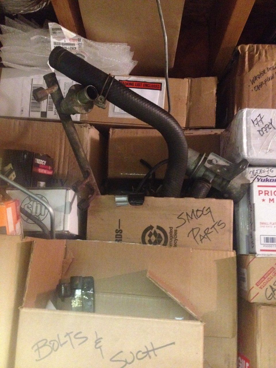

But, I have a question... where will you carry your spare engine, once you finish rebuilding it? :hmm:
Good question! I guess it won't fit in my glove box, will it? ;)
Nor will I put on the Top Shelf with my de-smog goodie box....
...there that hose is.....

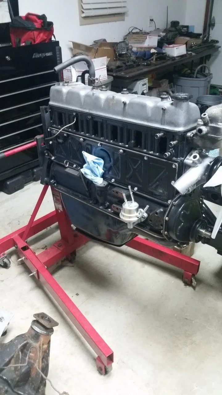

This should work well for your extra engine
Just wheel the engine in an unused corner of your basement garage until you're ready to work on it.
I love this stand. I can turn it myself. It has safely held my 2f since 1/14. Maybe if it is going to be a long term storage solution, modify it to support the front of the block on the engine mount holes and you can sleep safely.

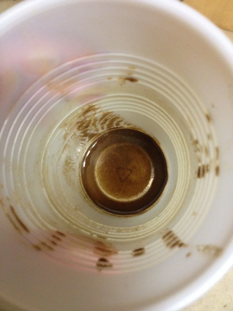

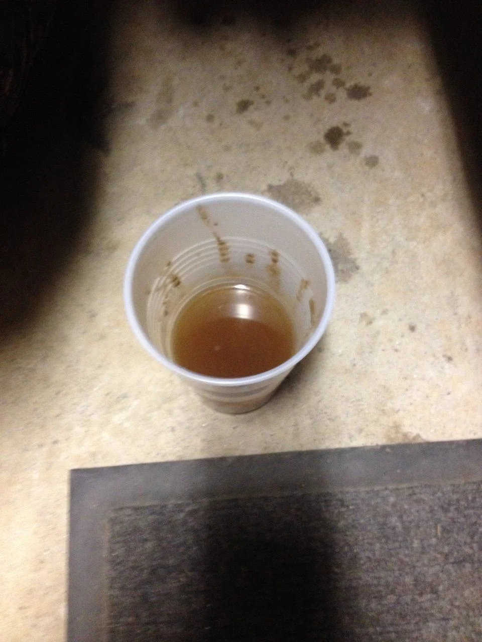

After a few days of running my new 2F, I noticed the antifreeze looked a little discolored. I venture a guess that I loosened up all the fine rust sediment from the engine block prep from the rebuild....Here are some photos.

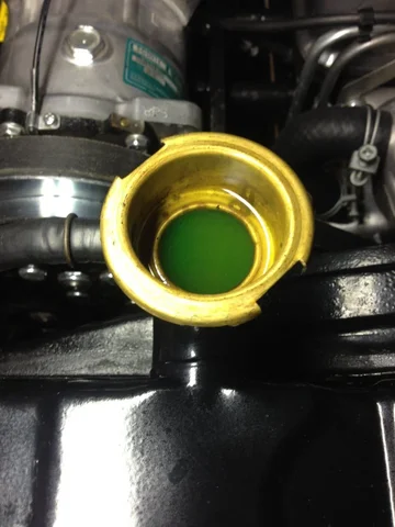

With a good system flush yesterday, and running several cycles of H2O thru it.....Here is what it looks like this morning.
Turned a rusty "Brown Eye" into a Prestone 50/50 "Green Eye"! :hillbilly:
rusty "Brown Eye"

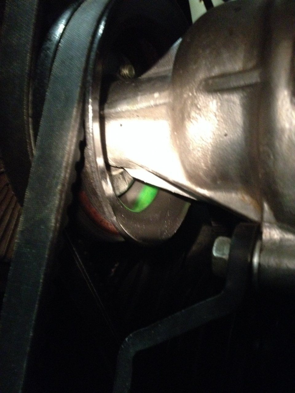

Less than 200 miles on a supposedly new old stock Aisin Water Pump......I will be replacing it here soon. Made a mess of my new engine and cleaned up engine bay. I guess I bought a pig-n-a-poke on the water pump?
Wondering why you opted for a NOS instead of picking up a new one?
My '77 doesn't have the oil cooler and I wanted an OEM part. Found this one that has crapped out............and now wish I hadn't! Such is life. I'll buy a new OEM unit with the oil cooler (ones without the oil cooler are discontinued) and cap it, I guess. I'm trying to figure this out what to do without posting another water pump thread.
