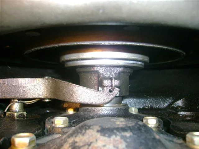

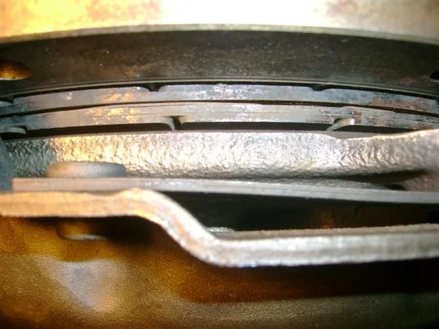

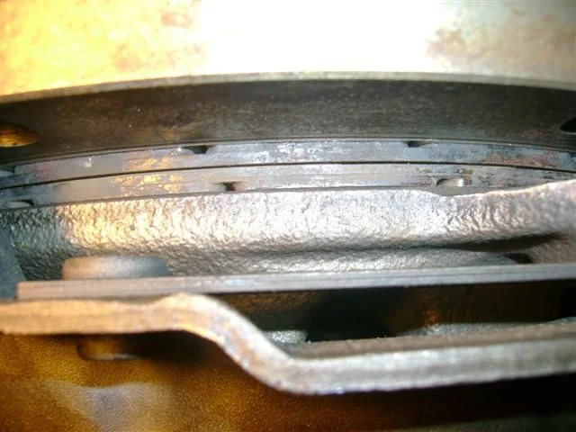

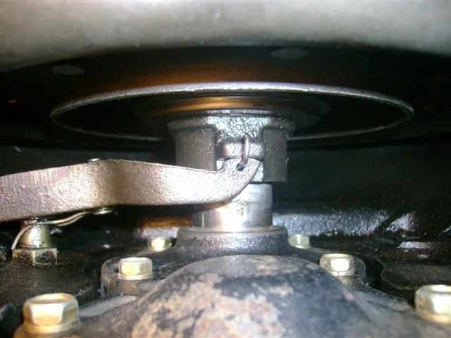

first pic shows the view up with inspection cover removed with clutch up, second with clutch depressed... you can see that pressure is relieved and there is a gap, but is the gap in the right place?
A reputable member has suggested that the clutch disk(s) might just be stuck together and to try to start it in gear and bump the gas with the clutch depressed to try to jar them loose. i'll try that tomorrow after today's storms pass, but thought I'd throw the pics up here for any other opinions.

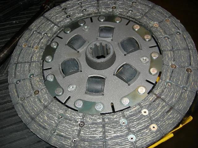

If the disc is in backwards, it could be bound up on the heads of the bolts that retain the flywheel to the crankshaft, causing it to be stuck.
The first picture shows which side of the clutch disc is the flywheel side and the second picture shows the opposite side, or the side that faces the pressure plate/transmission when installed. The clutch hub (splined section) is taller on the pressure plate side, and is likely bound on the flywheel bolts.

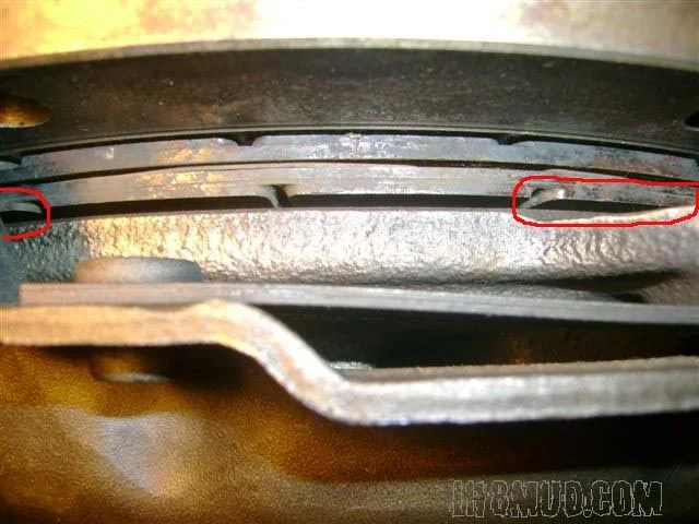

Looks as if the disc has gone de-funk in the areas circled in red.... whats up with that?:confused:

Just looks like when the clutch was released those two sections of the disc were trying to fall out.... your s*** must be broke in there.... pull it back out...
yep, I'm a confirmed dumb-ass.
Pulled it, flipped the clutch disk, reinstalled, and off I went... nothing like that first ride in something you had completely apart, is there? Woohoo!
