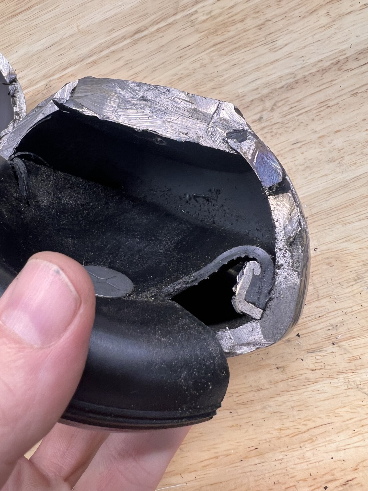

For those who may find this of interest, last week I decided to dissect an old globe.

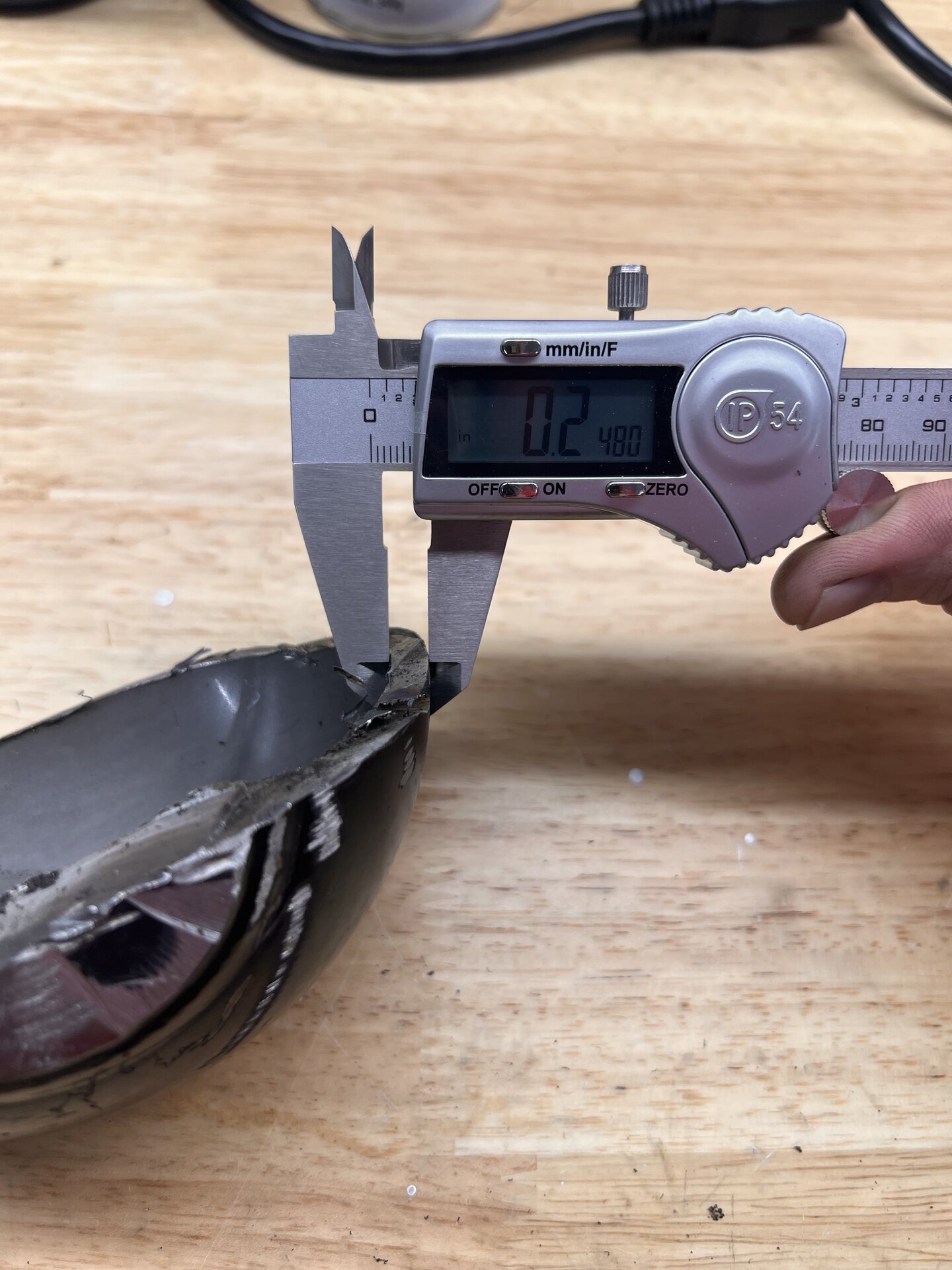

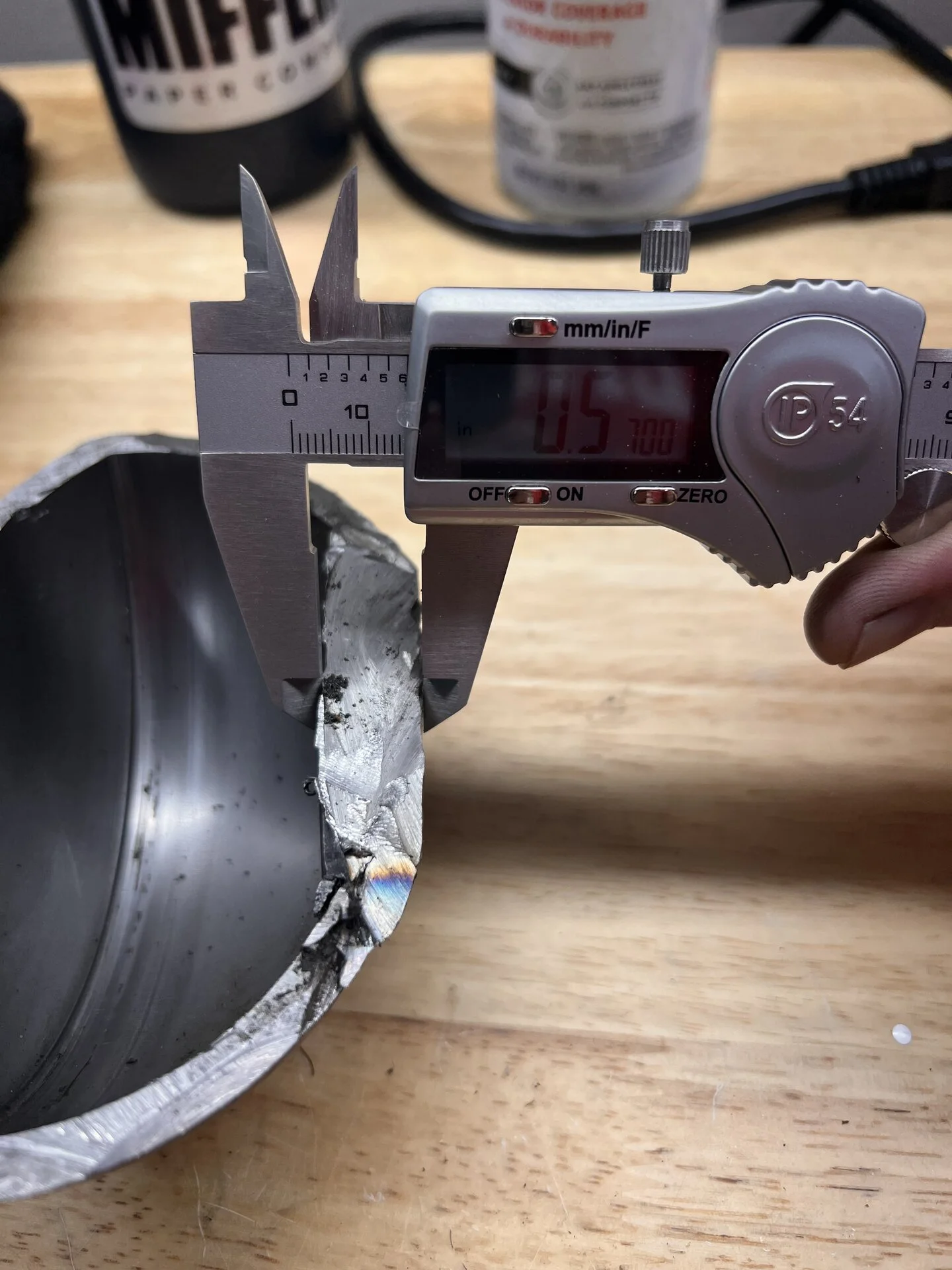

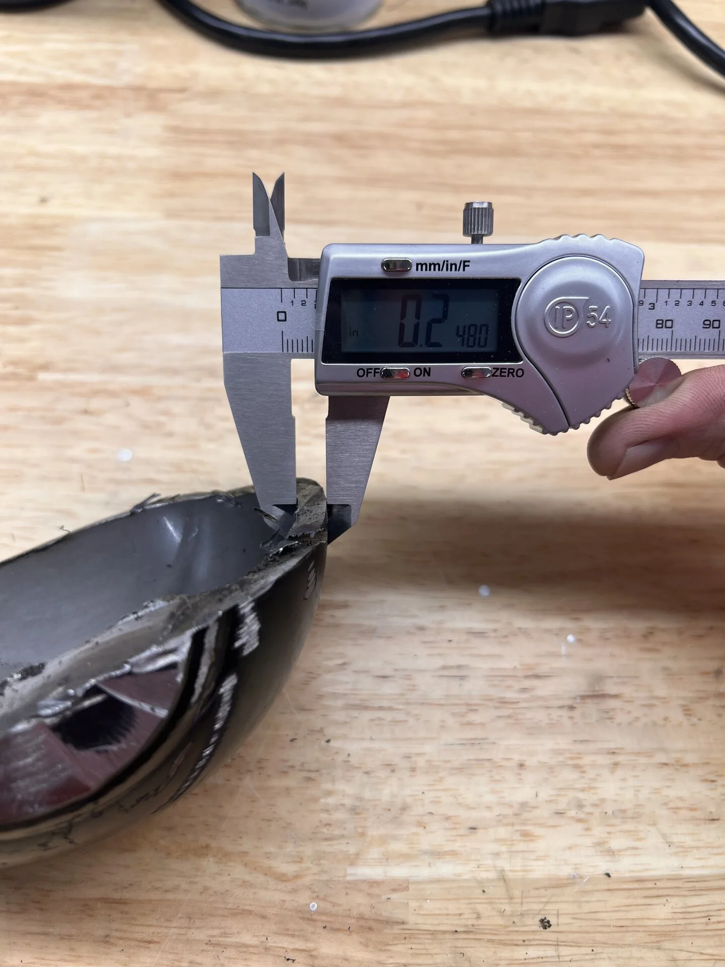

The findings were as expected with a rubber separator between the nitrogen and the AHC fluid. I was surprised at the housing thickness, 1/2” at the base. In my case there was no visible wear on the rubber. Maybe over time the wear is microscopic or with age the gas escapes through the rubber?

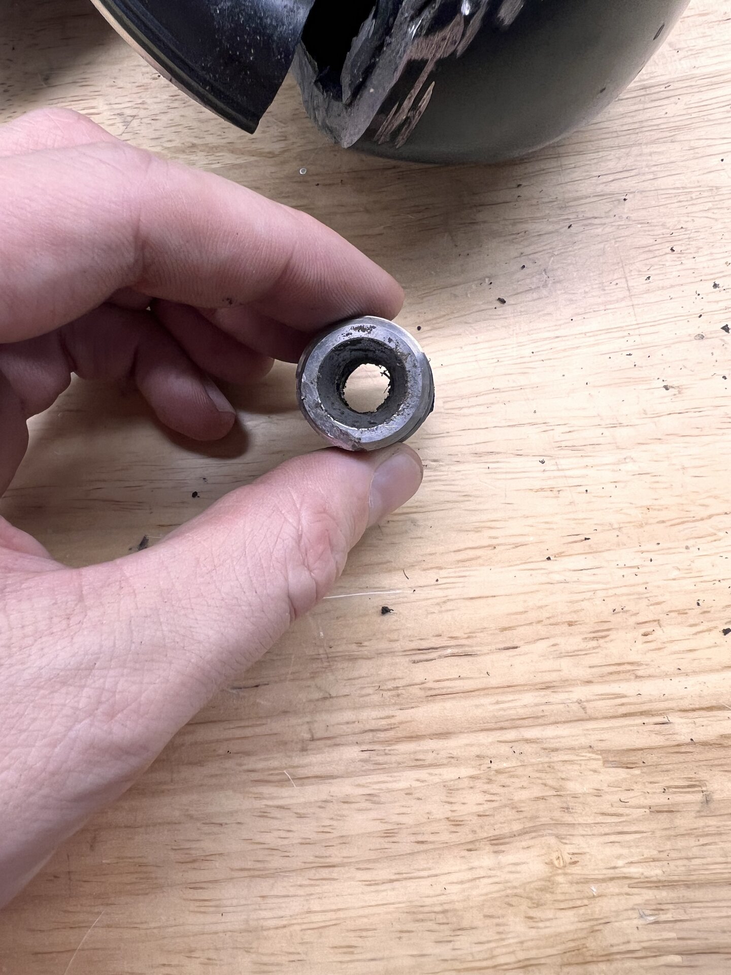

Interesting. What does the top - part that threads into the plumbing - look like?

So when you buy the accumulators new, the rubber is obviously strong enough and thick enough to resist the pressure of the nitrogen and not allow it to leak out. You don't want to buy old stock then..
