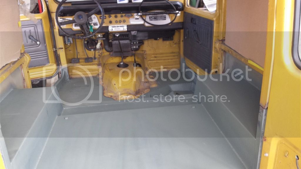

Here is mine we are currently working on. Done out of 1/8 steel like Randys. With the 47 he can blend in the rocker better be cause of the lip that goes all the way to the bottom.
