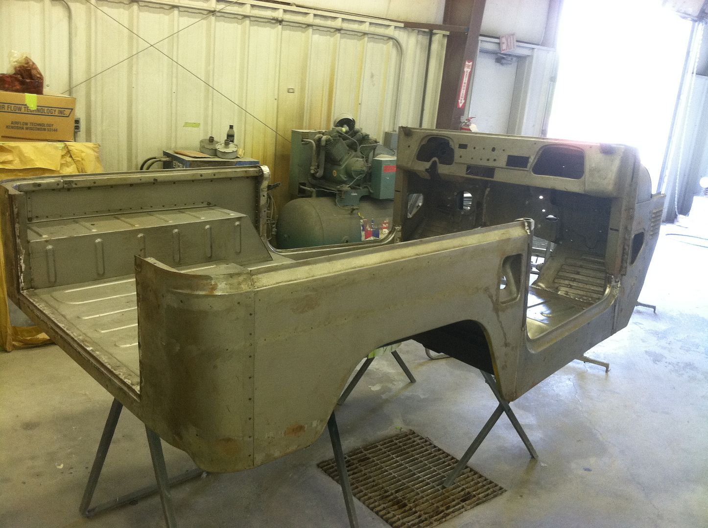

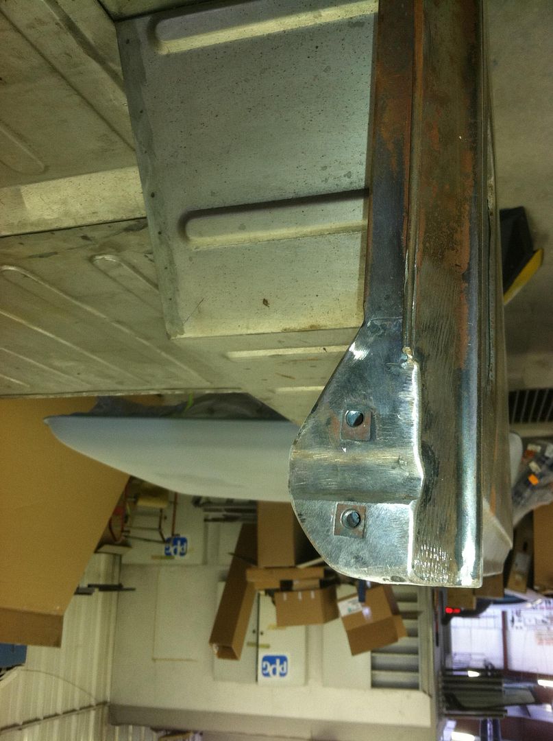

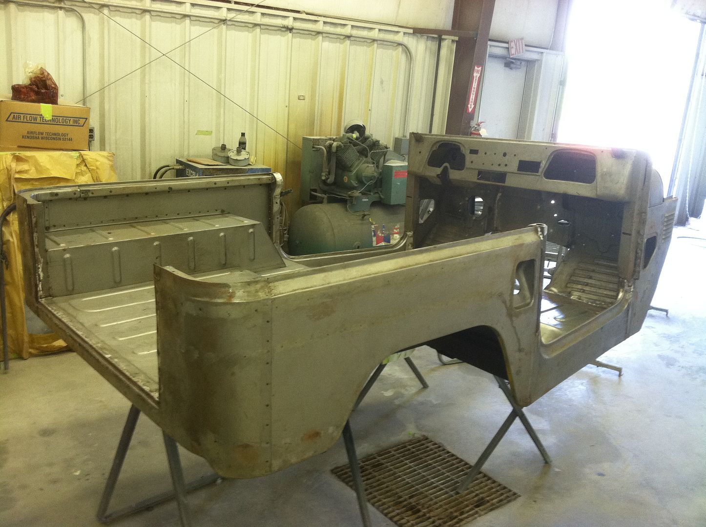

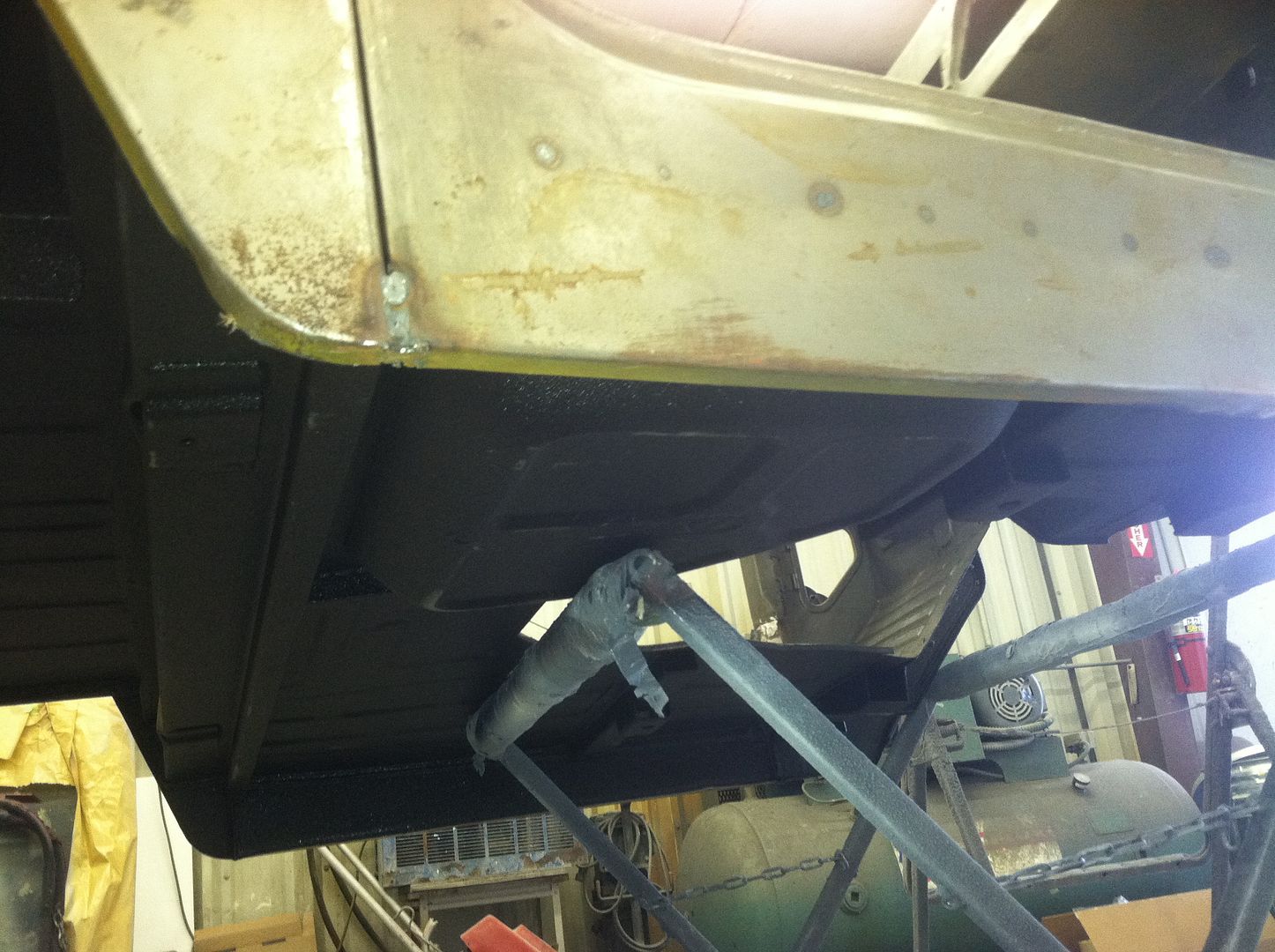

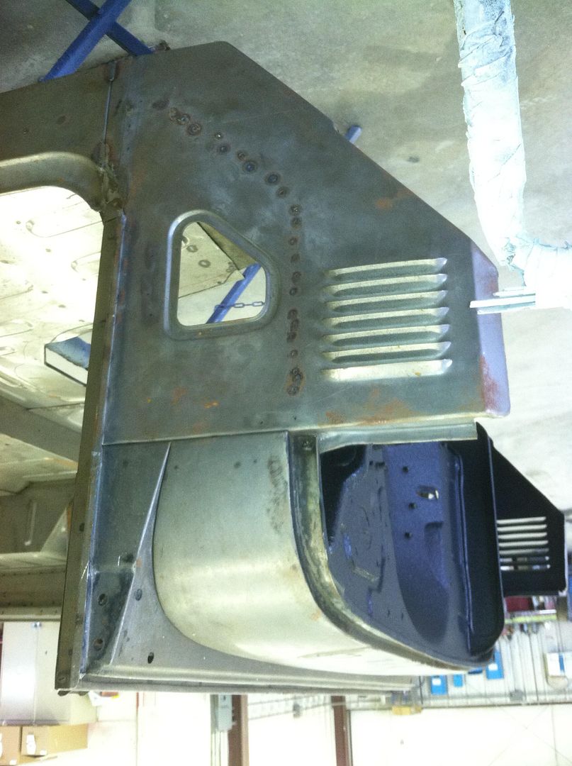

I will add a bunch of pictures in the next response. The product is nice, detail is good....most importantly, all of the stock takeoffs have fit back on perfectly or with minimal mods.

From what I see in the pictures, the detail is nominal....if you could buy these, you had better learn how to install riv-nuts and captive nuts.
It looks like an ok option....but there is a lot of work left to do.

I chose to Linex the underneath of my new tub for protection....its good insurance.
I did this as well, under the floor pan and on top. The rust came back from the seams, and now spreads under the line-x.

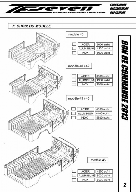

hello all cruiser
thank you for your enthusiasm for my work.:)
teseven company to move in 2013 and I had one year of delay.
for the moment I am the only one working in the company.
produced in France is very complicated because the tax is very expensive.
to send a container texas price approx 4000 dollars for 12 body. (I have no news from me too).
but I can find out for a single
I am very busy with french cruiser, and I still think the company changed to the very good quality for rich customer.
sorry if you did not get an answer my new address is teseven@gmx.fr
and my wife speaks very good English number is 0033 620652169
and I have my new facebook https://www.facebook.com/pages/Teseven/604811082911675
thanks
ouachée fabien
this is the good price for 2014
