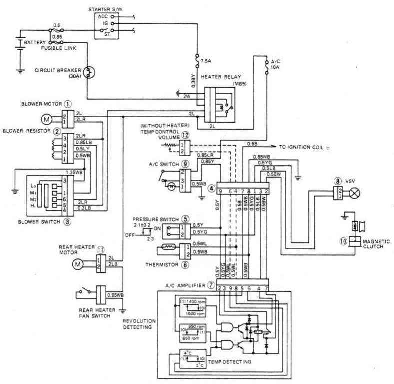

Does your aftermarket ECU use +12v on its idle-up input circuit to speed up engine RPMs? If so then you can just connect this idle-up circuit to the same wire that goes from the A/C Amp to the compressor clutch (the wire on connector pin #7 in the FJ60 schematic shown in post #3 above). If the ECU uses a different voltage to increase RPMs, then you need to figure out what it expects. But 9-to-1 odds says it's +12v.

Just adding this information here (from another site) :
Toyota Land Cruiser FJ60 A/C System
When I bought my FJ60 the A/C was blowing really cold air. I mean freezing air. I didn't think too much of it until one hot day I had the A/C on in stop and go traffic. Suddenly the A/C air was warmer, and shortly after I smelled burning lining. The A/C compressor had jammed solid, and the clutch on the compressor axle was just spinning and burning. A new compressor cost me $350, along with a $20 receiver/drier and $500 to have Gary's Auto install these, flush the R12 from the system, convert fittings to R134A, and refill with R134A. This is a pretty big outlay so I decided to check and make sure that the electronic control systems were operating correctly. They were not - the A/C compressor was never disengaging if the A/C button on the dash was depressed. A quick check in the manual shows the schematic of the control circuit:
The logic is provided by the "A/C Amplifier" at the bottom of the schematic. This is a small PCB inside a plastic case located just under the passenger side dashboard. The 9 pins on the PCB are as follows:
PinFunction
1NC
2V+ 12VDC from A/C switch
3V+ 12VDC switched by low pressure A/C - off if pressure less than 2.1
4Idle up VSV (output)
5Ignition coil signal (input)
6Chassis ground
7Compressor magnetic clutch (output)
8Evaporator Thermistor (input)
9NC

The blue knob protrudes through the plastic housing and is used to adjust the engine RPM at which the A/C amplifier will cut off the compressor on low idle, and also engage the compressor after idle-up is accomplished with the VSV. The red knob adjusts the temperature at the evaporator at which the compressor will be turned off to avoid evaporator freezing (factory target is about 34F). By attaching a voltmeter between pins 6 and 8, you can monitor the voltage drop across the thermistor. On mine, the voltage ranges from about 1.5V (80F ambient) to around 2.1V at 32F when the evaporator begins to freeze. By measuring this I could see that the thermistor was properly measuring the temperature of the evaporator. But the compressor just stayed engaged at all times, even after freezing occurred. I adjusted the red knob and was able to switch the VSV on/off as the amplifier attempted to turn off the system, but the clutch never disengaged - pin 7 remained high telling the compressor to run. Left as is, this would burn out my new compressor. I pulled the amplifier all the way out and examined it more closely. Lo and behold here is what I found on the reverse side of the PCB:
Somebody had modified the board, adding a jumper (circled in yellow above). The jumper connects the collector of the switching transistor to V+, engaging the clutch relay (middle of the PCB) at all times. I removed the jumper and the system began to work somewhat as intended, cycling the clutch. Here's what the back of the PCB should look like, without the jumper:
