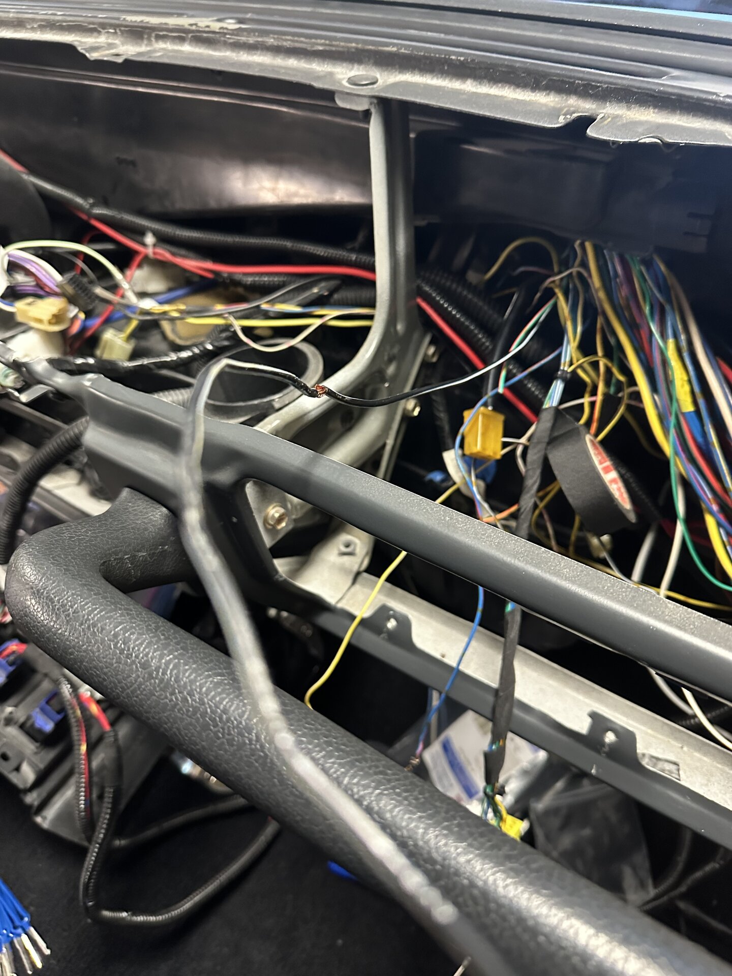

This is an awesome thread with great information, wanted to thank everyone whose contributed. I have a FJ62 w/ 5.3 vortec thats been cleanly swapped and wired by previous owner without AC. I finished all the plumbing with custom hoses and a dirty dingo low AC mount. My last hurdle is this wiring. My plan was to use a trinary switch off my dakota digital fan controller, stock AC sender and the compressor.
I tried to locate the AC sender in the engine bay harness and its neatly wrapped and organized. Short of pulling the harness apart, id like to run a new relay off the AC amp box. My ac light is receiving power and my question is which wire would I run the new relay off? There's a larger white/black guage wire off the amp box but I don't think that's the one. Do I use the compressor clutch wire #7 in the chart? I've added some photos , photo 1 is the ac amp box.
Thank you!
With the new wiring for the vortec done by the previous owner, there's too many potential variables to provide definitive answers to your questions. Sorry. Best thing is to look at the wiring diagram in post #3 and wire the new A/C up based on that. There's no real need for a new relay if you make proper use of the existing A/C amp. As far as the wiring for the "AC sender" (I'm assuming you mean the pressure switch), you could just run a new wire and not mess with the wiring harness.

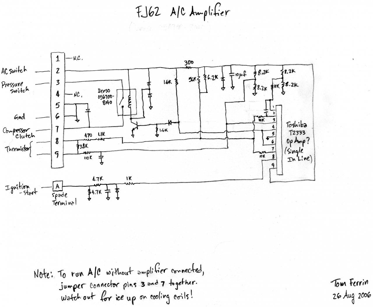

For the EE’s out there, here are the schematics that I reverse engineered for the two boards.
Both boards use a proprietary IC for the controller. On the FJ62 it’s a Toshiba T2333 and on the FJ60 it’s a Nippon Denso SE012. I could not find data sheets for either.

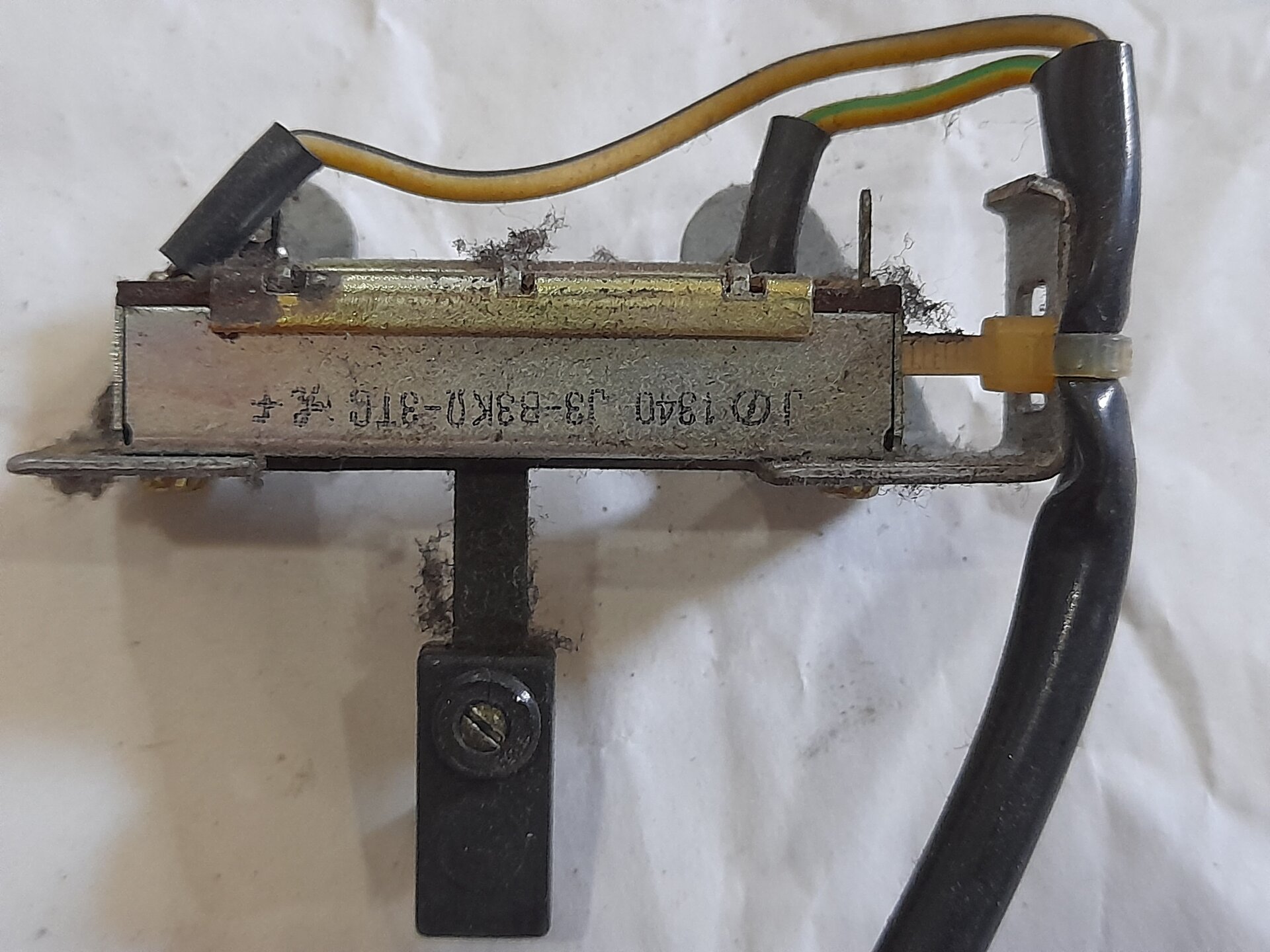

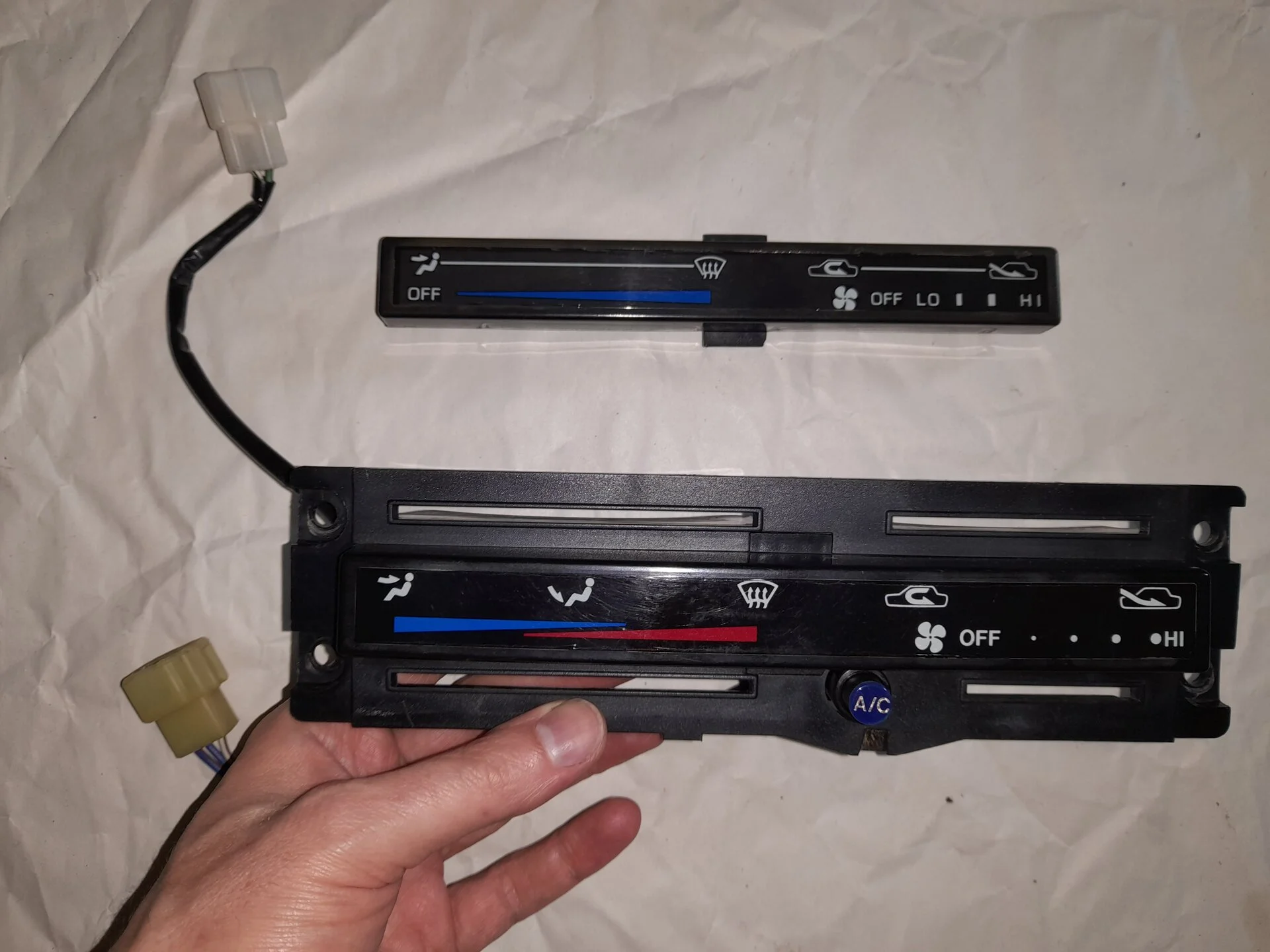

Because it lacked a heater, the HVAC controls look like this (comparing with a 87+ Australian heater control - note my car is right-handed). You can see that the heat/cool slider becomes just a cooling slider, and that the far left shows 'OFF', something different from the heater/cooler version where only the A/C button can switch off the A/C.

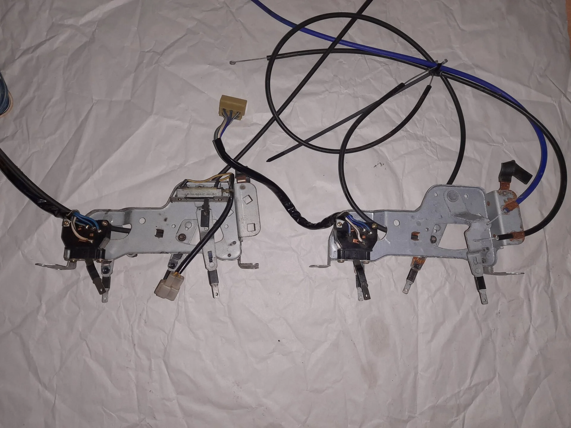

Here is the heater control slider unit for comparison. The units are identical except that the heat/cool slider arm on the no-heater variant (left) has no cables attached, just a variable resistor (the control units are upside down here).
Here is that variable resistor:
The wires on the variable resistor are:
Yellow/black, which runs to Terminal 8 on your diagram of the board.
White/blue which runs to both Terminal 9 on the board and also runs (as two white/blue wires) to one of the terminals of the thermistor which is inside the evaporator box.
Could you shed any light on how this arrangement works? What signal is it modulating through the variable resistors?

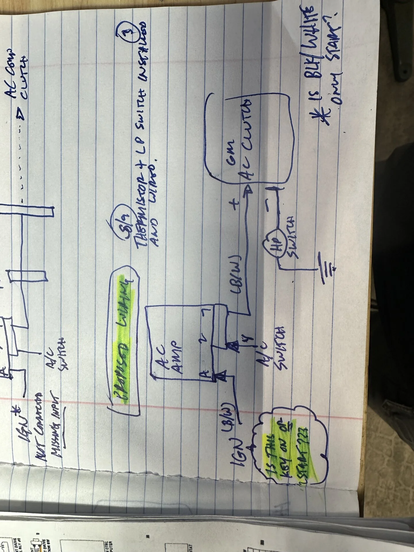

Trying to get the AC sorted on my 88 FJ62. I am knee deep in my dash and have some questions. After a lot of study I have a plan, but still some questions. If you look at my notes (see pictures below), the current set up bypasses the AC Amp, by wiring the AC switch directly to the AC clutch. It currently does not have the thermistor or pressure switch active. The proposed set up is to wire the output of the AC Amp directly to the AC clutch (original set up on a FJ62 goes through the ECU). Then add a high pressure switch to the ground side of the GM Compressor. That much is straightforward, but is it correct? Also, the Ignition wire to the AC Amp (the Black/white wire) is missing. While cleaning up the harness, I found an "unused" (post swap) Black/white 10Ga wire. Can I use that one?
