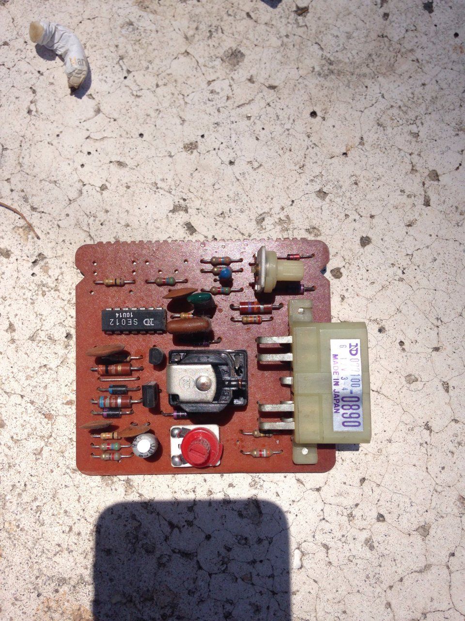

Mine looks like neither. 1982
Mine looks like neither. 1982View attachment 1112774
Yours looks the same as the 1985-and-later FJ60 amp, but with some components (4 resistors and a capacitor) missing in the top-left corner. I can tell it's basically the same as the lower photo in post #2 because the IC is the same (p/n SE012) and the relay and potentiometers look the same. I don't have an FJ60 amp in my possession any longer and so can't easily say what part of the overall circuit the missing components affect, but I'm pretty sure it is not the RPM sensing circuitry. I do remember from talking to @beno that pre-1985 LC's use a different thermistor part number so the change may be related to that.

Can you suggest why the '88 62 I've just purchased - and its A/C works extremely well - has the ground(?? - top leftmost spade on the circuit board) disconnected? Was the PO trying to provide A/C at all times?
Well it should first be noted that the spade terminal is not a ground! (See circuit diagram in post #3.) The spade terminal goes to the ignition start circuit in order to disengage the A/C when trying to start the engine.
Right. And already I had noticed that it was better to make sure the a/c was off when trying to start, so obviously that is the sort of issue this entire circuit board is created to address. But I wonder if there could be a good...or bad...reason the PO disconnected it. Any clues, anyone?
