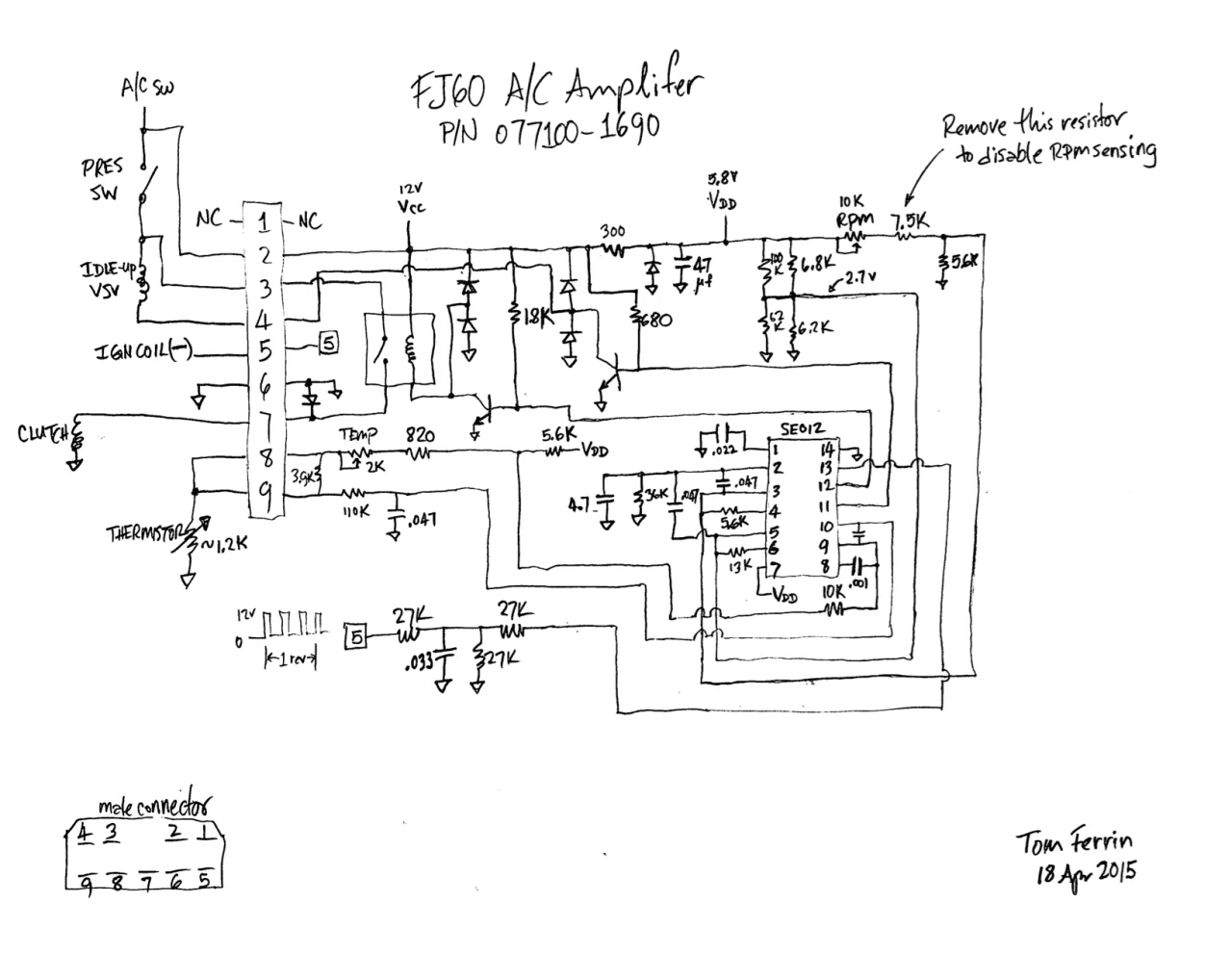

@TrickyT thanks for all the info!
I just noticed something from the photo you included in post #115. See the position of the red knob on the temperature potentiometer? Compare that to my photo in post #5. Yours is set as low as it can go, which should make the A/C run so much that the evaporator coils freeze over. My guess is that the PO added the black wire because the A/C was not working well and he/she thought the problem had something to do with the board. What's far more likely is that the system is either low on Freon or the expansion valve that sits between the condenser and the evaporator is plugged up. Or maybe there's moisture in the refrigeration circuit. Either way a good A/C shop should be able to diagnose what's wrong. Also, after you remove that extraneous wire you should set the red knob back to something reasonable, say 34° or 35° according to my photo in post #5. You want it set to where the A/C stays on until the evaporator get within 2-4° of freezing, then shuts off the compressor. The adjustable temperature potentiometer is part of the circuit because the thermistor that senses air temperature is not a precise device and the potentiometer allowed the factory to calibrate each sensor. (I have no idea if Toyota actually did such a calibration on every vehicle leaving the factory; I sort of doubt it.) It's interesting to note that in 21st century vehicles like my 2014 FJ Cruiser, the whole A/C system is basically the same as your FJ60. There's still an A/C Amplifier and an evaporator temperature sensor, but of course all the electronics have been updated to modern devices.
Thanks again for all the help. I had noticed my red knob was set wrong based on how you had yours marked. It’s really helpful that you put so much work into it. I rarely have to ask questions on here bc most of it has already been addressed.

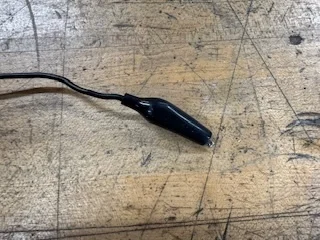

Let's make sure that it's the pressure switch that is causing the compressor to cycle, because cycling every 1-2 secs is awfully fast. Do you have any test leads available? Something like this would be ideal:
Or a wire with a small alligator clip on the end:
Attach this to the same place on the relay on the A/C amplifier where the black wire you previously had used to attached. (It would be best not to solder a wire on -- this is only for a test.) Attach the other end to a convenient ground point. Start the engine and turn on the dash A/C switch. The compressor should engage right away and stay engaged. It should be just fine to leave the compressor on for a minute or so. If the compressor is not cycling then there's something funky going on with the A/C amplifier. If it does cycle then it can only be due to one of four things: the pressure switch, a bad relay on the A/C amp board, a bad compressor clutch, or bad wiring somewhere in between.
