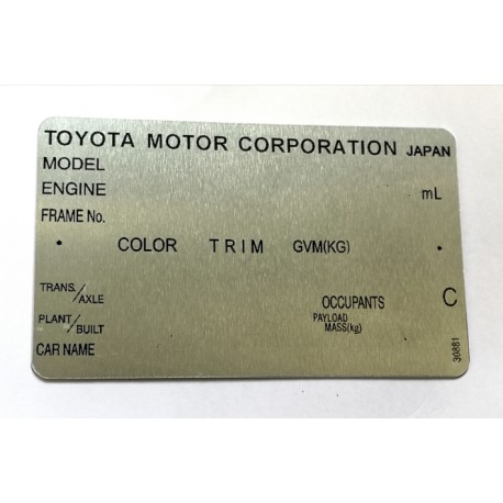

So here is something I want to share with you all as a resource and for your own restoration.
The original 1993 firewall vin plate was pretty wasted on the Troopy.
So I had a place in France make a new one. I tried a guy here in the states who said he could do it blah blah blah but all he did was cost us time.
I had them change the paint code to Cygnus White, the trans to H152, the axles to K084 and the engine to 1HD-FTE. I also got an additional vin plate made as a replica of the OG pictured above.
We didn’t change the vin number or model number or anything like that on the new vin plate. So I don’t believe there is anything wrong with this, in fact I would think any DMV or LEO would prefer the updates as it represents the Troopy in its current (and probably forever) state.
Anyhow point being I can vouch for the linked company in France. It took them awhile but in my opinion they knocked it out of the park.
