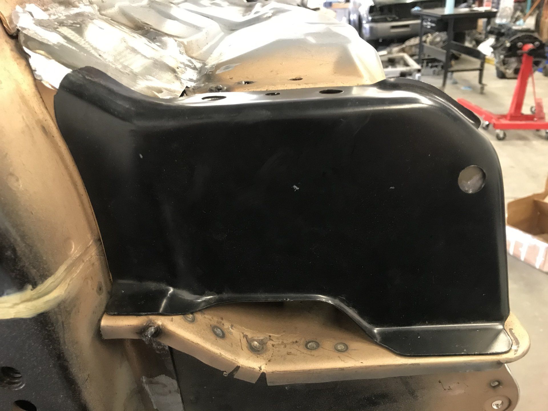

So @TonyP and myself have not been able to figure out why the 78 pillar has this recess.
Maybe a different roof that comes down farther to overlap. Or the bracket for mounting the snorkel is recessed?
Regardless we decided to cap it so it is like a 75. So I repurposed some of the original pillar.
Yes I still need to drill holes in it for the snorkel mount.

I know people said snorkel and no doubt the mount works with the snorkel, but...
I think the extra mounting area is for the sun visor... You can see how the snorkel can be attached to the sun visor.
So you are saying there was a factory sun visor option? Haven’t seen that in the EPC.
Cheers
I believe currently, the sun visor is only standard\available on certain versions, I think the "Workmate", versions sold in Australia.
The visor shows as an available option on the Toyota Australia site below.
Perhaps when searching the EPC with a frame number that isn't Australian... it doesn't appear?
One of ASPW's vids is where I heard him say which versions the visor is available on.
Searching for the vid now, but he's got a lot of Troopy vids... It might take a while to find.
Here's a screenshot from one of his vids where the plate that covers the area is visible. This was shot in a Toyota dealership
I can't see Toyota changing how the pillar is stamped\machined if it wasn't available in other regions, but maybe?
EDIT ^^Changed "Can" to "Can't" in the sentence above^^
Regional accessories are not listed in the factory-generated parts catalogs. They are supplemental documents distributed within the pertinent market area.
Found a vid (below), where he mentions at about 1 minute on the timeline the visor came from Toyota, but it is NOT the vid I am looking for where he mentions the versions... still searching. Hope this helps.
Found it...
Starts at 2:24 in the vid below.
Fits to the Workmate without issue, but the GXL version has chrome around the windows which means the standard Toyota brackets don't fit. They used 3rd party brackets to fit the visor due to the chrome...
Not sure what it was like 25+ years ago.
Found it...
A-pillars from a 78 so you are probably right. Regardless, capped on RHS and will do same on LHS.
