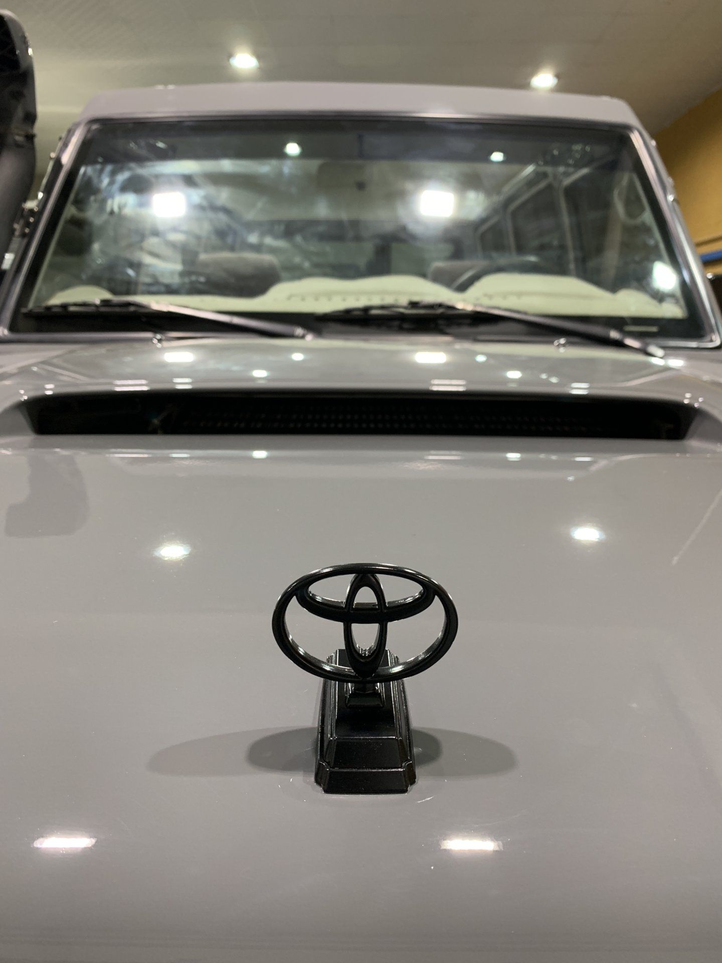

Black bull horns on the bonnet.
See? I kinda like that! Did you paint it black or are they available that color from Toyota?
