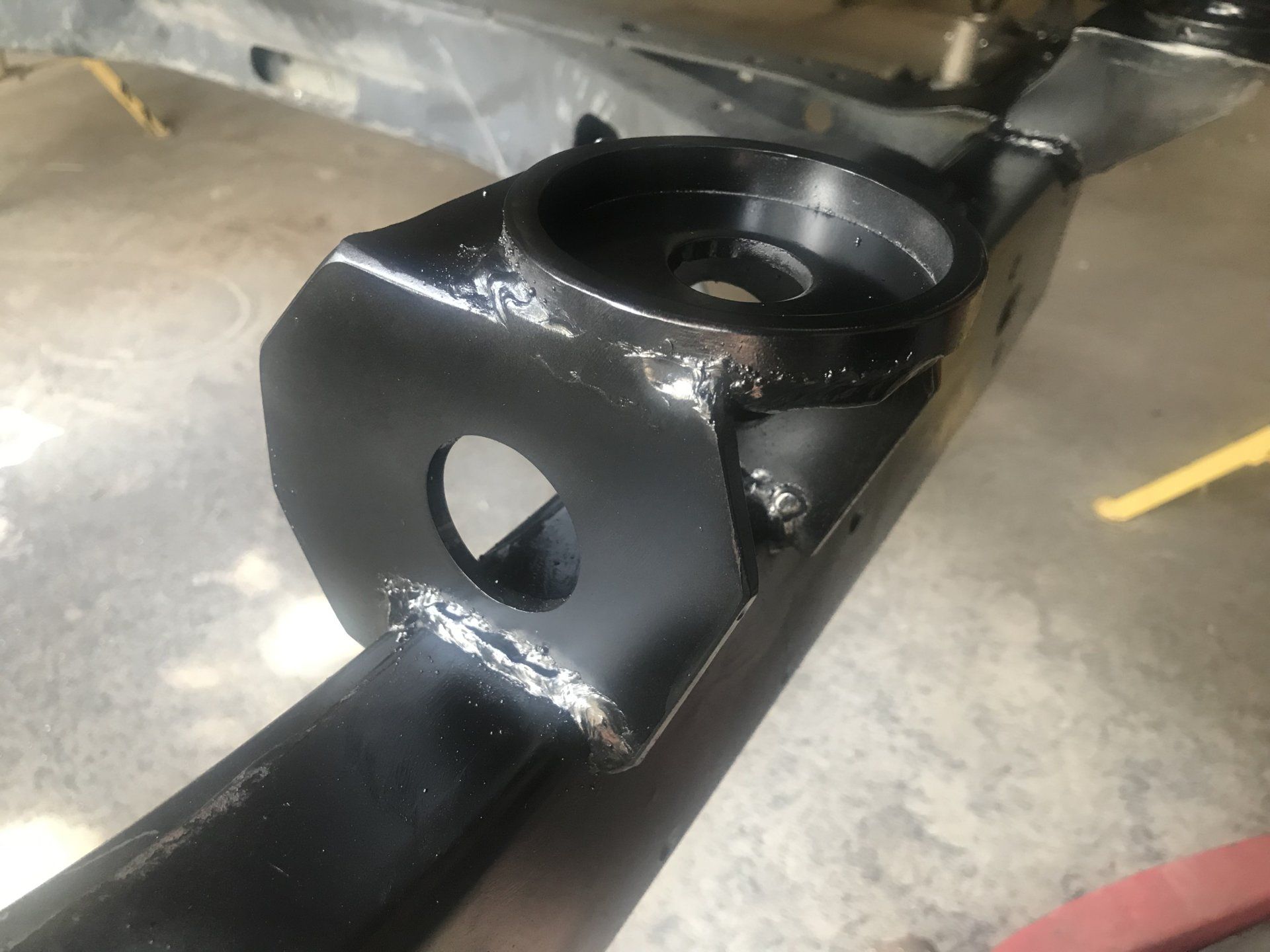

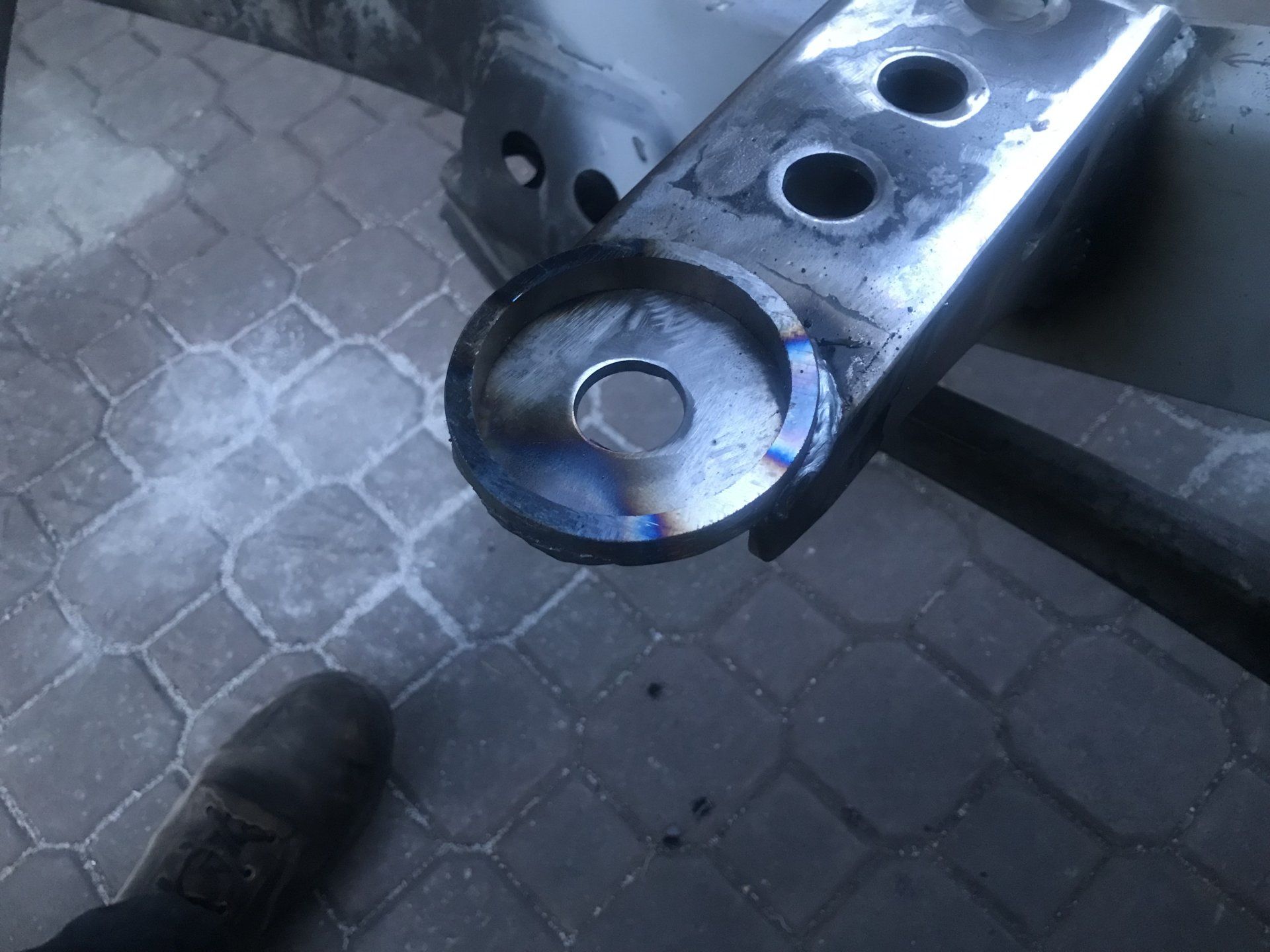

I missed one in the pics, this is #5.
Looks like our “pucks” may work and that is more welding and grinding! :(

I think they are pretty sweet, way more work though than building them out of rectangle tube which is how is did the FJ142. More difficult as well and time consuming but they do look nice. Super strong as well, remember folks triangles are always stronger than squares! ;)
My beer is nearly done, back to the grinder! :censor:
Cheers
Just a thought, those mounts are strong side to side but sort of unsupported front to back, if you added a vertical plate between the mount and the top of the frame it would tie that shear plane into the frame and prevent the mount from ever buckling.
Yup, if you read earlier in the thread, I said I would gusset where I felt needed.
Honestly, I don’t think it’s needed at all. This is 3/16’s and all the load is downward, not side to side or front to back. I do believe the bolt and sleeve carry any of the side to side and front to back load. I will go ahead and consult my engineer friend though just to make sure I am on the right track.

So I am done with it for now. Need to drill some drain holes in the eight larger mount cups. Need to weld up the bottom of the motor mounts. Need to plate the rear crossmember like I mentioned before. That’s about it but I got to get this truck out of the shop ASAP. Need to do some things to the PZJ70 right now for prep of the owner using that truck come Monday.
