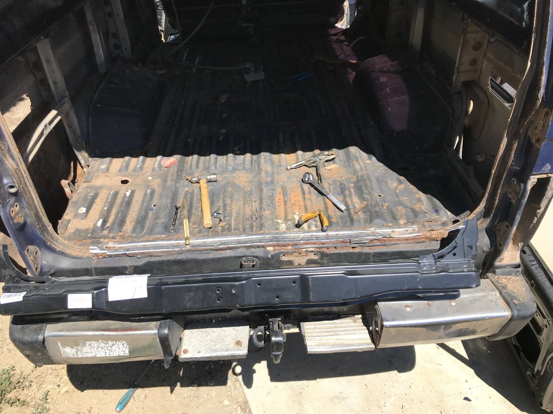

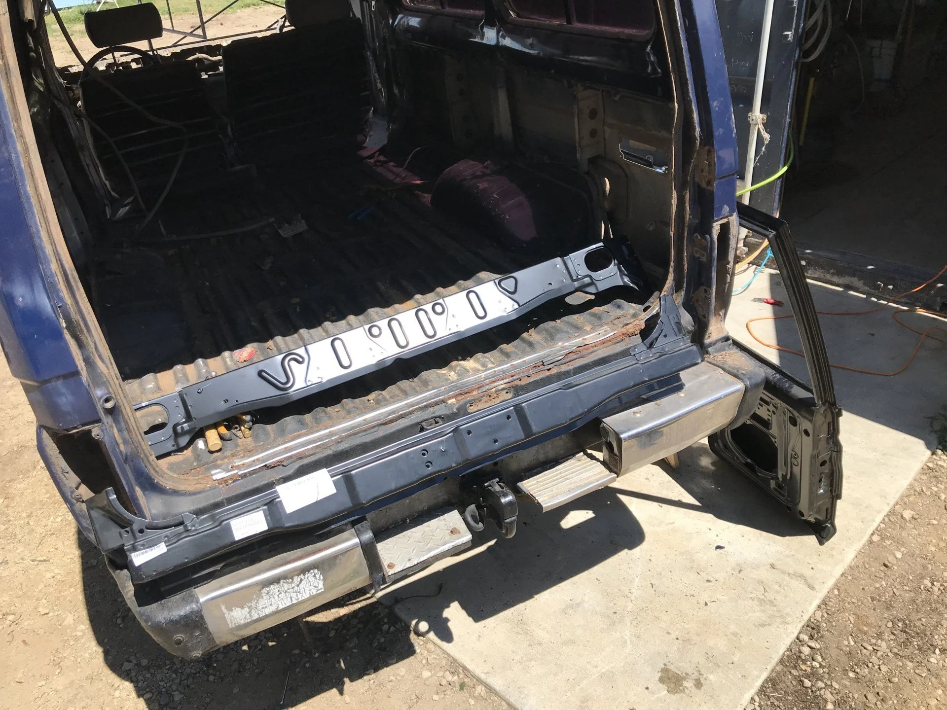

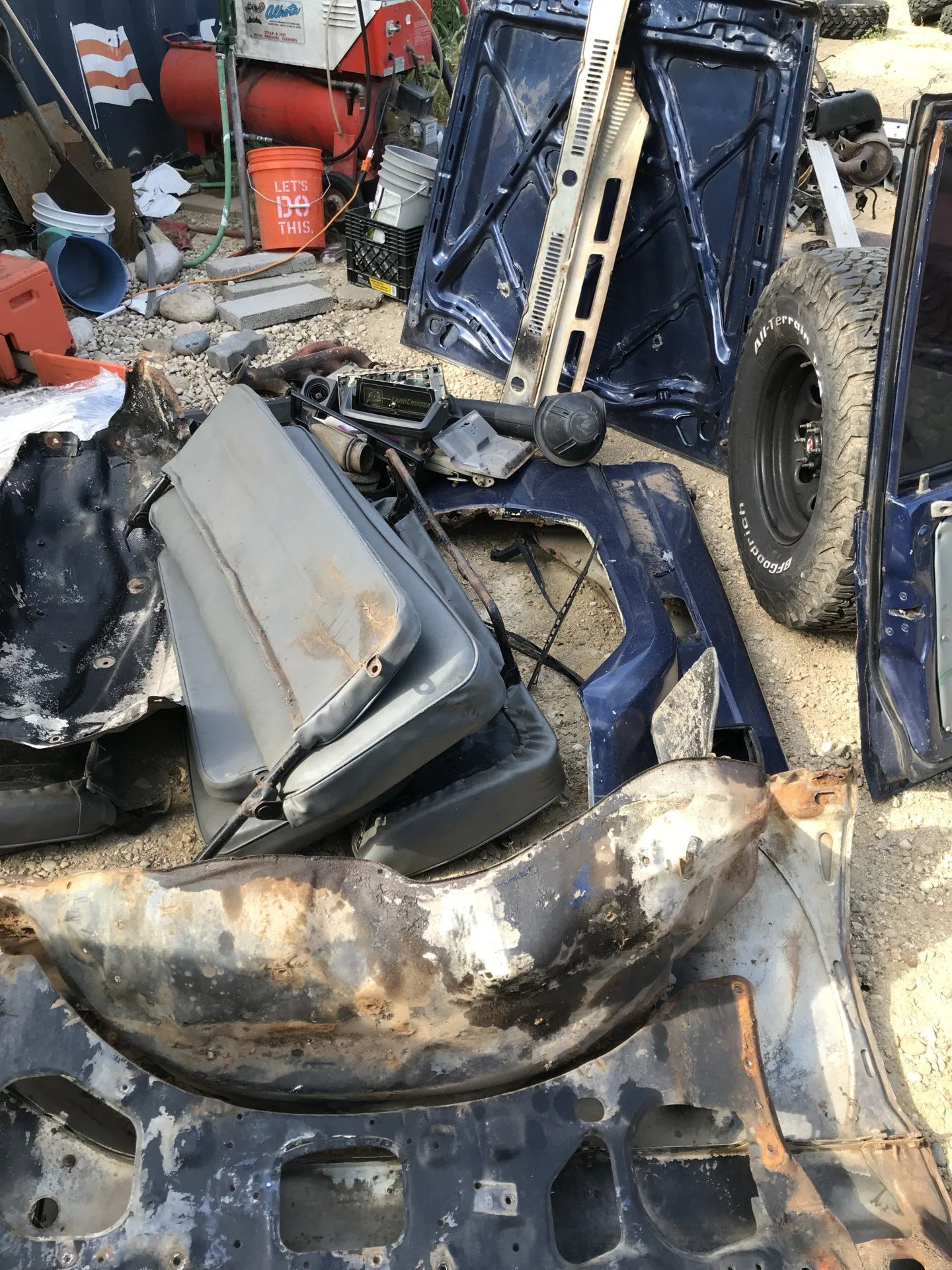

Rear body mounts and rear floor cross member is way more work and more rusty.
It’s a Cruiser, they rust.

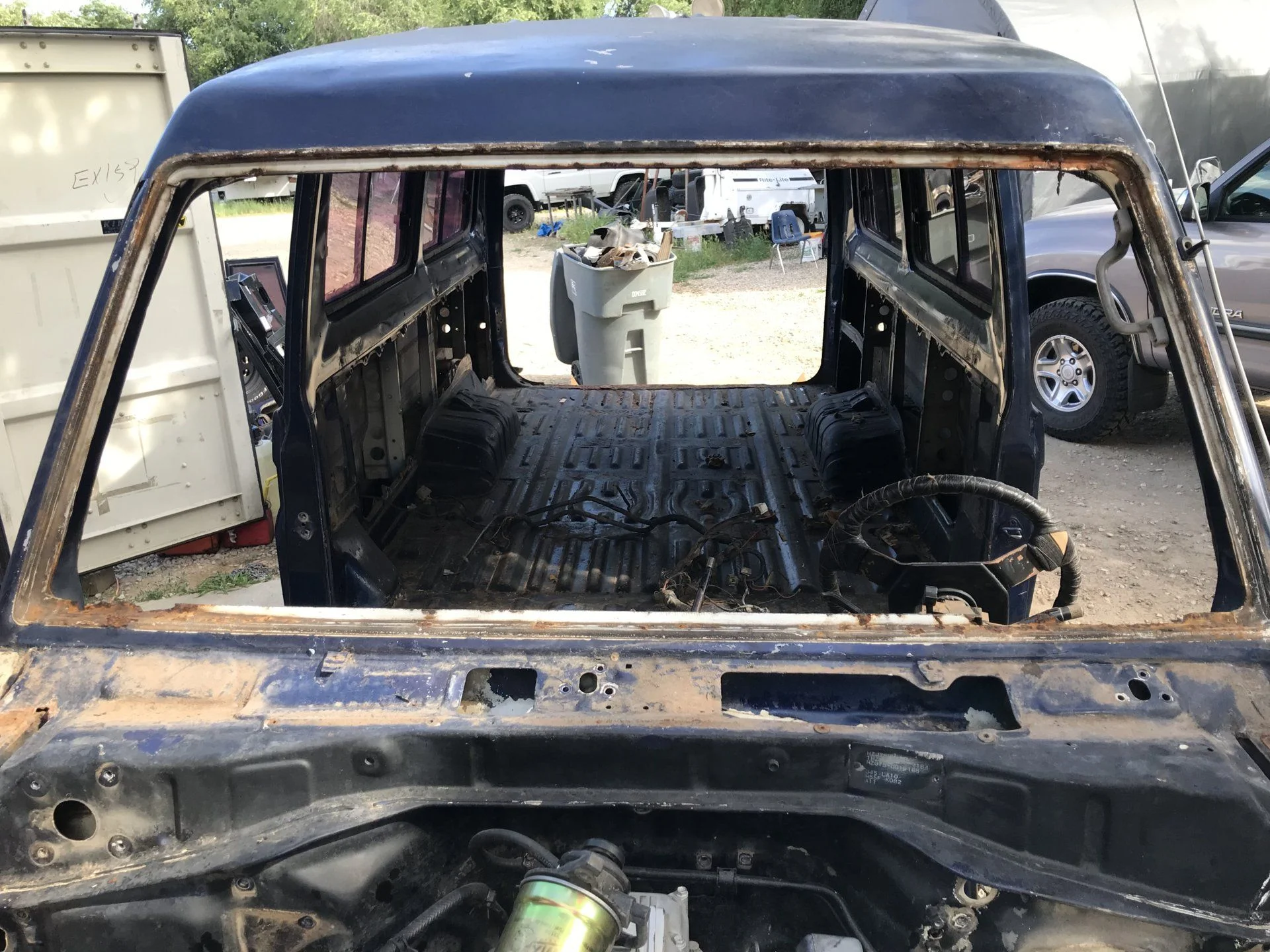

It's certainly a bummer but certainly fixable. And it'll be better than new without the question of 'is my windscreen frame rusty'. One of the main rusty areas on 70s from what I gather. Water is known to pool in the lower corners. I have a feeling a lot of the 70s on here have rusty frames, they just don't know it.
Fix, seal, peace of mind.

It'll get some much needed repairs after it's media blasted so I can evaluate what needs fixing and what can just be sealed and called good. Sealing will stop any further rust; if there's no oxygen, and no moisture, no rust will be spreading or starting.
