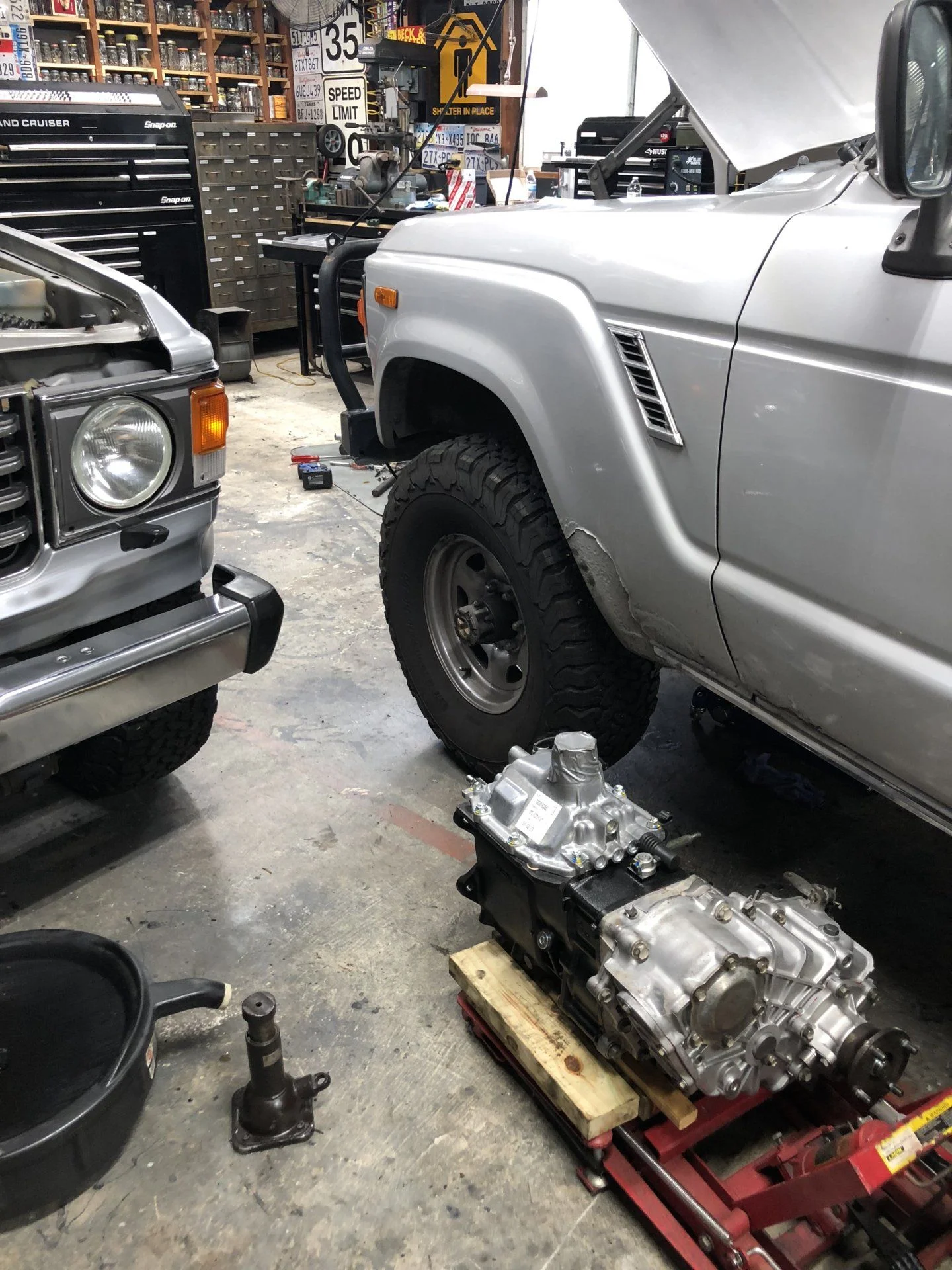

Upgrade completed. Would not have been able to do this on my own without the help of @FARMAN33
Hats of to this guy who worked a shift, and then pulled 18 hours start to finish to get this done.
No leaks, no problems and a totally different truck.
New H55F and split case by @orangefj45

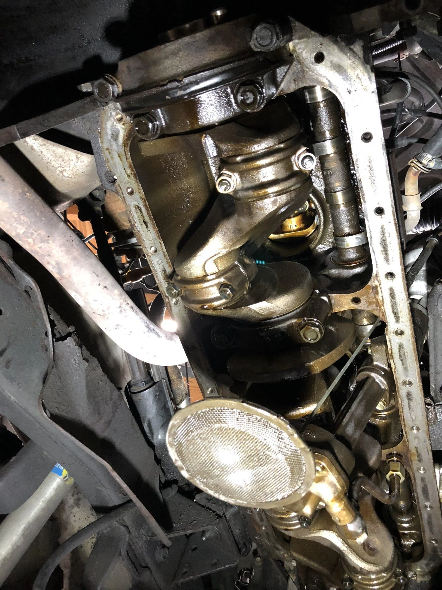

New oem oil pan
Oem rear main
Oem trans mount
Aisin clutch and throw out bearing
Resurfaced flywheel from @cruiserjunktion
The old split case was really tired. Rear output shaft bearing was moving a ton. The H42 was whining a ton but shifted great.
Now I’ve got a functional overdrive and the truck loves it. It cruised home easily and felt very proper. The 33” tires suddenly seem like a correct tire for my truck.

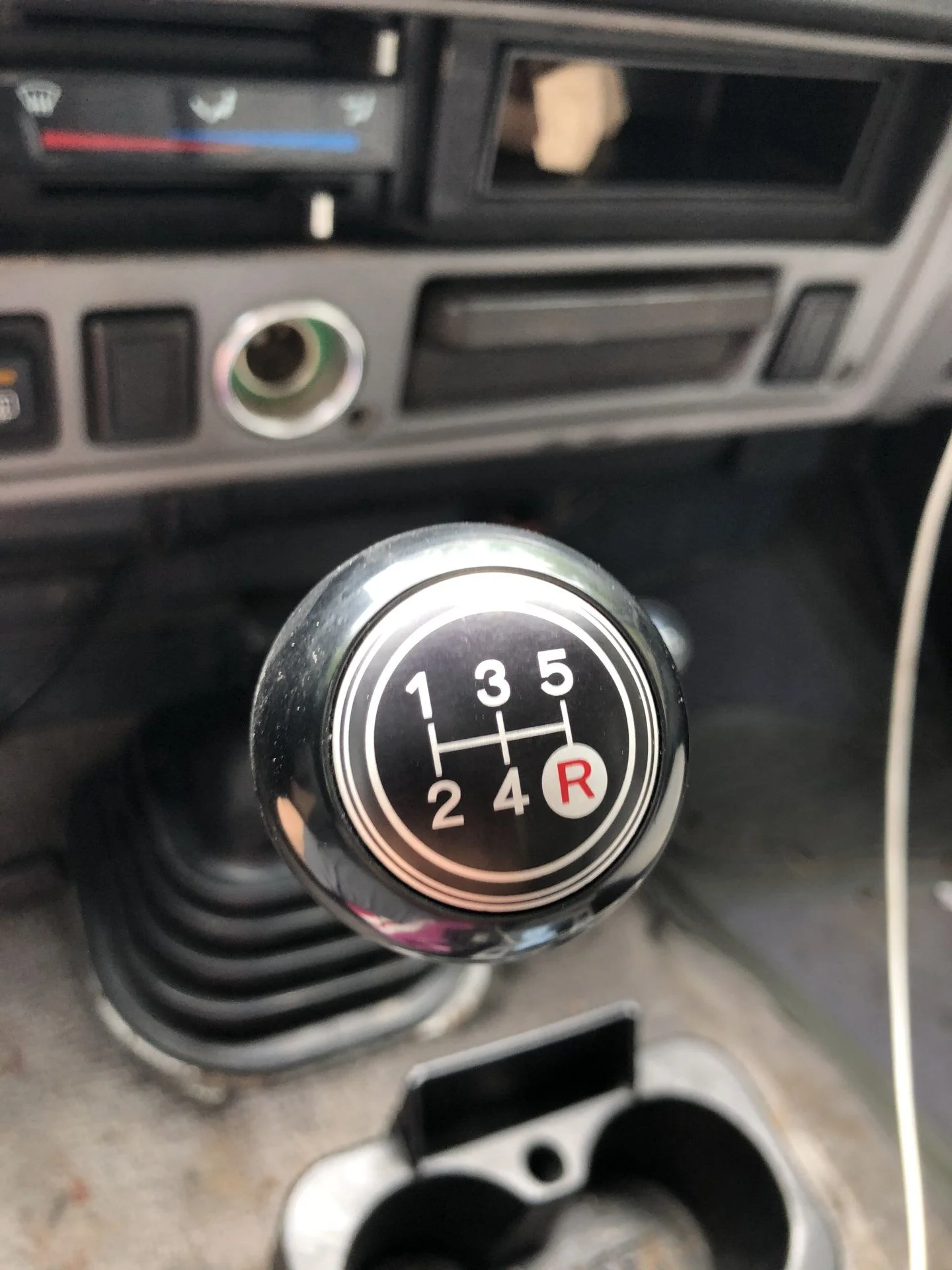

First drive to work just validated the whole deal. Driving on a busy freeway with that transmission at 75 made this completely worth it. The high mileage and desmogged 2F in my truck pulls from 2000-2700 rpm in a happy manner.
It just feels like what should have been there all along. No more slipping the clutch for starts or having to get out of the left lane everytime a Prius feels like he is king of the road. I honestly had started loathing the truck and wanted a new daily driver. Driving was such an ordeal of planning 3 steps ahead of everyone else and having to accept that keeping speed was basically an exercise in futility. Even around town the gears feel more naturally spaced and organic. Part of this issue of hating the truck is my fault for living in a metropolitan area of speeders and 5-20 over the limit being the norm.
I'm very happy, the cost was completely worth it and my mechanical work is done for a long time. Until the 2F blows. Which may be never. It was really clean inside.
I just need to get a few more miles and put some GL-4 synthetic gear oil into it and let it eat.

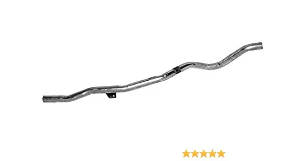

I bought a walker 46678 tailpipe for $28
It says it’s made for a 60 and 62. I’m going to see if if it looks like it will clear the sway bar, if not I’ll get them to make it.

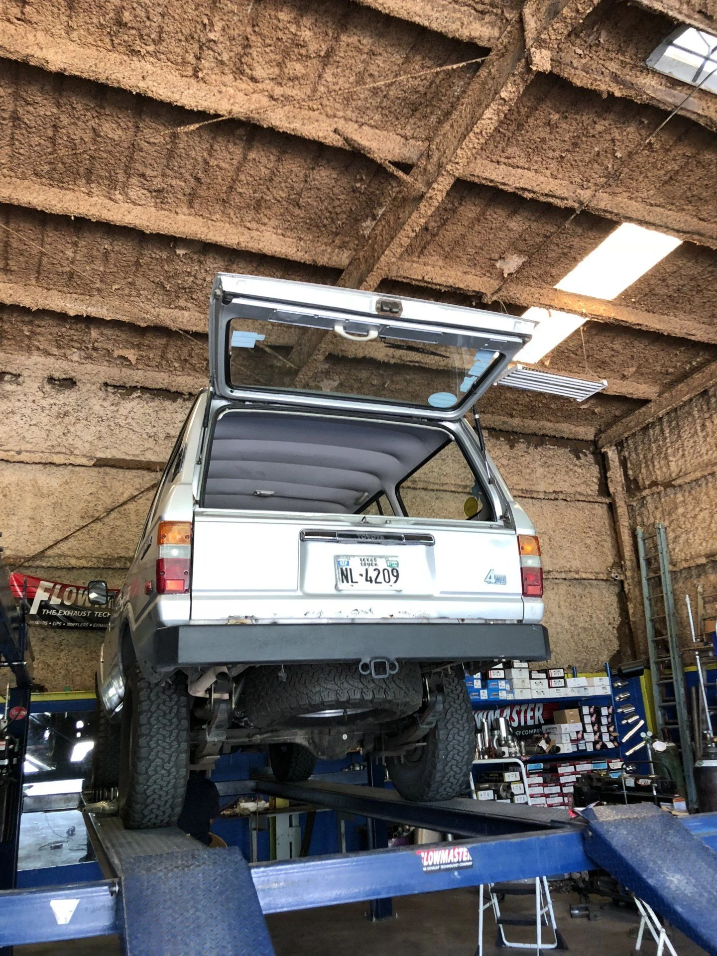

We used the eBay flange and built a new downpipe. We decided to dump the exhaust before the axle and fit the sway bar, and then I’ll take it back for the tail pipe once all that is in place.
The manifold connection is no longer leaking, so this was a huge victory. I knew I’d done something right when my idle raised after fixing that huge leak!
