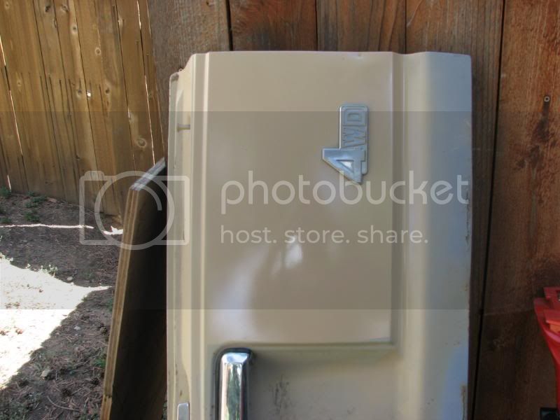

I got a rattle can of the Sand color Rustoleum, It isn't a very close match to the FJ60 tan, but you know what? F** it. Im goint to paint it anyway, and if the door jambs don't match so good - Oh well.
I'll post a pic tonight of what it looks like on my old rusty tailgate.,
Here's the photos of the section of old tailgate i did w. the rattlecan (I did the area around the 4wd symbol)
shade -
In the Sun -
you can see the color difference from the original tan, but I think it will look pretty dang good.
