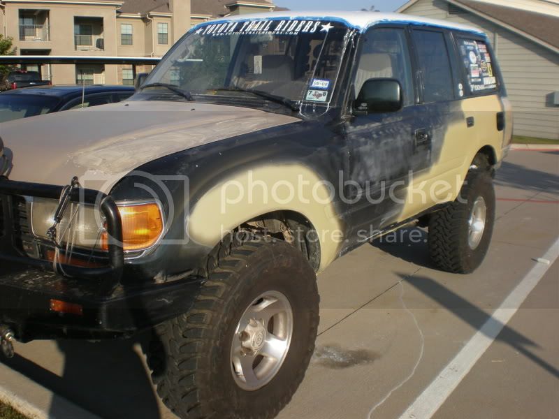

Well here is the 5th and proably final coat for the roof. Abd shes back from the body shop looking good. Now only one problem I like the color of the primer they put on there. The shop told me they would do the whole truck in primer for me for $100 any draw backs to using primer as the main paint????
He she is with the tan hood and the primer lol.

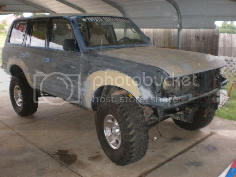

Oh here is a pic before the body work.

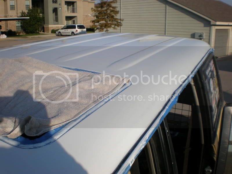

All that is left is a good 1500 grit wet sand a polish, and put the emblems and roof rack back on!!!! Oh yea and paint the wheels white!!!

Well I only rolled on the white. I got 5 coats on sanded and all in two days its really pretty easy the time comes from the wait inbetween coats to dry. The tan I sprayed on using a hvlp gun. To roll on I mixed 50/50 with mineral spirits to spray on it was 80 paint 20 mineral spirits. I would have rolled it on but my friend offered up the sprayer. I will say this the roll on is smoother and has more gloss than the spray. The spray is more of a satin finish, neither have been wet sanded with 1500 or polished yet. To better answer your question about time It took me about 30 min each morning to wet sand and put on another coat then I drove it to work this was just for the roof though so the whole truck I would say 1 hour every second coat with wet sand. 30 min every coat in between.
