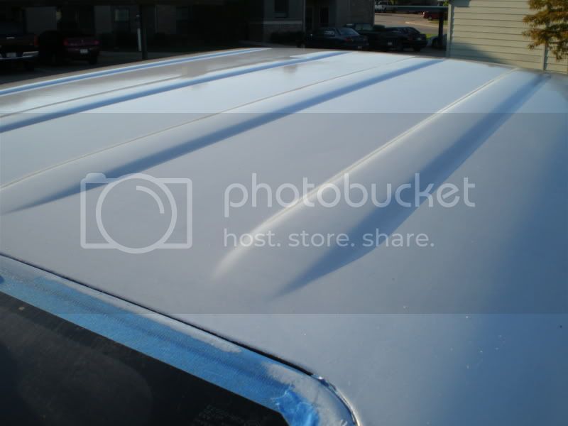

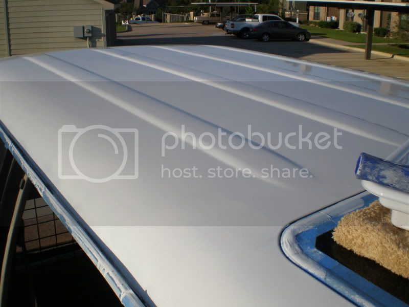

Coat # 3 after wet sand of coat #2.
Ok think Im going to spray on the body 60% rustoleum 40% mineral spirits just because this is my daily driver and time is becoming an issue. I guess Ill go with the 7771 sand to maybe I can mix it with another color to make it a lil more kaki. Or can you get a rustoleum color match I wonder.:confused:

I did that paint method. Was about 10 coats. With out the doors on. Serious labour man!
But really nice product after. Worth it if you time and don't want to clean the shop up.
Turn the radio on have some beers and roll the paint. Don't need a respirator or anything.
The trick is to not over thin as it takes too many coats. And if you go to think the wet sanding takes much longer. It literally takes 6 or more coats to get the feel for the viscosity you need.

My help spilled half of my 1 quart white and I still had enough to coat the roof with at least 6 coats maybe 7 so 1 gallon should be plenty for the rest. I tried that at my home depot and Lowes they couldnt figure it out. LOL I finaly told them look Im the one roller painting my truck and I think yall are the morons. But I think its going to work for the best because Im getting the industrial strength rustoleum one grade up from the professional In 1 gallon dune tan. After reading up the industrial dries in same time frame just made for painting heavy equipment and such. I tried to post the link last night but I just noticed its not up there.:doh: Truck will be back at the latest Sat. so should have 1st coats on by Sun.:cheers:
