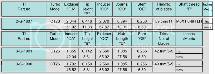

Here's a chart I took from a website with the normal sizes

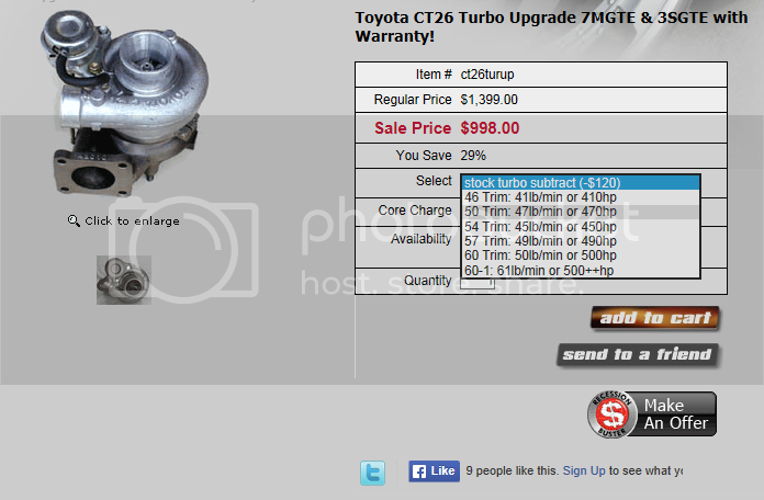

and here on this site they're offering hybrids and the mythical unicorn 50 seems to be more potent then a few of its larger cousins.
