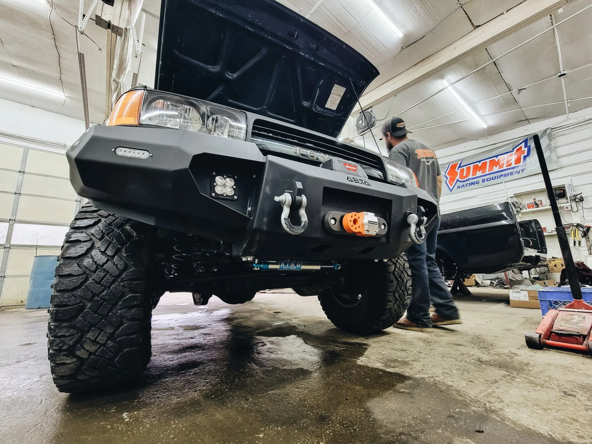

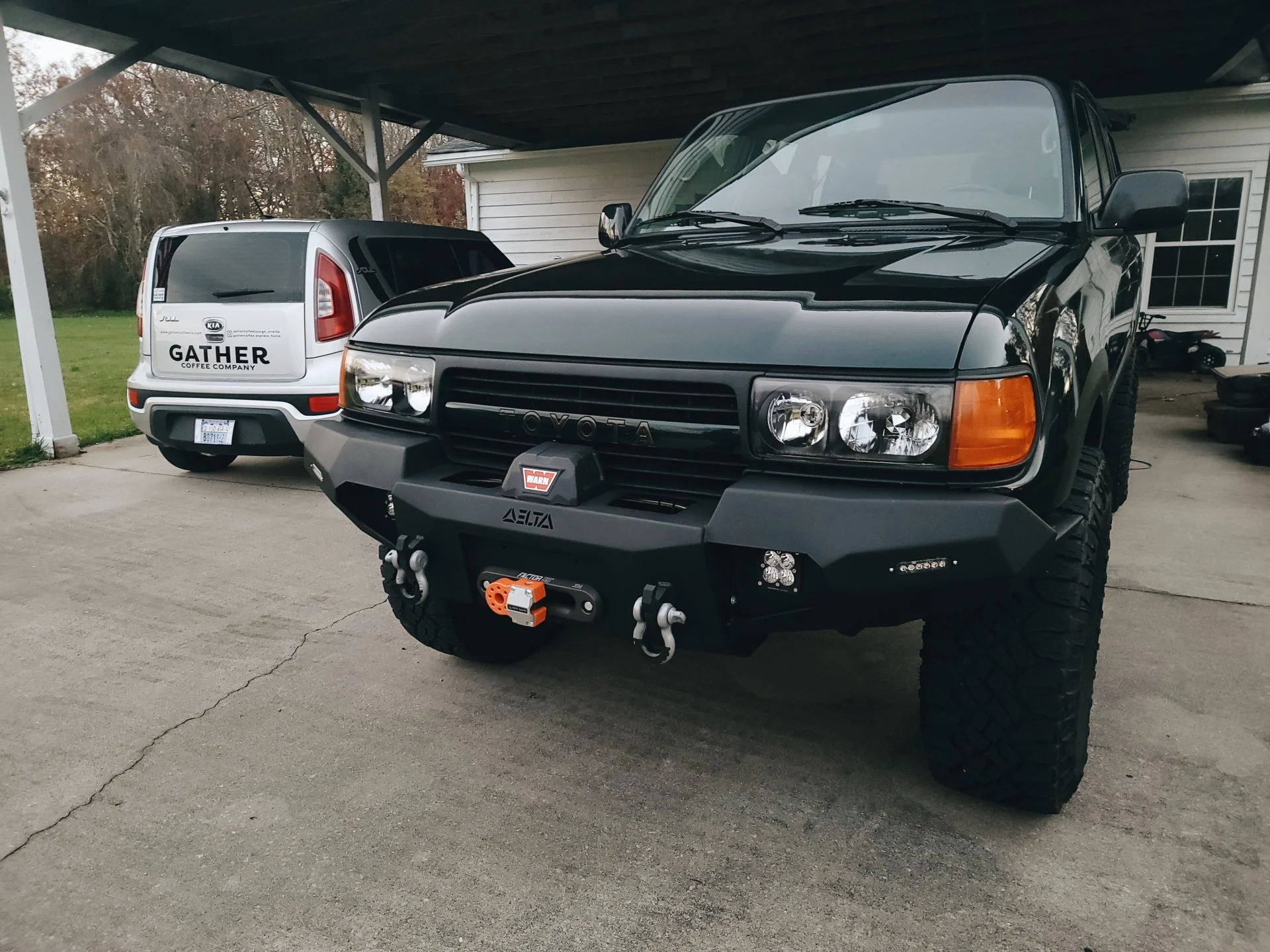

Thanks to everyone that talked me off the ledge about 3 weeks ago, and kept me from selling my 80. If you remember, I got screwed by a local shop and the project was waaay over due and I was running out of options. I had offers from y'all from Florida, to Texas to send my rig down and get it finished. Thanks to everyone for those offers! Thanks to @cruisermatt for the frantic phone call for the advice (it was dead on right!). Thanks also to Eric Berg, and the many others that reached out on FB.
I was blessed with finding a local hot rod shop that was HIGHLY recommended. I took the risk, and man I am so thankful! Thanks to @davint24 for the VERY high quality work!!! And welcome to the Land Cruiser family. I heard rumors he may be expanding his operations here in East Tennessee to offer these swaps.
Anyway, thank you again everyone! Here are some pics!!!
Scott

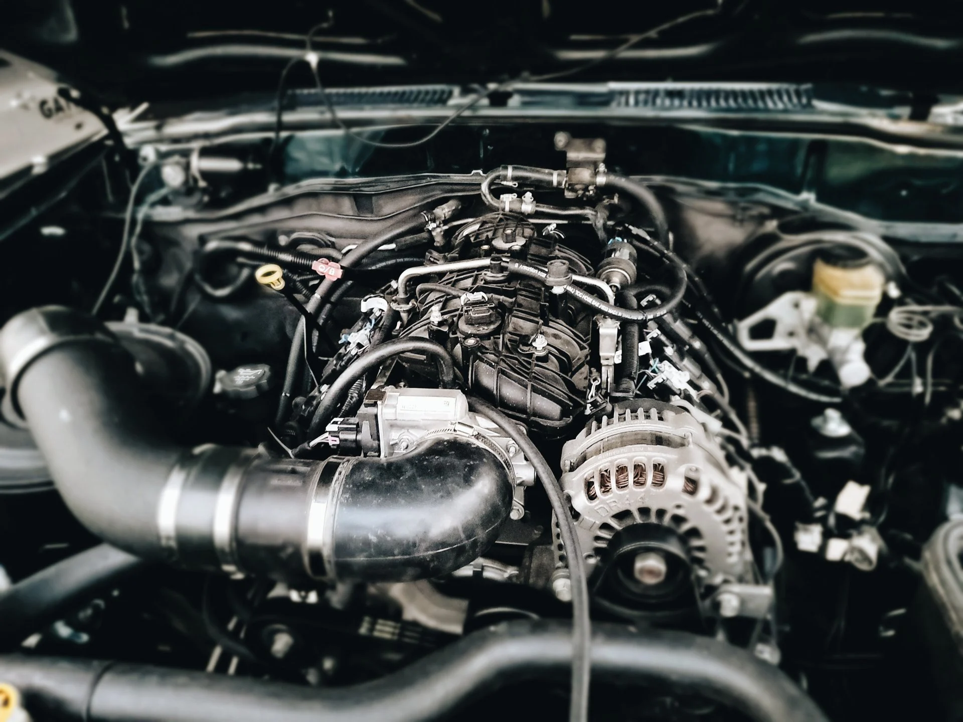

Nice, can you post some details of the build? Engine, trans, adapter? Thanks...
5.3l LY5 out of a 2008 SIlverado. 4L80e trans. Went with Mark's Adapter
Wow, that build looks “meaty”. ;)
Good call on the 80 series slushbox. There's nothing "wrong" with the 60 series per se, but I've had a Tahoe or a Yukon for 20 years and I've always started having transmission issues around 125k with basically soccer mom style usage. I just think the 60 series isn't robust enough to deal with LS power and heavy SUV weight. They'll get you through the warranty period but they're a ticking timebomb after that.
Minimal (and nearly free) mods can cure this. The 4l60 gets a lot of unnecessary hate. But yeah, the 80 is more stout.
